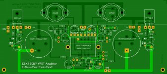

Hi again PermanederBetter that way?
Could be possible delete little hole on the track between 1K's and gates of Vfet's ?
Open possibility to use biger wattage resistors if supplementary holes on 1k but on side's of 5k trimmers ? Thank You !

Hi again Permaneder
No. They are the through-the-hole contacts from the bottom to the top layers.
Why use higher power Rs in that place?
Bottom with top layers contacts is for soldered with jumper ah ok.
I agree standard vishay dales do the job well.
Higher wattage mean less thermal distortion.
For 3,50 $ Caddocks 1% To-126 package 1k or 100k TO-220 wake up my curiosity but is only for few resistors in output or buffer stage.
With supplementary hole we have space to try this things or others and don't be limited to one model of resistor hope other people like it 😀

Hi one more time Permaneder !
Can be possible bring this to layers contact to 1k 's resistors leg than be one hole less on track just two sides soldering ? Simpler and with entire track who go to gate...
What Your think about this ?
Thanks and best regards

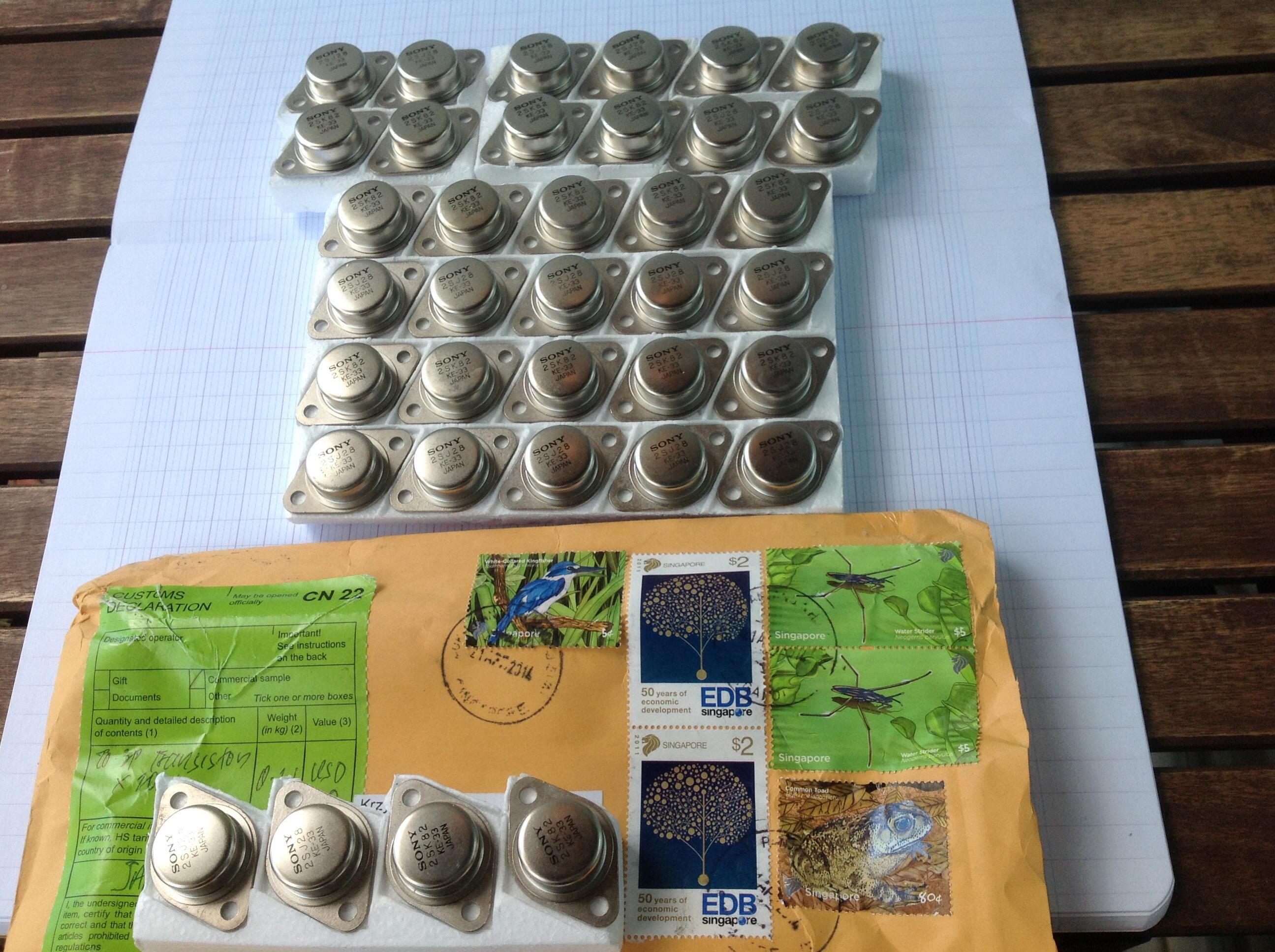

I have 18 pairs of Vfet's not matched is this sufficient for build one symetric amp ?
Nothing to solder here. The two layers are contacted through the hole already.
Hi Permaneder
I better understanding now this layer.Thanks
What you point of view about biger resistors extension on pcb ?

I did some minor changes. The negative input rail of the main supply (-32V) has been moved to the bottom side of the PCB. That dependably prevents any possible electrical shorting between the L profile and the supply voltage.
The rest seems to be OK so far and I’ll place the order to my board makers on next weekend.
