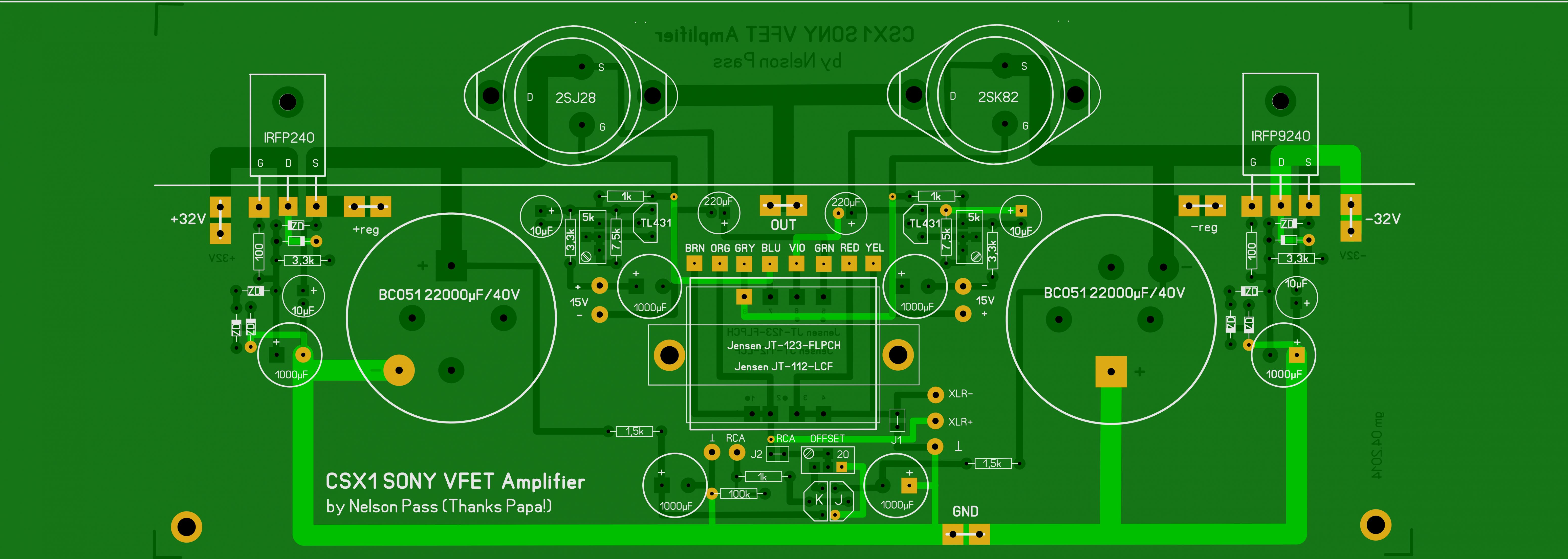

Here is a first proposal. The board measures 240mm*107mm. It bears all regulators an the input buffer. The jumpers J1 and J2 allow unbuffered balanced or buffered unbalanced mode.
Suggestions on improvements are welcome.

with those minimal parts you still need a pricely PCB?.just add it up to the heatsinks. Well it might be good for a cosmetic look....if there's money why not...
Hm, I think it is fine for me to have all these regulations and gate bias circuits in one place...
And very short distances....!

I like the board. If we realize a preamp gain for it. All together in a board.
Only difference I see, is that you have a big 22000uF cap after the regulator. At first sight I thought is was before the regulator as part of the PSU.
It helps to improve the supply.

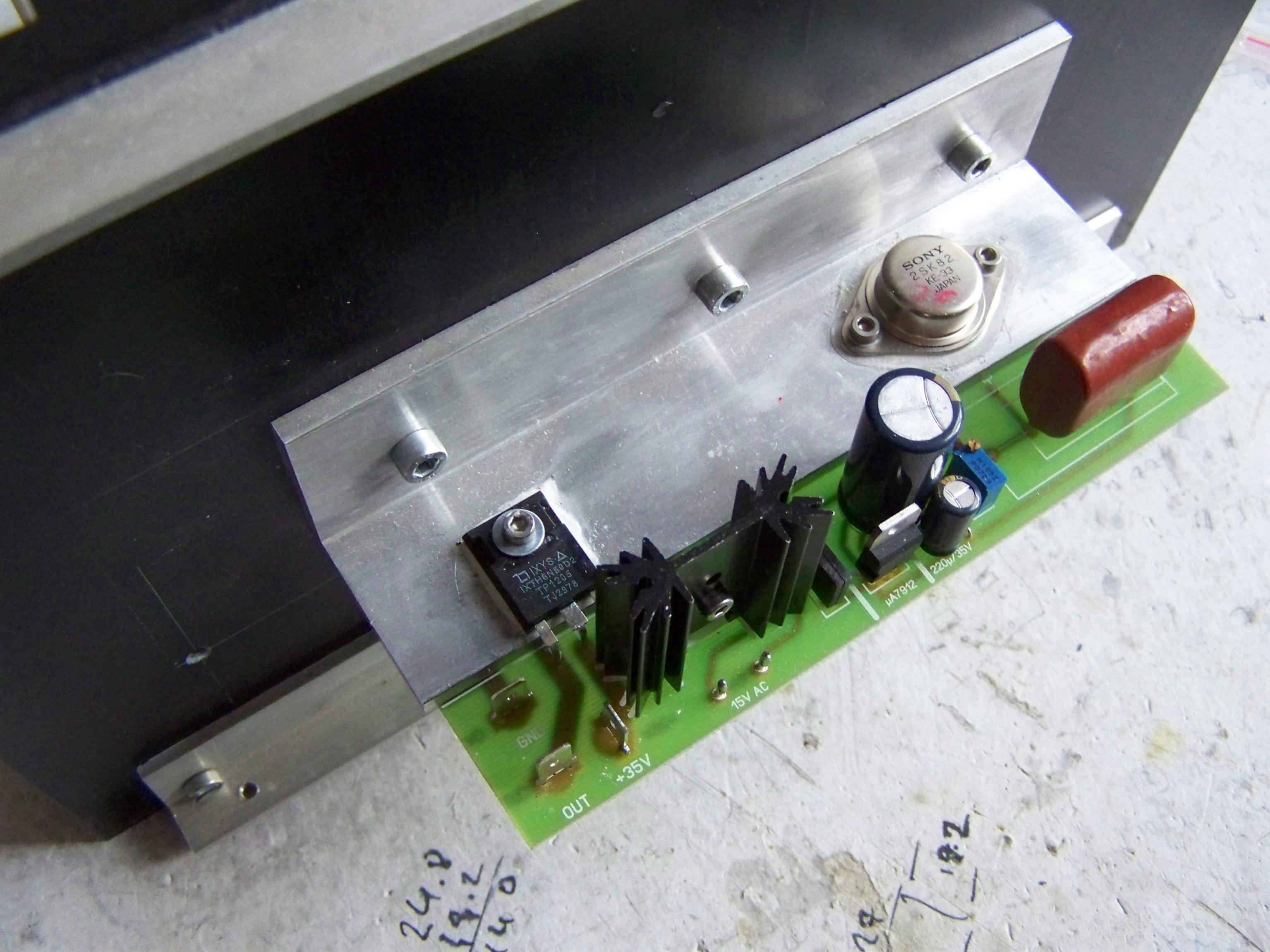

Can this PCB have supplementary holes for fixing with screws on the chassis and L profile ?
This circuit have much weight with Jensen and 22000 uF capacitors on.
I don't see any in your final pcb CCS L'amp version and Vfet...
Thanks for Your great work !
Greetings 🙂
SONY VFET
Yes. Not really necessay yet. The 2.2mm thick board is stiff enough.
Hi Permaneder
Greetings 🙂

The actual price for a set (2 boards) will be around EUR 30 + shipping cost.
