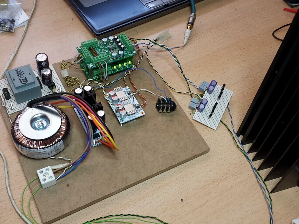

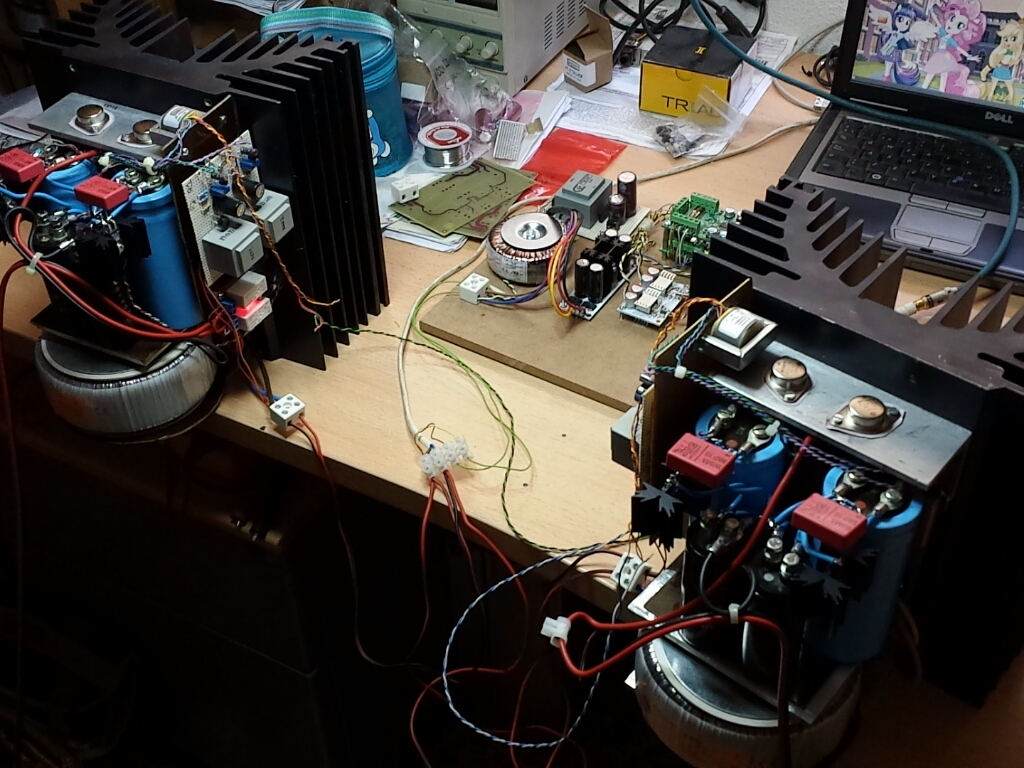

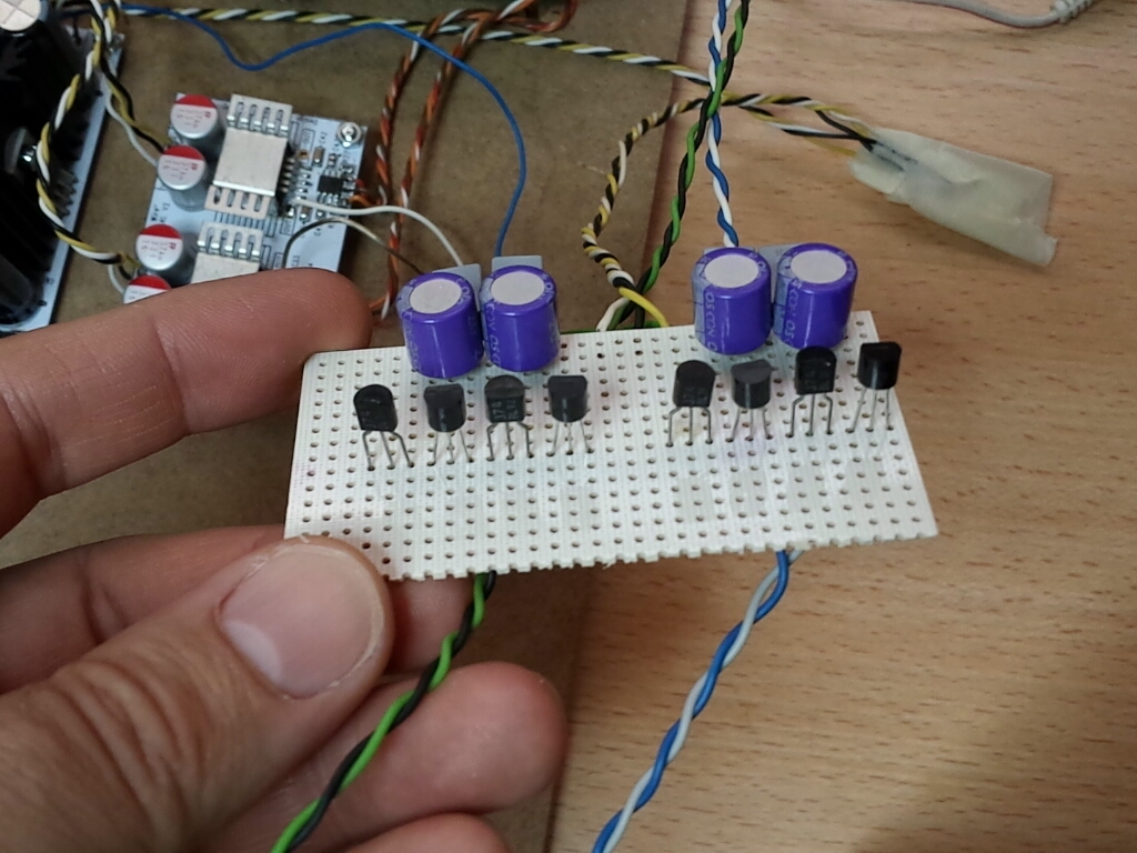

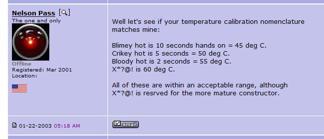

Good days all. Today I have finished the second channel. I connected to speakers and I found that: 1- there is a pop in speaker, 2-amplifier needs 30 minutes of warm-up to adjust the current. I set to 1.43A both and there is a little drift into DC offset, but in +-30mV range. 3- Heatsinks are a little hot, I cannot touch with hand more of a few seconds. 4- Initially, DC offset is high (300mV more or less) but in a few moments descend to +-30mV range.
So, it is necessary a delay to connect the speakers and DC protection, I think.
I used OPUS DAC from TPA and buffer without pot. I do not like sound of Opus DAC. It is very soft for me. But amplifier it is very neutral, I think, very detailed (with orchestal music) and very realistic (piano sound like a piano).
But I need more gain with Opus DAC (2Vrms in accordance with specs) and 86dB speakers.
The next step is connect to my BIII and unbalancer tube stage from Broskie and the buffer with 2sk170 2sj74 of course (output impedance of unbalancer is a few high). And a little of gain before (x4 to x8)...

I touch my self and I am bloody cold. Two seconds and brrrrr Que frío!
Congratulations and put muscles to drive it Friend Juan Antonio.
300mv indeed are eleven miliwatts? Not to high power for your 86dB/W Proac.
I would to realize a softstart with dc protection anyway.
