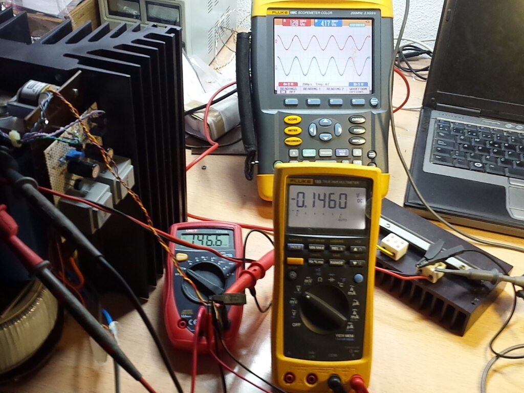

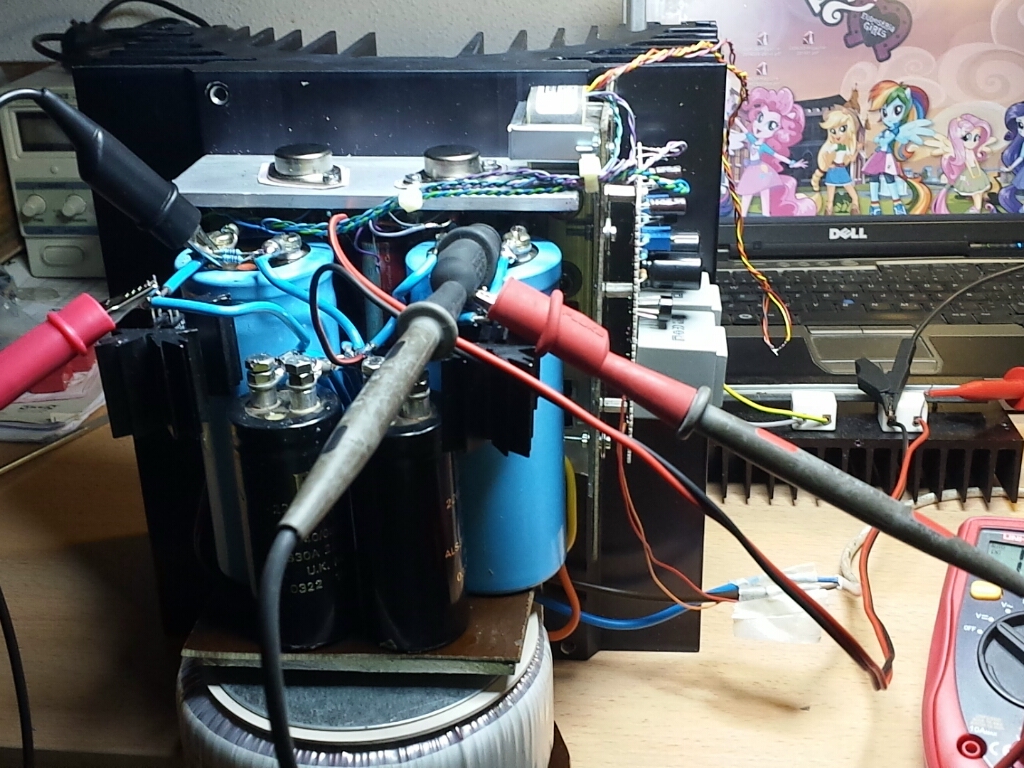

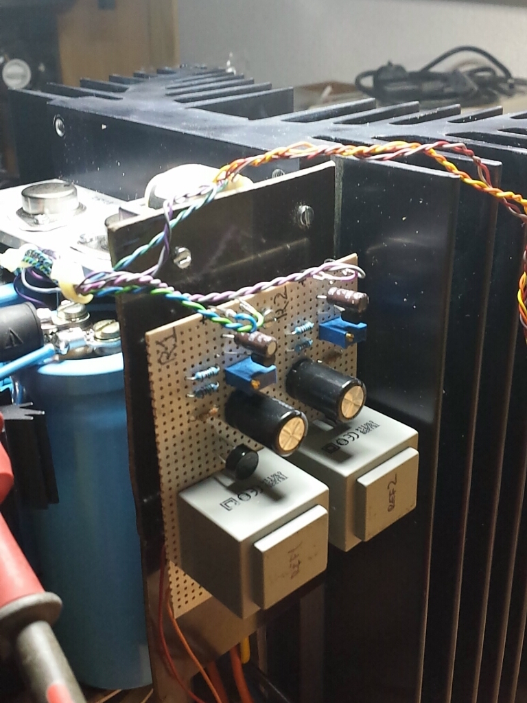

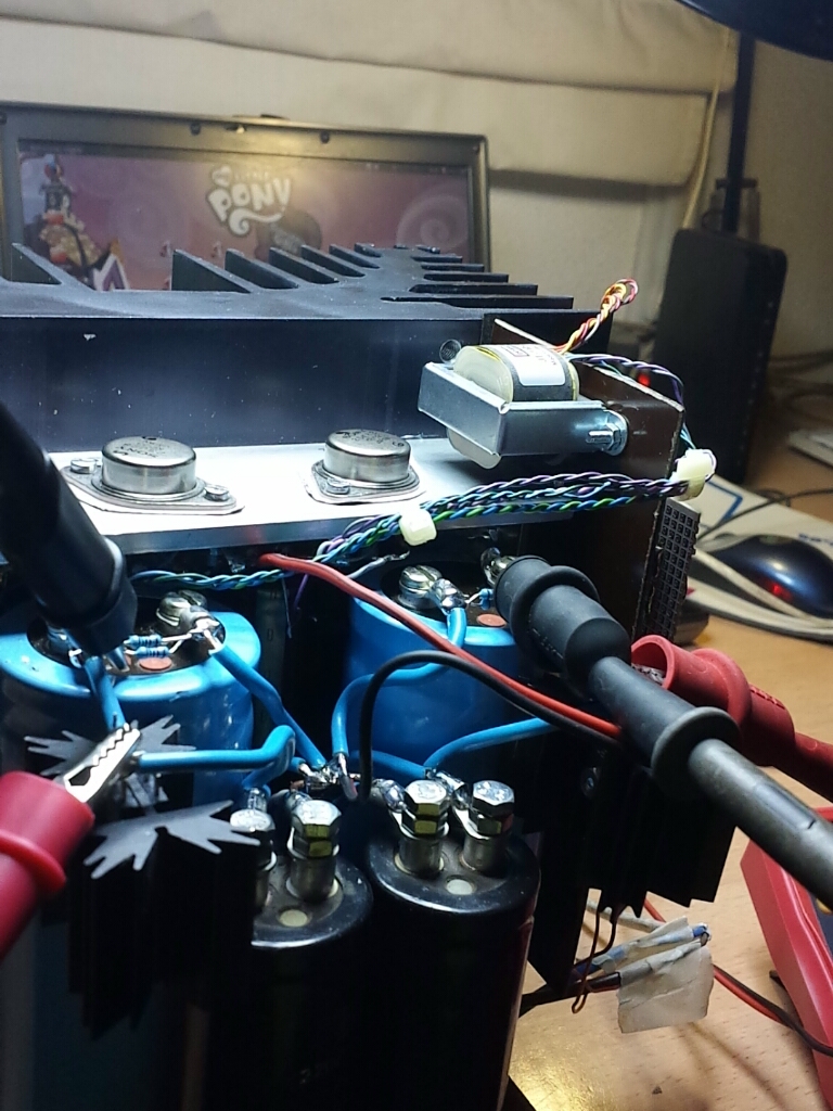

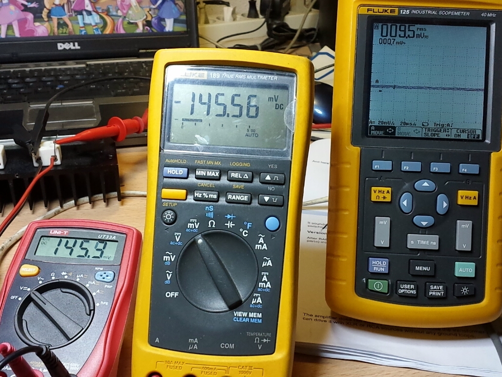

First power on
Hello, this is my first power on. I have gotten 1.45A of current and 9mV of DC offset. I think this position of transformers is good. Input of Jensen is short.
The heatsink hot but it is possible touch it.. Load is 8 ohm power resistor. This is a good start....

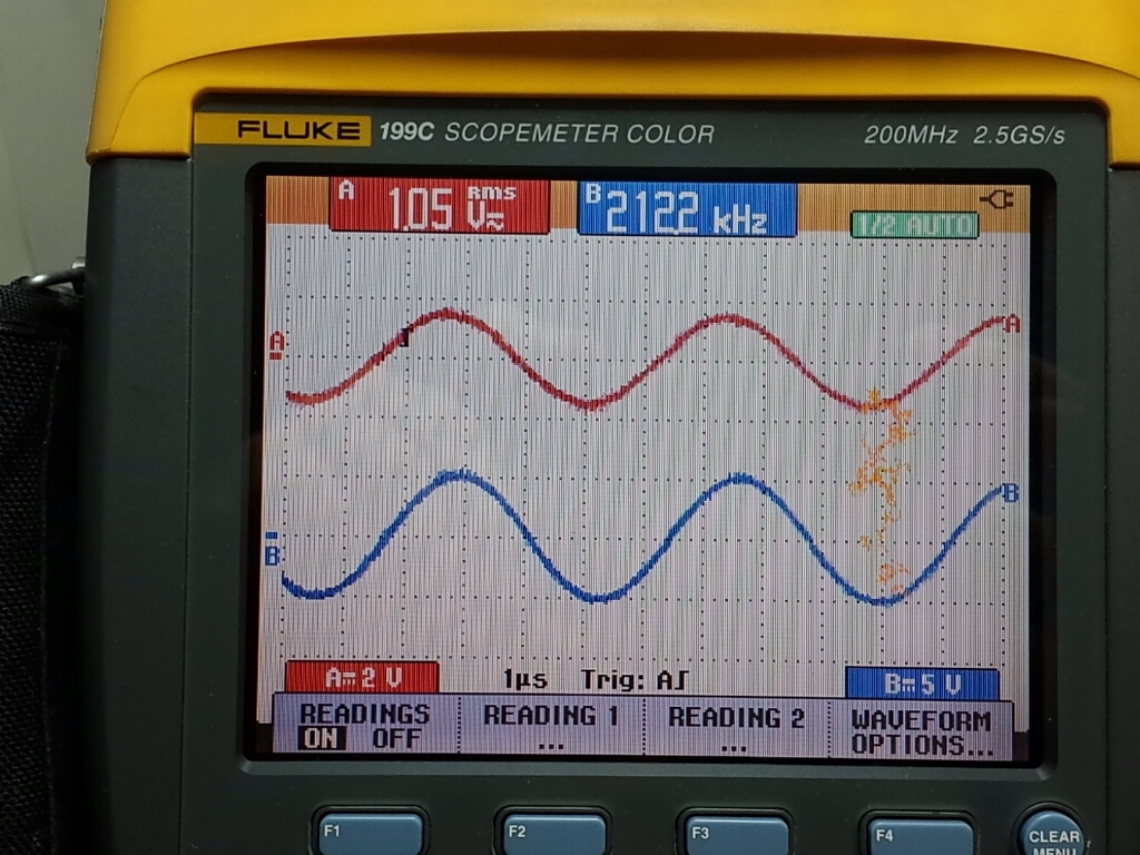

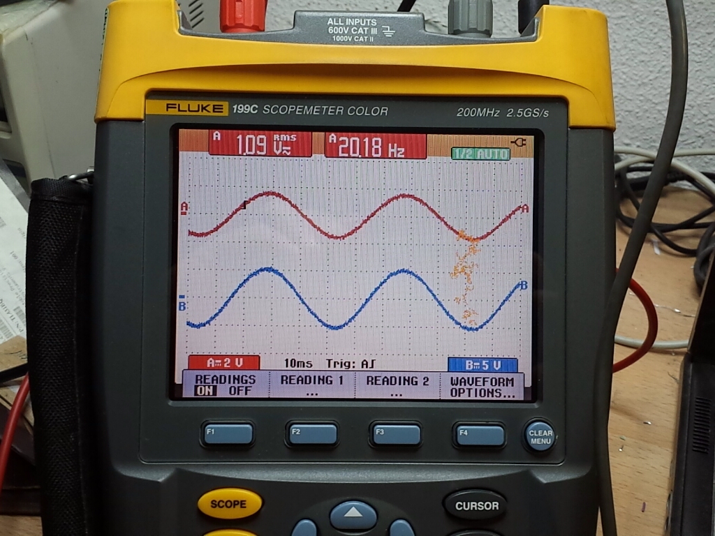

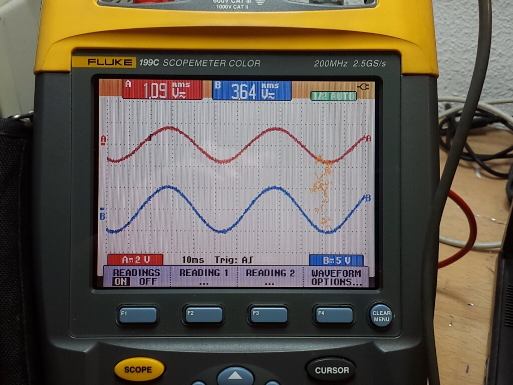

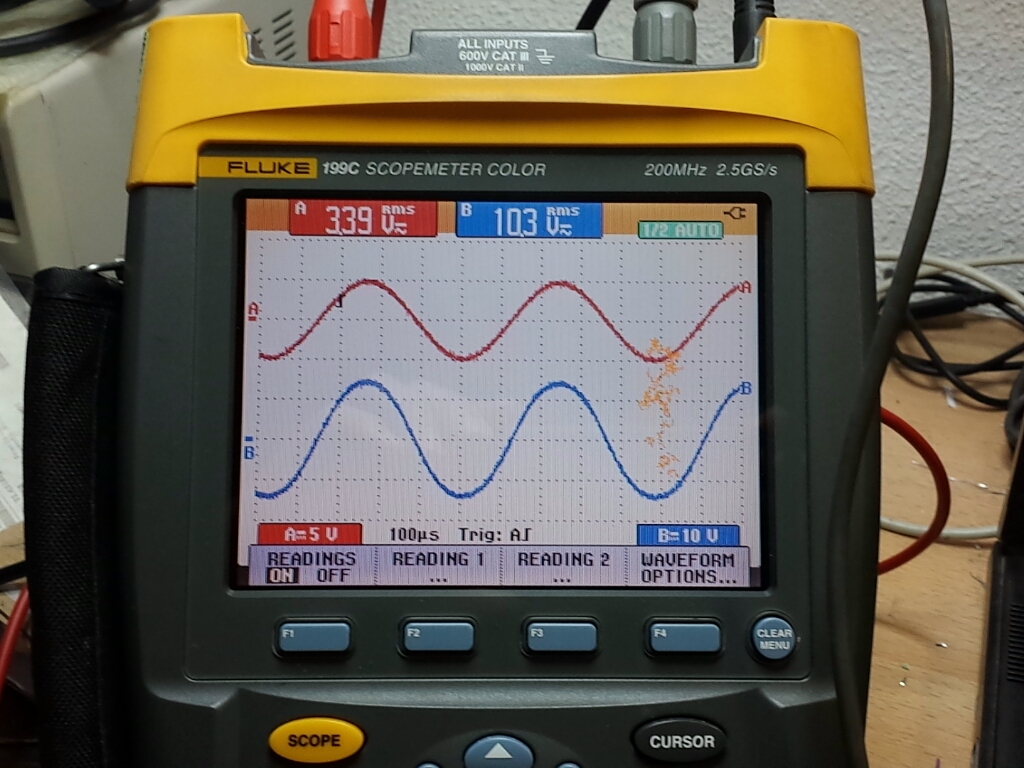

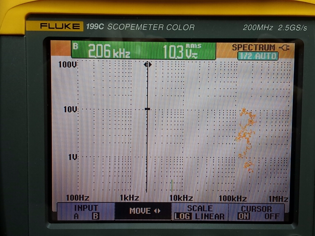

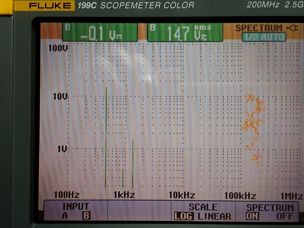

First test
Hello again. I have done some measurements.

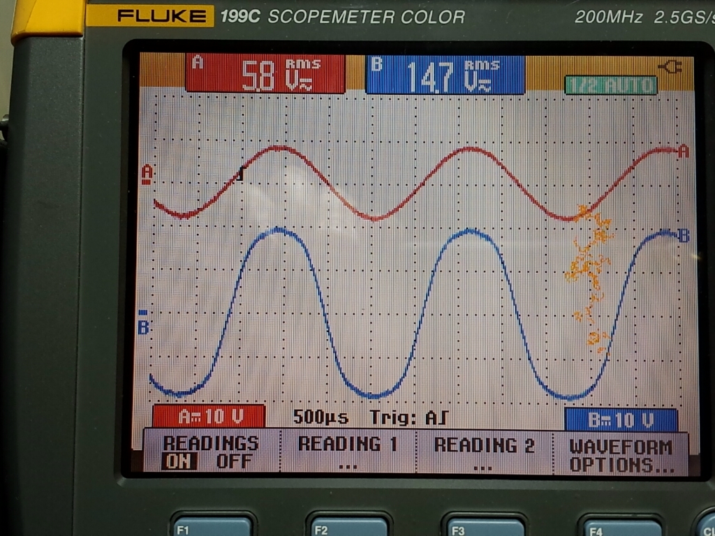

3. To 12 Wrms to 8 Ohm (10Vrms), appear third harmonic

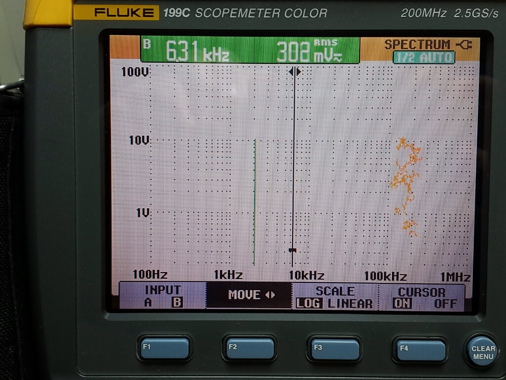

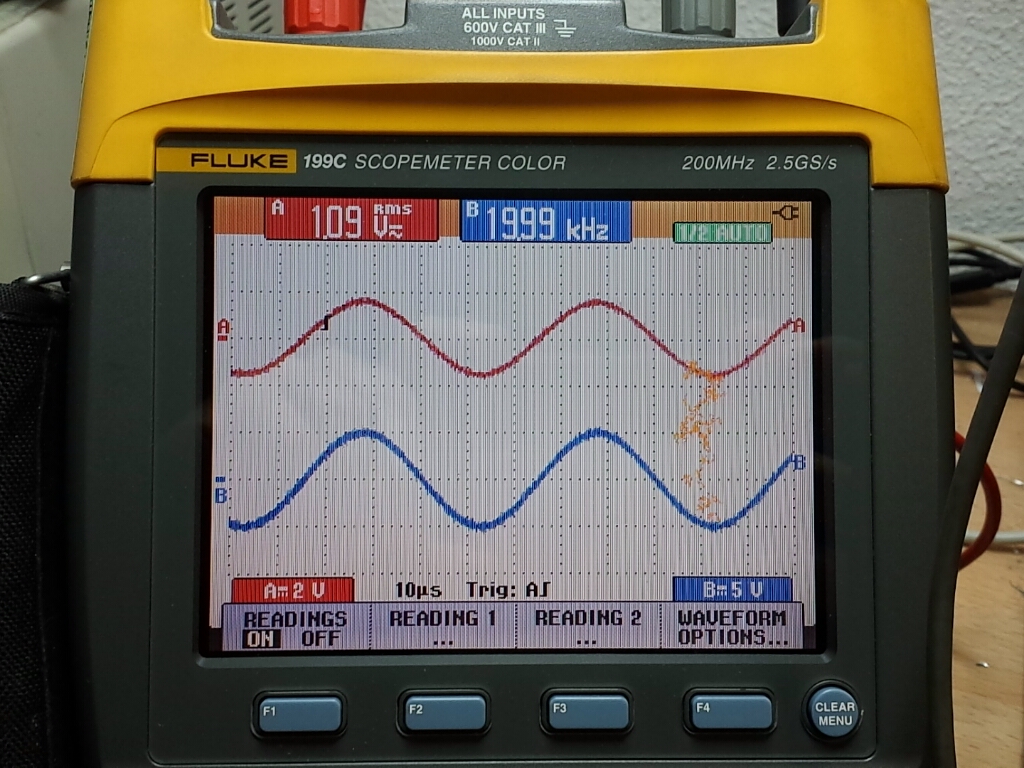

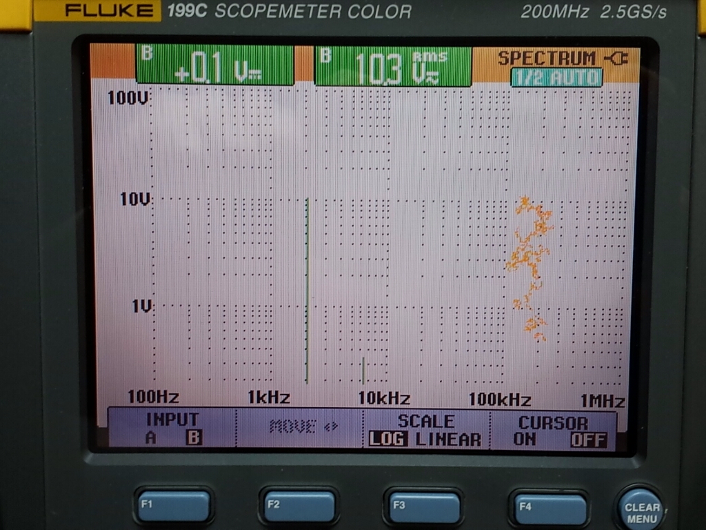

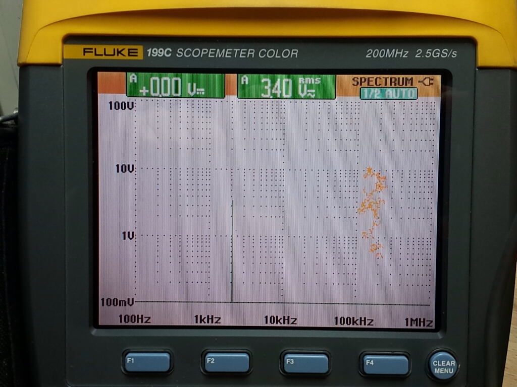

More measurements
Regards
