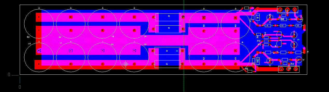

Is anyone handy with pcb123 and willing to check my work/collaborate?

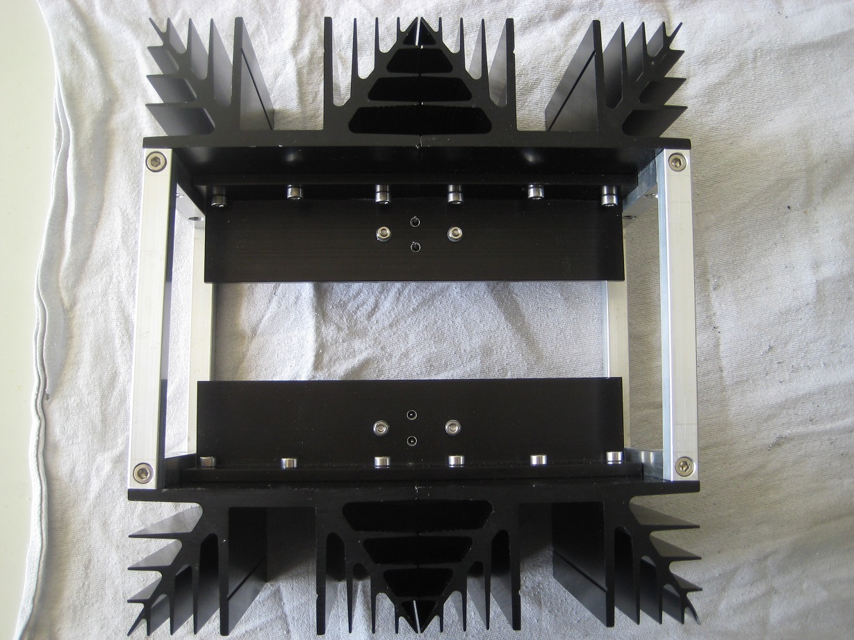

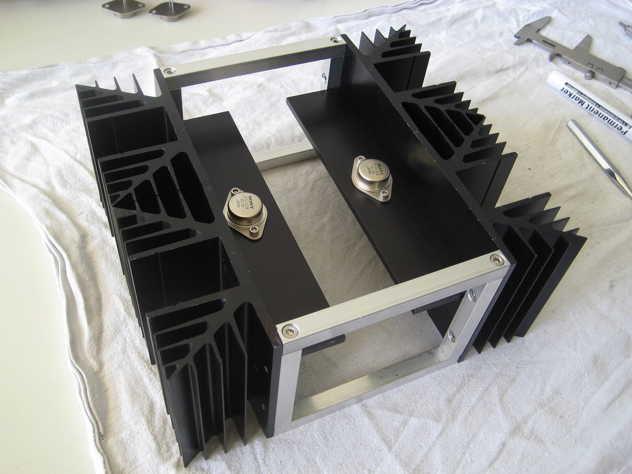

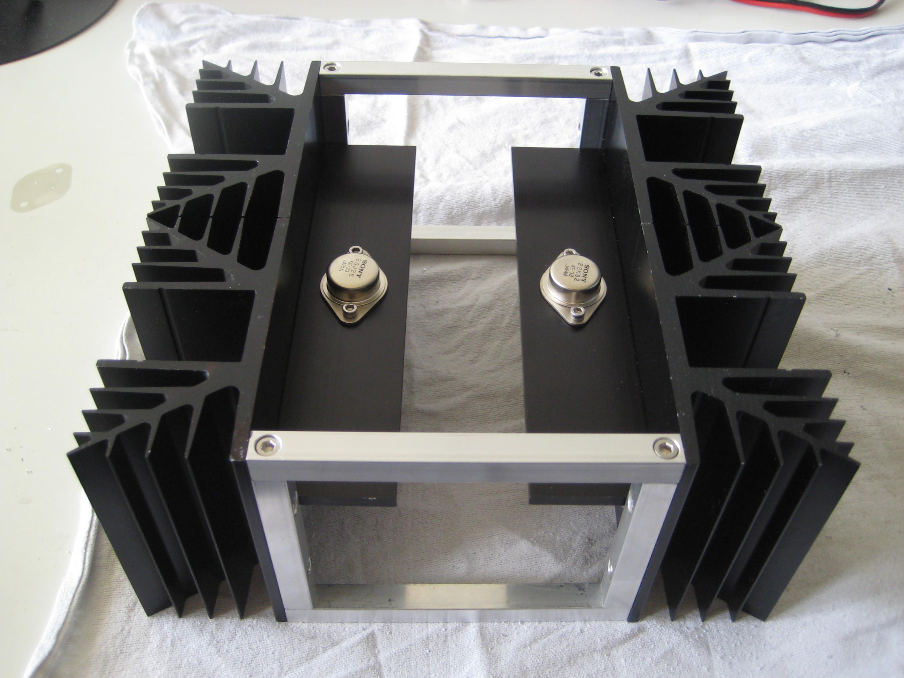

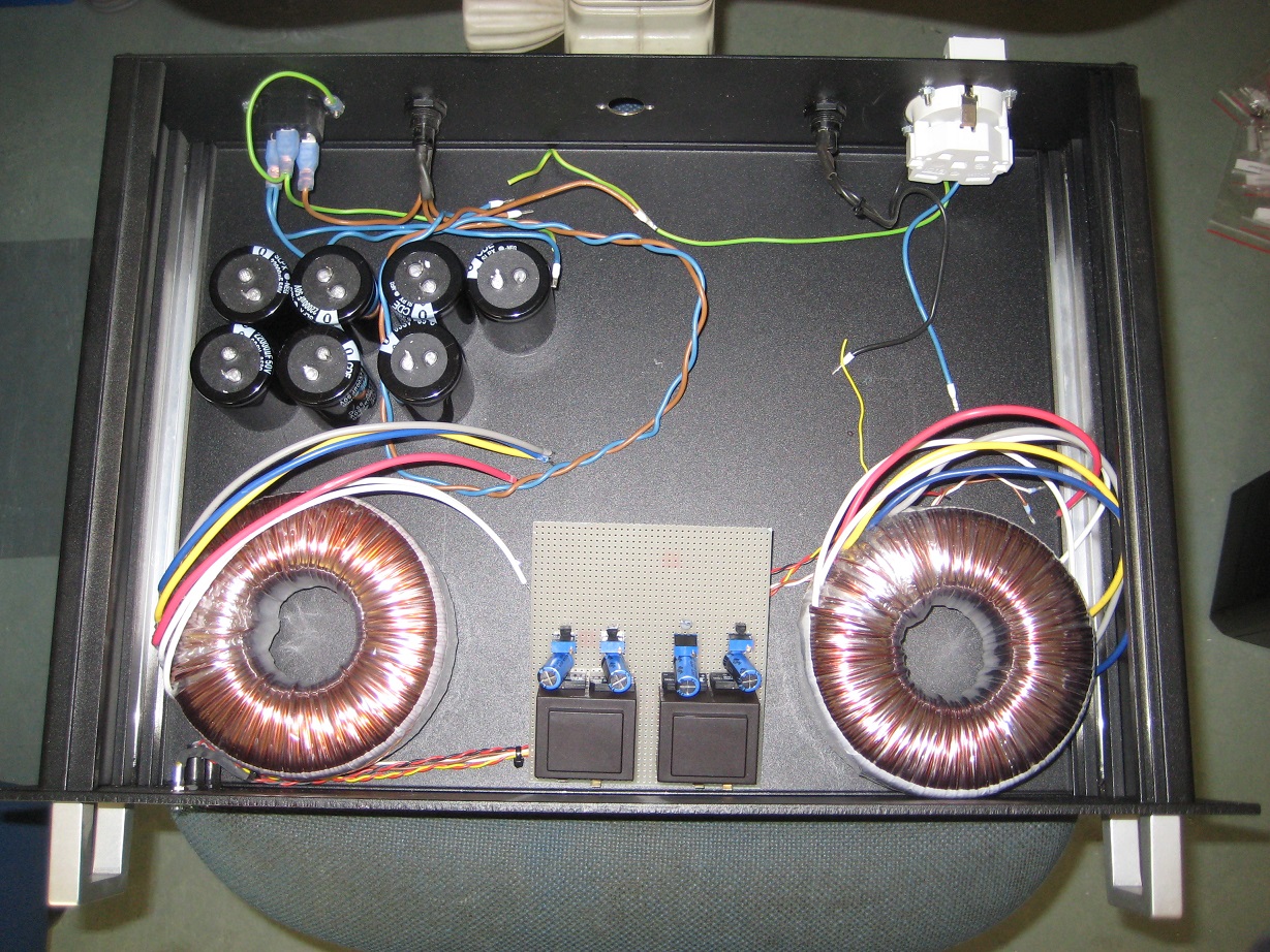

This is how I'm gonna make the chassis.
Two little monoblocks with each 4 x SK88-100 (0.9K/W) heatsinks I got from the surplus store. I'll spray paint all the aluminum black.
Hardwire the Amps. Dimensions are: 220x200x100 mm.
Separate power supply in cheap *** 19" case I had laying around.
I have a feeling this would not be my last VFET Amp, so I don't use too expensive materials yet... but I do want to listen to them 😀
Any suggestions for the PSU connectors (8 pole) to the amps?
Still waiting for my Jensen they are at dutch customs....takes usually 7-10 days 🙁
Walter
