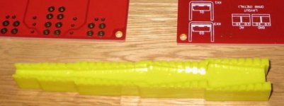

The plastic tool Rudi has to bend resistances matching circuit board's holes distance, is very usefull too.

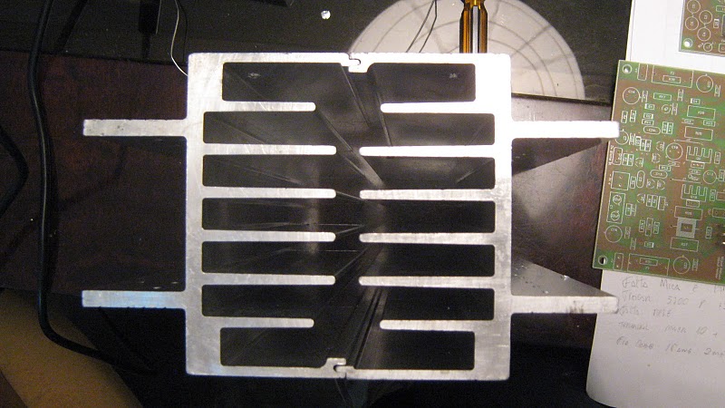

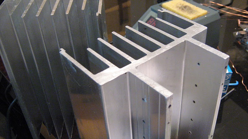

There is some escape, Niss_man...
Now that you said it, I realized the MJL are smaller in width than the Sankens....
The Sankens are wider, and would make the PCB much larger ...
If you manage to get heatsinks like these, you can mount each Sanken on a different floor (first transistor on the first floor, second on the second one, and so on).
Max.
