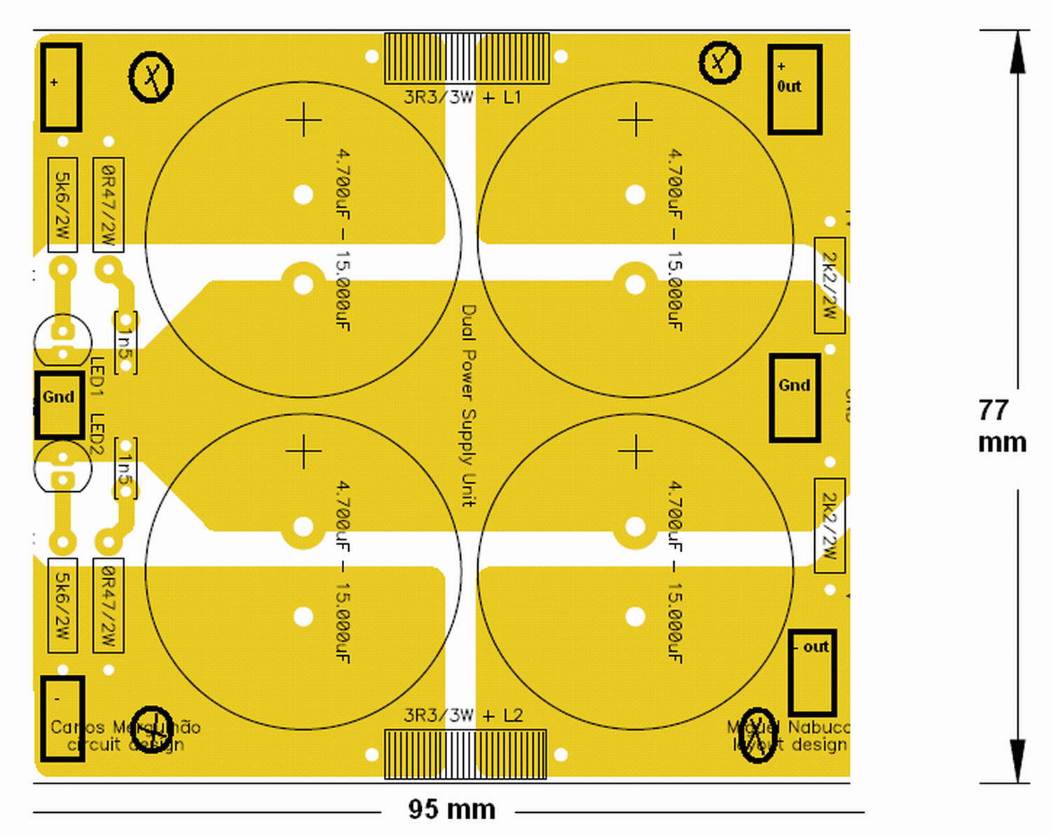

post28 shows Q9 & Q10.
these happen to be located right at the two ends of the Power supply rails. These are the closest that the supply rails come together on the PCB.
Here is where the HF decoupling should be fitted. This is to minimise the length of track/trace from the +ve output device collector to the +ve rail HF decoupling to the -ve HF decoupling to the -ve device collector. This route must be short to keep inductance down. If inductance in this route is allowed to rise then the HF decoupling cannot pass HF transients and becomes worthless.
The centre point of the LF decoupling and the centre point of the HF decoupling are joined together to become the PCB Power Ground. Unfortunately the main Ground is ~90mm away from the HF decoupling centre point. That is brought about by the enormous spacing between the +ve supply rail trace and the -ve supply rail trace. These two rails must be located right next to each other to minimise the radiated effects the half wave rectified currents have on the rest of the low level circuitry.

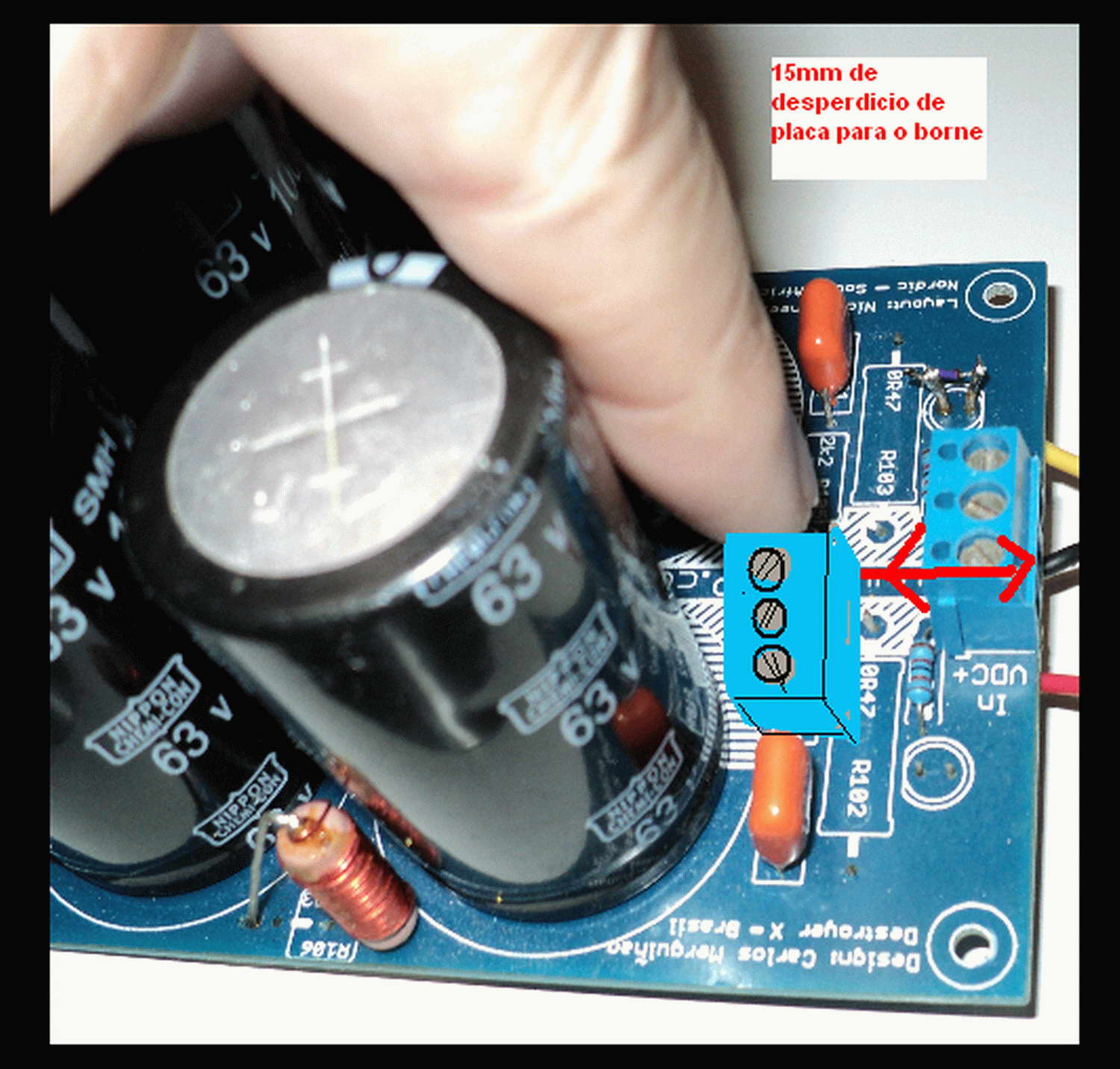

We are working in the details, discussing sizes and shapes
We are not sleeping..the "Corporation" is working full time to achieve better and better quality into boards, layout and schematic.
Soon you gonna see the result..now we are reducing supply size, because our amplifier is suggested to use two separated supplies...also can use a single one too..but when using two supplies the performance is better, but also the room needed to two transformer and two supply boards is huge..so..we are reducing all we can.
regards,
Carlos

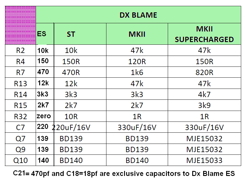

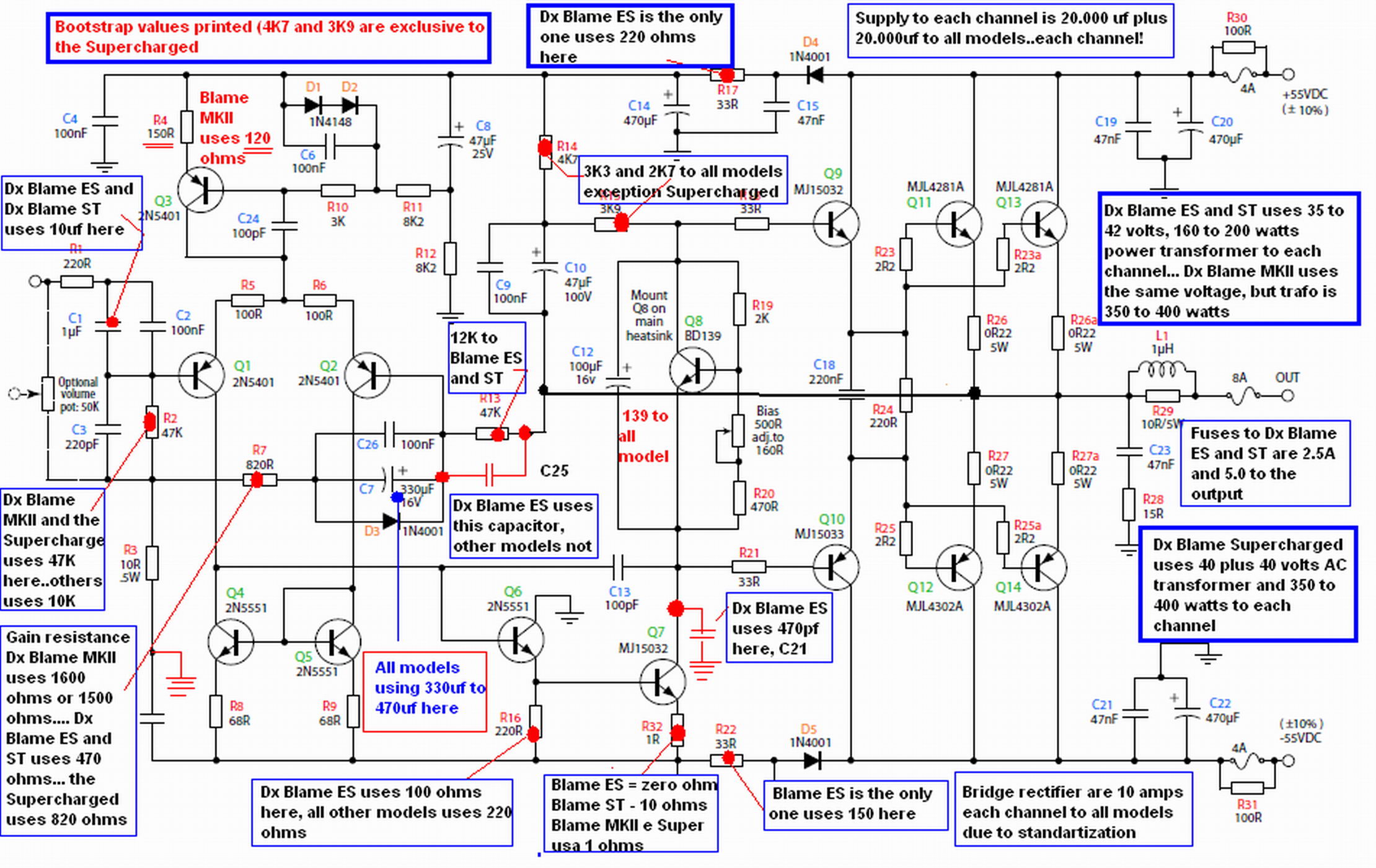

Dear Friends...here you have the Dx Blame MKII Supercharged
and the board.
I will soon explain you in details..but you can be watching the schematic and the board and you will understand the basic things.
First.......... schematic is the same..amplifier is the same... sonics is the same..quality is the same..distortion is the same.... power is different
Second....the Supercharged is a 200 watts rms / 4 ohms power amplifier
third...the Dx Blame MKII is a 180 watts amplifier to 3 ohms loads....so....will be good to difficult and low impedance speakers.
You see some parts in the board without value..these are the parts will be replaced depending the model you will assemble.
The board is good for:
Dx Blame ES
Dx Blame ST
Dx Blame MKII
Have only to replace some parts...transistors are the same to all models..yes...all models.
The first three models use 35 o 42 volts supplies
Soon you gonna have more details..also soon you gonna have a group buy to be organized by Mitchel that promissed to do that.
Soon you gonna have black and white layout to allow you to etch your boards at home..not only to Toner transference method, but also to the photographic method to layout image transference to copper boards.
Boards will go with xerox showing part numbers....pdf also will be published...a chart will explain the different parts that belongs to each model in special
So... we are starting to release informations....i will produce texts, also videos explaining the differences..but schematic and board shows things clear.

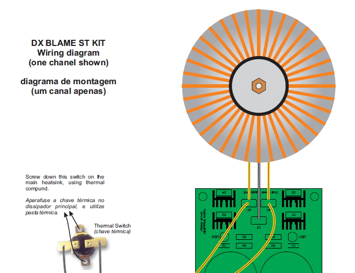

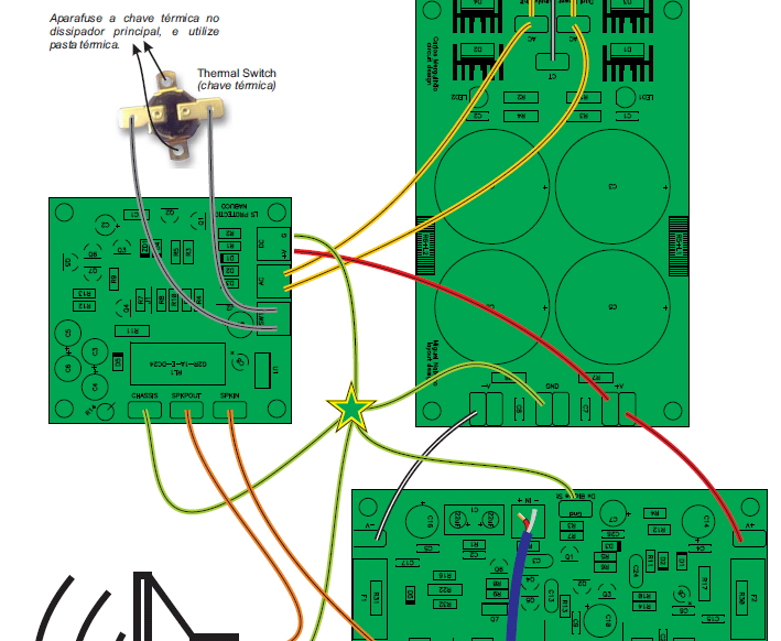

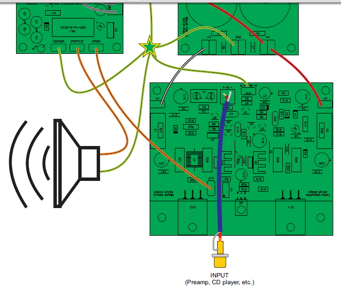

The speaker protector board
I am uploading an audio with images to Youtube explaining you some details.
soon it will appear in the signature..down the post.
attached the protector and once again the Dx Blame MKII Supercharged schematic.
Observe was already published the chart...there you have the parts that should be substituted, or replaced, depending the model you decide to build.
regards,
Carlos
