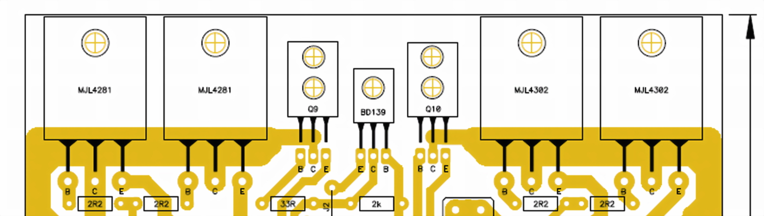

Boards are ready to go...layout is ready..also tests are doing fine
So, no troubles to the release in December, 24th.
I had to take some decisions:
First was one board to all models.... Dx Blame ES/ST, Dx Blame MKII and Dx Blame MKII Supercharged.
Second, silk screen forced me to use a standard transistor to all models, so, at the silk screen we have 2N5401 and 2N5551 indications...but people can use BC546/556 (suggested) in the place of the high voltage ones, just inverting the way they will go to the board.... silk screen indicates 2N5401 and 2N5551, and these ones works too...it will be up to you folks, the ones to use.
Dx Blame ES/ST and Dx Blame MKII uses 35 volts (42 volts maximum)..the Dx Blame MKII Supercharged will use higher voltage...maybe 55 or 63..i am still thinking about and testing options.
Almost all parts will have part numbers and also their values printed inside resistance rectangles (covered by the resistance after assembled), to make it easy and faster to assemble.... some parts are different to each model, and these ones, the different ones, will have part identification numbers and no values....values will be obtained from a chart that will be published the same day i will publish schematics, layout and the chart of part's substitution values.
I am showing you just the upper part.... i am very happy with this board..finally i could have a board that matches, entirelly, my needs... well... this is a natural progression.... i was waiting 7 years to have it my way..finally this one is "my way".
This one is 100 percent approved, i had not to negotiate, Mitchel made my way..... a matter of coincidence..... it is his way too... maybe cause we are both Brazilians..no troubles...he made with pleasure and had not to make violence with himself.

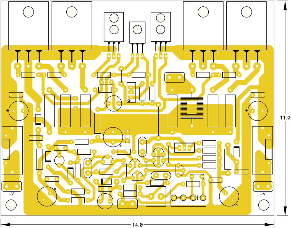

A needed tribute to Todd Johson, our TAJ, will be printed into the board
As all further layout developments started from his excellent work...so, despite some upgrades made, he deserves to be pointed as the pionner in this layout style.
regards,
Carlos

re post 28,
notice how close the supply rails come to each other at the collectors of Q9 & Q10.
This is where the HF decoupling should be placed. There is space between the transistors and traces on the top (or links if single sided) will pass across the other traces. Or use the empty part of the PCB under the legs of the bd139 Vbe multiplier for a bottom side trace.
The biggest problem left is the long distance ~90mm to the nearest point on the Power Ground.
Hi Andrew. We could just solder one end of a 100nF capacitor directly over the colector terminal of Q9, and have the other end wired to ground. THe same procedure should be done to Q10. I don't think there's space to have this capacitors on the board, because it's single sided.

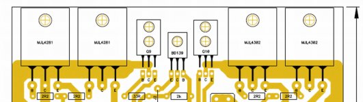

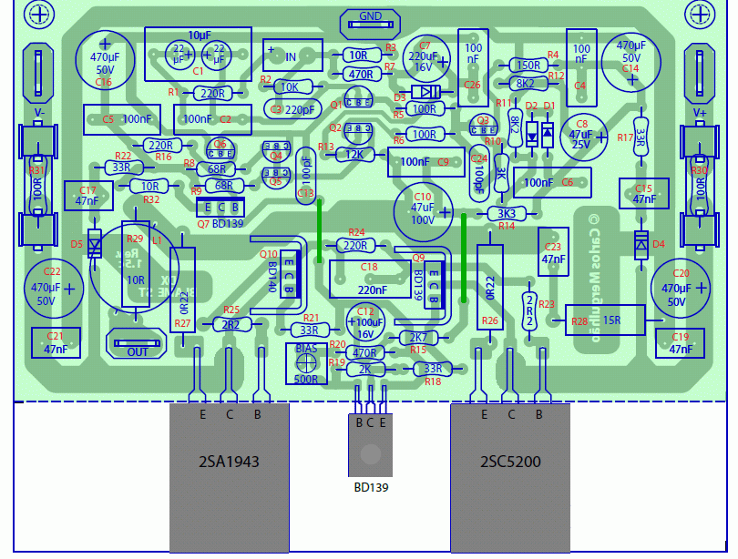

We have arranged, me and Mitchel, another board style, more rational in my point of
view.... more modern and more simple... we have detached the board assemblage from a computer screen (part's list) or a piece of paper (BOM).
I do think...and i always had that idea, that is not very good to have a part list and to print R1 (for instance...means Rx) in the board...this will be helpfull while debugging...but really, nice amplifiers, assembled without mistakes, will never ask by debugging, and they are turning more and more rarities....but, anyway, we need a reference number, not to be saying:
- "search that transistor that is over the BD139 and below the XXXX transistor, that MJExxxx, positioned left low board side."
Of course, it is much better, and easier, to say....
- "search for Q12"
So, we need that stuff, but we do not need, in a mandatory way, these indications to be printed over the board as silk screen.... we can have an image, a xerox copy, a printed copy, a word doc, a pdf or something alike to be used "if needed"..... so...board will have this companion, xerox copy will go together and will be helpfull if you face troubles.... when to search for mistakes.
But the values are needed and detach you to be in front of the computer, let you free from copies, pdf, word docs and so on.... printing values over the board, as silk screen, not only they will be covered by the resistance (as an example) but will be needed for you to select parts and to populate your board....the resistance value can be printed inside the rectangle that indicates resistance....so... you see that Dx people use to engage brain and not go following old rules without think about if the old style is good, if no good..when it is good and when and where it is no good.
This way, values, indications of parts alike 2N5401, 2uf, 100n, 220p...all this will be seen in our board.... because we have no transistor 2N5401 with Q1 printed on it..also we have no 100n capacitor printed C23 on it!... so... we are removing unnecessary non sense steps in the procedure.
Parts that have not fixed value, for instance. VAS emitter resistance, that has one different value to each model.... this one and some others will have part number indications, as people will use a chart to select it because each model will have their proper values...this way, a single board, that can be good for 4 models.
So...this way there's no "Supercharged board"..no "Blame ST board," no "Blame MKII board"...we gonna have "Blame board"
This is something i always wanted to do. but i always have faced oposition from friends that where producing layout..... now i got it..finally.
I do not know how to use Eagle, also i do not want to learn...i do prefere other doing that...i am better to do amplifiers.... and it is better to each one of us to be doing what we know how to do.
There are folks that feel happy doing layout..when i hate to do that...make sense them to make and to obtain pleasure then uncle charlie to be upset with that stuff.
So, as you can see in the image attached below, we gonna have few indications printed over the board as silk screen.... the Designer name, the Layout reviser name, the Layout original designer name and models the board can be used to..... parts will cover the indications...board will not look alike an outdoor, will have class and elegance.
regards,
Carlos

taj
diyAudio Member
Joined 2005
Did you mean to type?
Yes, I think he meant 55V actually for that last one, Andrew.
Also, I'm not clear on which transistors are Q9 and 10 you were talking about -- the drivers next to the output transistors? And the power ground is 90mm from what? Can you clarify that last bit? Thanks. Just curious.
Carlos, I appreciate the tribute, but this gold layout is much different/improved over my green one. Putting my name on it seems a little uncomfortable to me. Mitchel's name should be on it.
..Todd
