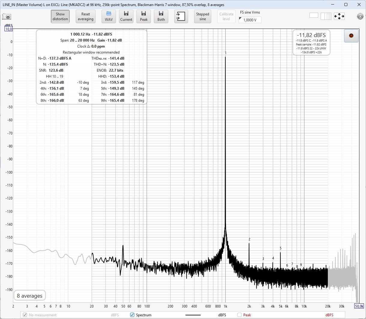

What in that measurement is proof? Does your DAC have lower noise & distortion or noise shaping with less higher order artifacts above 40kHz?
Here is the same 96kHz measurement but through Cosmos APU notch so setup is close to ASR AP measurements.

So these types of inexpensive Chinese dacs will sound mediocre with pcm and best used with hqplayer dsd and the associated hardware. The overall costs go up … and how does this approach sit the rest? Btw Asus has sort of taken over the NUC business and looking like >1k USD for a decent gear 😮
How do you end up with this claim? I see nothing mediocre in the above PCM measurements. And even the pricier DACs using ES9039PRO or AK4499 not to mention R2R are not any better.So these types of inexpensive Chinese dac will sound mediocre with pcm and best used with hqplayer dsd and the associated hardware.
