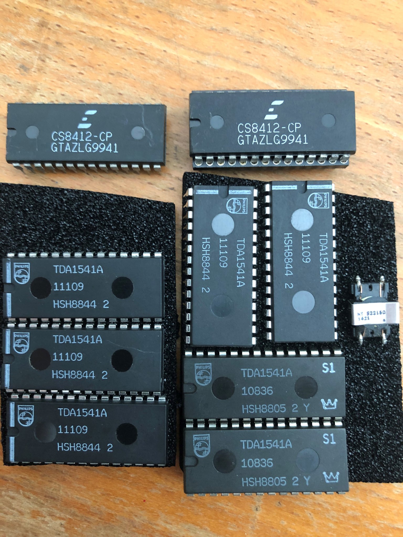

I am actually thinking of making Pedja's NOS DAC again (I still have a brand new PCB for it), with TDA1541S1. That was simply beautiful sounding DAC, especially with Audiomeca Mephisto CD transport... the best analog sound I ever had in my home (some 20+ years ago). Not super detailed, not super extended, not able to play 1.536MHz PCM / 1024 DSD... but ohhh so enjoyable. The other day I looked for TDA1541 info to figure out how I'm gonna feed it a digital signal these days... and realised that a plain TDA1541 chip goes for 400 dollars... insane. S2 goes for a cool 1000 bucks. Here's my stash, the very good Schott pulse transformer included 🙂. Ahh, that brings memories... of a great man I learned so much from - Jocko Homo, God rest his soul.

Extreme_Boky , this might be a better investment than stock market!

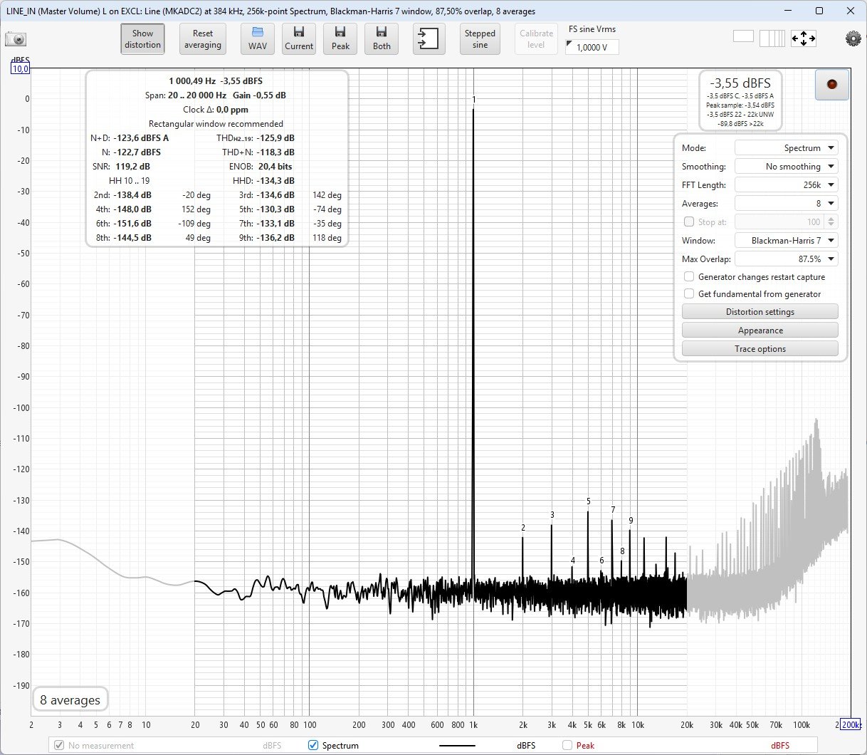

AK4499EX+AK4191 works ok but not great with DSD up to DSD512 (haven't tried DSD1024) when DS modulator is used (i.e. no volume bypass). With volume bypass DSD512 (even DSD256) needs higher BCK which adds noise. ESS dacs typically have much lower high-order harmonics with DSD albeit slightly higher noise. E.g. ES9039Q2M works best at DSD512.there are no sq problems playing dsd on my AKM dacs, current reference at dsd256. Looking at ways to tweak for even higher performance.
Overall performance with DSD on both AKM and ESS dacs is dependent on the DS modulator. HQPlayer is an easy way to test that.

Apart from performing the PCM measurements at only 96kHz instead of something much higher, all you are doing is showing how a perfectly capable PCM stream can produce mediocre results if inadequately fed to an incorrect DAC IC for the job.
In what sense? Can you show how your device performs?mediocre results

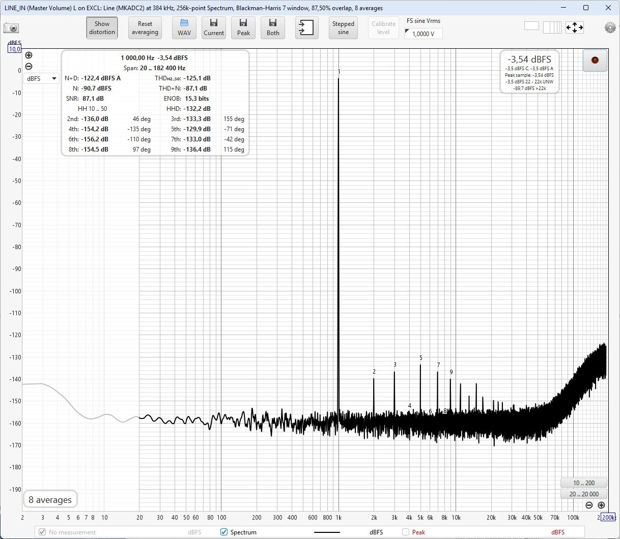

Here is 384k PCM. No difference.
That is proof you are using the wrong DAC for the job.
I mentioned that DAC with regard to DSD... not PCM.
