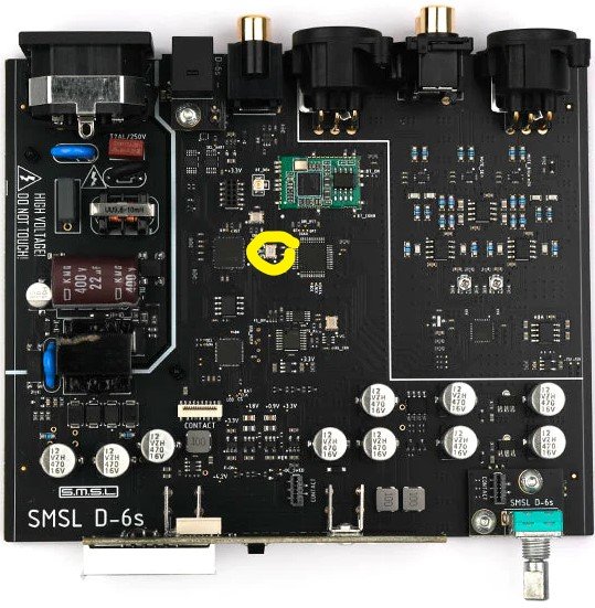

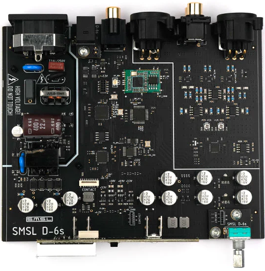

Interesting to look at board in good resolution. It seems to me that this brand uses the same scheme in all devices. Judging by the photo from the internet (in poor quality though) the same system as in the SU-1, without independent audio oscillators, the same SPDIF transceiver and a IC clock-generator MCLK.

this one?Interesting to look at board in good resolution. It seems to me that this brand uses the same scheme in all devices. Judging by the photo from the internet (in poor quality though) the same system as in the SU-1, without independent audio oscillators, the same SPDIF transceiver and a IC clock-generator MCLK.
Yes, 1:1 SU-1. All the digital part of device till I2S output to ESS is the same. Added bluetooth, internal smps and another DAC and output stage. Sounds good ?this one?

Ok thanks, just like what’s on the WIMM Ultra A98 module, to keep costs down … how cleverIn SU-1 that generator IC does any MCLK, it changes between 45/49MHz. Perhaps here too

And I suppose that your SPDIF content could sound much better, if here soldered usual cheap resonator 24.576Mhz.
