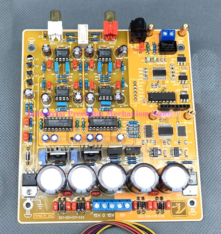

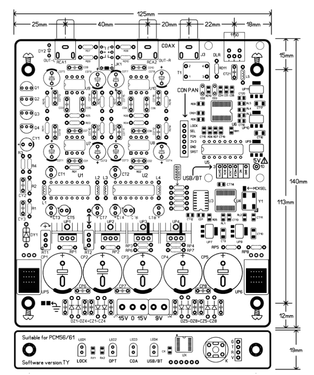

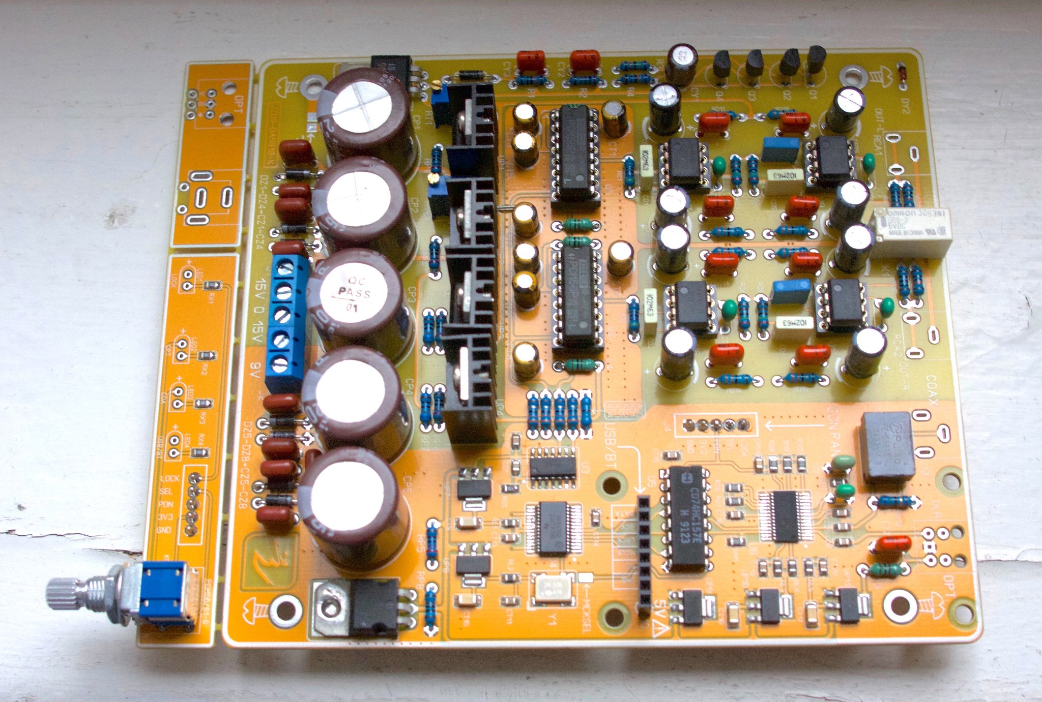

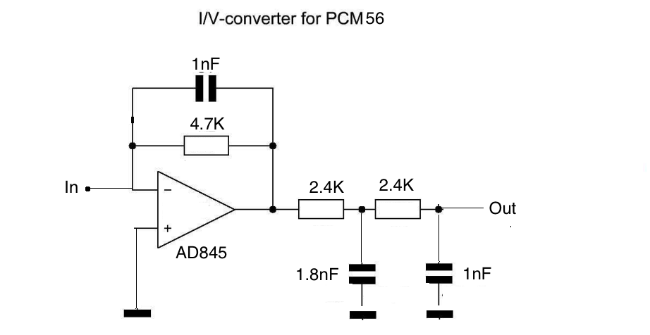

Returning to the subject of Chinese DACs, they are not just the current SMSL/Topping types. There are several legacy multibit boards available that you can add power supplies and cases to, and in most instances a USB/SPDIF converter. I use a PCM56 board that I'm happy with after modifying the I/V stage and using an AD797. There's still a lot of mileage in using these legacy chips, especially the PCM56 which isn't too scarce or expensive. I've posted on this a few times in different threads.

I want to build one or two fairly simple multi-bit DACs with cheap and available legacy chips, which right now looks like PCM56 or AD1865. All the TDA1541 and PCM63 type stuff has got rare and expensive now.
So point me towards some PCBs or built boards that can be used with PCM56 or AS1865. There seem to be quite a few on AliExpress and I'd welcome advice on which are good ones to buy. Input could be SPDIF or a I2S board.
I can build with tubes so could add a tube output stage and I can build power supplies. But useless with SMDs, that's not possible so a built board would be best...

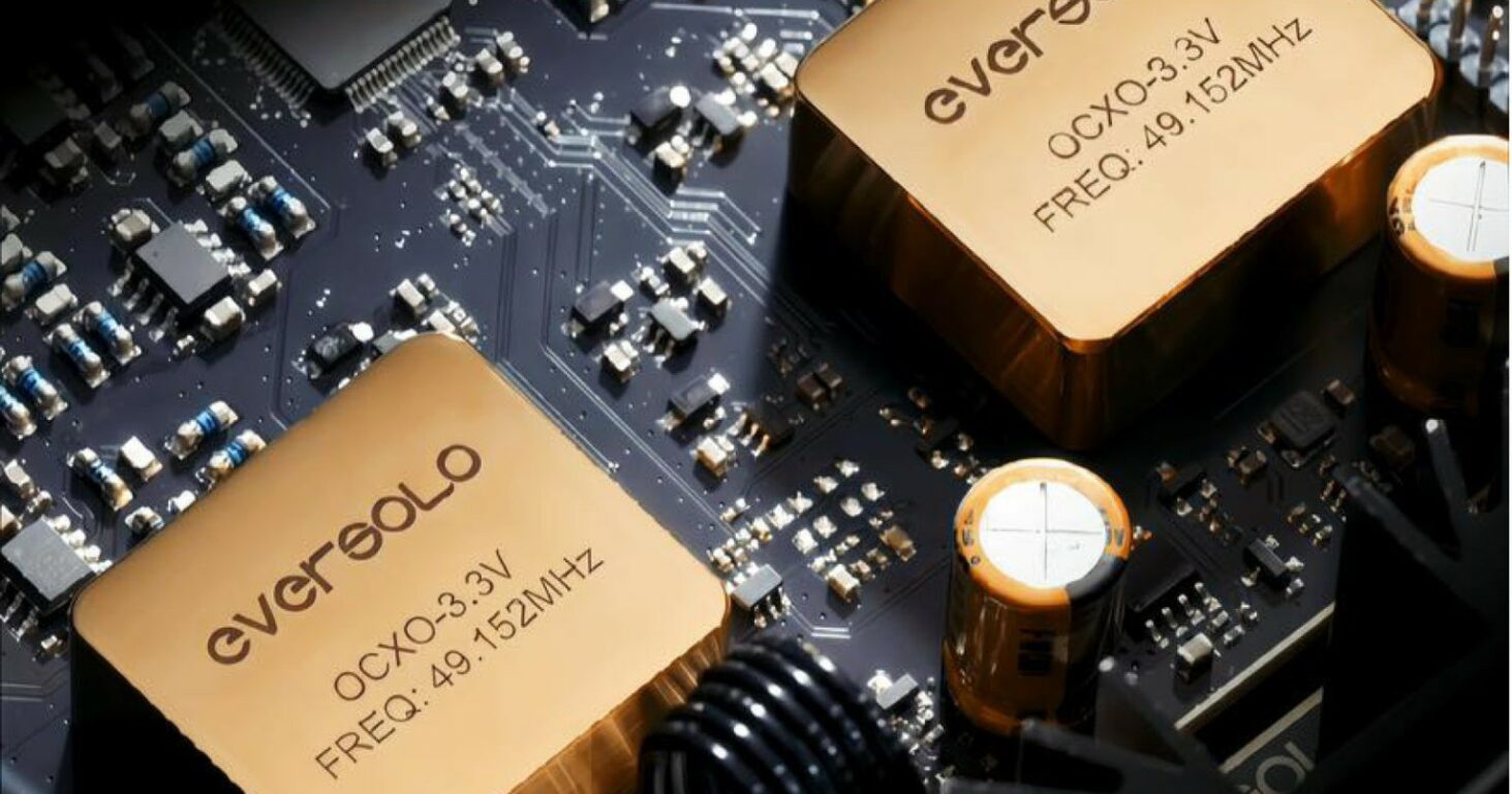

As soon as they start improving their DACs and clocks the price goes up. See how previous market leaders Eversolo DMP streamers progressed …Using them as bridges to the DACs, so their DACs are not crucial...
DAC part looks pretty straightforward to improve but for the A98 core unit getting proper audio clocks in requires possibly an entirely new design. Of course for those with good external DACs/Clocks nothing of these new models matters🙂
I think there are two different Fs ones in the actual product, just promotional material or simply to confuse the ‘enemies’😁
