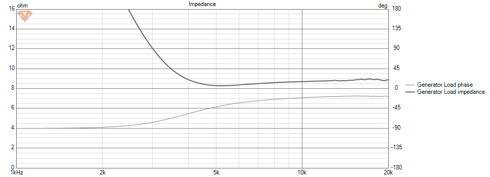

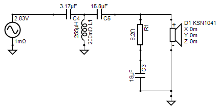

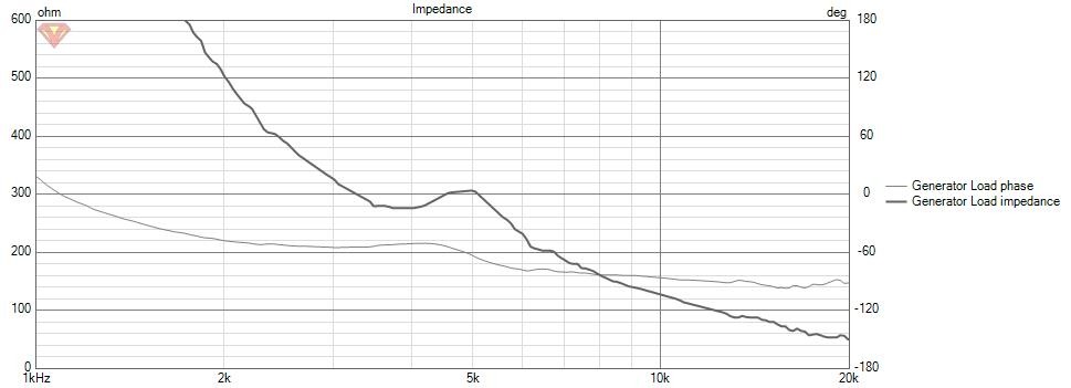

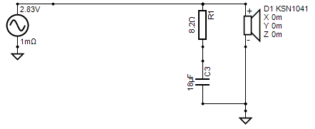

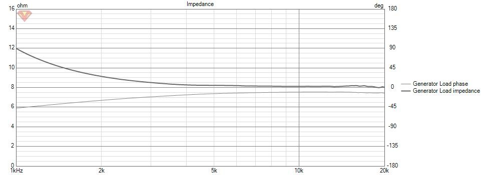

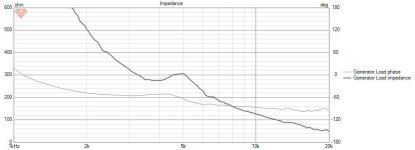

Impedance curve of classic Motorola KSN1041
From about 2k be little different than usual , 600 ohms to around 50 ohms
Drop in 8 ohm Zobel around 10 to 18uf to start curve around 2k
Bing...Straight line 8 ohms

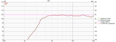

Drop in 3rd order 5k crossover

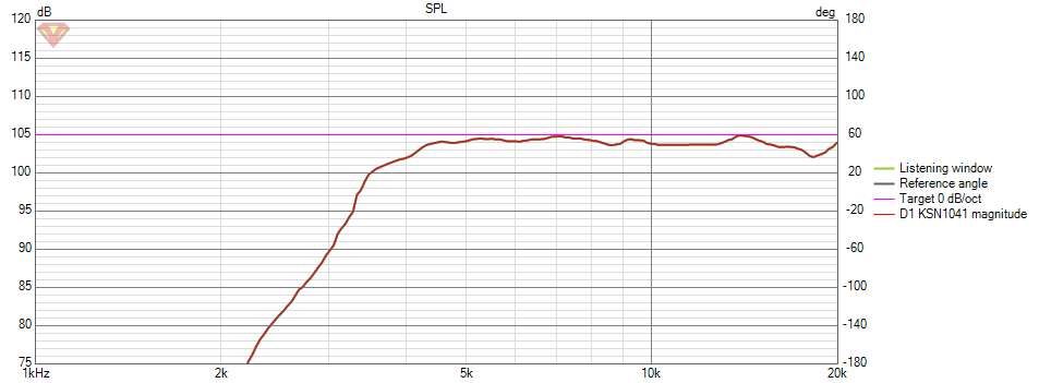

Of course the FRD comes from old Motorola Datasheet
with gracious amounts of smoothing. But that is basic 5k super tweet
Impedance data is important if you add padding, the Zobel needs
fine tuning. All rather simple.
You just cant use conventional crossovers without Zobel
no transformer needed.
View attachment 1224127View attachment 1224128
View attachment 1224133View attachment 1224134

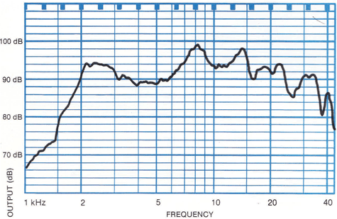

Without smooting...some from internet.

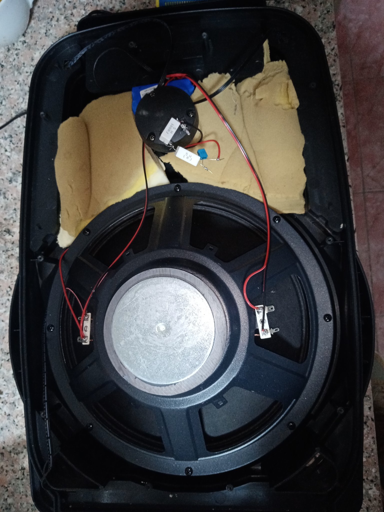

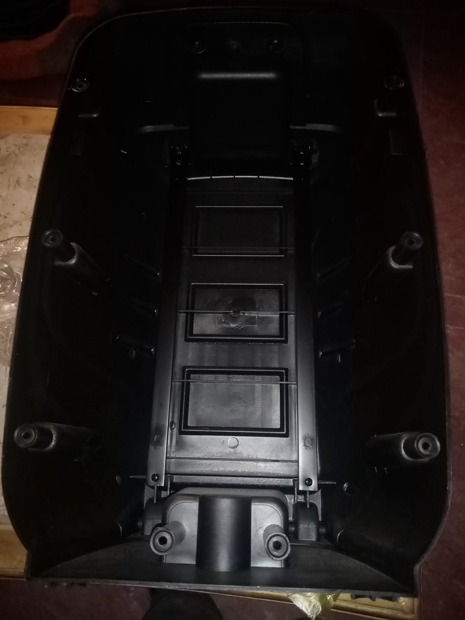

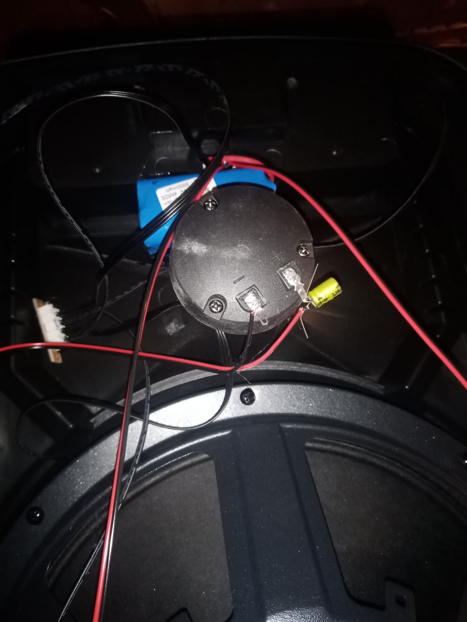

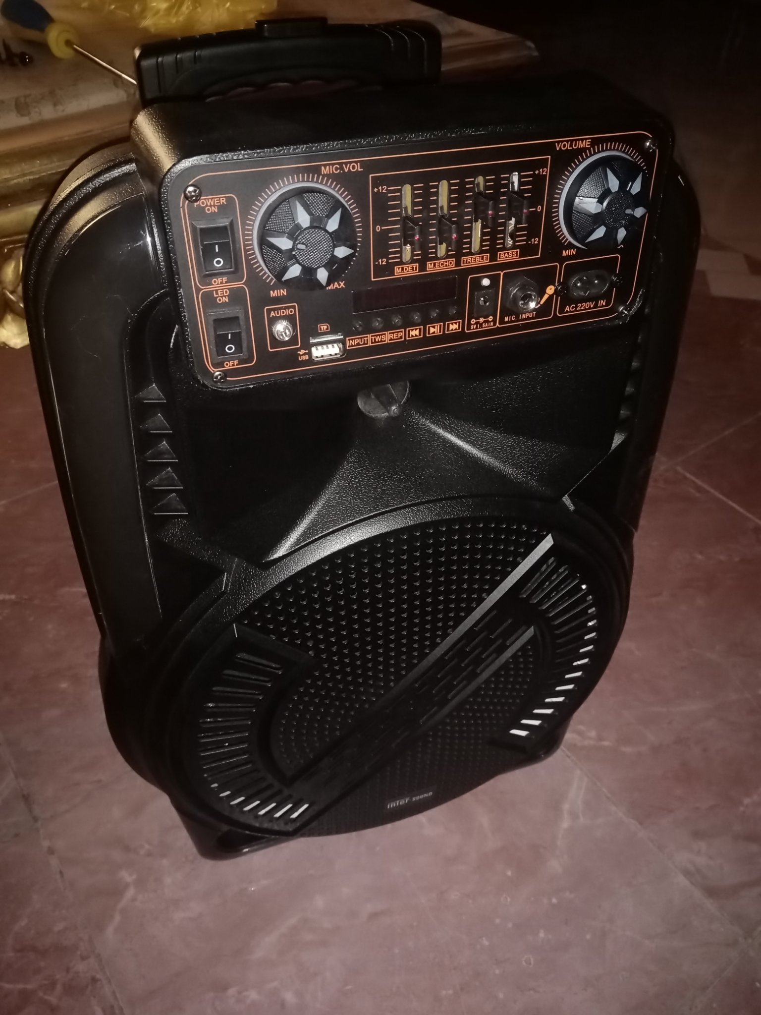

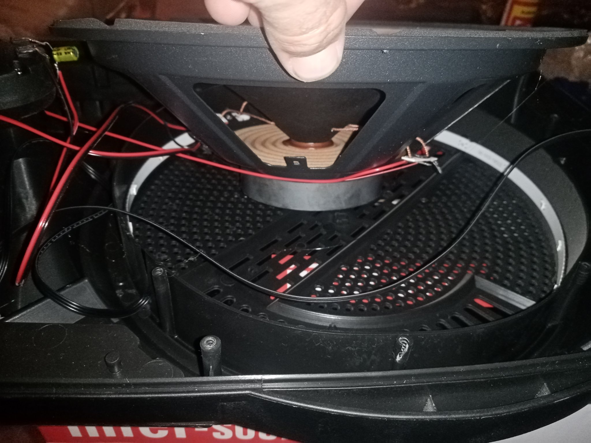

Portable bluetooth box with piezo which deserves attention.
Original is 2.2uF in line nothing else.
Will get some resistor from plus to minus and checking polarity.

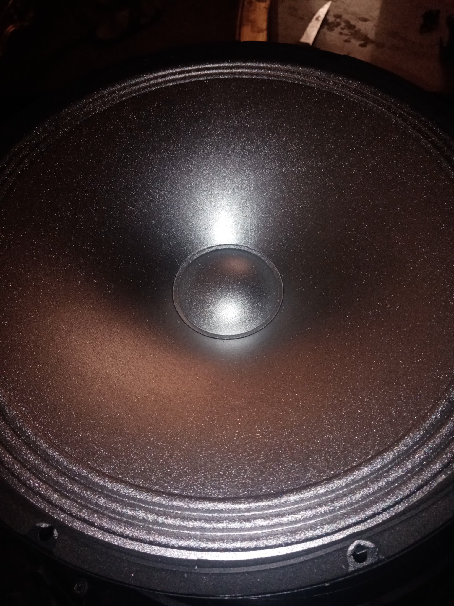

Box got damping (had none) and the paper cone some aluminium treatment

this piezo tweeter sounds originally horrible came drastically obvious after cone and box treatment.
tweeter is wired with same polarity I am sceptic this is correct.
Measurement will show if there is a cancellation between both drivers

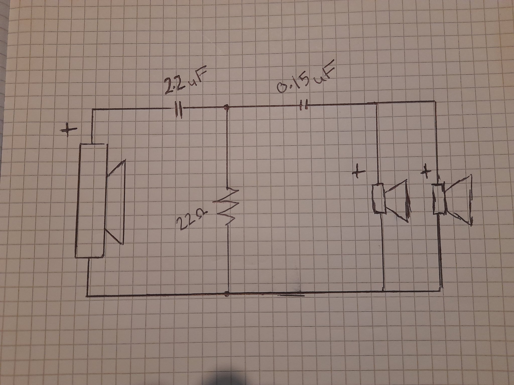

put 8 ohms in parallel to the piezo between plus and minus and 2.2 microfarad in line before it.
Make that 22 ohm in parallel.
The RC circuit will attenuate the low frequency voltages thus reducing the risk of overloading the piezo and producing distortion.
A suitable crossover and high frequency attenuation arrangement for a small piezo, or parallel combination of small piezos, is shown in the attachment.
It comprises a 2.2 uF series crossover cap, then a 22 ohm shunt from hot to ground, then an optional series cap of about 0.15 uF for 6 dB attenuation.

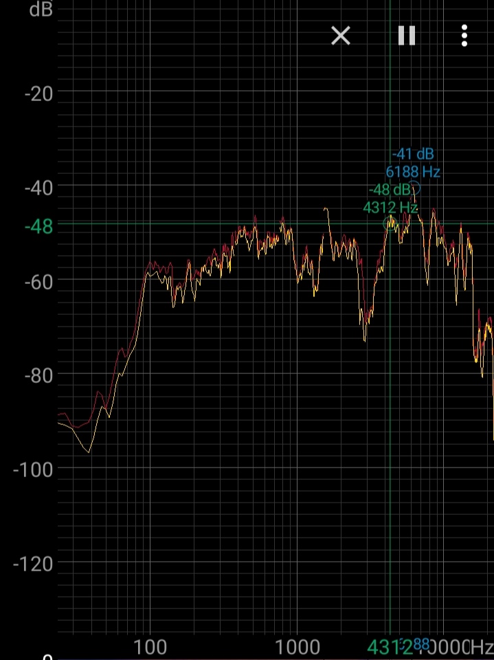

update to post 29 in this thread.
The piezo tweeter must be reversed there is a suckout at 3khz. Will report when turning its phase if it gets more linear.
box 25cm measured between driver and tweeter
close to tweeter 5cm

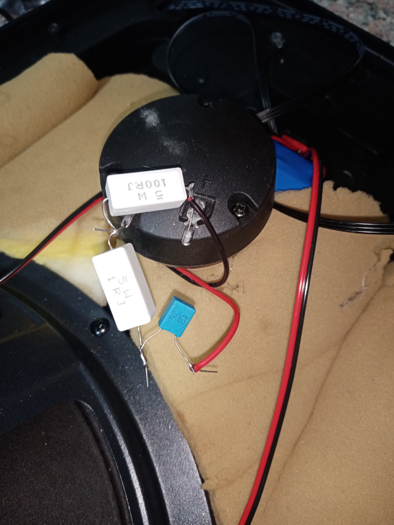

piezo tweeter with reversed phase gets even worse - returned to before again. Also listening test showed same phase sounds better.
Highs sound now acceptable with 1 ohm in line, 1uF in line and 100 ohms across plus and minus of the tweeter. Makes a big difference.
Added some thin damping to the inner side of the metal basket. This is also a very audible reduction in colouration but doesn't do anything obvious to the frequency response.
added some more damping to the box

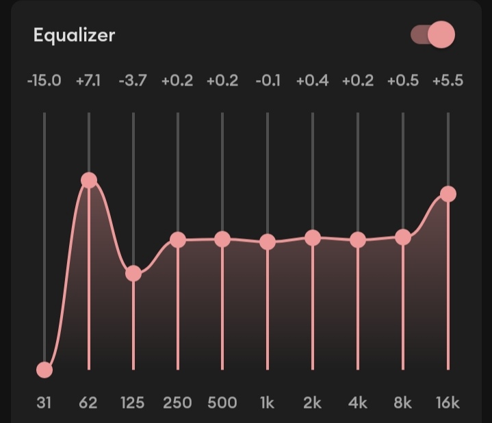

some EQ helps getting a more complete sound

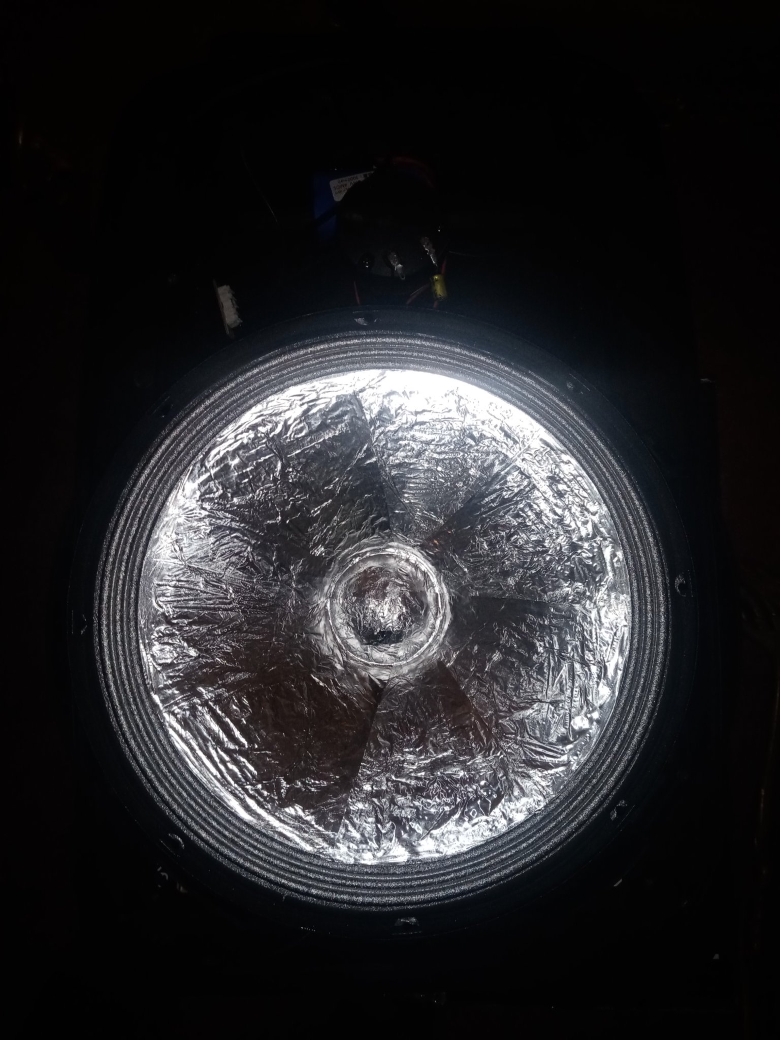

damping piezo tweeters with very fine damping material for free
covering the piezo paper cone with fine aluminium foil from the goldsmith
piezo tweeters with thin aluminium foil from the goldsmith

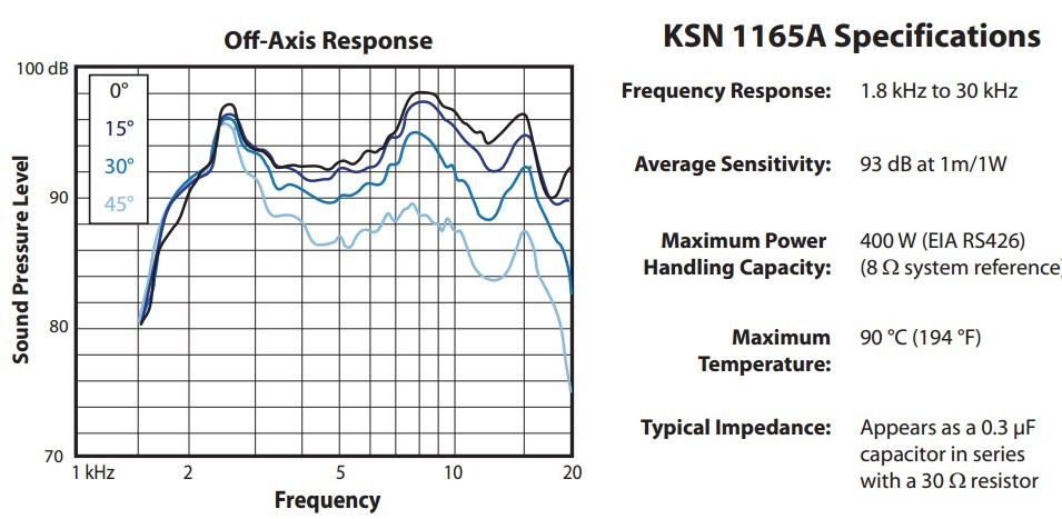

I just thought that 'for the record', I should correct this post >Since they present a pure capacitance as an impedance, the resistor actually acts like a cap would for a dynamic (magnet - coil) speaker. A resistor forms a high-pass filter when in series. It's sorta counterintuitive.
Because the natural impedance of a Piezo tweeter is that of nearly pure capacitance, series resistance actually creates a low-pass filter.
The higher the series resistance, the more the 'top-end' roles off.
Adding series capacitance creates a broard-band level reduction. The lower the series capacitance > the more level reduction is increased.
For a series capacitor to act as a high-pass filter, resistance has to be added across the Piezo terminals.
The lower the resistance added across the terminals > the more the Piezo's impedance changes away from being capacitive AND the more
a series capacitor acts as a high-pass filter.

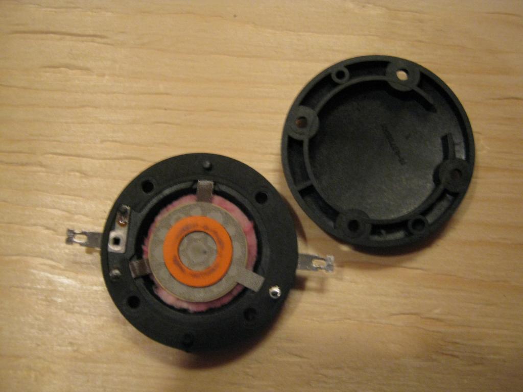

nice pictures of original Motorola tweeter ksn1025a
https://www.audioheritage.org/vbulletin/showthread.php?40987-The-piezo-fun-box/page2
just to learn what piezo construction was like in former times
