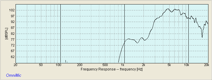

Try making a frequency response measurement of the piezo. The cheap ones with plastic horn which I tried, had a terrible resonance at 5 kHz.

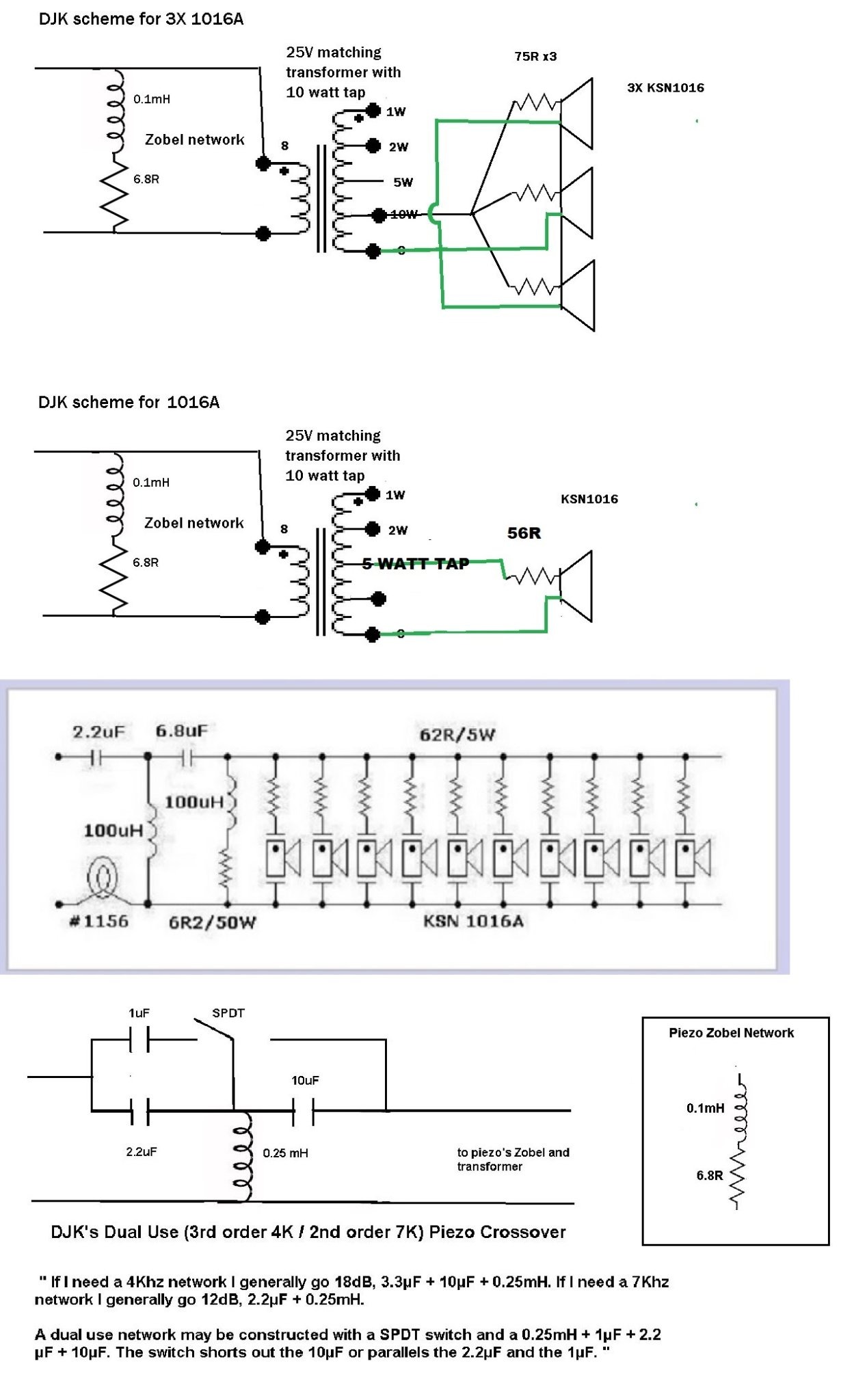

with one KSN1016 (original) and stepup transformer I got ~103dB @2.83v input and 1/10 of one percent distortion.
Here''s some application notes from the late and great "DJK" (Dennis
Kleitsch)
Kleitsch)

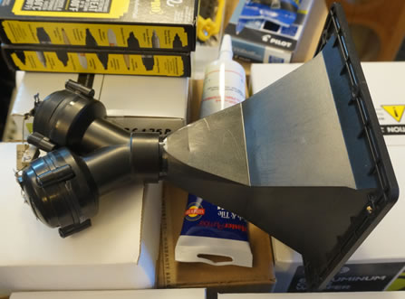

Here's a Peavey Piezo CDM horn that's used in many of their speakers.
If I'm not mistaken, the resistor is 50 ohms.

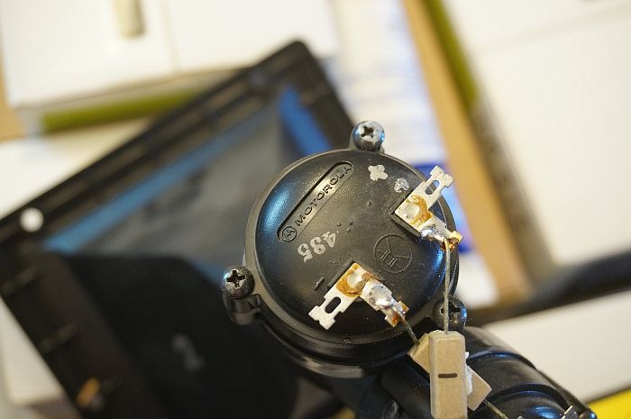

The piezos are Motorola. The cheap ones are very jagged in their response.
I would avoid them.
I would avoid them.
