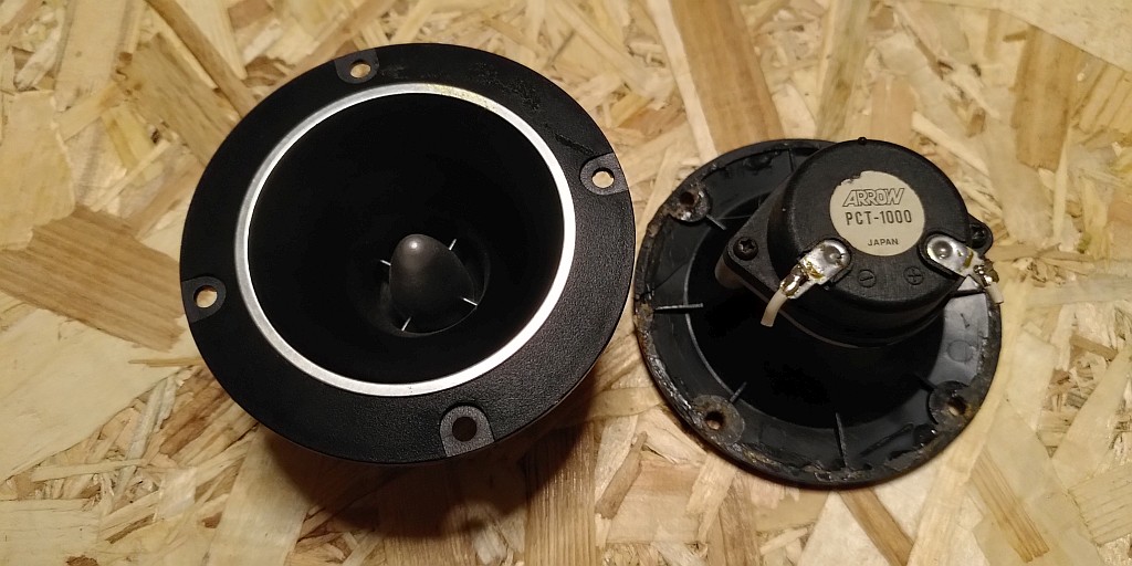

Are Piezo Tweeters frowned upon?
I did a similar thing as @Freedom666 ,but used acrylic model paint instead of tinfoil. I think the important thing is to add damping behind the cone. I used fiberglass which gave good results and took away some edginess. They are OK for pro sound where weight is a factor, and as others have said, they are good as super tweeters.

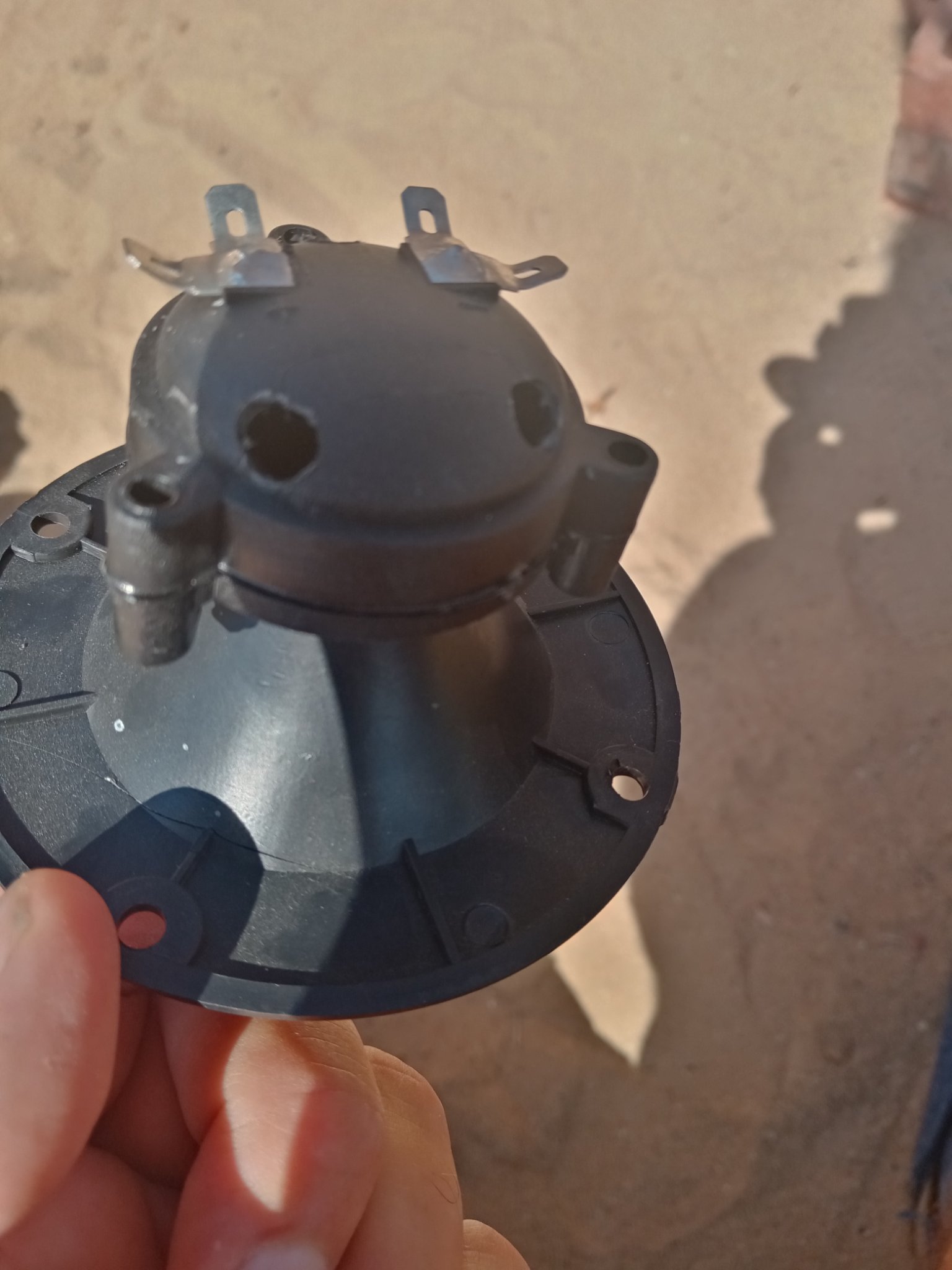

If you do not want to desolder a piezo disc to reach the back cavity of a piezo tweeter for damping it.
Putting holes in it worked out.
Very careful drilling and then stuffing with soft fibers from a drying machine.
Helps the sound alot.
closed it with silicone sealant

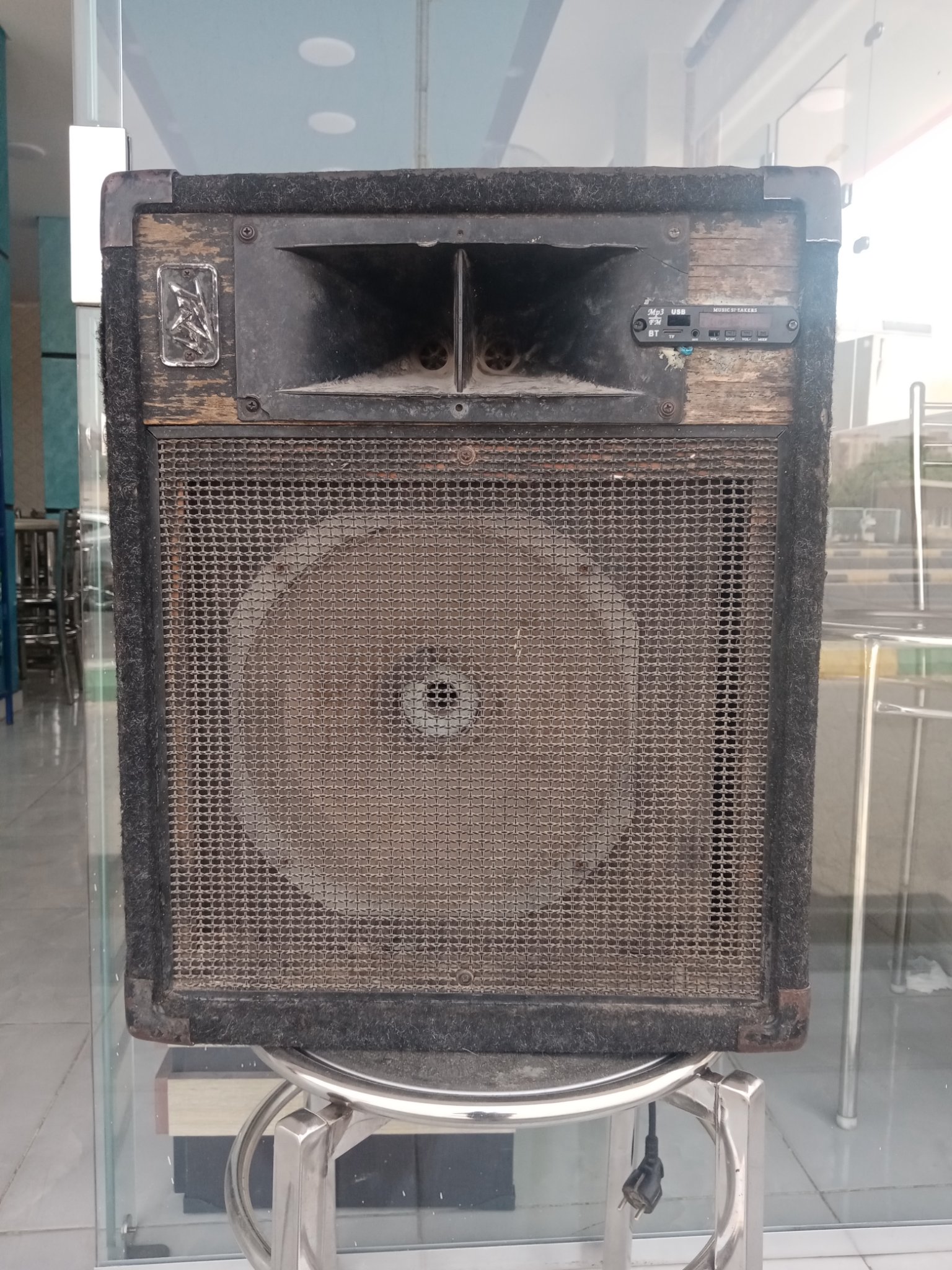

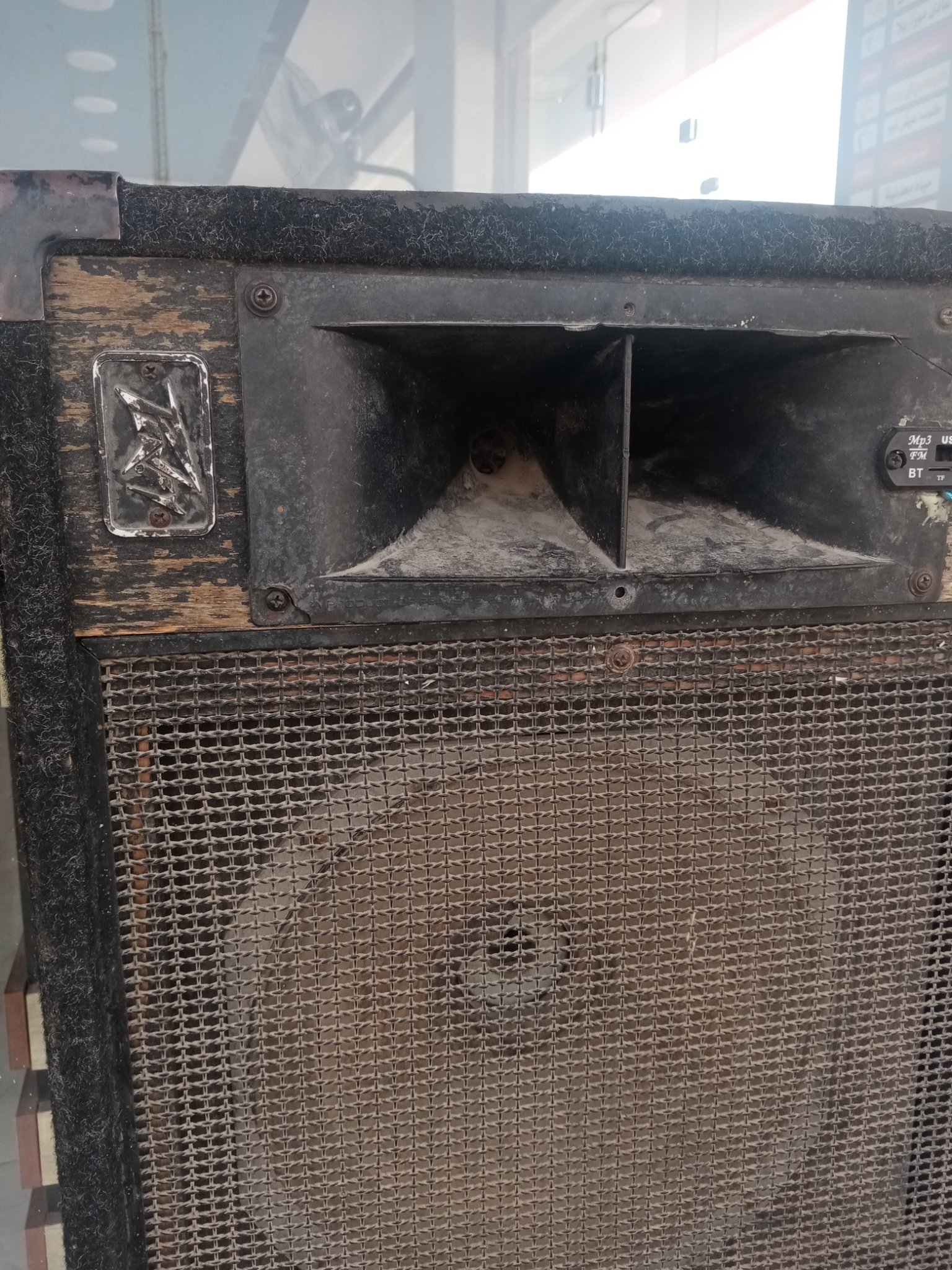

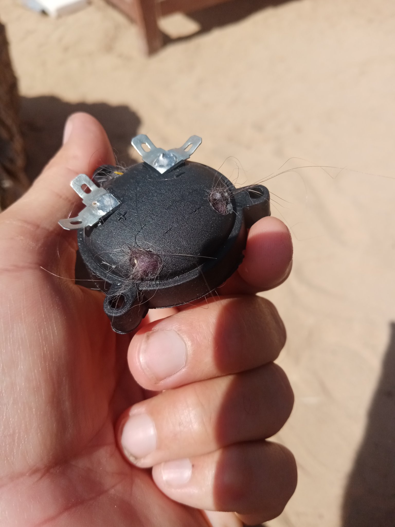

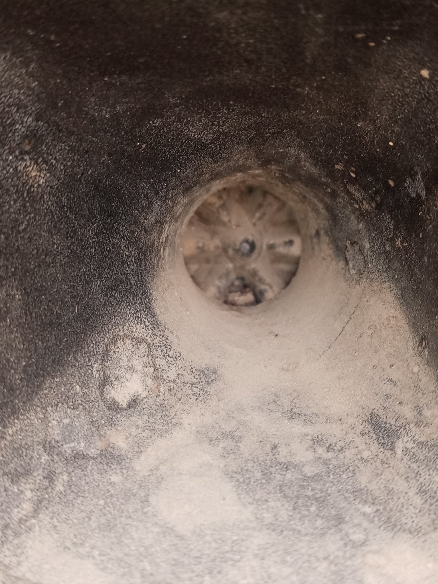

Dust is an enemy in desert regions.
Here the legendary Peavey double piezo horn covered in dust.
Foto from Safaga city, Egypt.

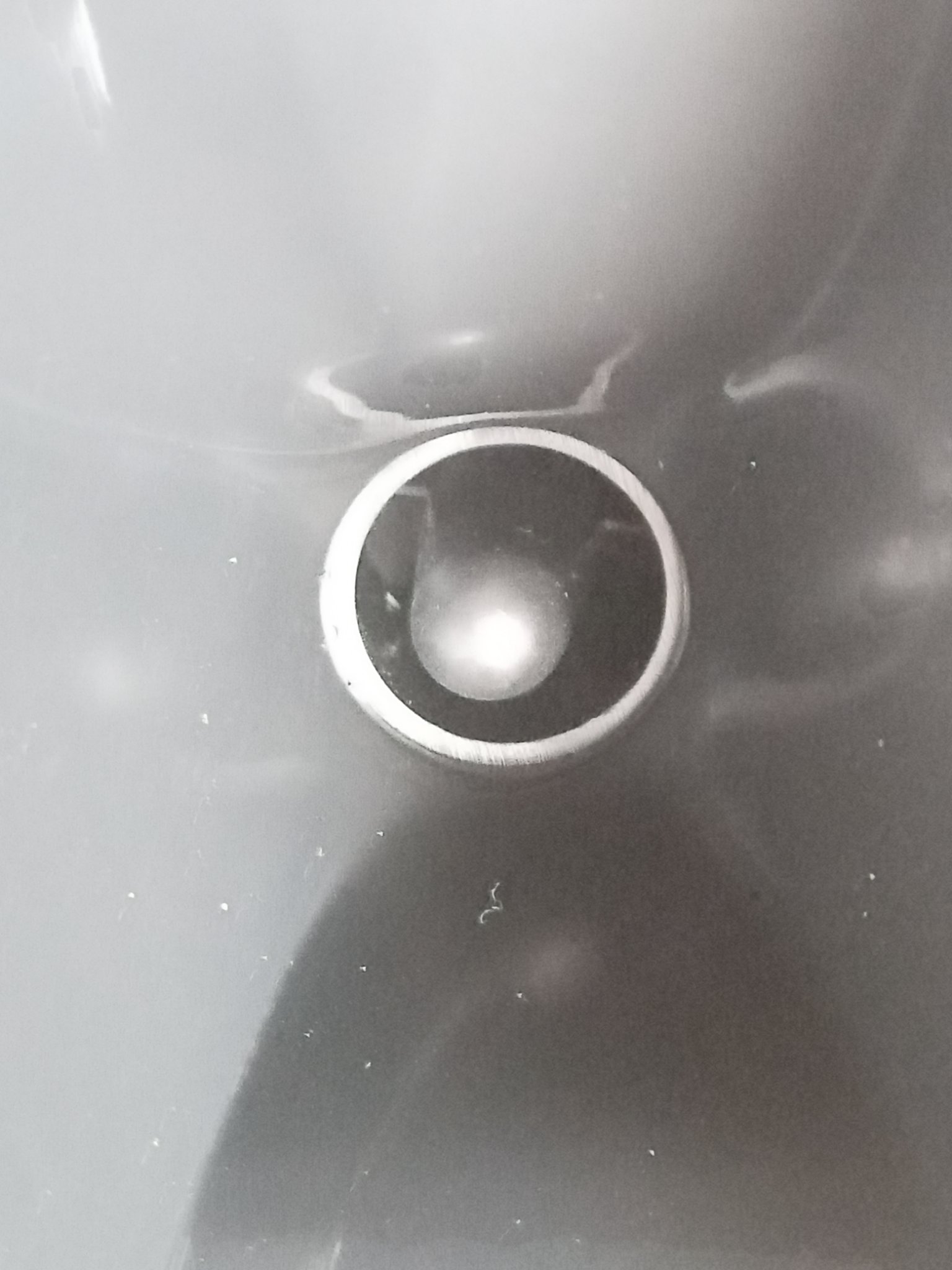

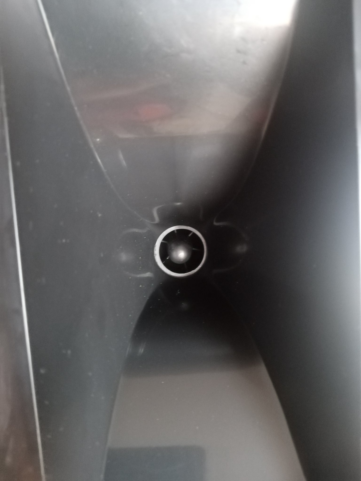

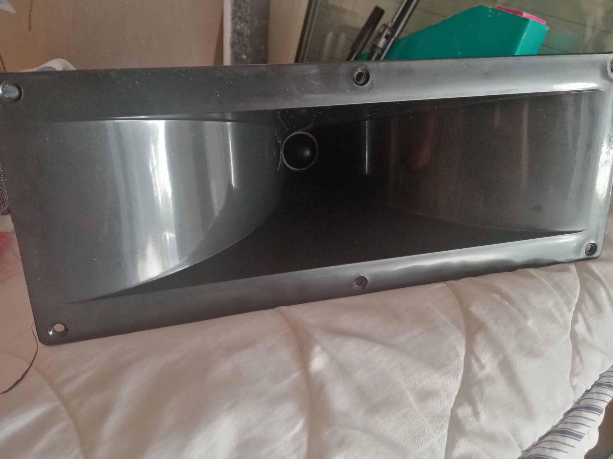

redone measurements in a smaller no name horn.
Here the piezo drivers fit better into the horn throat with only a small step (better than with the big HL-1018)

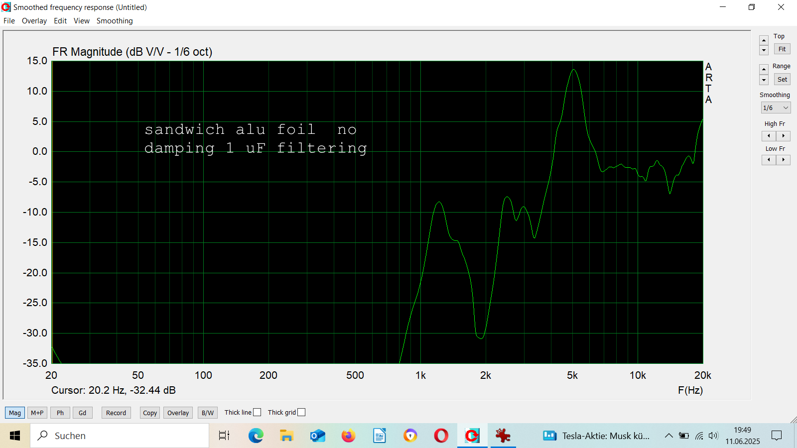

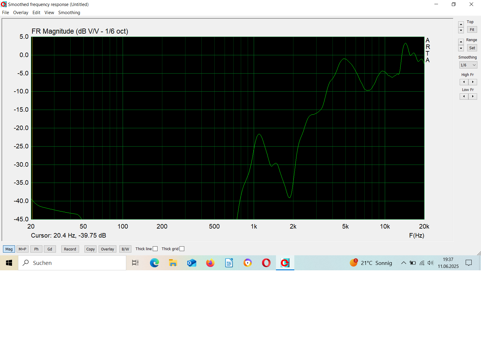

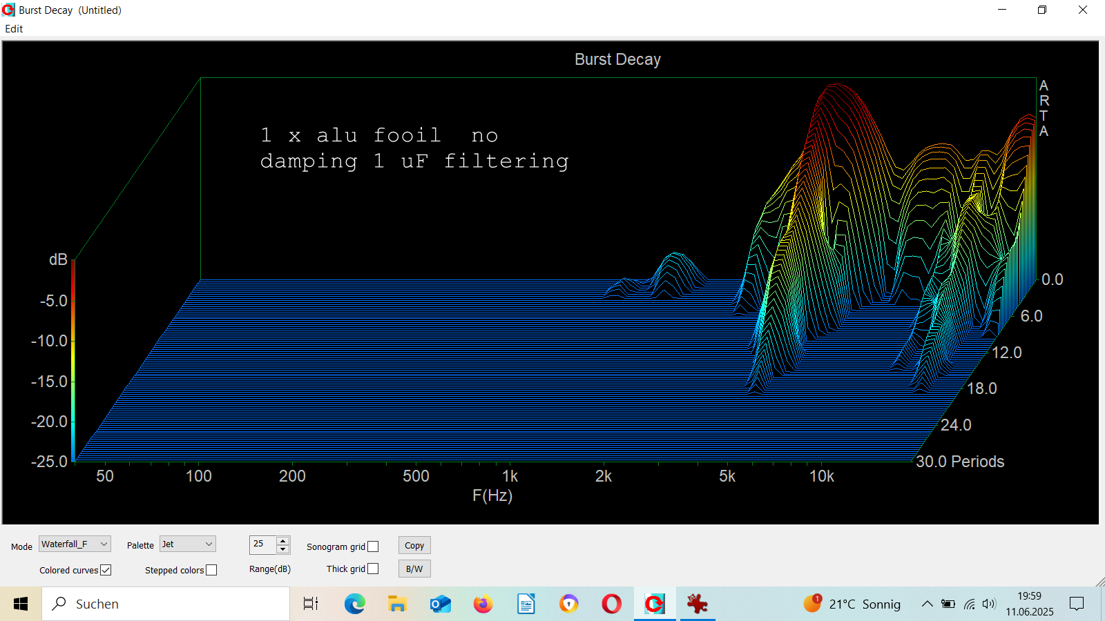

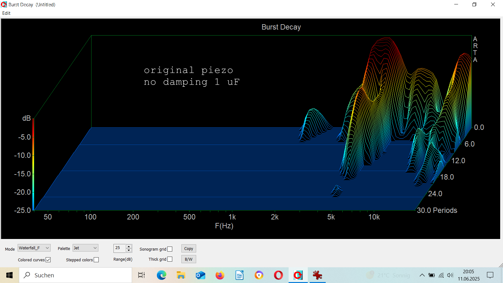

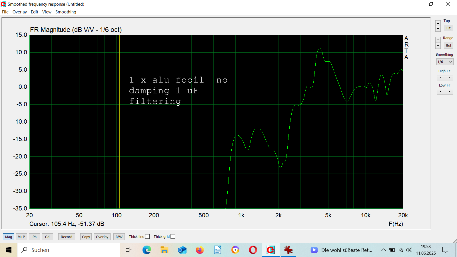

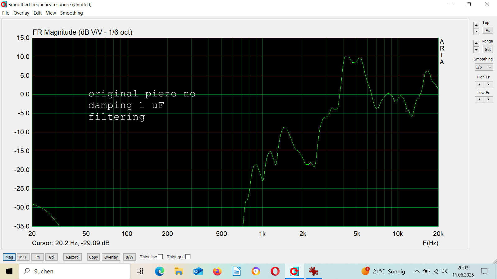

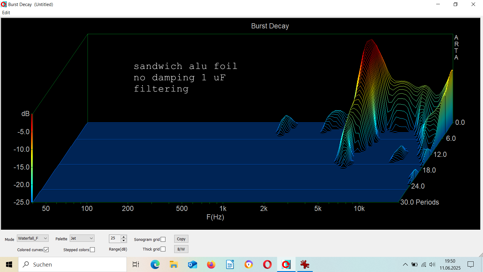

No name piezo drivers with 90 ohms across plus and minus, 12 ohm in series and 1uF in line (6db filtering).
Only the alu sandwiched and damped piezo drivers have 0.33uF but same resistances.
here original piezo with only filtering no alu foil, no damping

no name piezo driver with sandwich alu foil no damping 1uF filtering as described

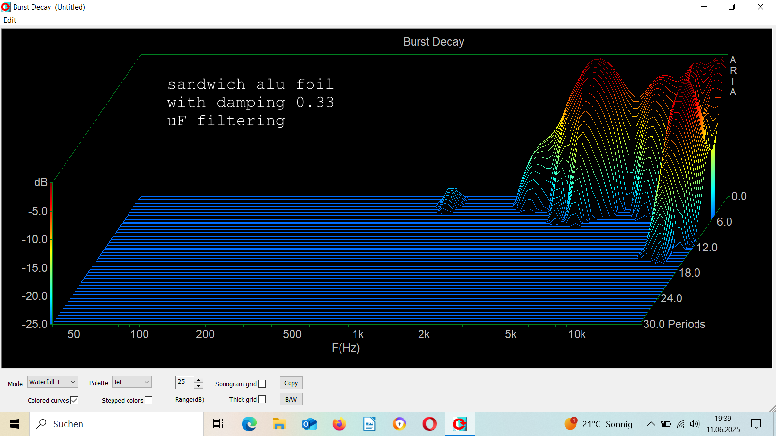

no name piezo driver sandwich foil and damping and 0.33uF filtering (instead of 1uF)
The better Monacor quality piezo driver did not fit into the horn - I could not screw to the end closing the gap in the throat.
I am pretty sure that better filtering and additional linearizing like described before in this thread is a way to go for better sound.
The measurement series were a test to see what happens if mechanical tweaks are applied.
Good frequency response was achieved with a quality piezo driver from Monacor and damping the back cavity and 6db filtering.
Here no typical "piezo tizz" was audible any more. This means that a pretty cheap driver can become much better. Also the typical "piezo attack" gives a lively and "fast" sound to transients.
Pretty possible that abundant stuffing of the piezo back cavity is good and acceptable for home hifi use but for PA use it might be that a heating up piezo disc might be a problem. But with 24 db filtering you are on the secure side!

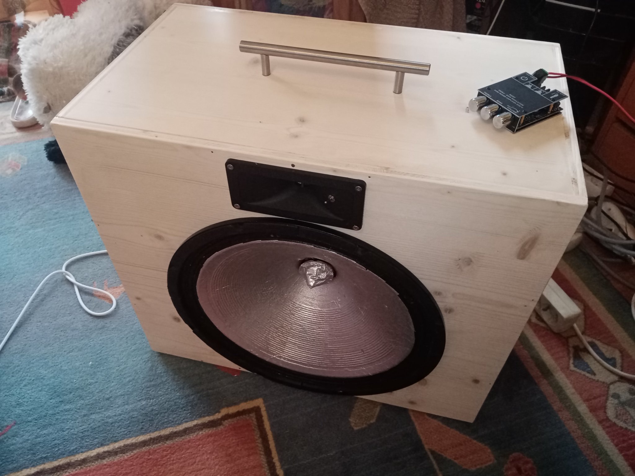

did you use only 24 db filtering when sliding down lower the crossover frequency? The resonance could be tamed / linearized with a parametric filter it is worth a try. However all these piezo drivers are not usable below 4khz properly due to small displacement. The bigger horns dont really help putting the lower frequencies up in response. Classic driver technology has its advantages as longer cone travel can be a design goal.
I enjoy a lot using 15 inch fullrange driver reaching up to 4khz and let the piezo do the rest. Works pretty well. Side piezo tweeter giving extra highs off the axis. Made them switchable just to hear how its like on and off.

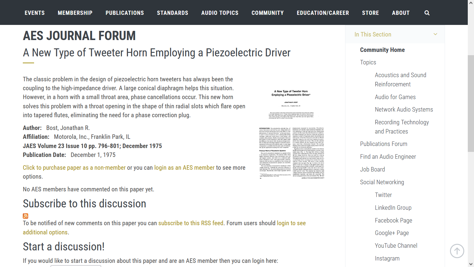

Ah, before asking I looked myself. There is some literature to be found and studied:
AES piezo electric super tweeter
AES new type of horn for piezo tweeters
https://secure.aes.org/forum/pubs/journal/?elib=2653
PVDF piezo tweeters
https://audioxpress.com/article/high-polymer-film-the-lost-speaker-technology-part-1
on Audioexpress dot com

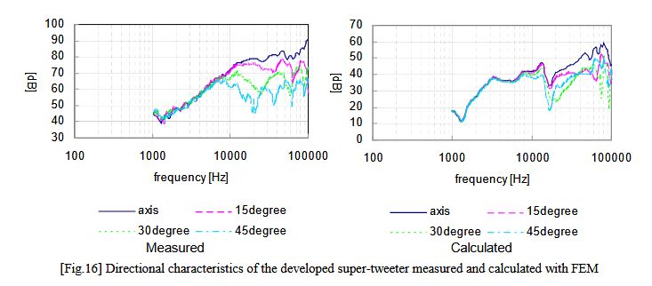

Reading the AES article from 2000 simple damping of the piezo disc will linearize its response.
Its worth trying some rubber or silicone selant applied to the piezo disc.
They used just the piezo disc as a sound source without a paper cone glued to it like in most piezo tweeters we analyzed.
Conclusion:
It has been reported that piezo-electric loudspeakers are not suitable for Hi-Fi audio products because of the effect
of sharp resonance on sound pressure frequency response. But we have investigated the use of a piezo-electric
element an ultrasonic vibrator, given its high potential for mass production. Additionally we have worked on
controlling its resonance.
The sharp resonance of a piezo-electric element can be optimally suppressed with a cone-shaped resonance
control element. The effect on sound pressure frequency response due to the cavity in front of diaphragm can be
decreased also with cone-shaped resonance control elements. As a result, we have been developed a piezo-electric
super-tweeter suitable for DVD-Audio, due to its ability to reproduce the wide frequency range of 10kHz-100kHz very flatly.
