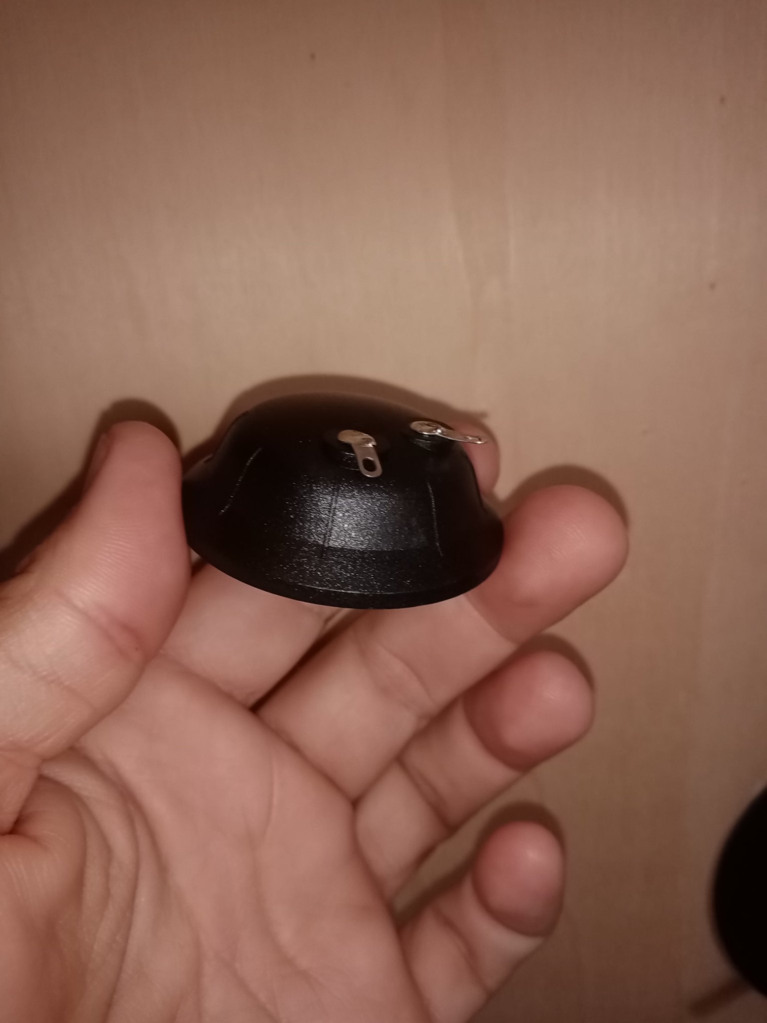

Are Piezo Tweeters frowned upon?

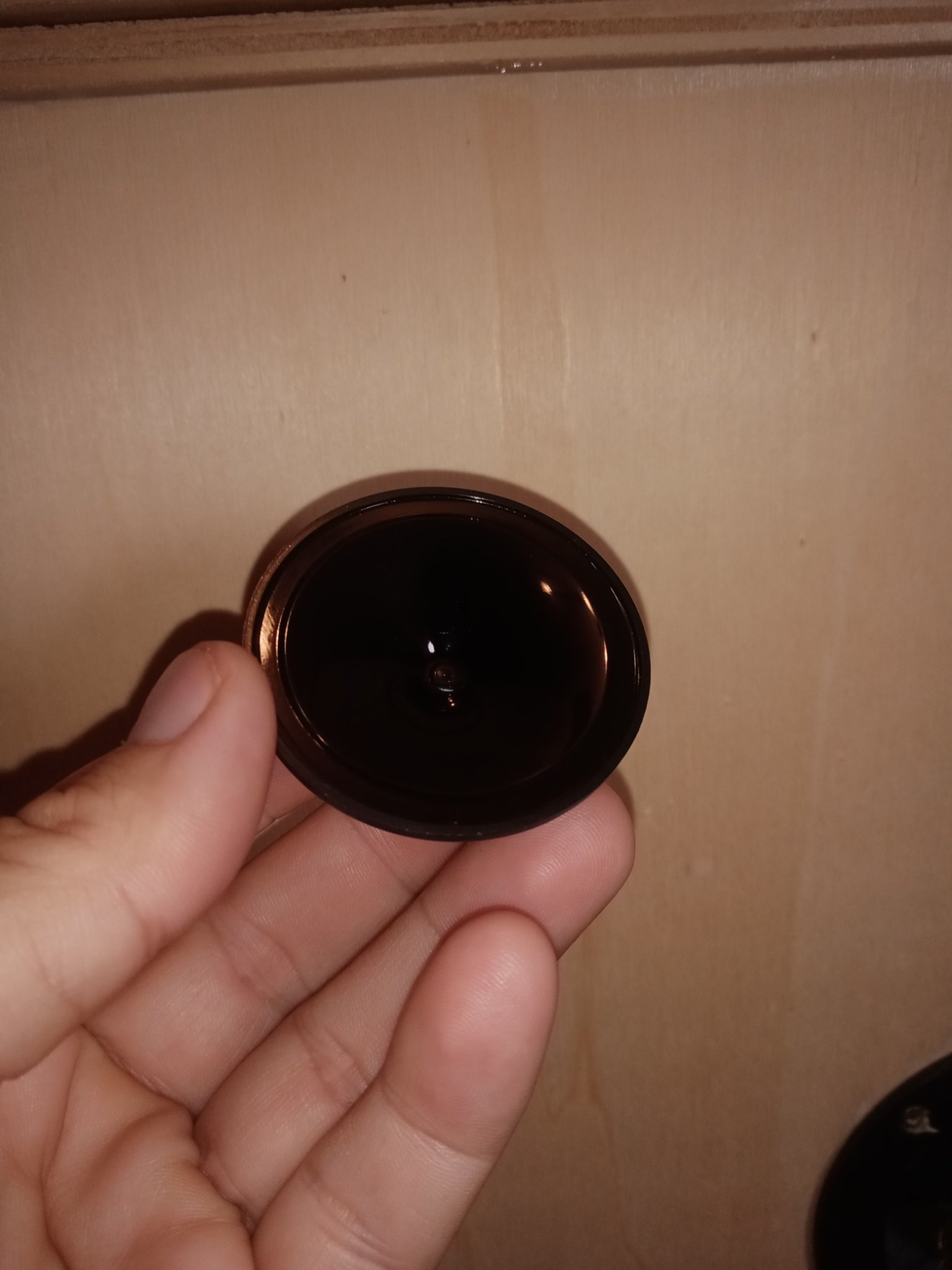

damping piezo cavity with medical cotton "Hartmann Watte"

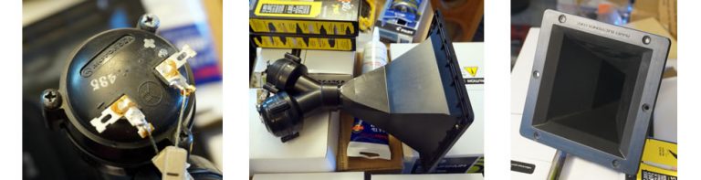

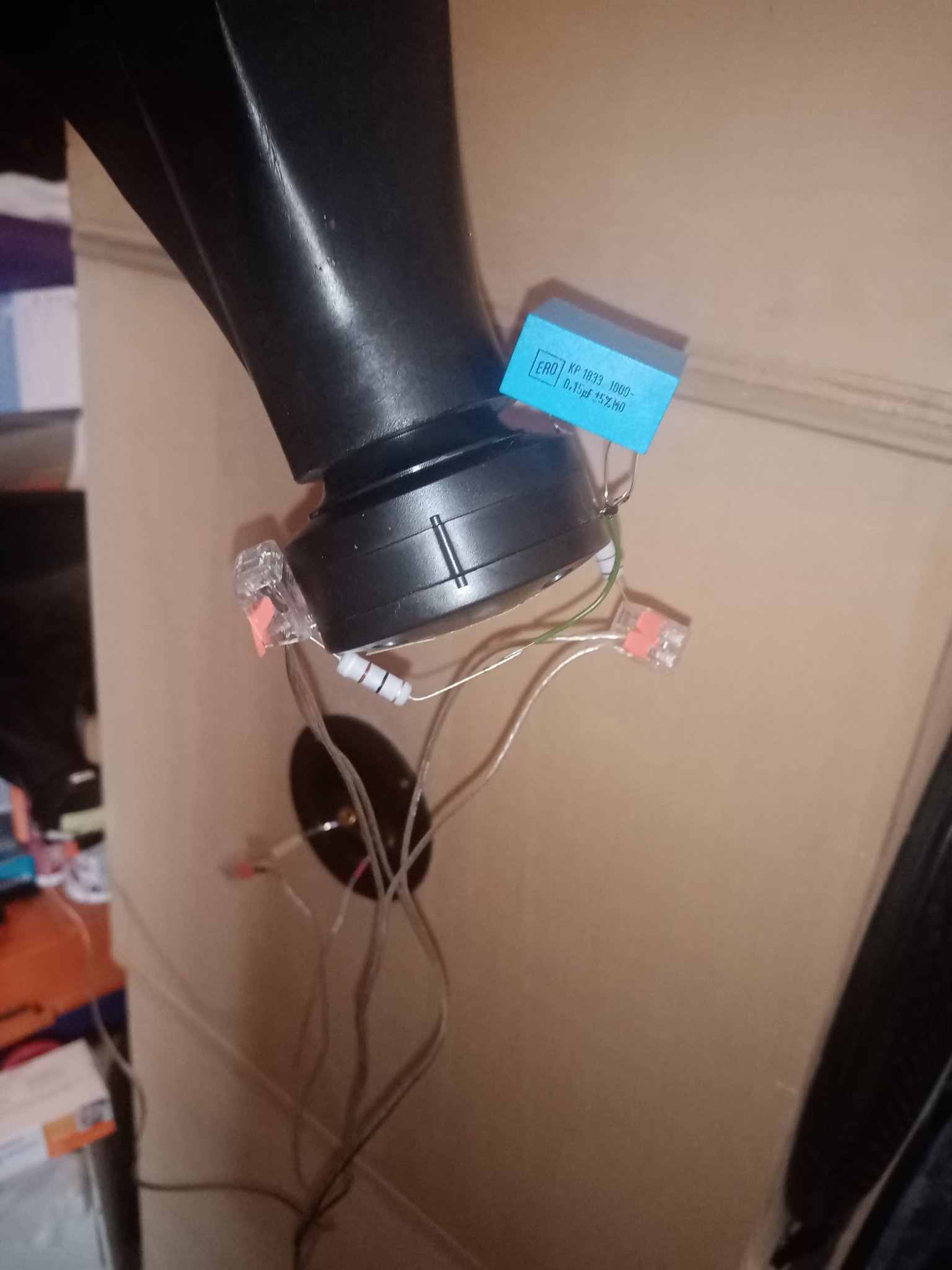

I'm a bit perplexed at the moment as piezo tweeters usually have some typical piezo resonances.

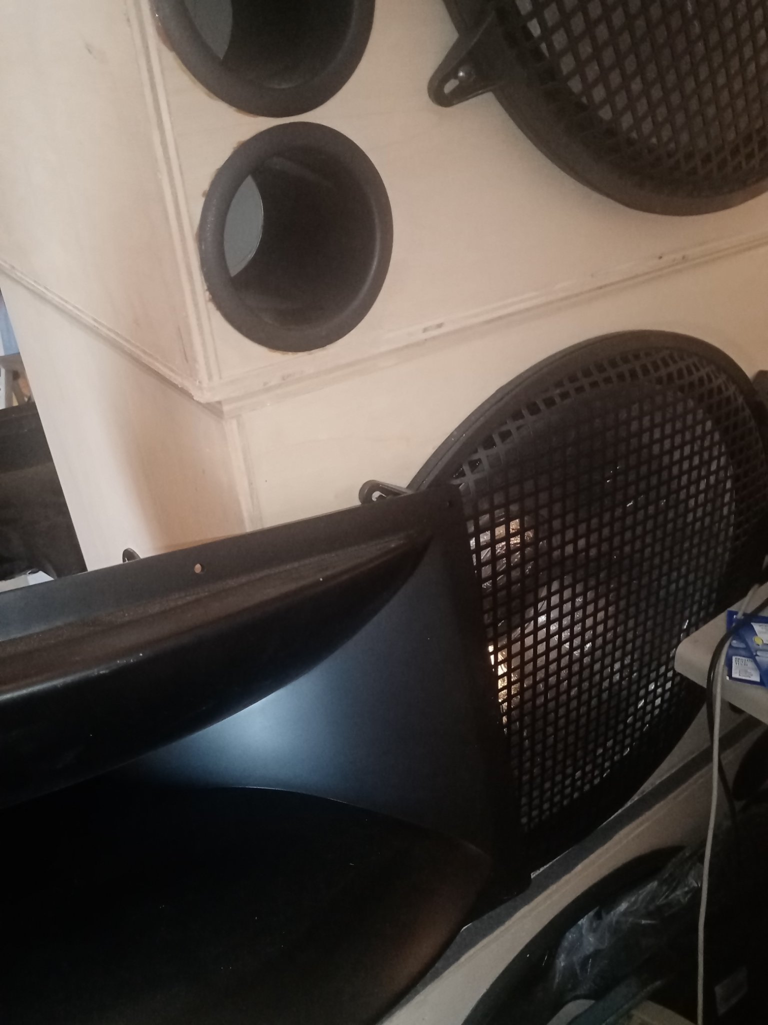

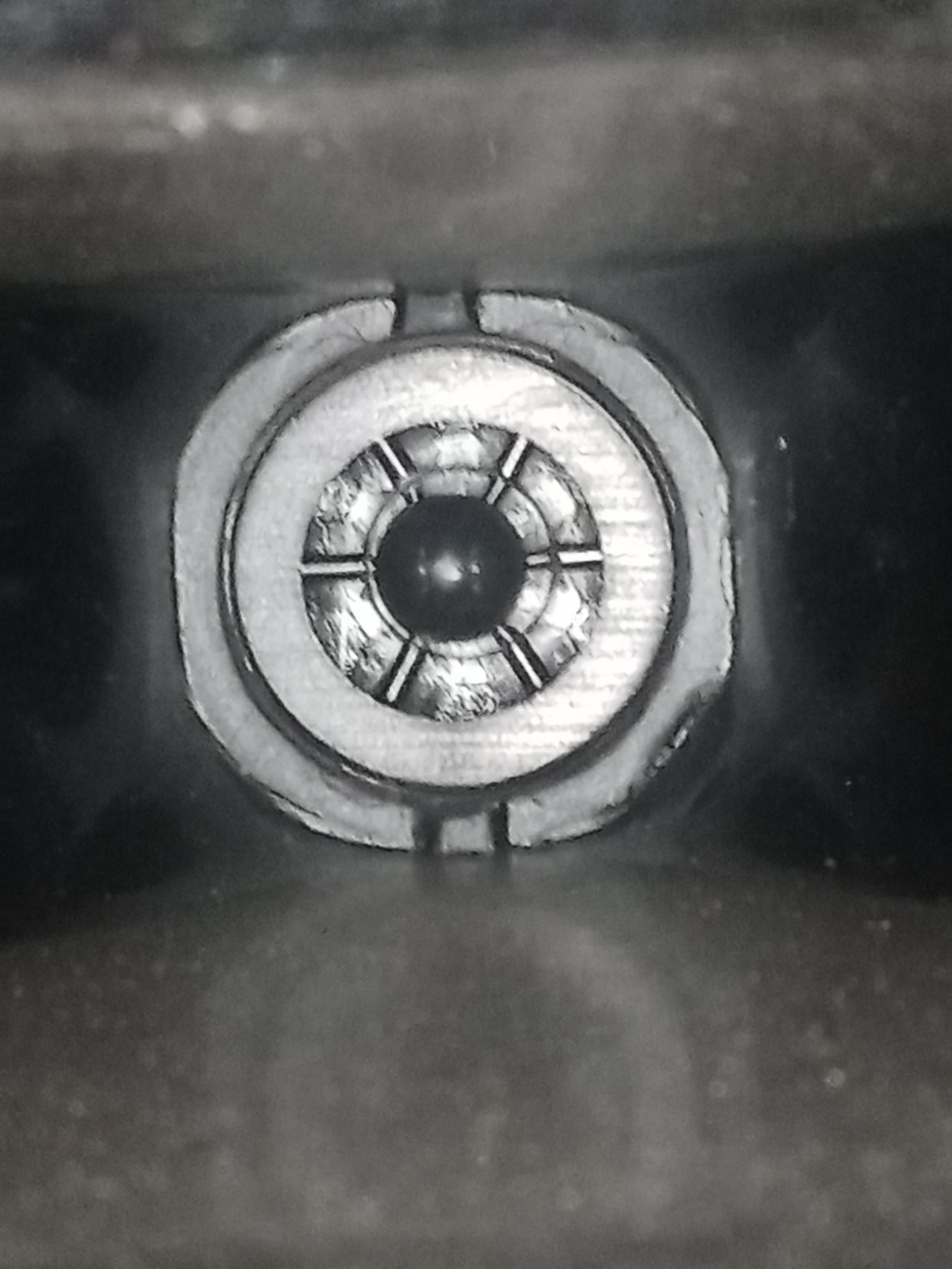

Have now a Monacor MPT-142 piezo driver on a big HL1018 horn but at a quick listen it makes no obvious faults and has low distortion. No tizzy sounds at all.
it has 91ohms across 2.2 uF in line and 12 ohms in line.
Piezo paper cone both sides aluminium foil (sandwich) applied and with medical cotton damped.
Quick and dirty test with an aluminized 18inch driver which goes up to 2khz, no filter.
Will reduce the 2.2uF on the piezo to 1uF.
No name piezo driver with same treatments sounded well but had some annoying tizz in the highs. But quite similar F response.

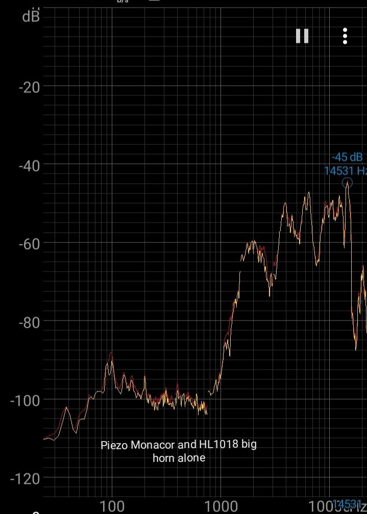

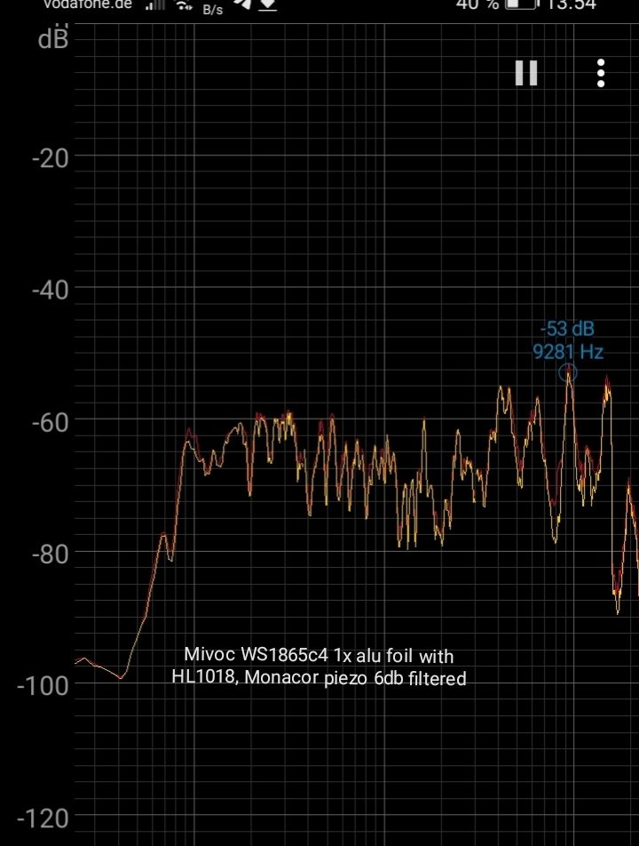

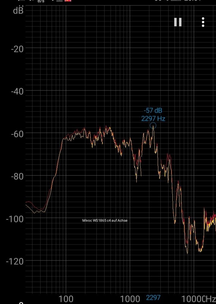

Measured Mivoc WS1865c4 bass, tweeter MPT-142 +HL1018 horn and combined measurement

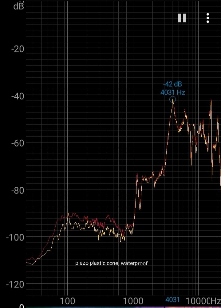

nice no name piezo with plastic cone
it lacks like all the other piezos some damping of the back cavity.
its sold as waterproof

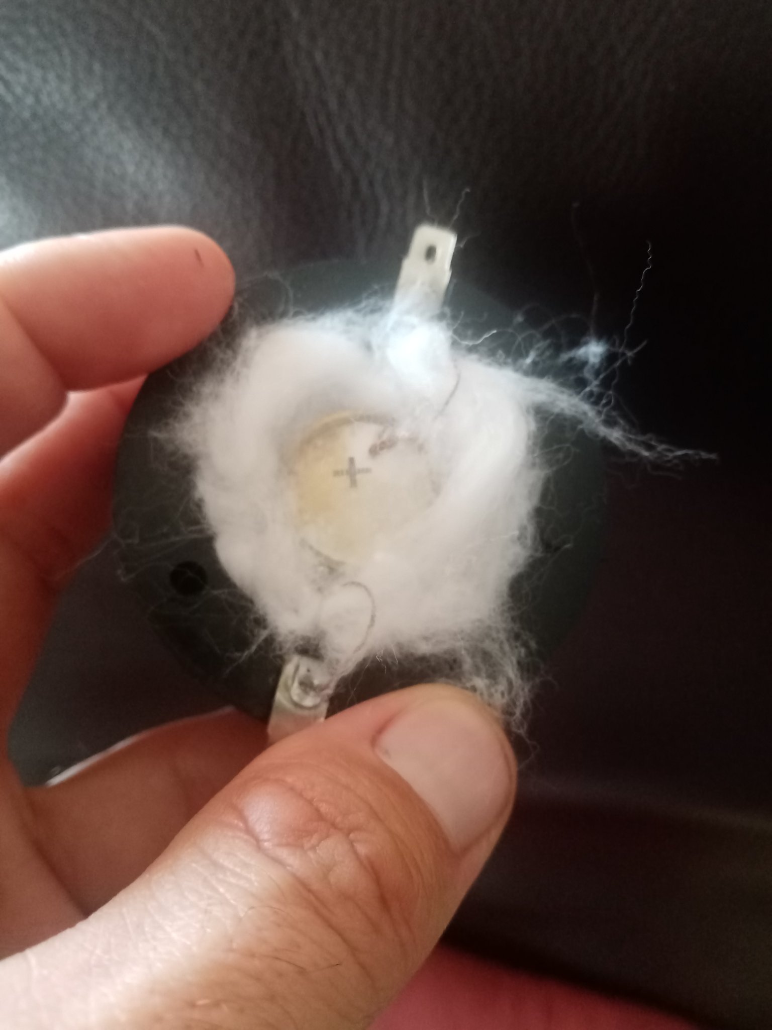

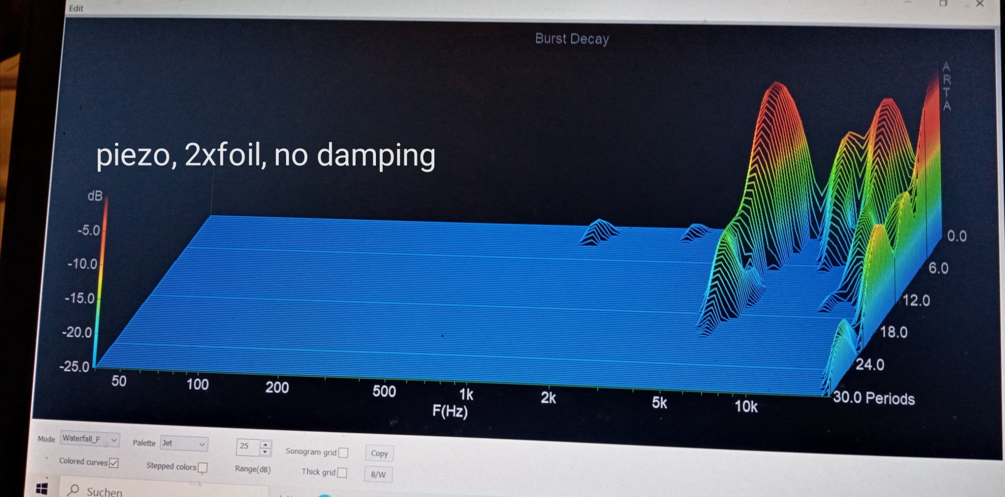

Investigated some tweaks I usually do. Most effective is the damping of the back cavity with medical cotton. (more in the thread How to make a loudspeaker sandwich cone).
Here two drivers, one with damping of the back cavity, the other one without. Both have aluminium foil (sandwich) on the piezo paper cone. The foil brings resonances down but damping of the cavity is most effective (and easier to realize).

The Monacor MPT-142 piezos wins over the no name piezo drivers on linearity showing no severe dip in the 6-8khz region.
All four no name piezo drivers (original, 1xfoil, 2xfoil, 2xfoil plus damping show the same dip in the region of 6-8khz and could not be tamed with these kinds of treatment.
Cavity damping reduced the long decay in the lower region (4 to 6 khz) to an extent that it allows for a decent hifi - alike presentation unusual for piezo drivers which are associated with "tizzy" sounds immediately detectable by the ear and what most people repels from their use. A listening test showed very acceptable sonic result.
The Monacor seemed "tizz" free on a quick listening test, the noname piezo remained tizzy.
Overall sound gut much better from the raw untreated driver to the treated ones. But only the quality piezo disc made the final and important difference.
After this further treatments like damping the piezo disc with some damping sealant like silicone or suspending the piezo disc (like seen in the bigger legendary Motorola piezos) is not worth for further investigation as already a decent result can be obtained by good cavity damping with medical cotton wool and using the better quality piezo driver.
It must be said that the listening test was quite impressive as the use of a correct 6db filtering with all the treatments showed the dynamic possibilities of horn loading and typical dynamic sounding "piezo attack" (due to lightweight resonant construction).

the piezo with a plastic cone (post 50 in this thread) is worth for further investigation:
easy to make a hole in the back cavity and add some damping.
Its already pretty linear and has a good cone material I prefer over paper alone.
Its got no horn and it might well match typical loudspeaker drivers in sensitivity.
It would be great if the tizzy sound could be tamed for their use as indirect radiating tweeters.
