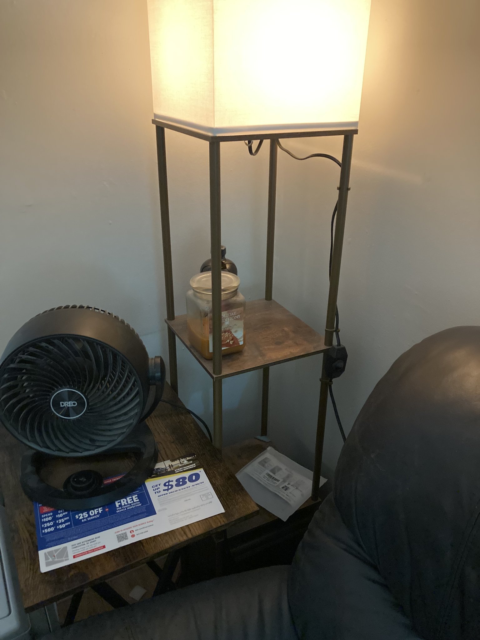

Woofer/fullrange spacing question. If we are running active and able to electronically time align the separate drivers to the listening position, what negatives are we generally left with? It seems that lobing in the vocal range is of considerable concern with driver spacing but when a waf is crossed below 400hz, and even more so lower, are those concerns still worthwhile?
The specific situation that provokes the question is the situation in my home that has been difficult to address in my mind. Because of aesthetics and functional furniture layout, I have come to the conclusion that my best 2ch approach is a fullrange (tang w3 1364sa) on the top shelf of my lamps with a small bass unit on the bottom. These are in the corner so I will be employing the minimum sound absorption for the rear wall bounce, likely around 4-500hz. The acoustic challenges will be addressed down the road but the woofer and fullrange will be 3’ apart and the crossover will be in the 300hz range. Would anyone go into the spacing and possible issues with what I’m thinking of doing?
I’ve thought about triangular cabinets like that that would essentially extend the baffles considerably. These are the lamps and as can be seen there a 1/2” pole in front of the radiation pattern. The diffraction and at what frequencies is yet for me to understand if it’s even worth worrying about. The lamps could be pushed completely into the corners though and would look a little better than being out as far as I can get away with.
I think though, for my aesthetically I would highly prefer a small sealed cabinet up front with a short 2” absorber hidden behind the speaker and maybe a small plant or maybe a tiny decorative fabric basket stuffed with an old t shirt or something to function as further back reflection control.
The 1/2" diameter pole doesn't do anything, I guess. That's an infinitesimal part of what the 'art' of positioning speakers in ambient (immersion) is asked when finding the best way to set a listening space. The reflecting surfaces around are much more detrimental than a little stick, as you notice. By the way, that corner is for one speaker...uhmmm, corners, cavities ... boxes (speaker 's) and big boxes (rooms).
That loveseat in the picture is also a factor in a small speaker on the top shelf. I would rather have a bigger bookshelf on the middle shelf but I believe the absorption of the seat would throw off the power response between left and right channels.

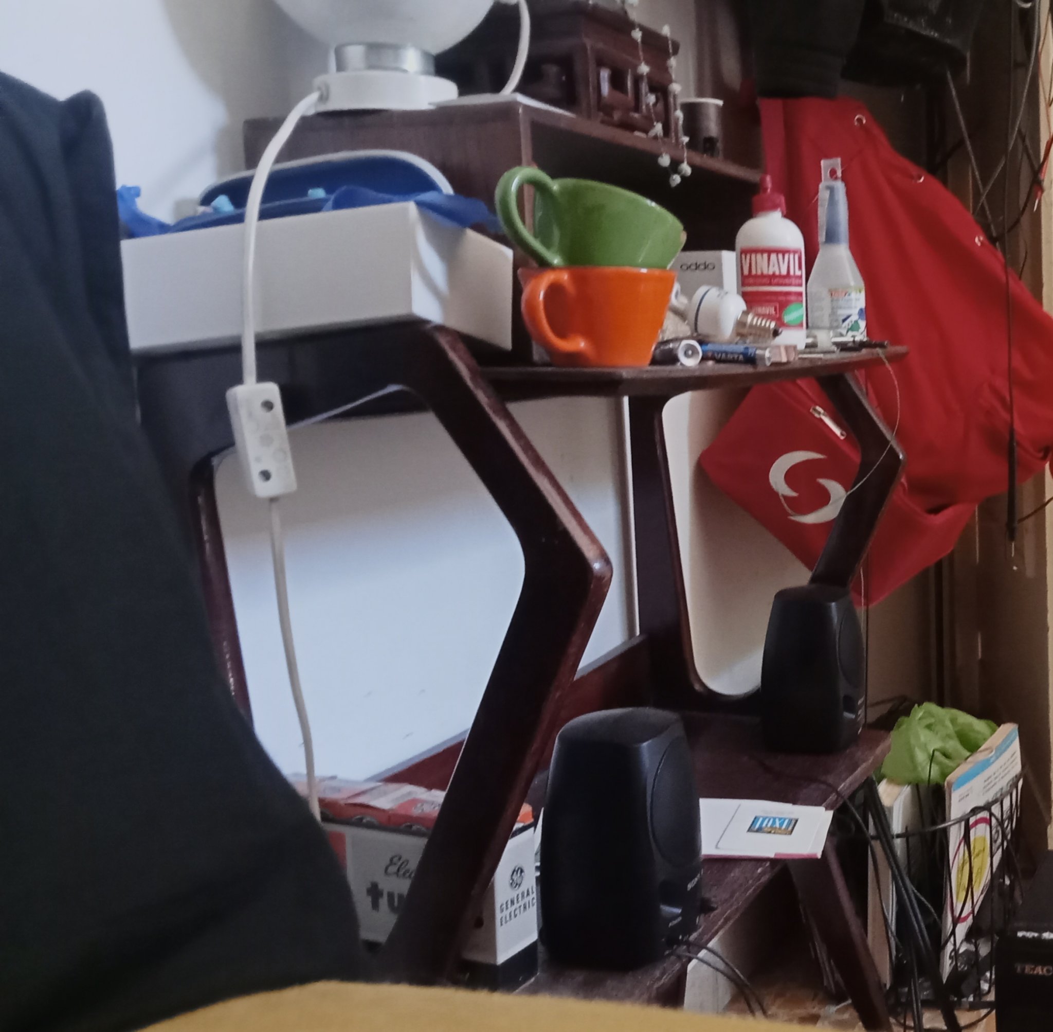

This is my actual listening space
Those are set to 'passive' and are driven by an integrated amp... Subwoofer ruins most of the 🎵 so I took it off
