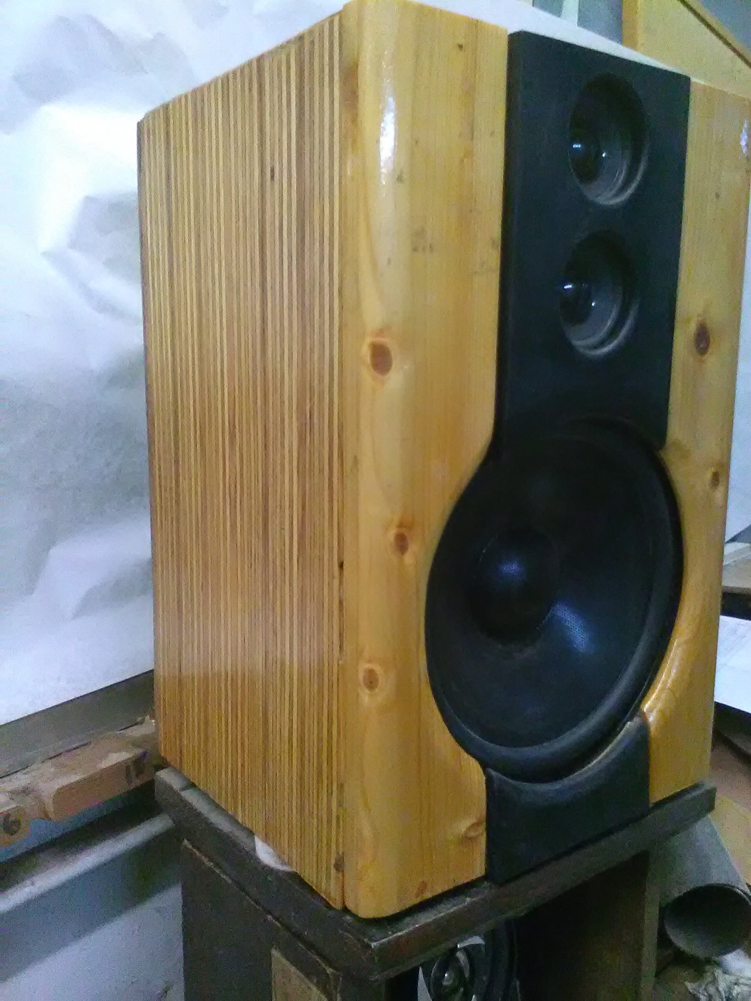

I think David Weems has a lot to answer for, I bought "Designing, Building and testing your own speaker system" about 18 years ago, now I have speakers all over the place; not made from his plans, (I doubt you can still get the drivers, - piezo Reed tweeter?), but certainly using what I learned from the book. I used the "Crossover-network design chart" yesterday.
So cool how the box doubles as a tweeter stand. Surely the knowledgeable engineers designed the box to be optimum size to be antiresonant and the correct height to avoid floor bounce and couple via Allison effect, to let through the pure sound!Better pictures.
Now more seriously, what if you made this today with vastly improved magnetics and materials to focus on high frequency response and dispersion.
OMG, that book is how I became a loudspeaker design engineer! I learned enough to be dangerous, and intrigued by his multiple Audio Engineering Society references got an older friend to drive me to a university physics library, where I photocopied about a 9" stack of stuff and devoured it. There has been SO much progress and evolution in speaker design, and yet it is still in many ways a black art, emphasis on the ART of the design process.I think David Weems has a lot to answer for, I bought "Designing, Building and testing your own speaker system"

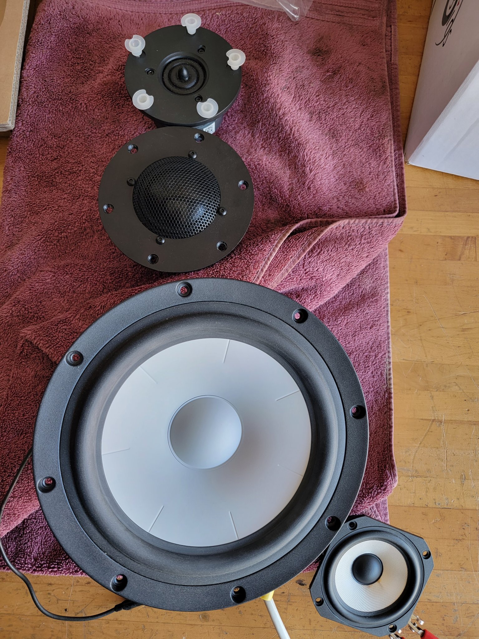

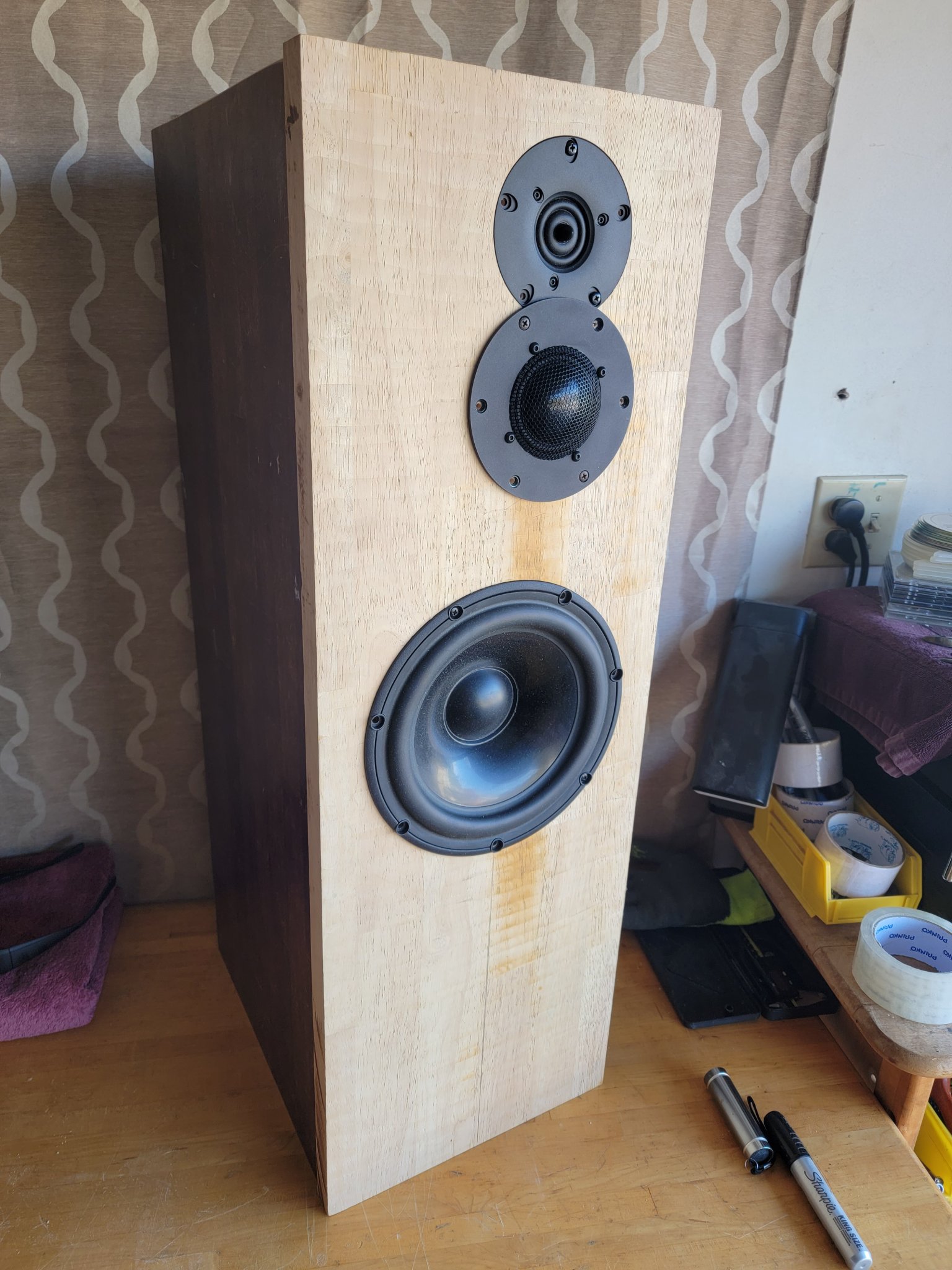

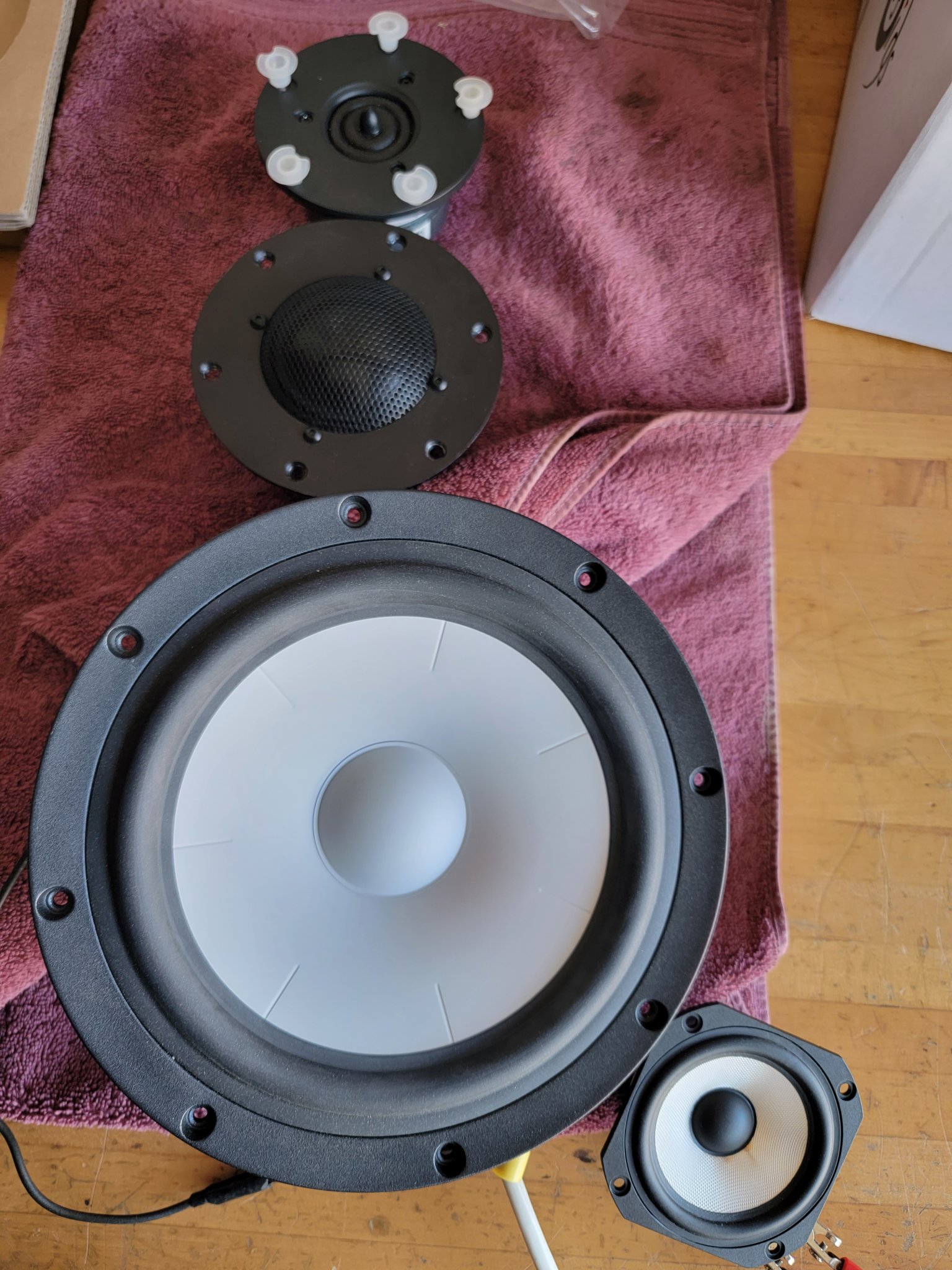

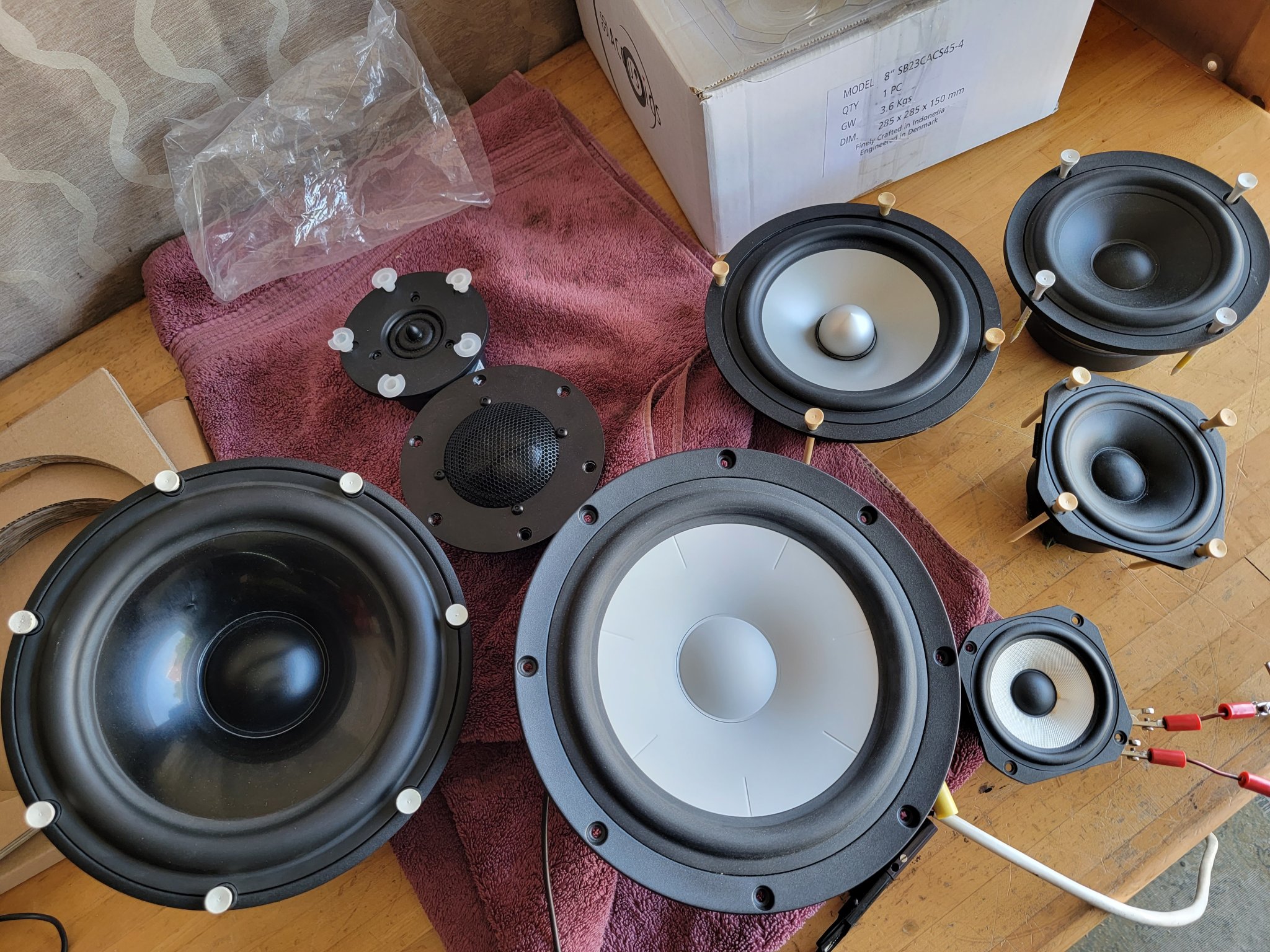

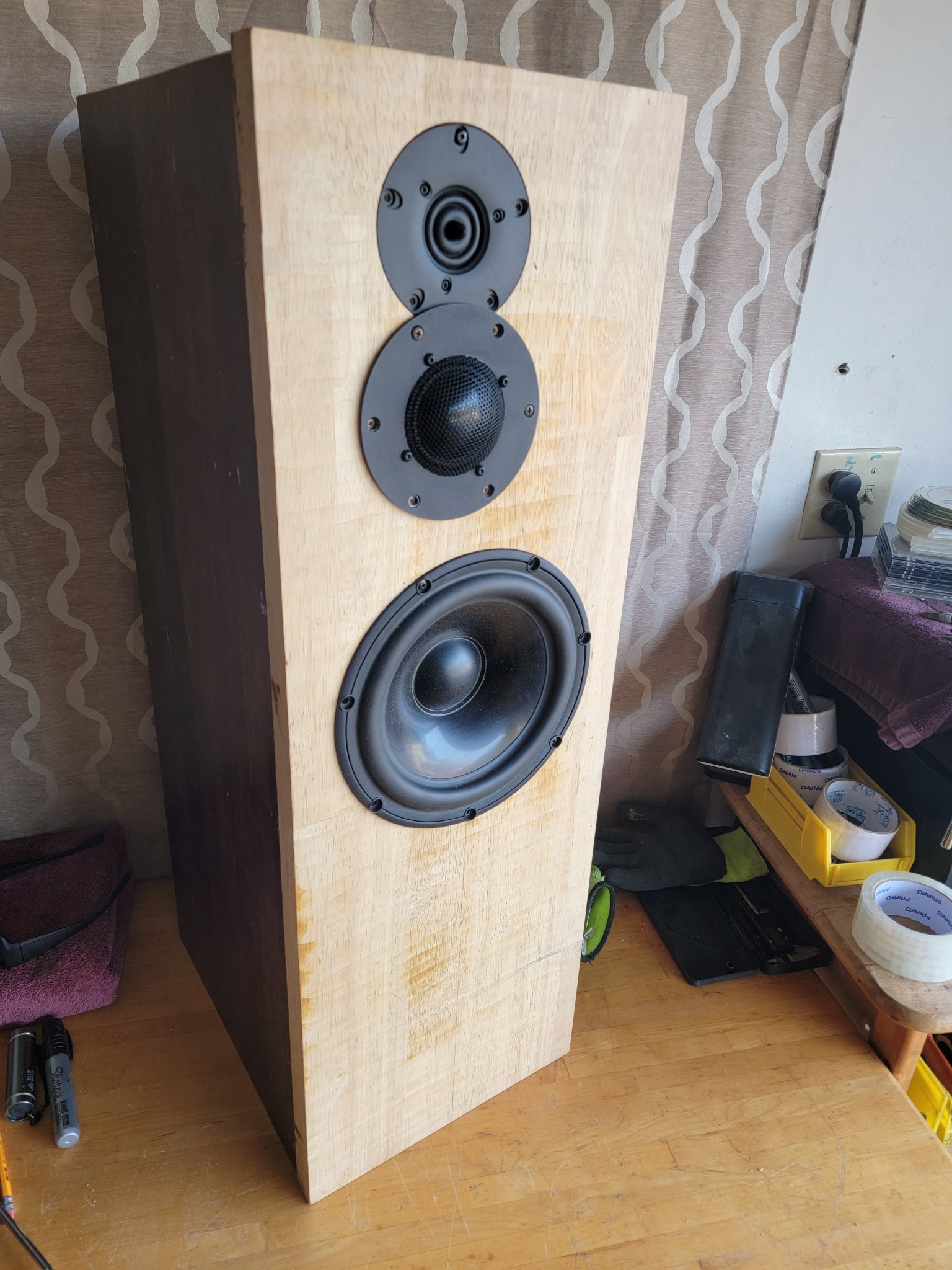

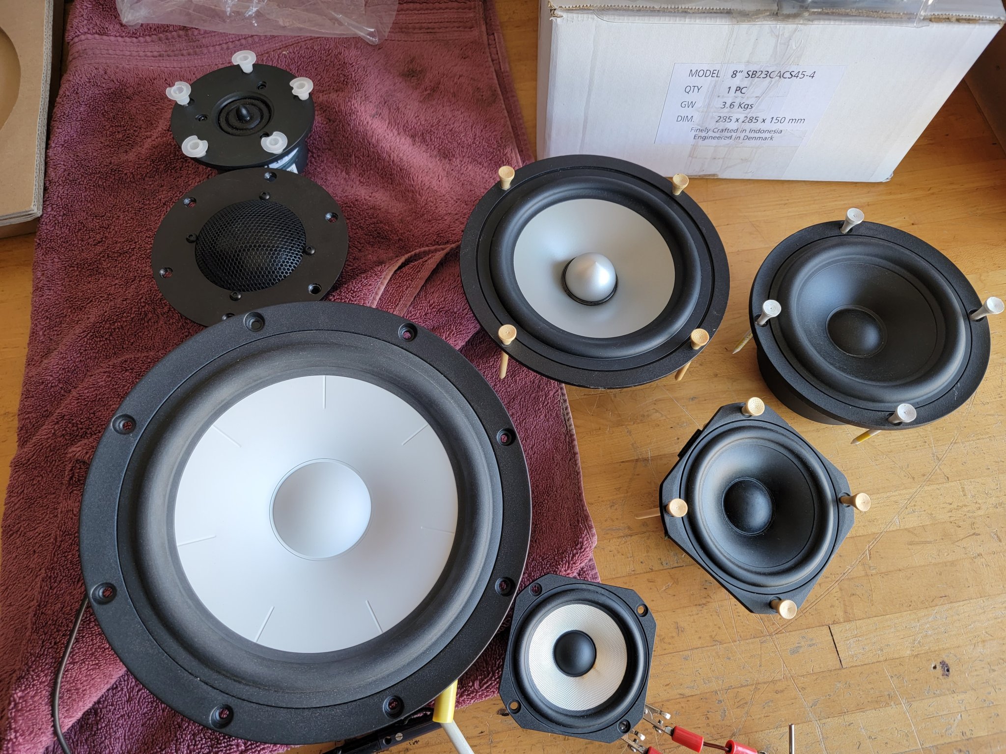

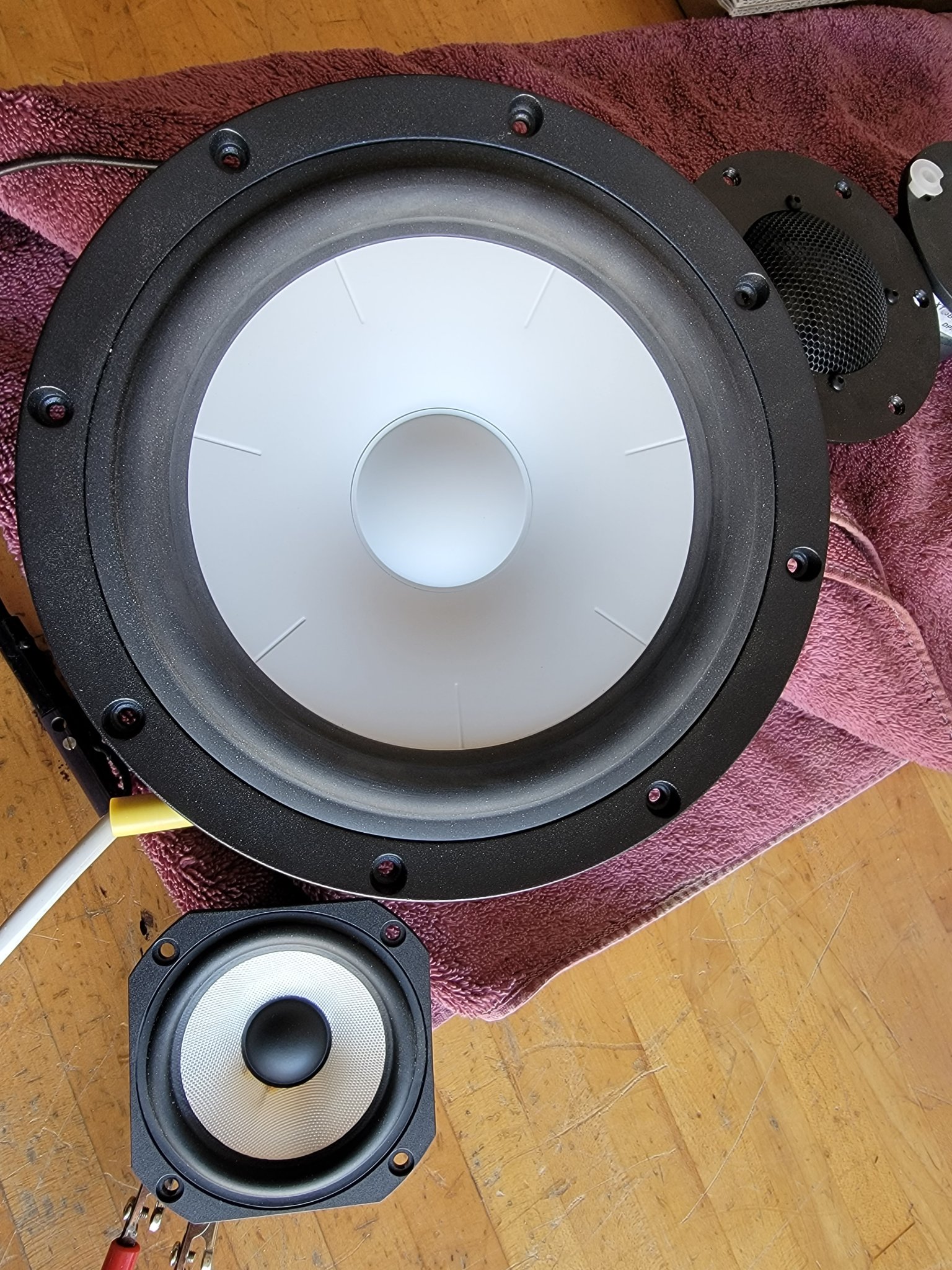

Trying to decide between Peerless-TG9FD10-08 (or Peerless-TC9FD18-08) + SB Acoustics SB23CACS45-4
Or
2.5-way SB Acoustics SB15MFC30-8 5" Poly Cone Woofers + Peerless-XT25BG60-04
Or
Peerless-XT25BG60-04 + Dayton Audio RS52AN-8 + SB Acoustics SB23CACS45-4
Few different designs actually, too many choices.
One thing I noticed (especially if you don't like a lot of highs) is:
there aren't too many advantages over ScanSpeak Revelator 26W/8867T 10" Woofer Black Aluminum Cone +
SB Acoustics SB15MFC30-8 5" Poly Cone Woofers + Peerless-XT25BG60-04 (3-way)
or
ScanSpeak Revelator 26W/8867T 10" Woofer Black Aluminum Cone + Peerless-TG9FD10-08 (or Peerless-TC9FD18-08)

Most of your excursion/compression/distortion issues with a wide variety of content will still be with the 10" 26W. Thermal, I don't know.
You should be able to get the Peerless-XT25BG60-04 + Dayton Audio RS52AN-8 to sound better than the TC9 by itself, but you have to cross it over 750 Hz instead of 400 Hz. And it has less Xmax and Sd.
But what was interesting the SB Acoustics SB15MFC30-8 sounds excellent also.
Basically most modern 2-ways suck.
Too many highs and no lows.
3.5" driver + 8-10" woofer is a way better 2-way than 1+6-7" 2-way.
My thinking is: If you can put a Sd 7 cm^2 tweeter and a 150 cm^2 woofer together; Sd ratio 21.42, you can definitely put a 36 cm^2 driver and 320 cm^2 woofer together; Sd ratio 8.89.
I'm not sure if people will like the Peerless-XT25BG60-04 + Dayton Audio RS52AN-8 (for example) better than the TC9 by itself, in blind tests.
There's a lot that can go wrong in the cross-over (I think) and Tymphany/Peerless drivers have some really nice performance figures.

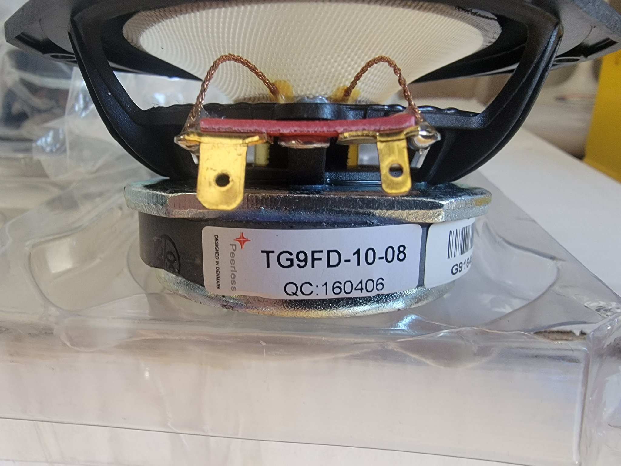

So, yeah I would use a TC9/TG9 instead of a tweeter. Other fullrange drivers have strange FR issues (top end usually rising, but compensates for dispersion/beaming) if not EQed.

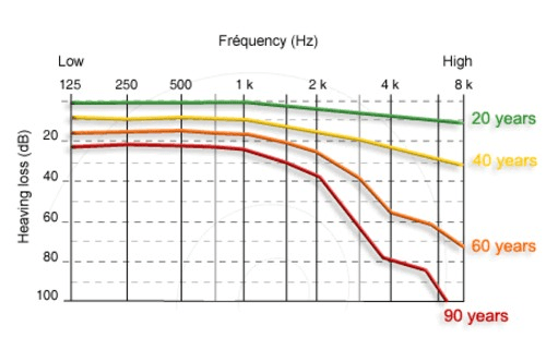

How old are you and what condition is your hearing in?You hear that top end shimmer and/or clarity? No, I don't and I don't want to.
Not asking to be rude, but because I think there are genuine differences in what listeners with different ages & amounts of loss will appreciate.

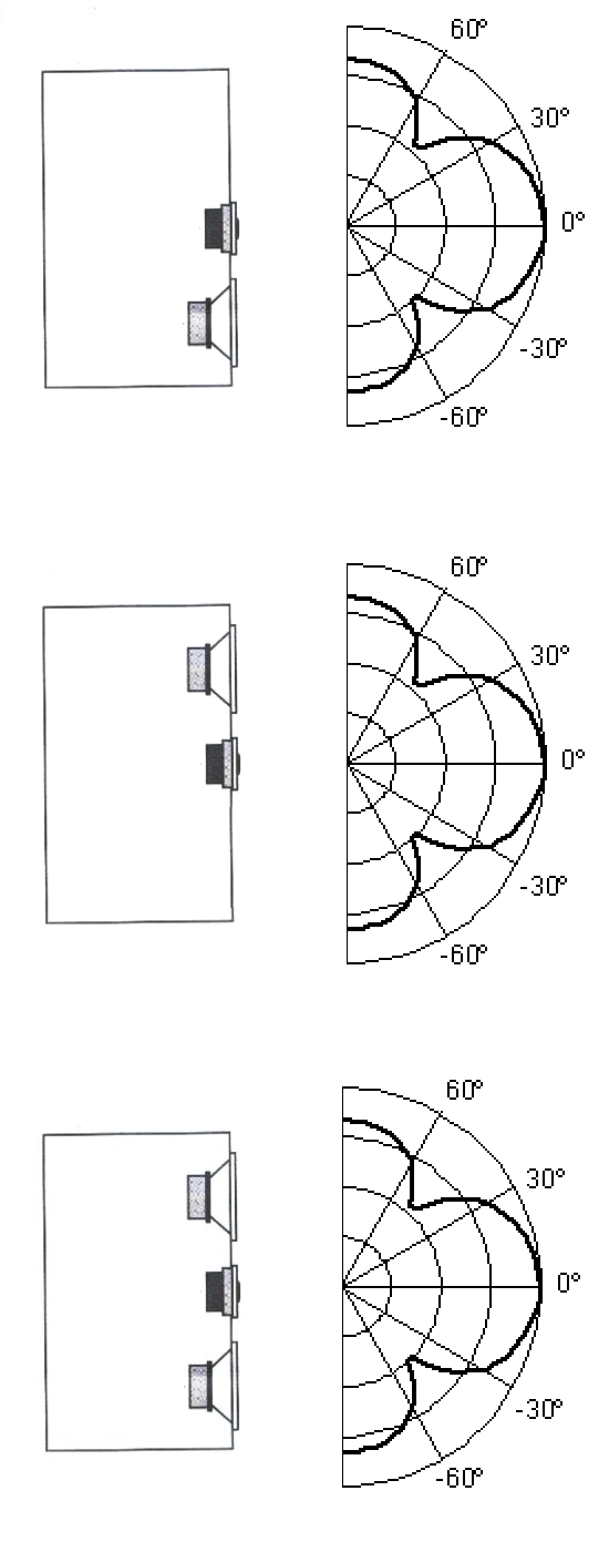

Yes, crossovers are evil. But the lower you can put them the better, under 400 Hz, and if the centre-to-centre is less than a quarter-wave at the XO frequency, the more of the evil you shed. Hard to do but if you can achieve that and a first order XO (not easy), they can almost disappear.
Sorry to bring this back from near dead…
The post got liked, and Allen B did a simulation of the lobing of a WAW with a 400 Hz XO, withing a quarter wavelength, a 4th order Linkwitz-Riley
This illustrates one of the evils of XOs gone.
Here is the lobimg seen in the moe common cone + dome (also complements of Allen)

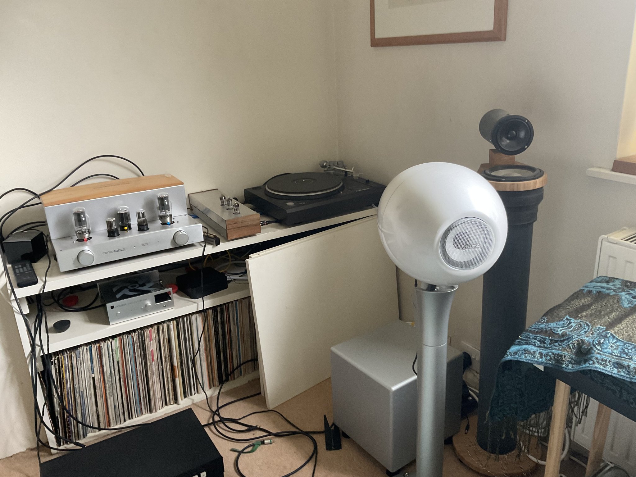

And yes my lounge is a transition mess….
The eclipses are proving very interesting indeed, not plugged the sub in yet .
And yes I keep very quiet about ar9’s ever since I stupidly sold mine many years ago…
