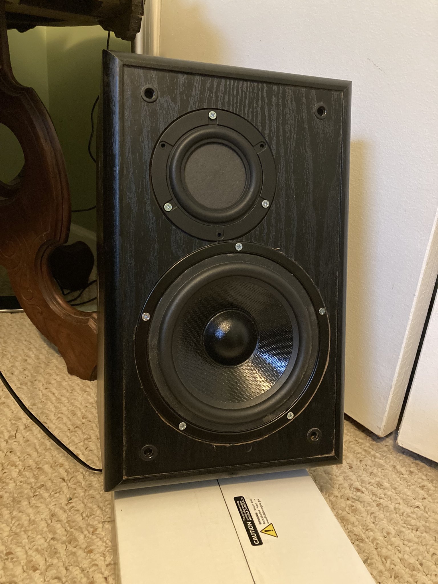

For a guy like me who doesn’t need a driver to do much above 90db, and that’s actually with like 10db headroom, the bmr 2” is not the worst choice I could make in choosing a widebander. But there’s also the possibility of adding a small neo tweeter to play above 5khz right before the resonant modes start appearing. I wonder how the transient response of a 5/8ths soft dome would compare to a ribbon, planar, or amt. That’s saying that more than only a few people could tell the difference blindfolded from a tiny dome and a ribbon type transducer. That could also be an avenue for me to explore in getting everything into those premade black Dayton cabinets I like so much.
I’m quite good with fiberglass from my car audio interest and could easily fit the bmr 2” and tiny neo dome onto a 4.5” circle that fits the tweeter cutout and even point on axis if the response wasn’t already phenomenal from a tiny dome. But, the center to center spacing would still be far from a 1/4 wave at even a 2” c to c. This is fun.
