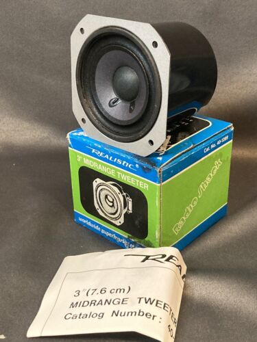

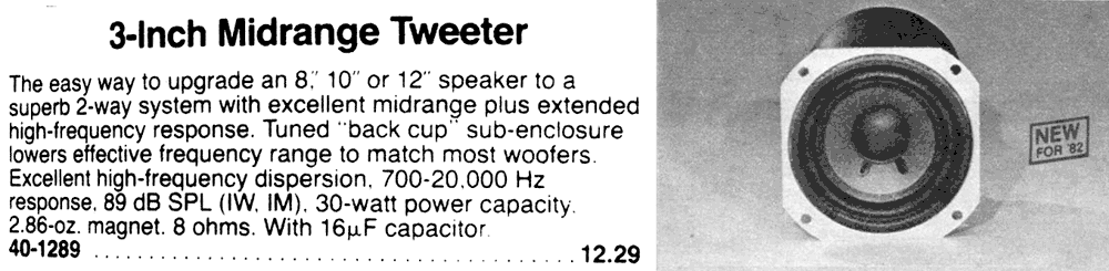

Retro tech story: as soon as I read the OP's first post, my mind immediately flashed back to the early 80s and my senior year in high school when I built two different sets of speakers in wood shop class. After finishing them (and graduating), I wanted to build another set & one of them was a two-way using a 10" woofer and a special driver I had been fascinated with since its debut at Radio Shack:
3-Inch Midrange Tweeter (it's listed on page 61: to get there, enter "61" into the left/black side of the page selector gizmo at the bottom of the viewer app; use mouse wheel to enlarge page*)
Seemed like a good idea to me: IMO a well-designed cone tweeter can sound decent, but usually only with smaller woofers i.e. 8" and below. So to me this was the "heavy duty" version of that, built so it could be crossed over at a relatively low frequency for use with 10" and larger woofers.

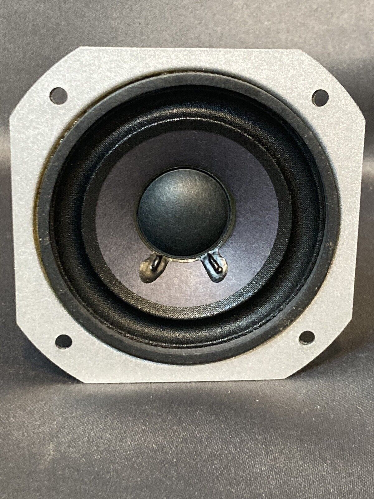

Probably a Foster FE83 variant loaded in a plastic cup.
I have some FE83A i am saving for something special. They came out of a Noresco WAW with a 10” AlNiCo woofers.
dave
I wonder if whoever took the pictures unfolded the leaflet, would there be a FR plot?Better pictures.
Many similar drivers are used in HT. Usually 80-86 db\m\w.

Interesting info (and thanks for the clipped article). That surround seems quite substantial for a "midrange" crossed over at 700Hz, so it makes sense that is probably a repurposed full range driver.View attachment 1125424
dave
I still think that's a handsome driver (function first of course, but good looks are nice to have). I've noticed many drivers back then featured exposed leads on the cone's upper surface, not sure why though.
