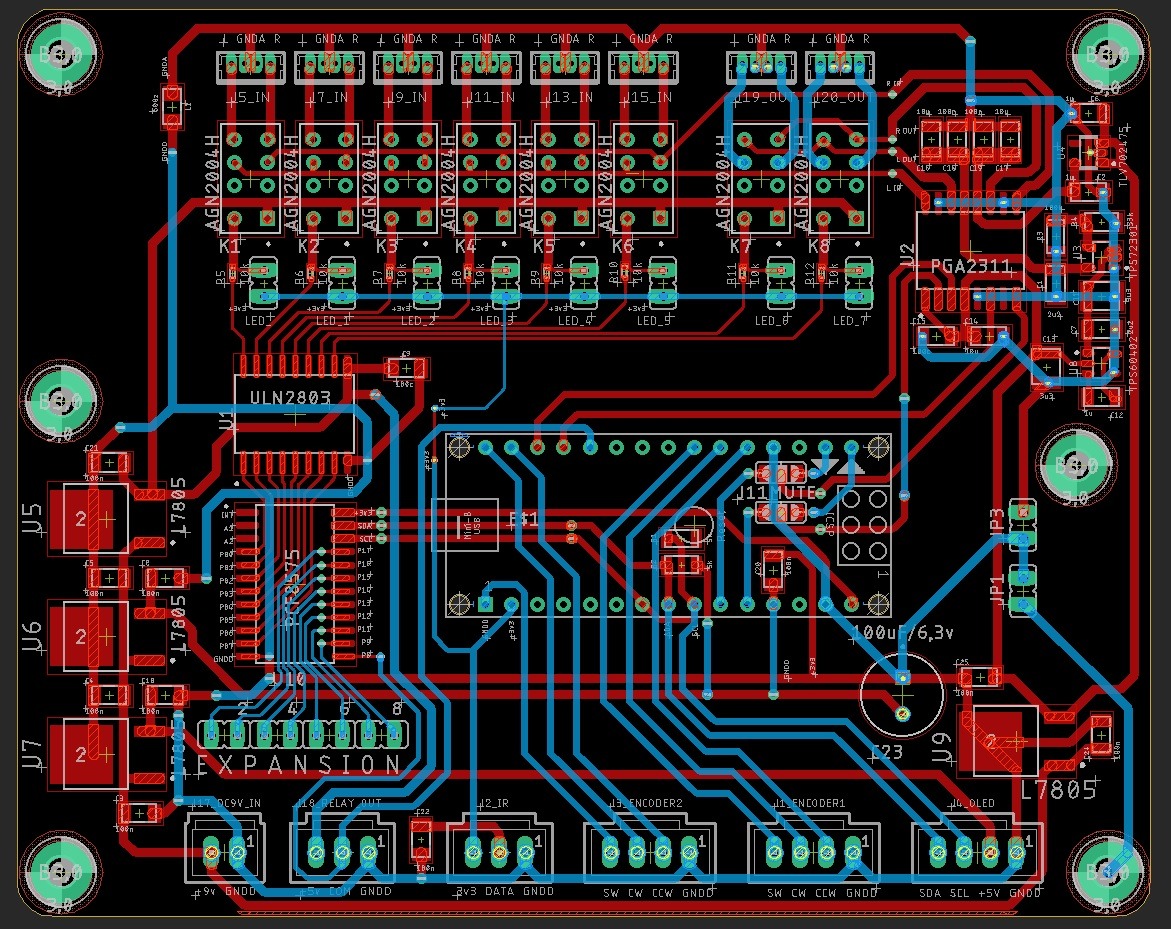

and assuming I have no knowledge of Arduino, I found some info online on how to expand the I / O using a PCF8575 expander connected to a ULN2803 by adding resistors to overcome the problem of driving the relays because the voltage is insufficient and I also added LEDs for signaling the input and output of the various channels. everything must be checked by those who know more than me, see pcd, I can post the gerber file created with Eagle program

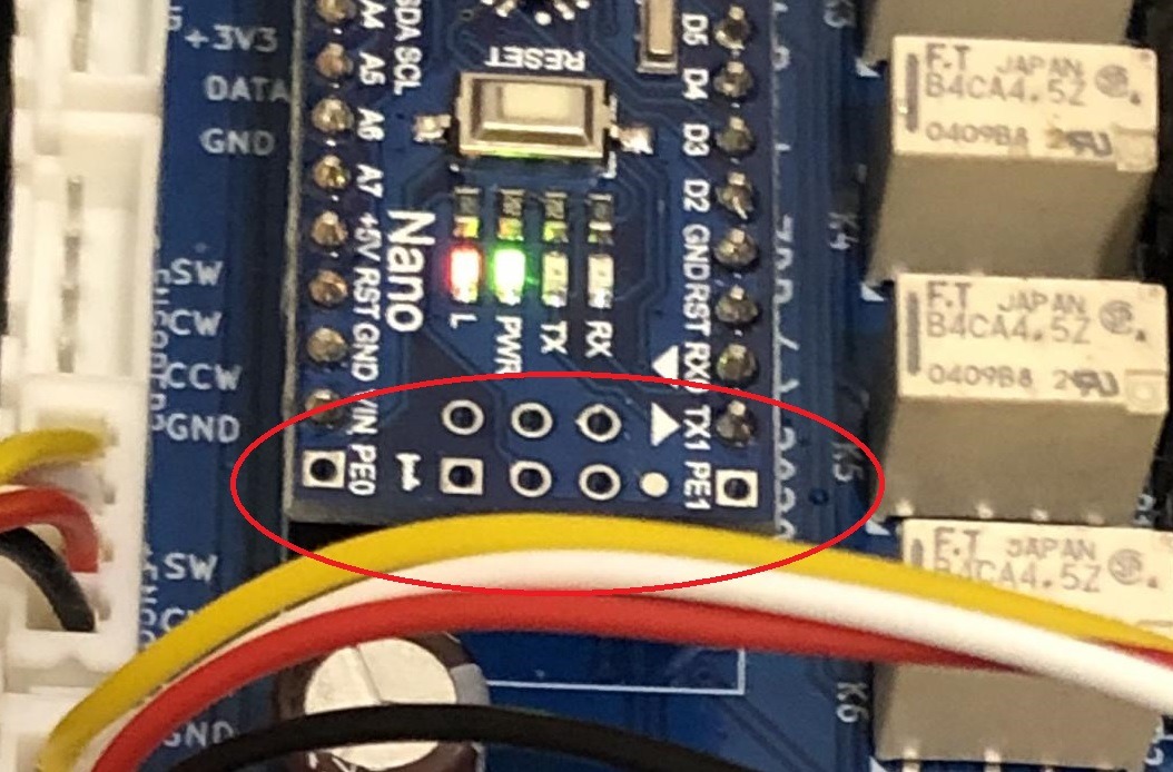

they use a 328pb Why couldn't I read out here ?, the 328pb is difficult to obtain, the connections PE1 and PE0 are also not used
the 328pb certainly needs another bootloader (minicore) , which one did they use ?
I want to test the project on a breadboard first, and already own normal nano 328p
Why would you need PB for this design? I am using normal Nano with P variant.

but sorry ... the three pin connector J18, of which pin 2 (COM) connected to pin 10 of the ULN2003 is not an expansion for a possible other relay? err?
A pleasure. can you send me the Sketche file of the development of this project?
I would like to do some tests to expand the IN and OUT
