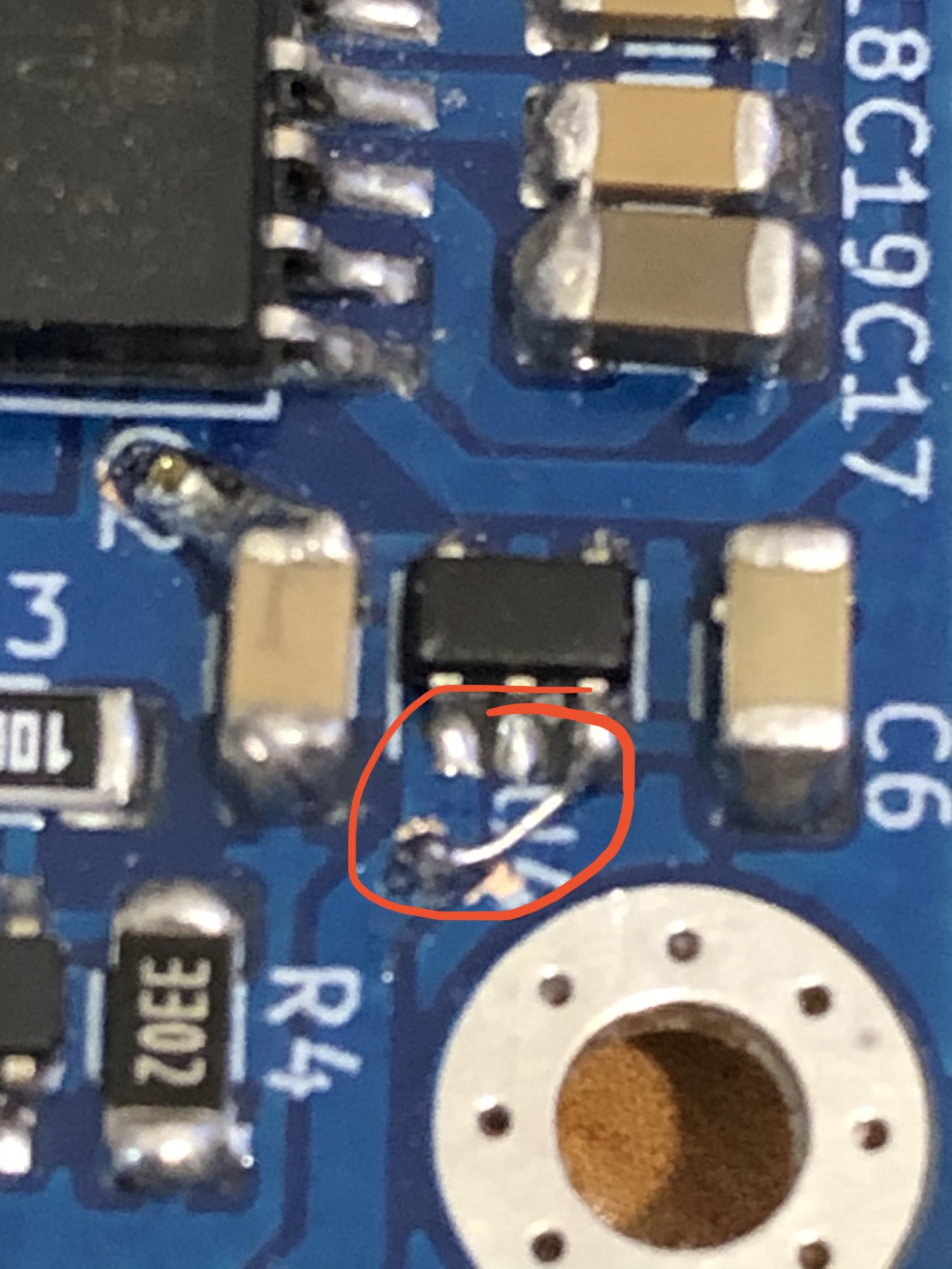

It's finally finished. Nothing spectacular, but feature rich, pretty damn good sounding and fancy lookin'. Driven by a single, cheap 7.5-9V switching or linear power supply, with 5 inputs and 1 output with tape monitor , switched by small signal relays. Controlled by Apple TV compatible remote, panel operable with two independent encoders, with graphic 2.4" OLED. Attenuation done with PGA2311 running on +-5V with negative rail inverted from +5V and stabilized with -5V LDO. Firmware ported from LDR Pre MkII. Volume steps are 1dB, from 0-99dB
Why PGA2311? Because I heard Musical Fidelity M3Si which is using the similar chip for volume control, and it sounded fantastic.
All passives are SMD 1206, easy to solder even for 56 year olds like me.

Hi the better performing PGA2310 would have been a better choice when sound quality is important. That one will give sufficient headroom too. You just need to up the analog voltages. Design flaw is the omitted input buffer as both IC's need one for sure! The buffer needs to be AC coupled and it needs an RC input filter (good design practice). Second flaw is the too low +/- 4.75V in an already tight scenario regarding headroom. 4.75V is the absolute minimum too for functioning of the chip. IF you stick with PGA2311 you really need to use +/- 5V.
Third flaw is the TPS60401 as its internal switching frequency is between 13 and 20 kHz which is exactly the area we don't want and certainly not when it is used for the negative supply voltage of the analog side of things.
The design would benefit from a symmetric power supply and preferably a small Rcore transformer. For a slightly higher cost way better performance... Again that is only valid if sound quality is important as there seem to be more and more designs introduced that don't care about sound quality but focus on easy building or features.

It depends what you call "better performing" :D PGA2310 possible 4V rms output gives it away. PGA2311 has 2.5V rms absolute maximum for input voltage before clipping. That is tight with modern sources. Regarding sources: let's say any modern source that has +/- 5V supply voltages in its output stage outputting 2V rms will be shot on sight :)
BTW in the sheet PGA4311 is mentioned, I don't know that one and if it is completely comparable to PGA2311. The sheet also uses the highly unrealistic load of 100 kOhm.
Hey, it is your call. I just mention my experiences with the IC's to prevent the usual pitfalls. PGA2310/2311 benefit tremendously from both input- and output buffers. In fact, I think they can not be used seriously without buffers which makes them less attractive as designs are more complicated and a higher part count is necessary.
MUSES72320 performs way better than both the PGA chips. It also needs a symmetric PSU higher than +/- 8.5V and it is not easily "overdriven". It does not need input buffering BUT it definitely needs output buffering.
Disabled Account
Joined 2002
Wild guess: PGA2311 will not be able to cope with 2.5V rms input/output voltages when used with +/- 4.75V. I tried to get this out of the datasheet but failed to find it as TI is not clear on this. They state that with analog voltages of +/- 5V both input and output can be 7.5 Vpp. This would mean 7 Vpp with +/- 4.75V supply voltages. TI says the chip can have 2.5 V rms when used with +/- 5V supply voltages but this does not comply with 7.5 Vpp....
Safe guess is slightly above 2V rms as a maximum. Too close to call it "enough headroom" for many designers. Again, critical remarks are meant constructively.
