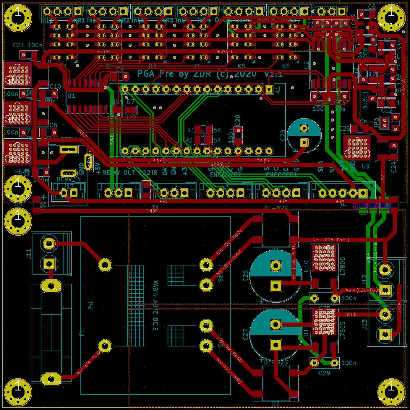

Arduino+PGA2311 Ultimate PreAmp with OLED and IO switching

As for your other suggestion, it is easily possible to do a slight mod in the schematics to use 7806 instead 7805 before converting it to +-5V rails, on the same pcb. I don't think there will be an audible and measurable difference though, I will test when the needed parts arrive.
Just because designing with absolute minimum supply voltages is not good design practice as specifications might not be met completely when the +/-4.75V are in reality +4.70 and -4.65V..... Also that famous 2V rms standard is often higher than 2Vrms....So the situation is in some aspects too tight but I explained that before so no need to repeat. There should be room to breathe.
The device needs a symmetric PSU to solve matters 100%. A switcher operating in the audible range is best omitted.
"2Vrms barely reaches 3V peak". True but please think of opamps that have outputs that have a maximum output voltage swing way below rail voltages... +/- 5V only works when IC's are specifically designed for these voltages like the PGA.
Essentially +/- 5V will work OK in your design but as written before, the design misses a few things so it can be better.
OK your BOM says TPS60401 which runs in the audible range. The predescribed limitation of a single power supply is what causes all the annoyances 😀 This while almost any small transformer has 2 secondary windings. Just a small 2 x 7V 7VA Talema (standard voltage in their toroid range) or Rcore and it is solved. If LDO regs are used a 2 x 6V might work out OK.

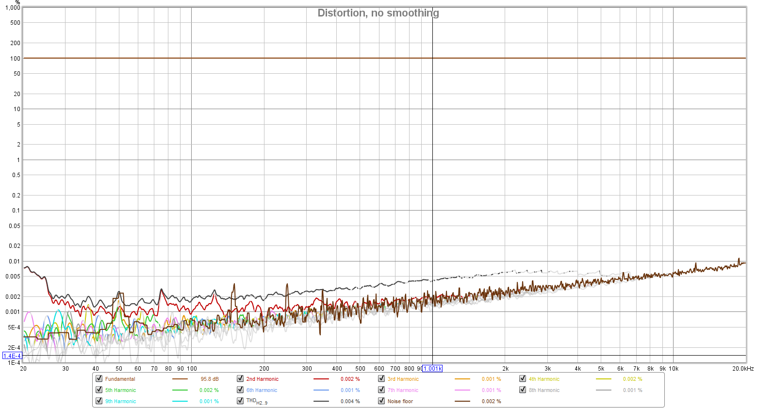

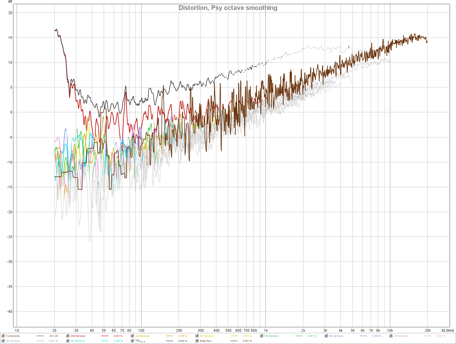

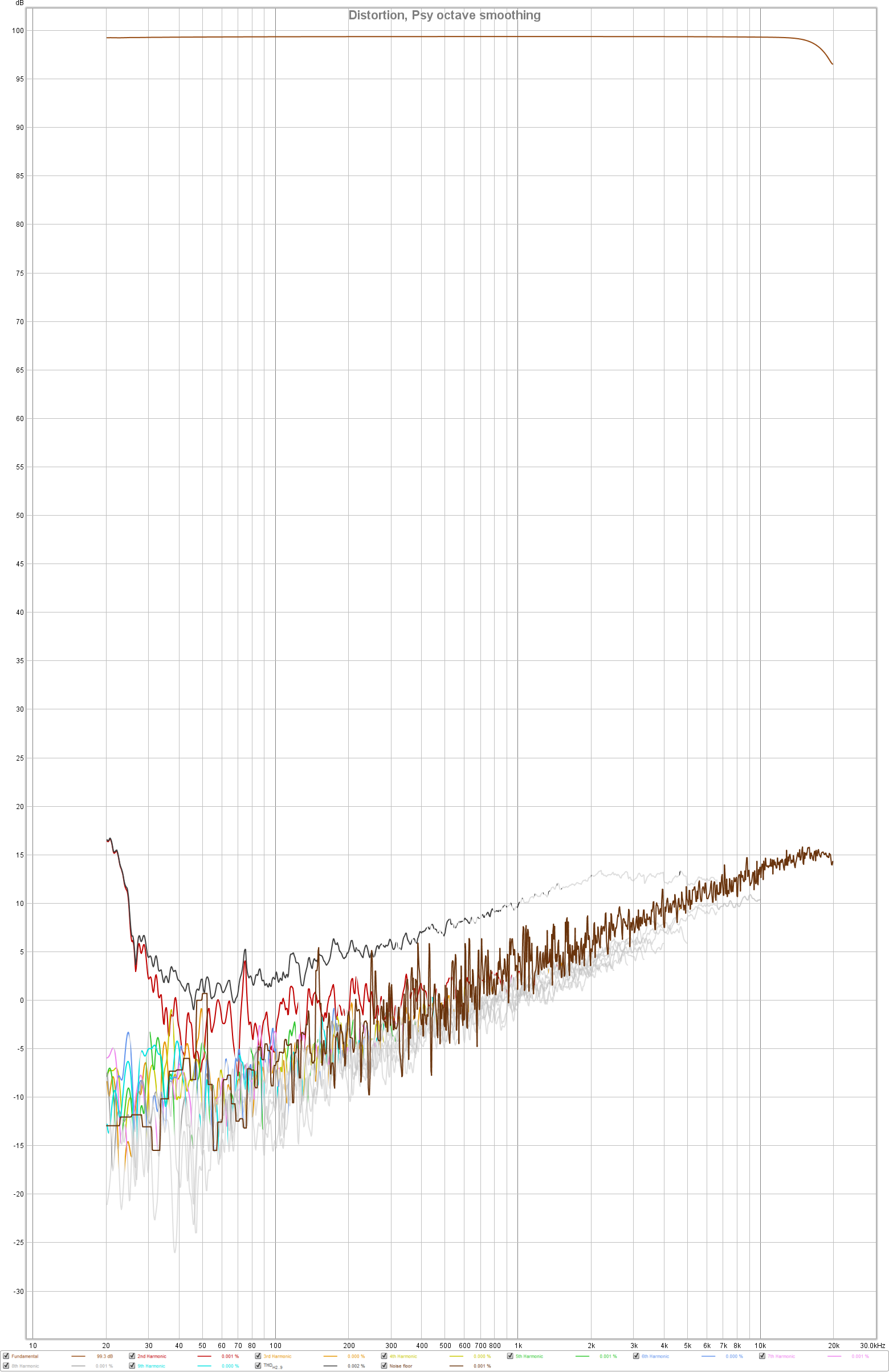

Lets not try to solve a problem before it reveals itself🙂 These are the measurements through my Scarlet 2i2 external sound card.
