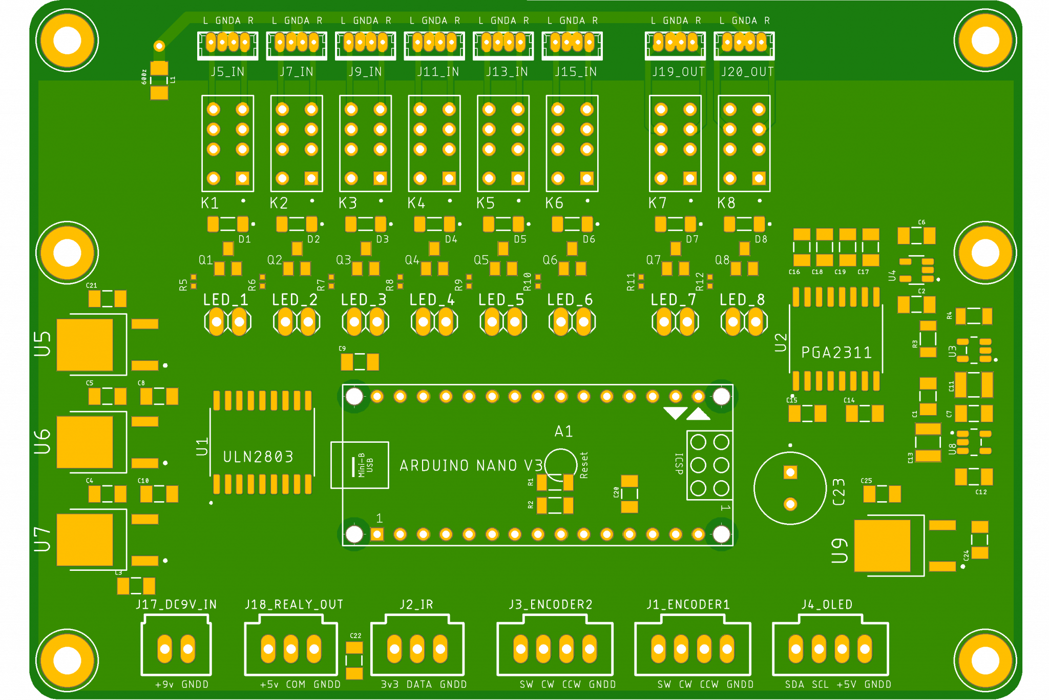

Arduino+PGA2311 Ultimate PreAmp with OLED and IO switching

Adding more inputs means hardware and software changes, minor but still a design change involving a new pcb
Imo I’d just put the mcu and what’s on the Nano on the existing pcb and forget the nano, you have smd on the main pcb as it is but no big deal, allows for more I/o
Reactions: aditya
If two pin selectable option was not used for cs and mute than we would have two more pins free for input selection we could have more input select pins.
This is just a suggestion I mean no disrespect to the developer as I feel he has give some more facility by doing what is done.
Yes you can use them as digital output’s and also as digital input ie high or low.
I see your point.

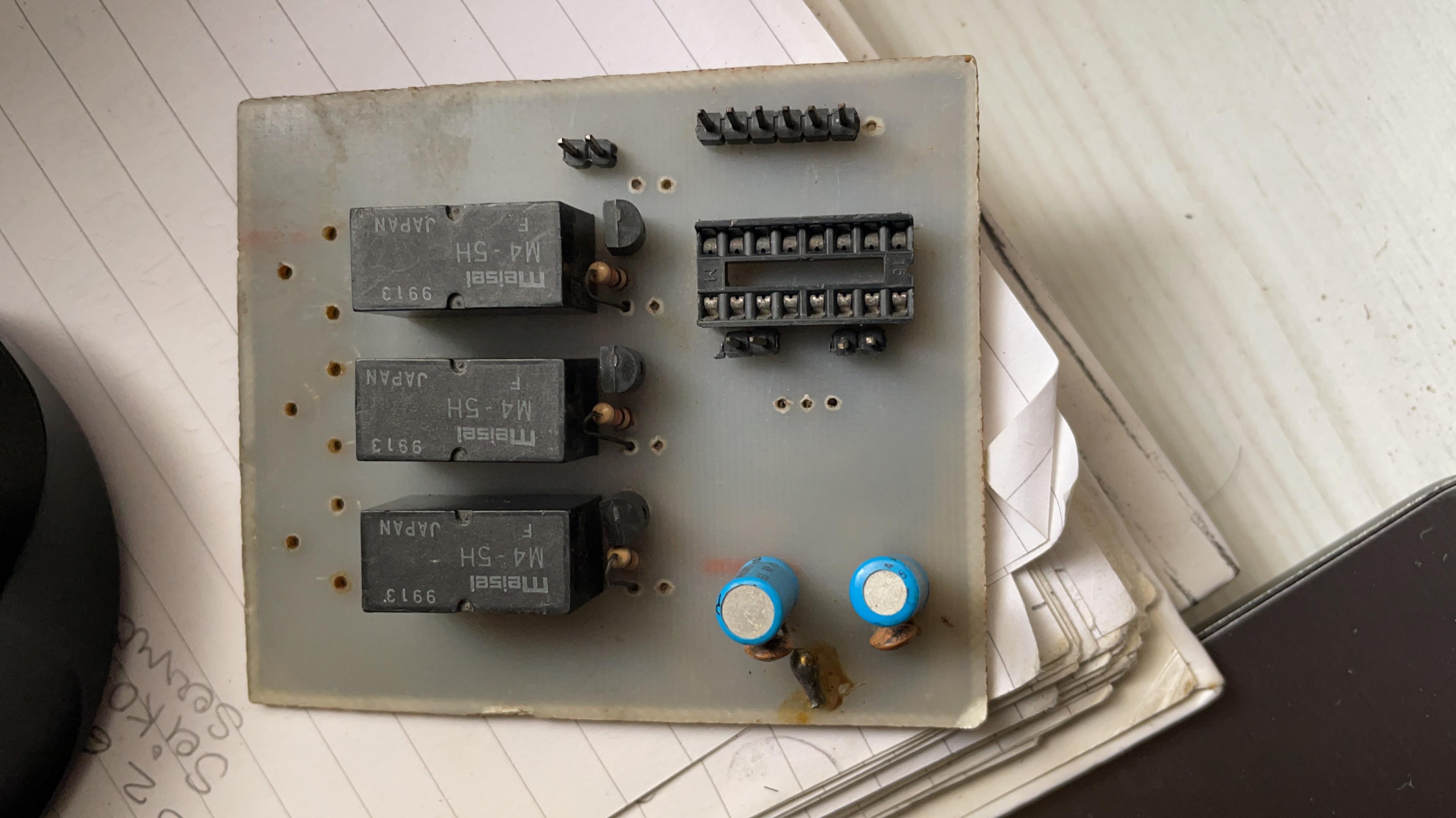

alright I went back to my project which me and a friend had built in that a custom PCB was made and I had burnt a uno boot loader so I was using those pins. (may be my Oooops )
Note - I correct my self you are right about those option pins are only good as inputs
A6/A7 can only be used as inputs afaik. I added jumpers in case a find a way to use them as outputs, but I was not able to. If you find a way, you could have two more I/O lines.

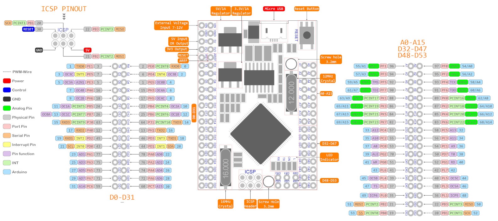

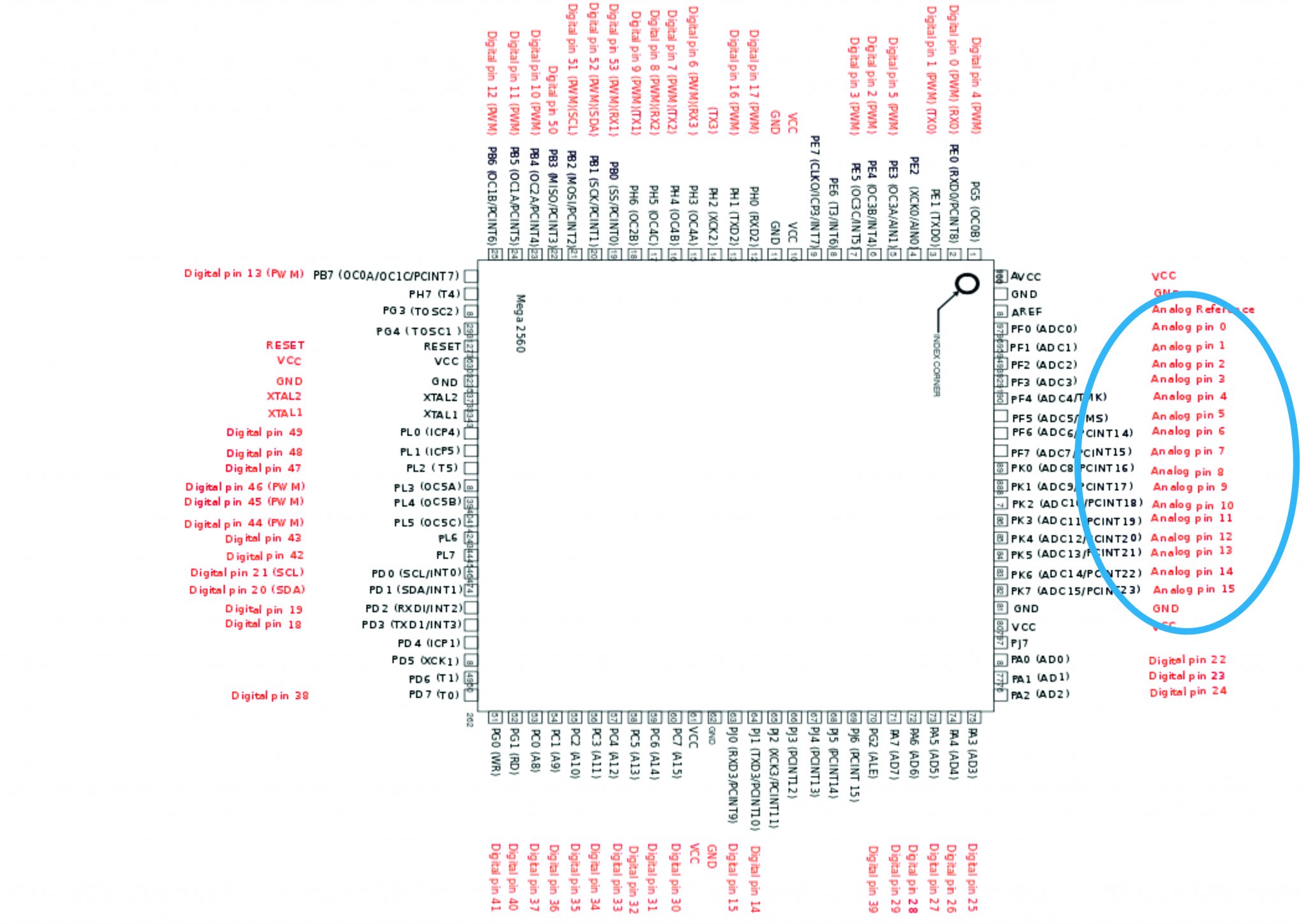

what if we used arduino mega 2560 pro mini
looking at the diagram of the Atmega 2560 there are more I/O than enough
it's more expensive but it solves the problem I think ...
