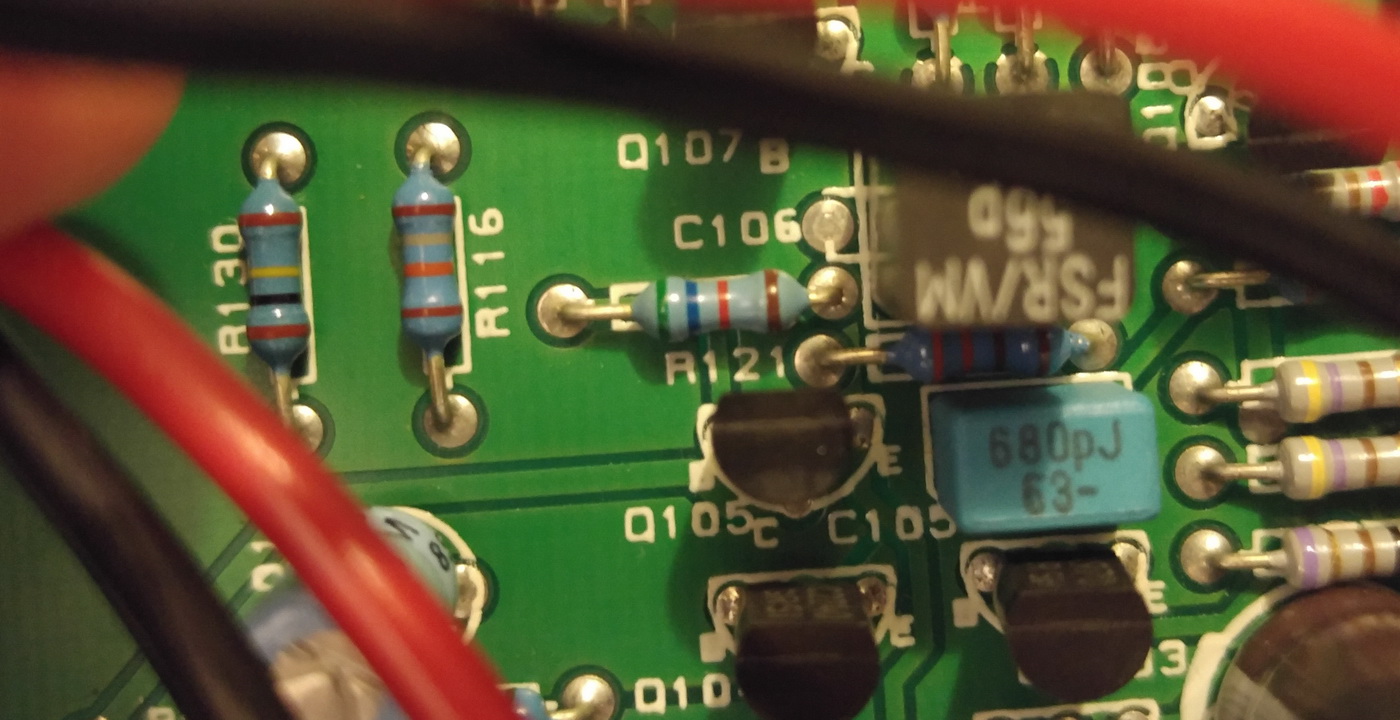

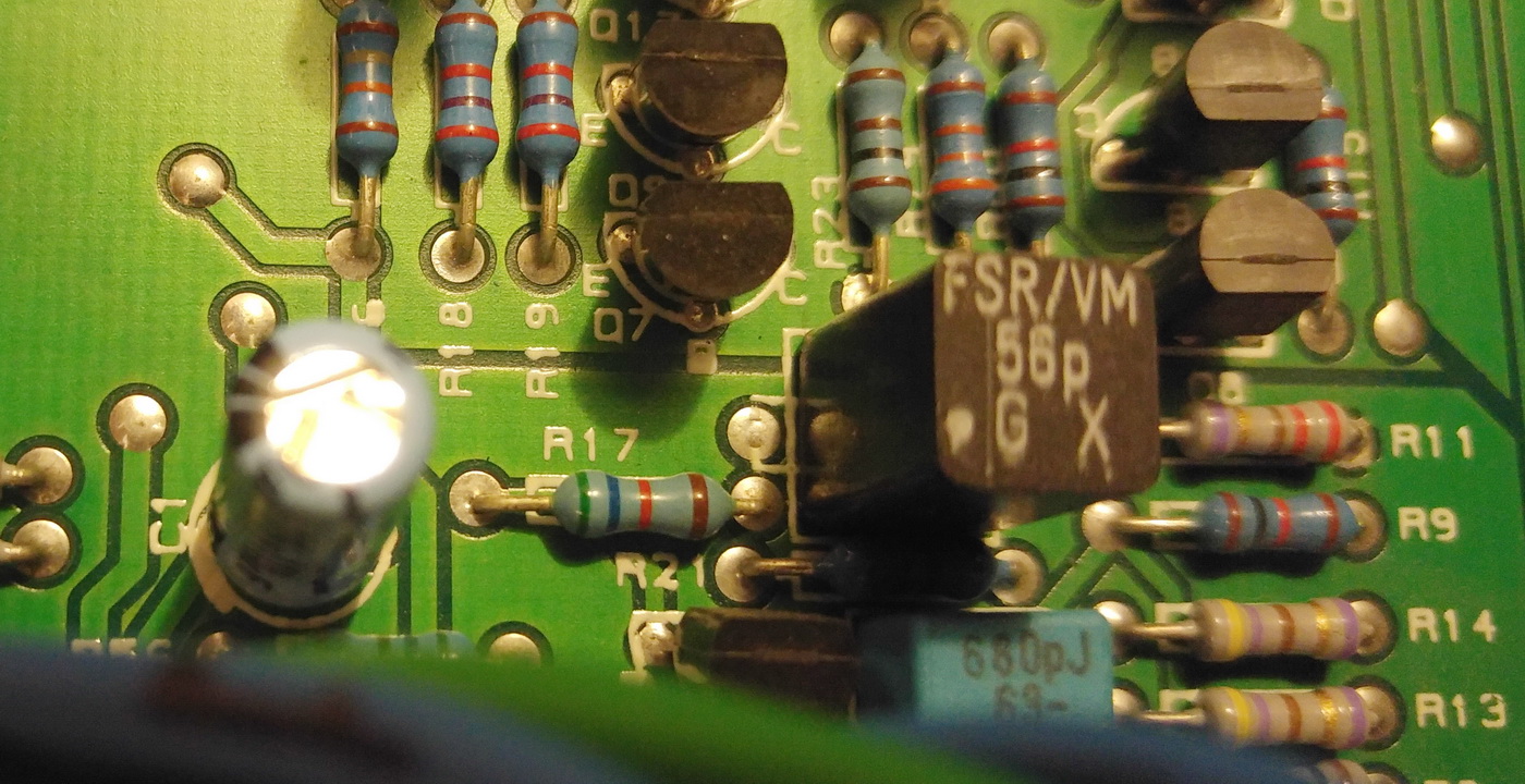

OK, I think R121 is actually the number for the capacitor to the right and R117 does not have a number or its hidden somewhere under something else. Check out 2 pics.
What setting am I checking these at.

7mV is right, and in line with what the service manual says (6-7mV giving ~60mA bias through the outputs)
0.1mV is definitely not. There is something wrong on that channel. Parts prefixed with 100 ie R101 means the right-hand channel, according to the service manual.
