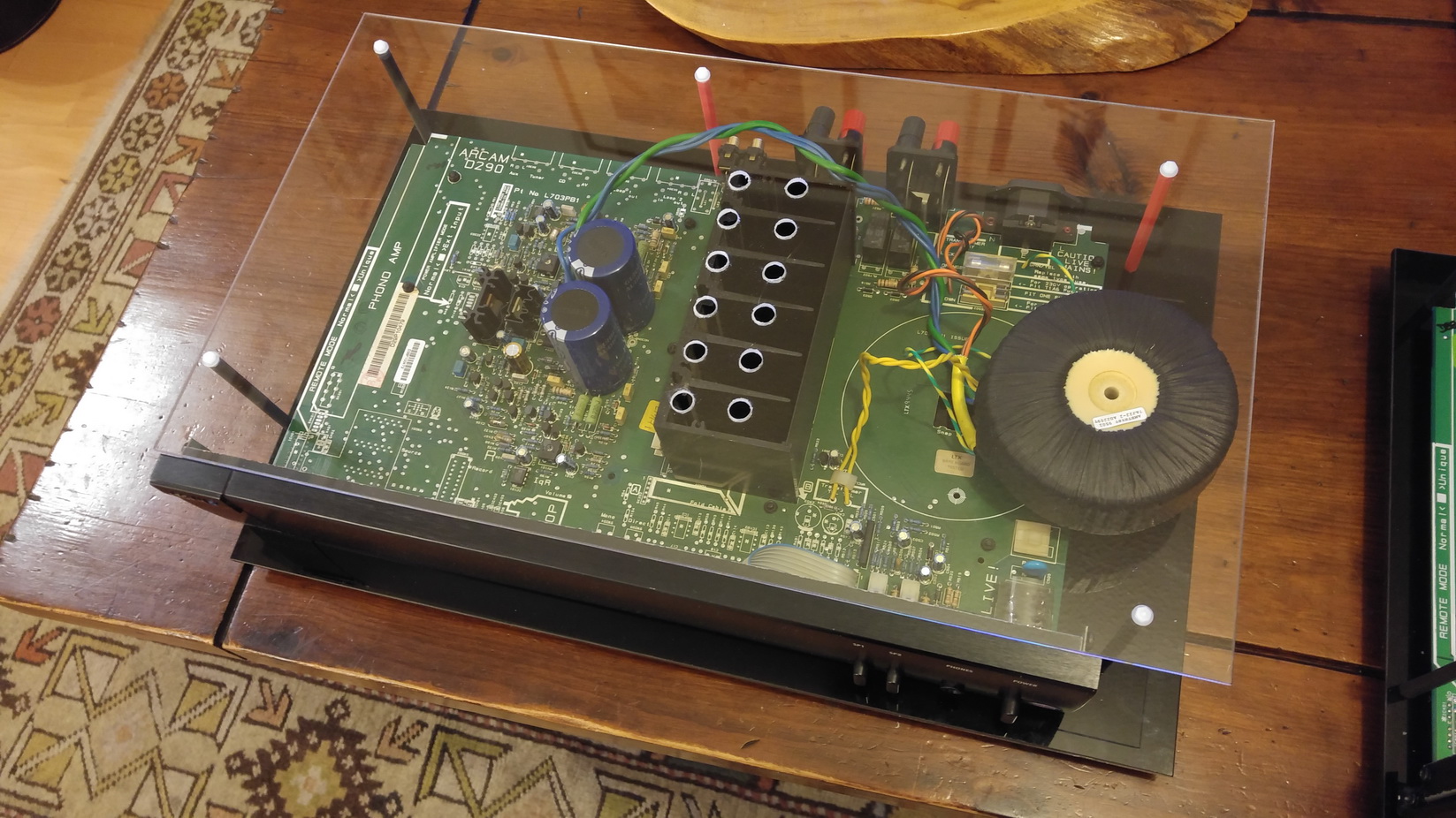

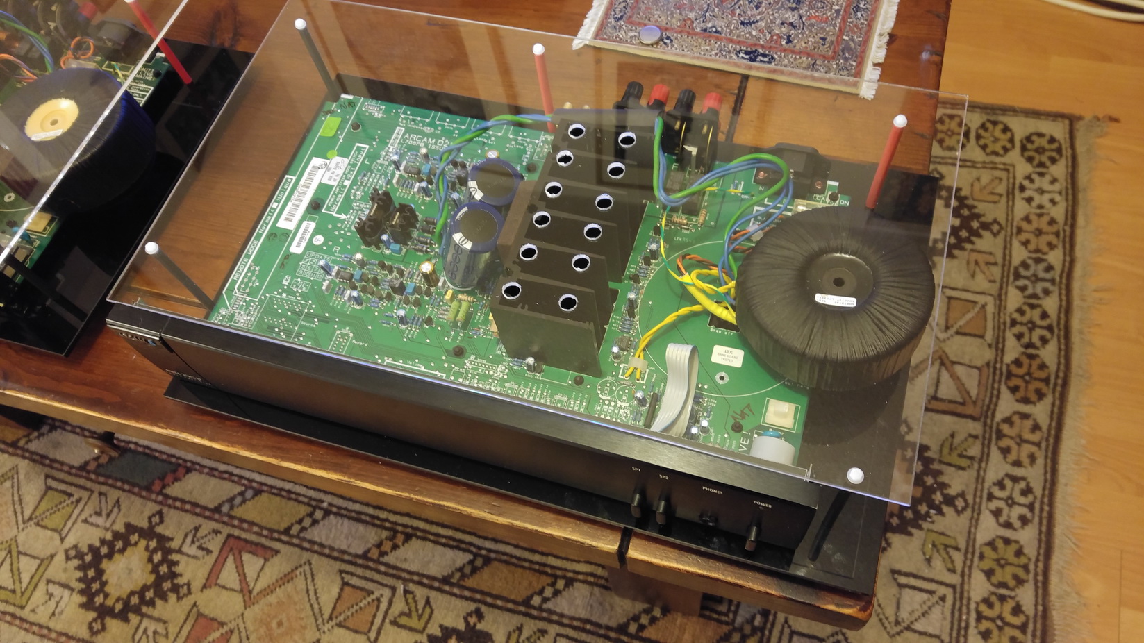

Well, its all completed and back in working order! So I had obviously fixed the problem when I replaced that diode, but then having got the green light and no fuse blowing I had decided to go right ahead and replace the capacitors whilst I had the thing open. So when I then got the problems with the right channel I just assumed there was still a fault. Little did I know that I had broken the link between the top and the bottom of the PCB.
Anyway, it took a couple of turns of trial and error to get the soldering right top and bottom. In the end I didn't need spacers as the short wires are stiff enough and the caps lean against a small foam block sandwiched between them and the heat sink. I have attached a couple of photos of the amps in their new perspex mounts. Sounding great now.
Thanks for sticking with me!

Yes, thanks. I wish I had done the thorough testing sooner. The bulb test apparatus was such a simple thing to do. Plus I had initially excluded C201 from my testing due to its position, but once I realised the link from D102, crossing over from the underside to the topside of the pcb, and then to C201, it all seemed so obvious!

And the perspex is not so I can look at the guts of the amps it was for sonic benefit. One line of thinking at least (DNM etc). Certainly improved the clarity of the amps quite noticeably.

Whatever the apparent sound effect of removing the steel covers, I don't like the chances of proper cooling there and the heatsink fitted is truly minimal. You'll need to make a lot more holes or open space above the heatsink to encourage the full vertical, designed air convection flow rate under that top cover sheet - or just wait and see how hot they become and smoke begins to rise while the perspex warps and discolours after a few sessions of some hours at decent volume 🙁
As these amps never seem to get very hot at all I decided it would be fine. If things start getting too hot then I might make changes. Its all open around the sides anyway. And things don't get too hot here in Scotland anyhow!
And yes, it does look better, although that was not my incentive.
Its basically just an acrylic sandwich. Thick black base and thin clear top. Even all the spacers, nuts and bolts (M3) are nylon! The only bit of metal case that I couldn't remove was the front plate which is riveted to the pcb and also it holds the front switches and headphone socket. And anyway it allows me to hang the decorative front fascia back on.
The toroidal units were previously suspended on metal beams but now they are isolated on what can are best described as small bird tables! All in all I am pretty pleased.
