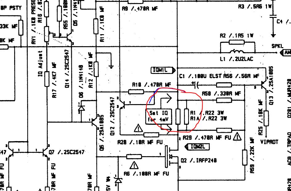

I would start by checking the voltage across R1/R101. You want to measure ACROSS this resistor, in millivolts mode on your meter.

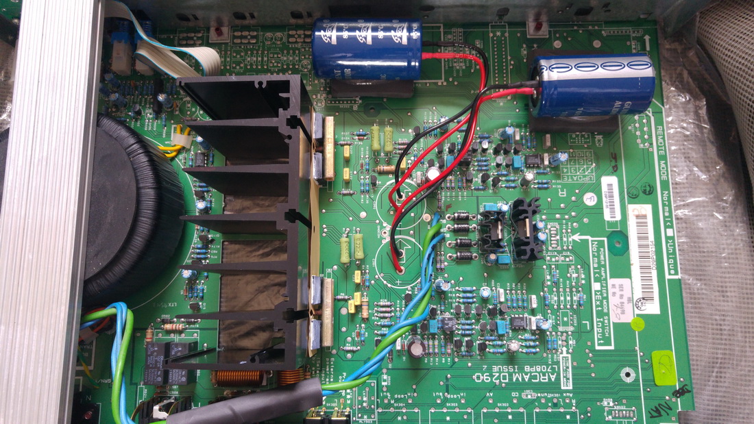

Picture after work
Here is current image since repalcements
OUCH. No. Do not do that with the power supply capacitors. It will not be causing your fault, but it WILL impair the amplifier's performance, as those long wires are effectively inductive resistance. Put the old capacitors back in if the new ones dont fit in place.
Measuring bias can be done as i described, by measuring millivolts across resistor R1/R101. Bias current is then mA = mV / 0.22
edit: Just spotted RA1/RA101 on the schematic, so thats actually 0.11 ohms resistance. So ias current is then mA = mV / 0.11
