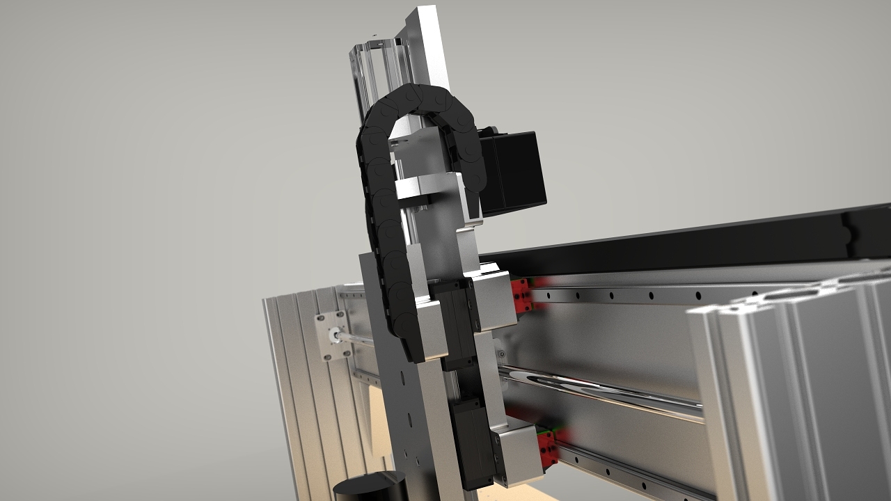

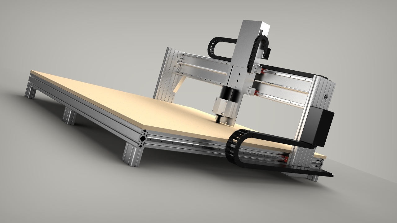

Complications with the Z axis mean a complete redesign of this assembly was necessary. I've done the CAD work and passed it onto a machinist friend of mine who'll cut the parts. Its being done as a favour(ie. cheap!) so its when he has a day to spare. For now I'm back using good old reliable methods!
To say I'm disappointed with the manufacturer of the CNC would be an understatement.
That sucks. Sorry to hear.
Love the renderings, but, are you sure the vertical arms of the gantry are wide enough to prevent flex (specifically the blocks that run along the longest axis on the machine being far enough apart to make the gantry stable)?
Looking at my much smaller machine, the width of the gantry legs (below where the black box is in your first render) is 8" (~20cm).
Not really ideal imo.
The spacing on these are 200mm too but without redesigning the entire machine(thought about it!) and spending months and ££££ its something I'll have to learn to live with. In practical terms its going to limit feed rate and DOC but considering the soft materials, wood and plastics, that it'll spend most of its time cutting there are other limits such as the stepper motors lack of torque at higher speeds that'll make it difficult to ever really see the limit. In a sense its a somewhat balanced design there.
Ah OK, if the width of the uprights are 200mm all the way up then they're sturdier than my machine (200mm reducing down to a smaller width), and I've not noticed problems running a 1/4" bit with a 1/4" depth of cut at 120" per minute (~3000mm/min) through MDF.
You may well be OK with that then - especially as you've got the spindle, which will have way more torque at lower rpm than my router.
