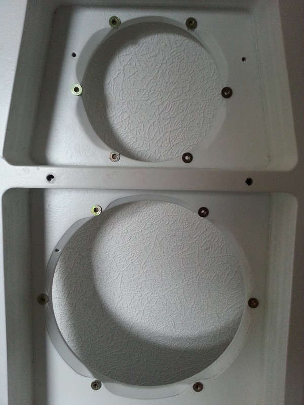

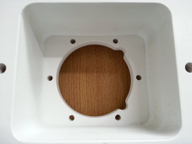

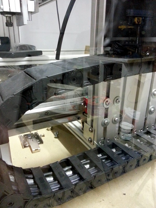

Shots of baffle rear.

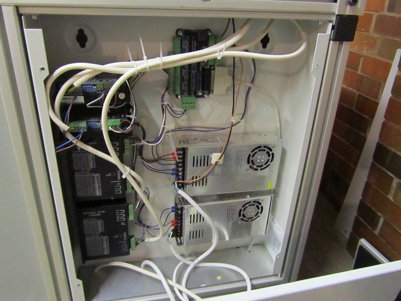

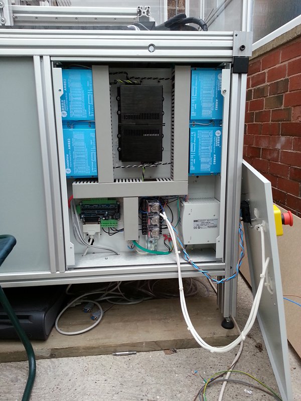

The cnc upgrade continues...
Control box received a large overhaul. Virtually everything replaced and now running top of the line digital stepper drivers along with dual 75v PSU's. Also features a relay operated safety and control system with 24v home switches and limits, tool height probe, spindle start/stop and coolant pump on/off control.
Before:

After:

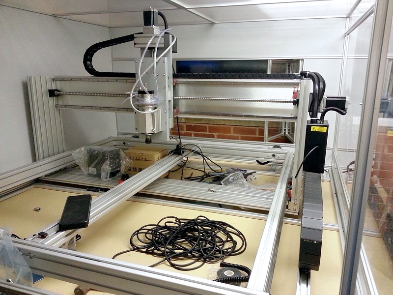

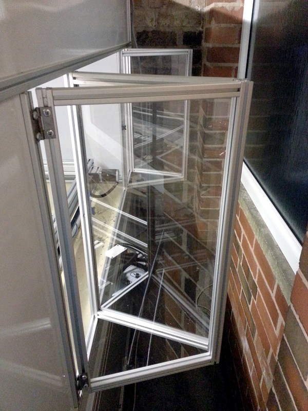

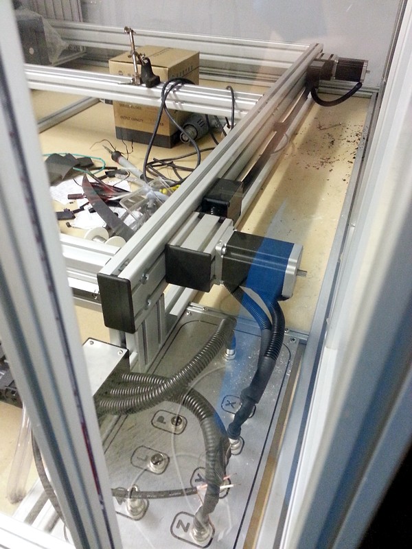

More jobs done like the home switches, sliding doors and the rewire is finally complete(*#&! of a job! Will be glad if I never have to strip another wire in my life!).
Only the spindle plumbing and refit the x axis screws left.

That's quite a difference with the control box.. from something home-brew to a thoroughly pro layout (..actually well beyond what you often find). Reminds me of some of the best enthusiast computer builds out there.
I'm starting to think your loosing a lot of pounds on this build, and I don't mean personal weight. 😀
Thanks qusp, Scott
Its cost about an extra £1000 on top of what I paid for the machine but that's not what irks me. Its the hours spent and down time. Still the experience has had its benefits too. You gleam a lot of knowledge on the inner workings of these things and that can only be of help when it comes to maintenance, setup and troubleshooting.
