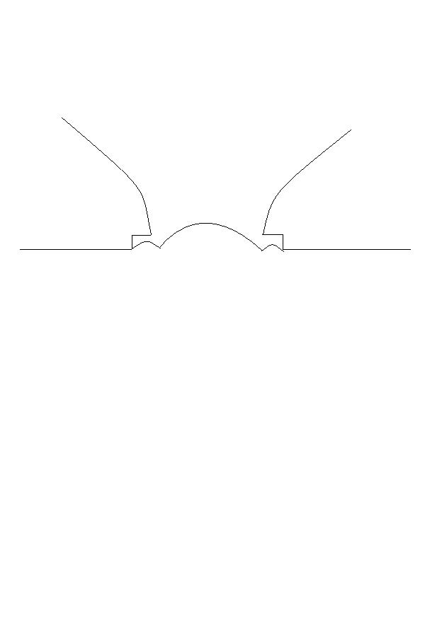

Here's a better view badman as the renders are largely useless for giving anything other than 'pretty' overview.
Ah, that's better- I'd still consider pulling the throat in a bit and even allowing a small gap to have the throat exclude the surround- in other words, the surround is in it's own little area and the throat begins around the periphery of the main dome. At frequencies where the surround is contributing anything useful, the barrier won't be an obstacle, and it ought to improve the polar consistency just a little bit more, as well as suppressing the distortion source that is the flexing surround. Since you're using proper mids and waveguide loading the tweet, just a small gap is all you need, you don't have to worry about the surround hitting the inside of the lip shown.
Forgive the 2 minute render.
Yep that's the sort of direction I could go without the faceplate. I'd be a bit concerned about the cavity created by overlapping the surround. Could be a source of resonance and reflections. Just a gut feeling and gard to say without building and measuring but that's the beauty of CAD and CNC, you can test ideas like this without much trouble at all.
The idea here is that the lengths involved are very small indeed- where resonances are a bigger concern are in the larger apeture size of the "surround inclusive" version. You could always angle the piece covering the surround if you wanted to, this is what I wound up doing when coupling domes to horns.
