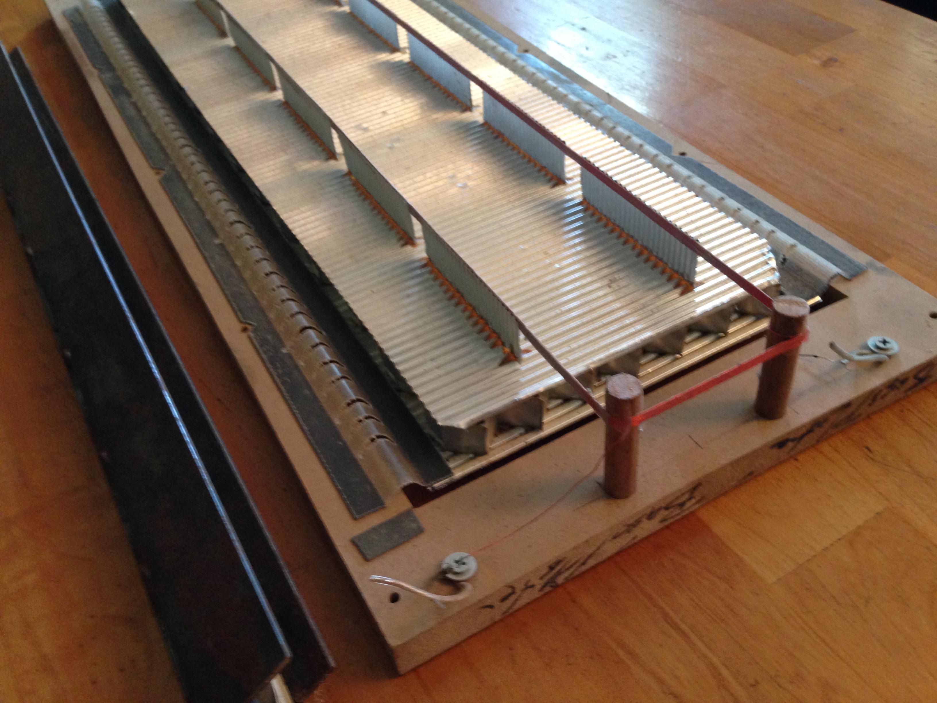

Well, having nothing to lose, performed silicone treatment on my both pairs of Stages. Used A + B component Ecoflex – 00-30 and silicon oil. Firstly, tried several different mixtures but already mentioned 2/3 of silicone mass and 1/3 silicon oil looked the best.
I had no luck with medical syringe, used 3-4 different sizes, but could not perform equal flow which was rather erratic making a big spill. So, I tried applying mixture with ordinary artist tiny brush which perform very nice. Silicone applied only on the front side.
I tried to remove the back perforated metal plate which is factory fixed to mdf frame with silicone, but that was very hard, the plate began to bend, so I decide to leave it.
Sonically, can’t say that I can hear any difference, but I am sure that the current foam condition will not deteriorate.
Just to point, it is important to mix both silicone components and oil thoroughly, at least about 5 min.

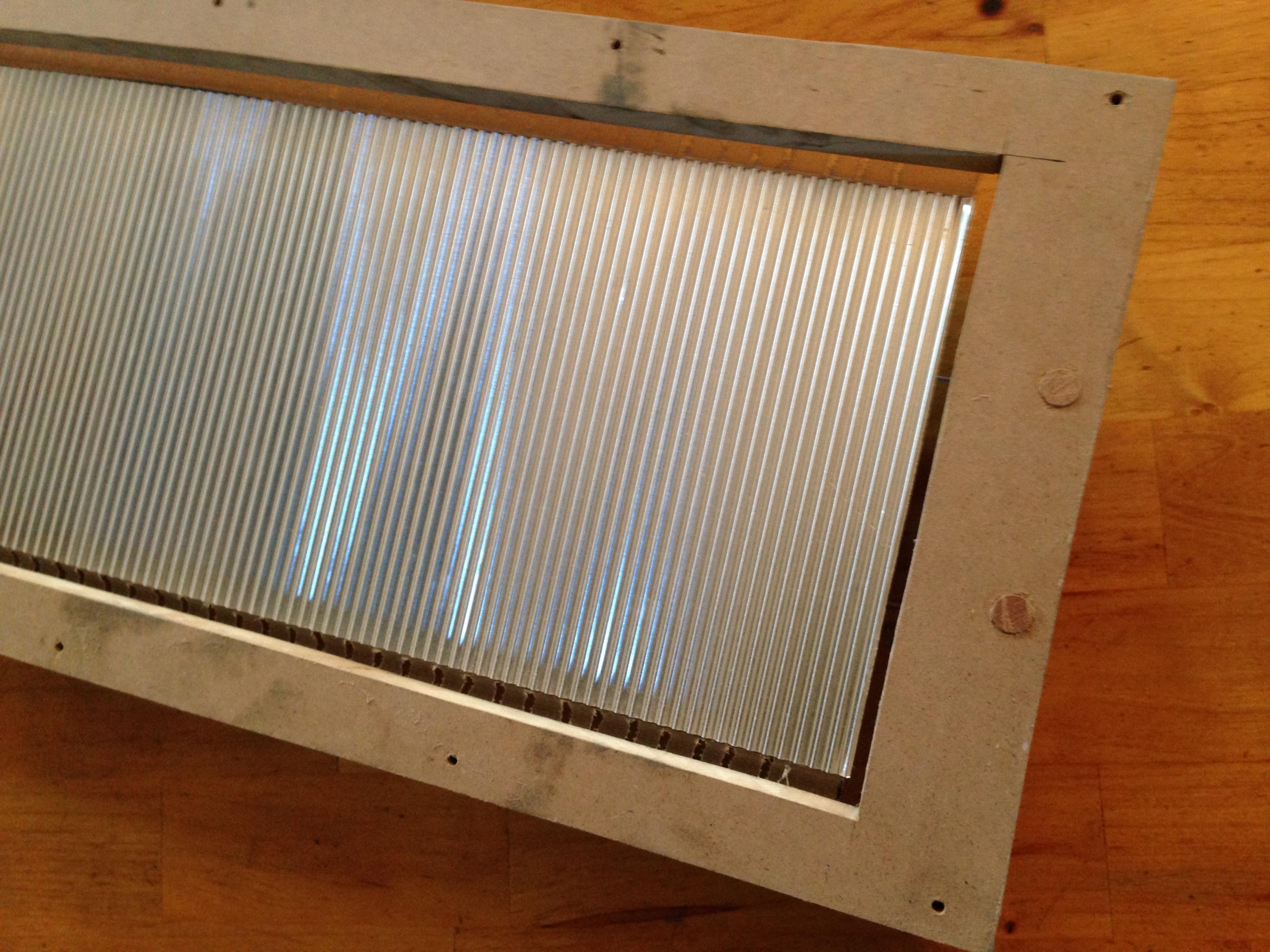

Im a little surprised someone with totally trashed Stage panels hasnt simply tryed stripping them and installing a simple flat tensioned film diaphragm. Ther not teribly hard to make. A bit tedious cutting multiple traces but doable. Overall sonic will be just short of App panel in some ways but not bad.In fact if you use some nodal buttons like on Maggies it should be preety good.
Im not sure what method some here are using. I simply....
1- on a glass panel spray a very light coat of that cheap spray adhesiv like super 77, very thin light coat.
2- roll your foil out on this and use a cloth to rub the foil down flt and smooth
3- cut your traces using a roller cutter from fabric store
4- on a seprate frame made nice and stiff with big open area, roll the mylar film out and tension it with about a hundred pds of tape around edges. just keep going round and round retightening tapes till all it very tight.
5- spray a heavy coat of same spray on the foil
6- lay the tensioned film over the foil and rub it down smooth with cloth to adhear
7- starting from onecorner slowly lift tensioned film /frame up and foil will come with it.
9- may have to retension with a few new tapes at edges
10- lay bead of silicone adhesive around the frame you applying your fancy new diaphragm to and lay down the tensioned diaphragm
11- push down areas evenly where silicone adhesive is and waith 24 hrs for i to cure, cut diaphragm edges away
It will have some ugly resonances around 200 hz but for most part you will be suprised at the result.
i found 1/2 mil mylar and .7 mill foil to work about best. Thats the same foil thickness you get fron standard kitchen foil BTW not the "heavy duty" stuff. Its not tempered but if your not corrugating its fine. Havent done the math but I suspect 3 traces one side will get you in the ball park of 3 ohms
yes its slumin it but hey if your panels are trully ripped useless it doesnt cost much to try this. A few dollars of foil and plastic.

lowmass... well you pull-move any of the magnets with your new foil traces?.....can you move them or well they brake?...you may not know...
I have seen others use foil strips on mylar....from top to bottem...for the bass driver....with what looks like some type of mylar to rubber...on all fore sides...
I like the look of your panels.....neet..thanks for your info... more pic...
