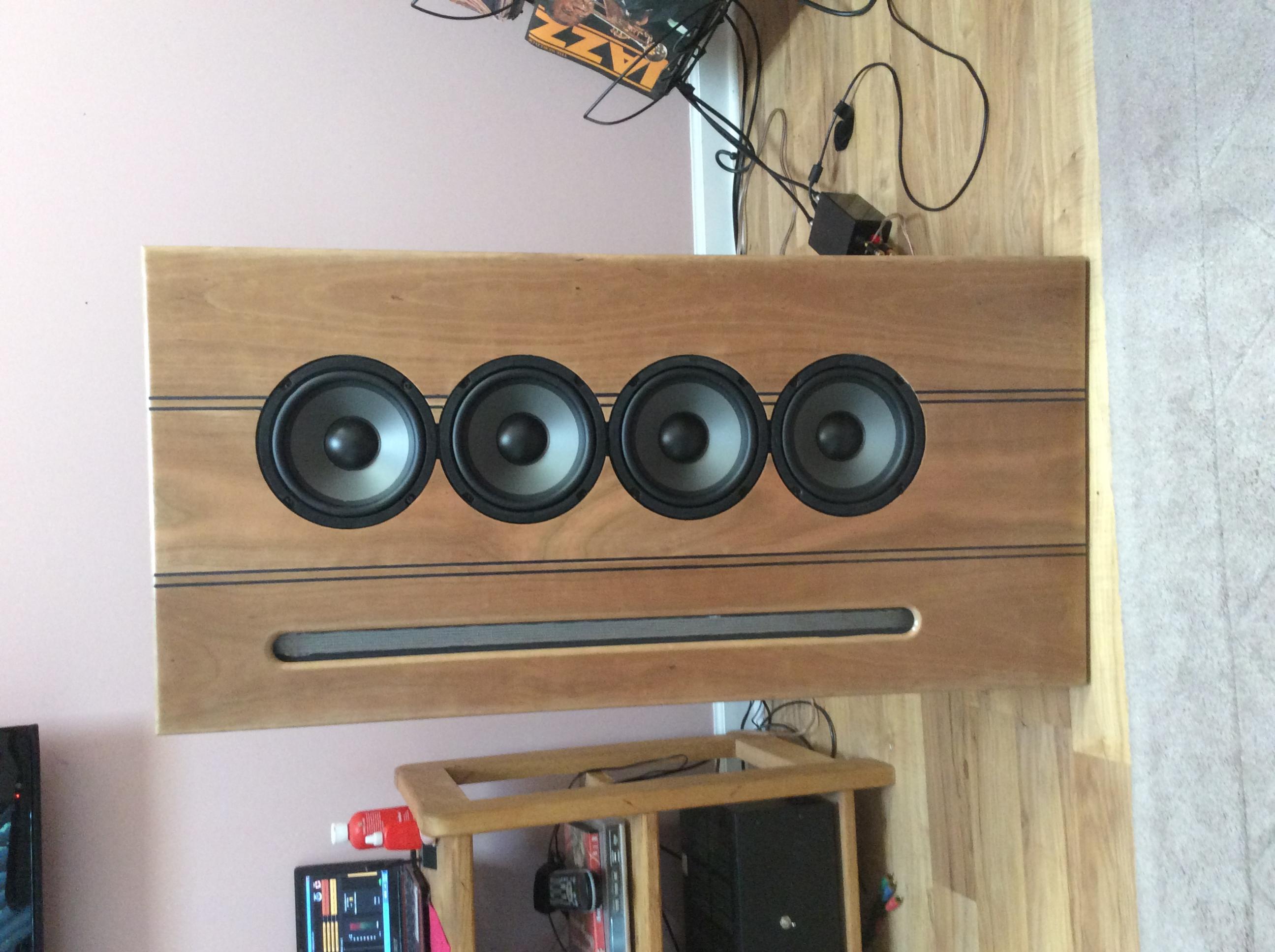

Latest ribbon iteration
Recently made a totally new baffle/frame for my 26"ribbon and 4 no-name
woofers.
The front panel is 3/4" cherry backed up with two 1/2" plywood panels with cutouts that provide proper spacing for the ribbon assembly and a rear waveguide.

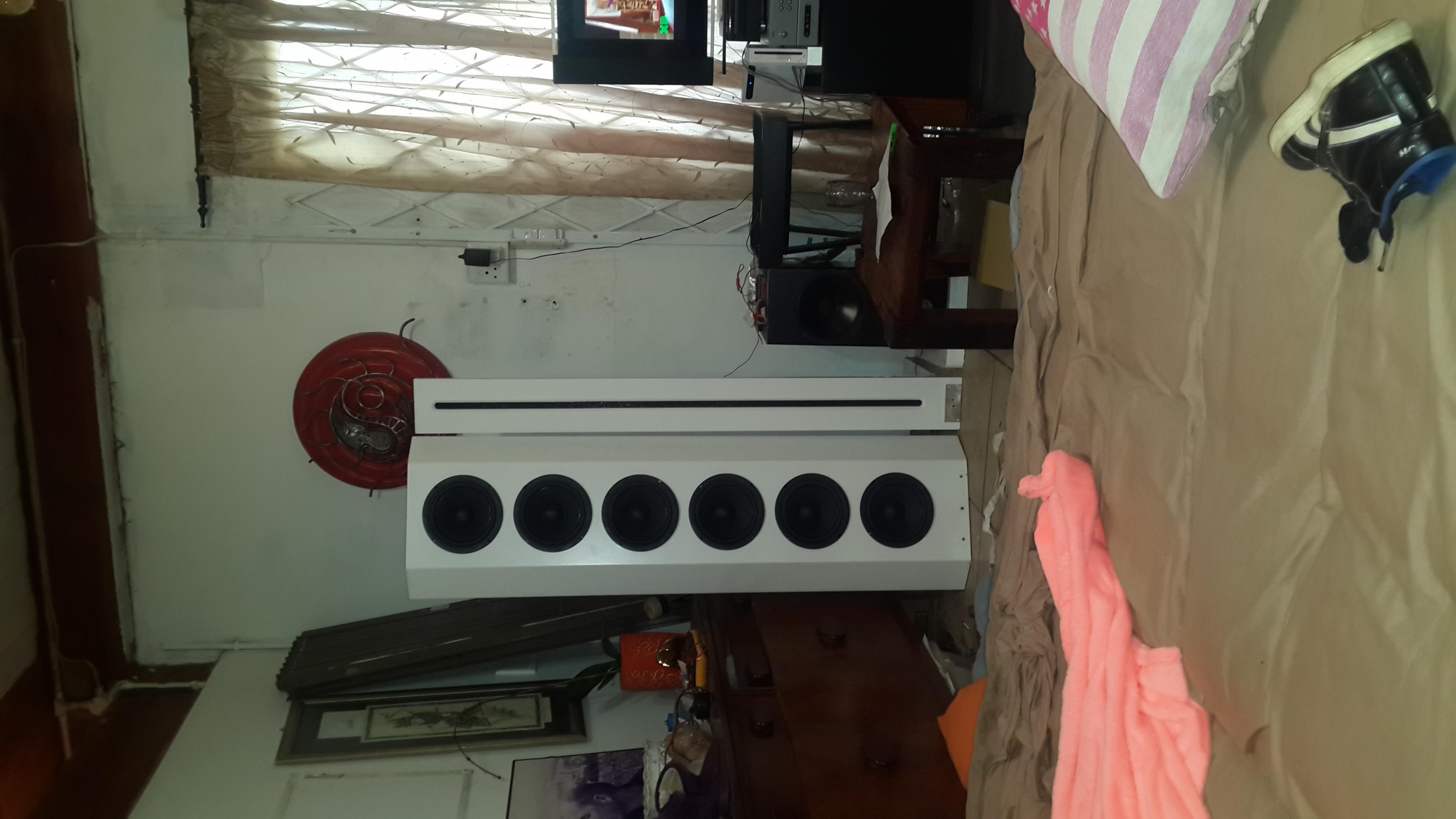

Tel me how have you wired the drivers and what xo have you used on the drivers and ribbons.
I am busy with a similar project but I am using some very cheap light weight 8" paper drivers but 6 per side.
I am struggling with the wiring of the drivers should I go with the power tappering method not really sure or experienced here.
Peter: Once again you completely embarass me with my slow progress. That looks lovely. I do have two questions
1. Can you move the woofers any closer to the ribbon. With a 450Hz X-over not an issue but certainly a bit far apart for higher ones.
2. It looks like you have lost the 'wings' your last version had. Will be interested to know if that has any effect on LF response or whether you have more than enough headroom to eq that out.

IMO, you should not power-taper the drivers. Just wire in a normal series-parallel configuration to obtain a nominal impedance.

Hi Dave,
So would it be 3 parallel and 3 series would a negative come from the top series driver and the positive from the bottom parallel driver?

Just Google series parallel speaker wiring and use a six speaker example.
Shavano Music Online - Speaker Wiring/Loading Examples
When wired correctly, all six speakers should move the same direction and exactly the same amount if excited with DC voltage.

Brian....as Dave has suggested I usedseries/parallel arrangement and crossing at 350Hz LR4 both high and low. Not completely finalized yet.
Bill.....my previous mockup didn't have wings and these are an 1" wider at18".I have a little eq and the one reminds me a lot of the original Quad. The woofers on the new one are 1/2" closer to the ribbon.
