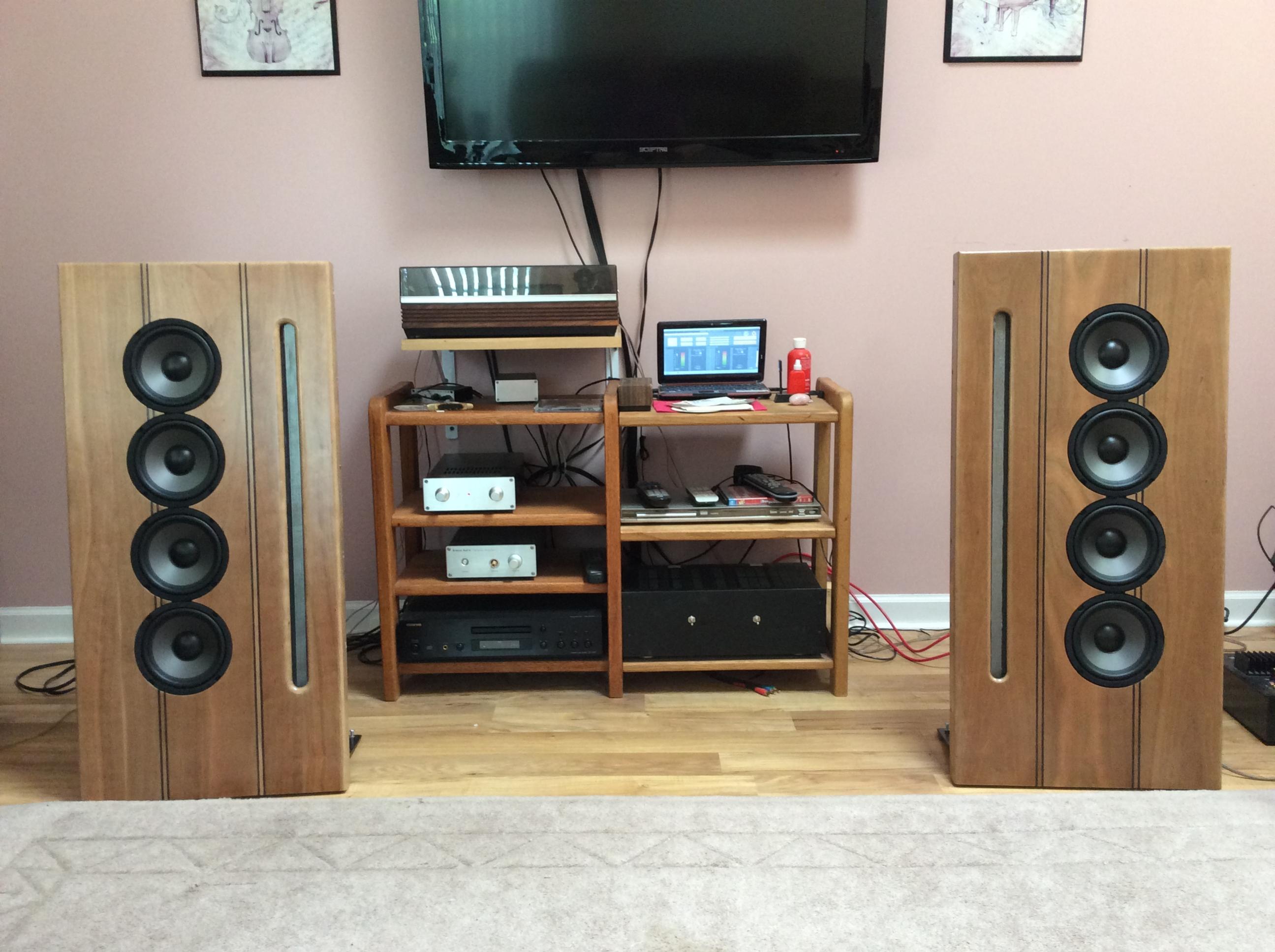

Just completed the second speaker and now I am in audio heaven. I attached some rather beefy shelf brackets to the rear panel with adjusting screws for tilt.
At the moment they are each powered by a stock 3116d2 amp and sound pretty darn good. These will take pride of place in my music room, at least for a while.

thanks for the pic.....cool look...
Wow as close as they are in your room...I guess you got Bass......

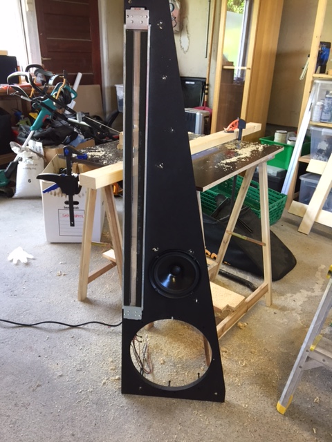

Hello,
I am busy with a similar build to the image attached.
I am looking at crossing over at 125hz to a 12" then to an aluminum midbass 5.5" @ 800hz then to a 40" 5 segment ribbon.
The ribbon is 20mm wide and I am using neo magnets that are 50mm long by 10mm x 10mm.
Whats your thoughts on the design and xo?

1- your baffle is quite small for the 12 inch low end. That small baffle will be rolling the low end off starting quite high in feq say around 300 hz and down. The EQ nessasary to compensate will send that driver into overload to get a flat response below 150 hz or so
2- your 5.5 inch is better mounted close to middle of ribbon
3- going from a "line" (ribbon) to a "point" (5.5inch) may result in one ideal listening distance. It can certainly work BUT be aware you may want to experament a bit with both sensativity level and listen distance
bill
what supplyer do u want to use?
bill

My goal was to roll off the bass at 125hz and xo to mid but my concern was the distance between the bass driver and the midrange being situated so far apart in the middle of the ribbon. I know the Apogee hybrids use to position the midbass in the middle of the ribbon. This image was of a Dali skyline 1000 but there xo frequency were 250Hz & 6000hz. The 12" is a fantastic dipole driver that costs like 25usd. Hybrid 12h150

Bass to mid distance shouldnt be an issue at that low x over
much more important from mid to ribbon
In the end u can get all sorts of arraingments to sound ok BUT over time the ear starts to hear the issues and it wont know whats wrong it will just kno somthing not exactly right.
I pplayed a bit with 12 inch with a small woofer to fill in just like u have there. In the end I actually liked the sound better when I got rid of the mid driver and x over from the 12 straight to the ribbon. It was a home made 12in with an exotic cone that was farly clean beyond 1 khz. Sure not as good as the 5
inch BUT to my ears the 3 way never sounded as "right". To many issues in a critical range.

Okay iv also have given a lot of thought around just going 2 way the ribbon certainly does well for 350hz to 20khz -4db. So I think should just go 2 way and xo at say 500hz I just need to go active on the bass.
I think the 3 way just complicats things.....

yep many cones are good to 500 and 2 way is an order of magnitued easyer to get right
