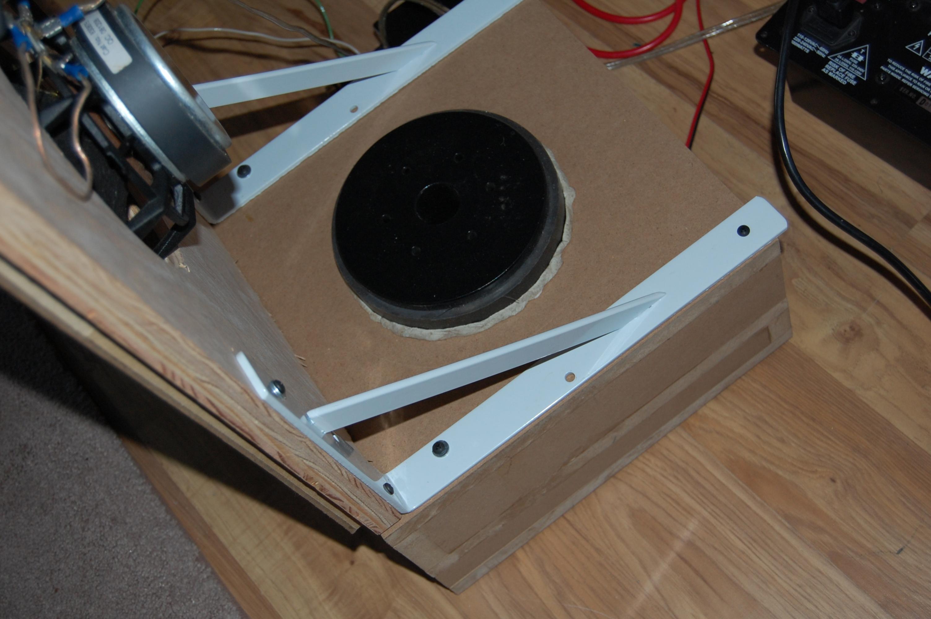

yes the back come off the stages...pic 1...no other Apogee bass panel is made like the Stages.....if Jason had lived....I think there would have been more bass panels made like the Stages.........pic 2...there a small strip of foam that's under the foil....all the way a round the edges.....front an back..
this foam ....is what come off over time an makes the dreaded .....buzzzzzzzing... that what this... man is fixing in these great pic...
All other Apogee bass panels have the magnet an pole peace monted from the inside...this deaden the pole-peaces an magnets....kills more output...ringing...call it what you well.............
Stages pole-peace.. setup adds more output to the bass panels...if you well.....pole peace works a littel like .....a simthick resonator ..an adds to the sound ...............
I have add mass... like blue dap to the Stages pole peace....an it changes the sound...a lot..... just one small peace.....more bass..but less upper mid.......
but in the end I like the sound without any added mass....less is more
as for you setup.....I cant say what well work.....
all just one mans finding.....keep up the great work

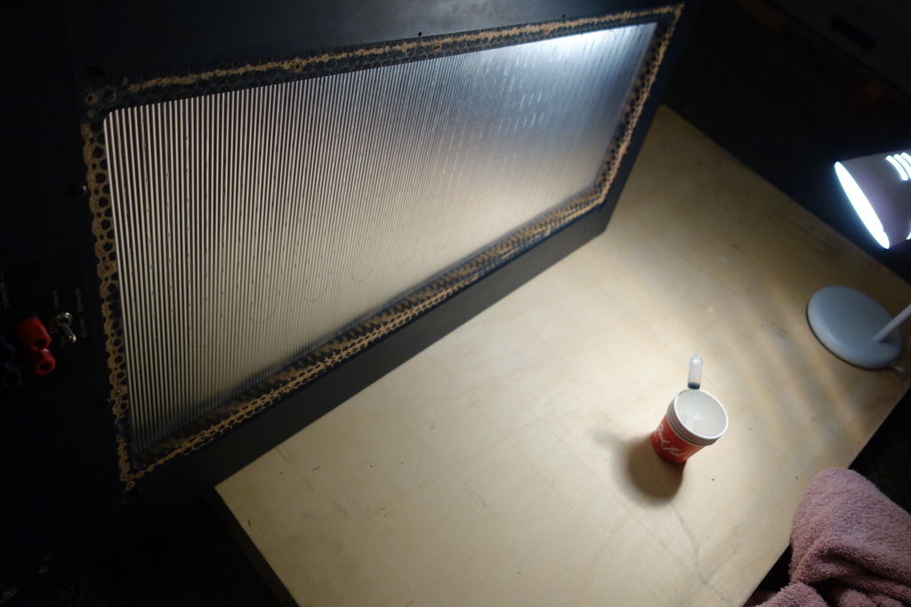

Peter,
The front and rear panels are a direct MDF/MDF coupling. There is no "isolation membrane" between them. The woofer ribbon needs to be maintained under tension (via the spring-loaded mechanism) and a membrane, or excessive adhesive, or double-backed tape, or etc, will not work.
Both the front and rear panels have an edge rabbet to support installation of weatherstripping for edge-damping. This weatherstripping material is the primary failure point of the Apogee bass system.

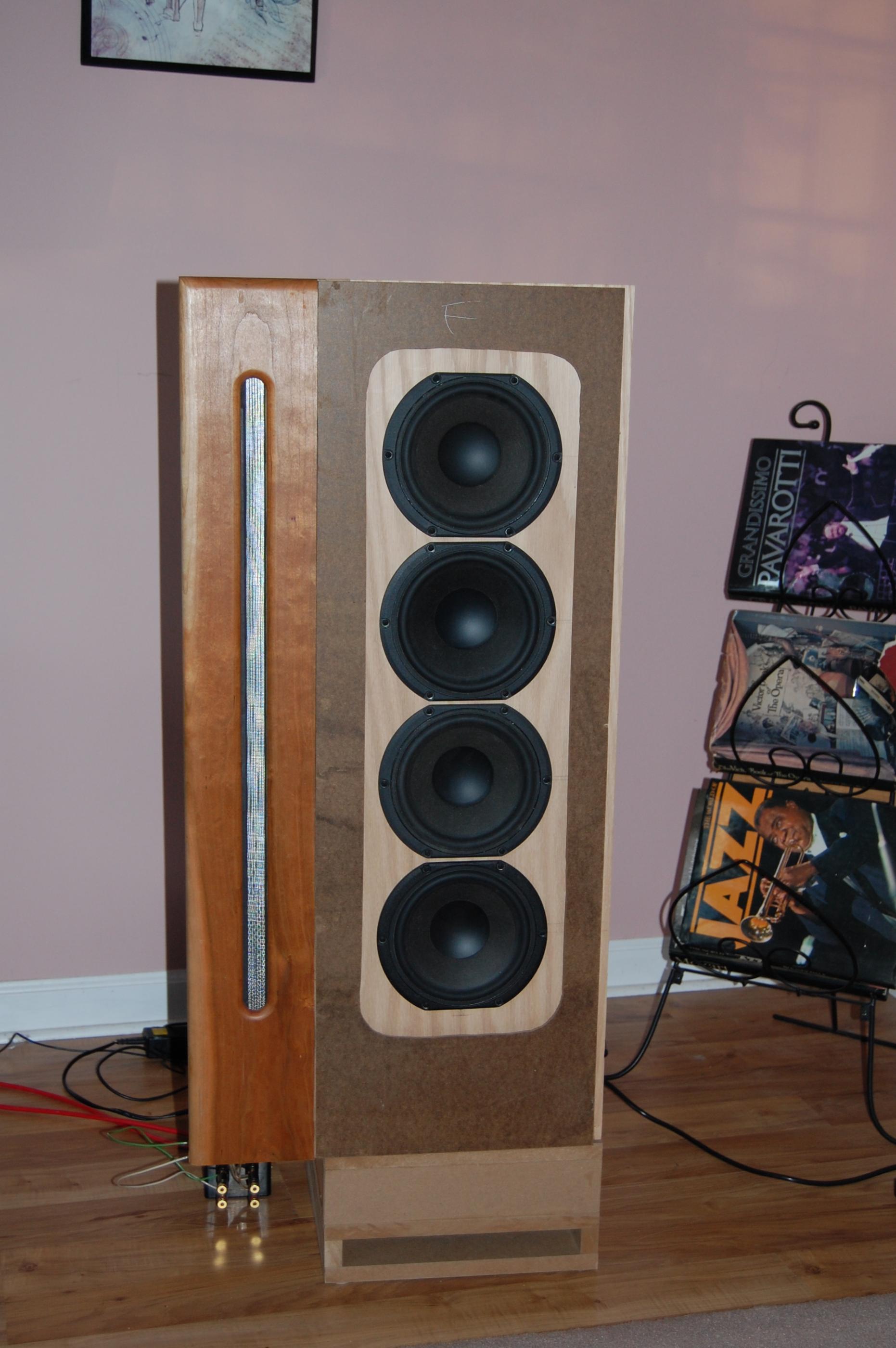

a little progress
I recently substituted the 4 peerless nomex woofers for the no-name cheap woofers on one channel. Just to evaluate a possible "upgrade" for both channels.
In a nutshell, very little audible effect....at least to my ears.
The minidsp is now crossing the drivers with a slight overlap for smoothest response. The ribbon is LR4 at 350Hz and the woofers LR4 at 450Hz.
Attenuation of the woofers is -10db with respect to the ribbon.
I have the assembly securely mounted on the ripole subs which have to be isolated from the wooden floor with felt pads.The local hardware store had some heavy duty brackets that suited the requirements.
Sub plate amps are presently connected via high level inputs and crossed at about 65Hz and flat to 40Hz.

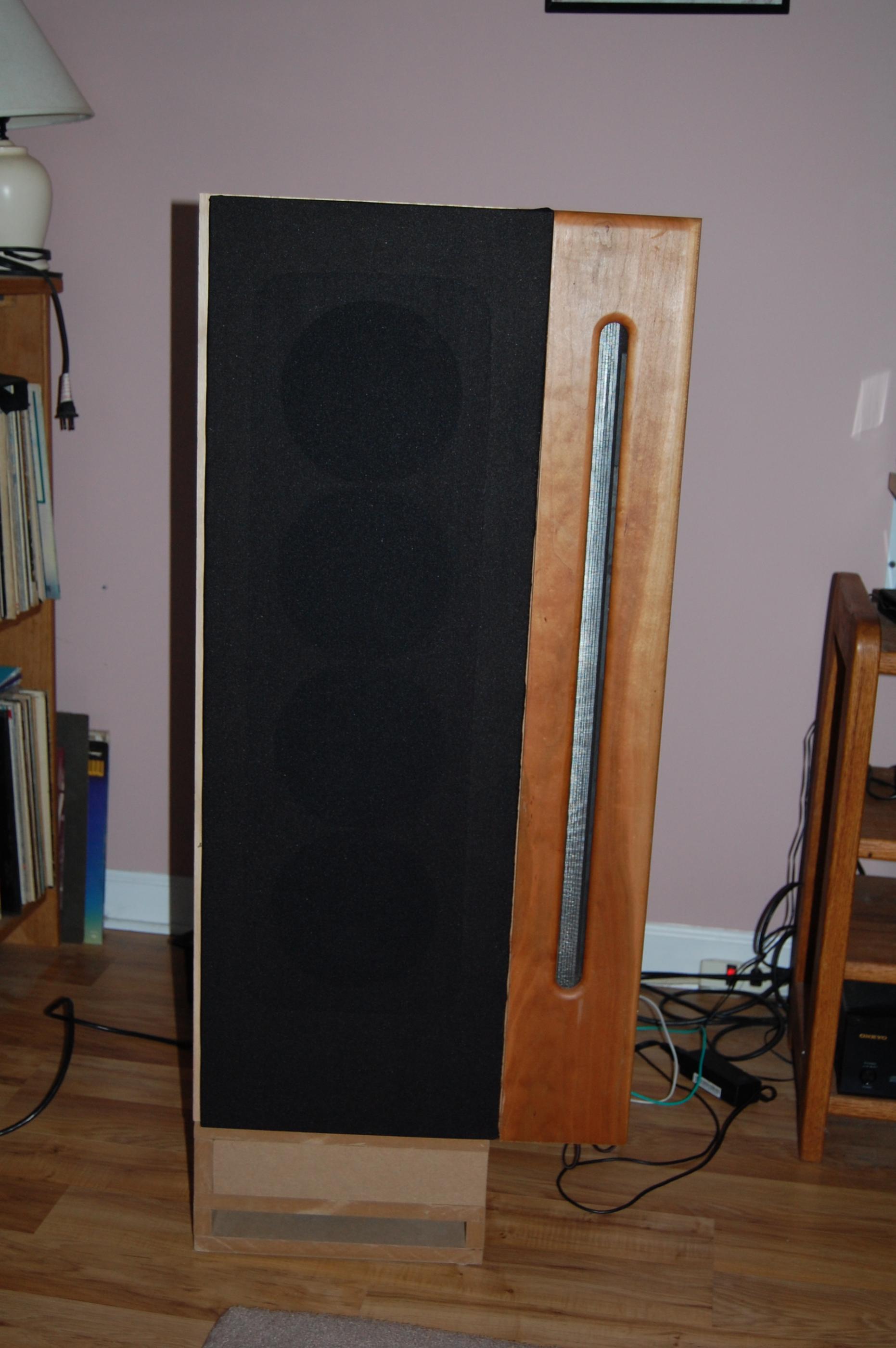

I fabricated a couple of grille frames and the resulting grilles are fairly decent. I plan on making similar grilles for the ripoles.
The wall of sound is quite stunning. I know it sounds trite, but you could almost swim in the spaciousness.
For the heck of it, I built a pair of Meniscus Continuum kits for reference and they do have a very very sweet midrange, but these ribbon assemblies ace them in every other way.
Little more trim work to do when I can pull myself away from the listening chair.
Cheers '
Peter
