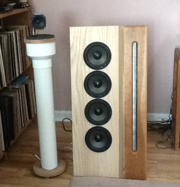

26" ribbon with 4 woofers
This is my first effort at putting the cheap PE 6-1/2" woofers on a panel with the 26" ribbon. The OP may be interested in this.
The drivers arrived in 2 days, so I picked up a piece of decent oak faced plywood at Lowes, cut the add-on panels and joined them to my existing cherry ribbon faceplates. I had some rather flimsy shelf brackets that I screwed to the rear of the panels and used some machine screws and nuts to make levelers. Good enough for initial listening.
I wired the woofers series/parallel and biamped with my minidsp.
Very little EQ so far and lower mid/upper bass is flat down to 100Hz, a little boost below that. Crossed 12db at 700hz. I had to attenuate the woofer input by 17db. The best panel performance I have achieved so far with my various attempts at OB speakers. And the silky TM is as good as ever. No sub being used yet. Just reveling in how good these sound.
The overall panel dimensions are 18" x 36". Shown alongside my version of the LXmini for comparison.
I believe this project is worth pursuing, and I intend to make a back panel to cover the entire speaker with cutouts for ribbon waveguide and woofers.
I may even make the panel wider at the base(a la Apogee Stage) to improve stability and looks(?).

Pretty cool. The basic concept with this type of conversion is robust. You'll have a difficult time not achieving good results....I believe.
It's just a matter of optimizing the necessary equalization and understanding the big sensitivity difference. 17db is quite considerable, yes? 🙂
A trapezoidal shape would be cool. Understandably, it will spread out the response of the additive peak.....and thus your equalization would need to be adjusted accordingly.
And you didn't have to spend too much money either.......I like that aspect the best!
Not what I wanted to hear. Bad Peter 🙂
Seriously, looking good. Darn.
Thanks for the comments guys.
Dave....yes, it does seem rather fortuitous that this cheap assembly came together so readily. Further listening and measuring at the listener location resulted in a little more tweaking. The dipole peak seems very gentle, and the only significant blip in the lower region was a sharp 6-7db drop at 200hz. I currently have a -5db high shelf at about
1200hz. Bass at the listening location(8ft) is flat to below 80hz.
