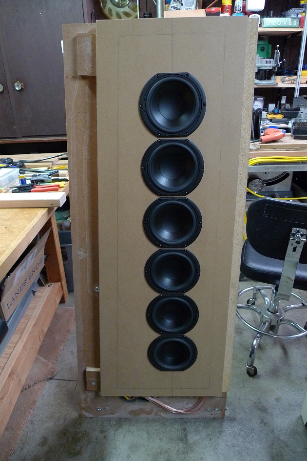

Al, no, not Watkins or Dayton 12" drivers. 🙂 Those are larger than the cover opening....at least most of it. Also, not preferable from a polar response standpoint....IMHO.
An array of smaller drivers will narrow higher in frequency than a couple (or single) of larger drivers and yield a better polar response match to the MRT. That, in conjunction with a modified crossover scheme, should yield a horizontal polar response transition with very little abruptness.
The drivers are 6.5" Peerless transducers which are fairly inexpensive. (I'm going to use six of them in each speaker.) If you compute the Xmax*SD*6 product of these six drivers compared to a couple of larger cones, the maximum SPL capability is nearly the same. The woofer section of this system will be able to play LOUD and clean. 🙂

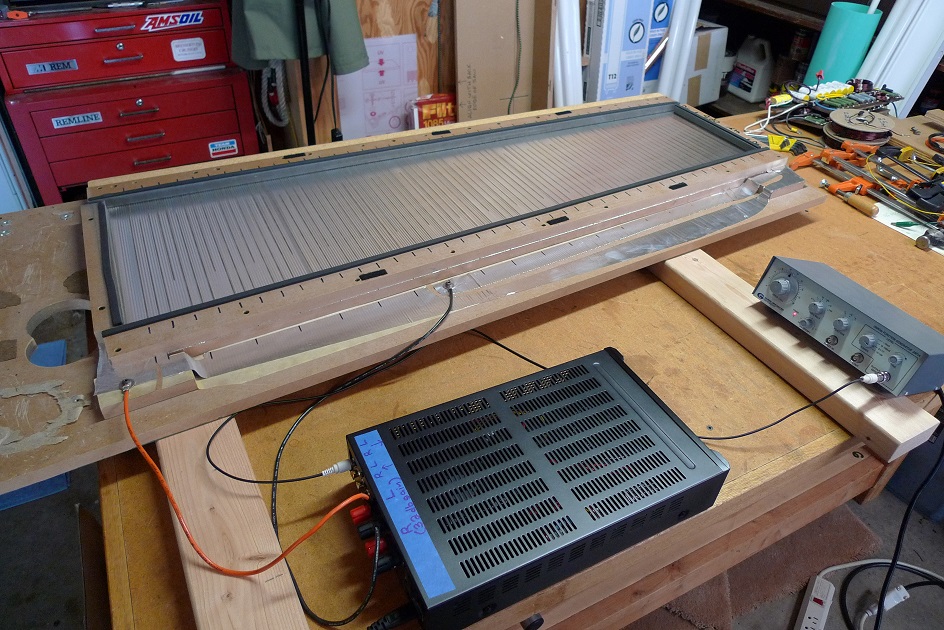

While waiting for the drivers, I've put my other (siliconed) speaker up on the table and have been having some fun. I've run some tests visualizing the effect bear mentioned previously (very interesting) and also evaluating the silicone repair I did a while back. (It's still working fine.)
If you're investigating buzzing this is a good way to do it. It's best if you perform this testing with the speaker tipped upright (normal position) on solid surface vice horizontal on a table. This way possible table vibrations and air between the table and the speaker doesn't introduce itself to the audible result.
It's also important to have a frequency generator with a continuously variable adjustment (as I've shown in the photo) so you can manually/slowly sweep through the entire range and dwell at certain frequencies to localize issues.
You may not like what you hear, so I suggest if you have any doubts, don't do it. 🙂

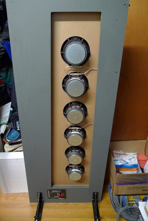

Anyways, if anybody is still interested, I've pretty much completed my "hybrid" Duetta ("Daveyetta") speaker. Attached is a photo from a few days ago after the woofer installation and before I reattached the MRT. This speaker is in my listening room now and sounds darn good. The equalization estimate I programmed into my DSP unit is pretty much as expected and very similar to the tuning response of the Duetta ribbon woofer when measured up close. An approximate 6db peak centered near 40Hz yields a fairly well balanced sound.
Ultimately, I will have to remove the MRT's and take these outdoors to perform some ground-plane testing with the speaker tipped over on its side. That should yield a really good measurement, I think.
I don't see any reason why this "hybrid" approach can't be used with Stages (or others.) If you have buzzing speakers and a full-on woofer refurbishment is required, then you won't be destroying the speaker any more than an Apogee professional installer would if performing that work. And, if you construct it the way I did, you can back-out the entire modification and change direction and go with the professional option easily.

The MRT will be reattached exactly where it was removed. A 2 ohm resistor in series to raise the impedance to 4.5 ohms. The original passive crossovers will not be used.
I'm going to wait to reattach the MRT until I've taken some ground plane measurements outdoors of the bass panel only.
Also, the cover will fit perfectly back in place over the whole assembly. That will probably be the final step.
Driver pairs are wired in series and then the three pairs wired in parallel. Net impedance a bit less than a single driver and equal voltage to all six drivers.
