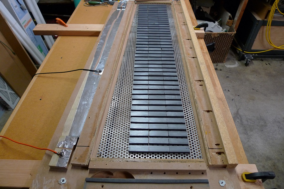

FYI, I've aborted mission on the silicone job for my other Duetta and am embarking on a different course.
Stay tuned.
Dave.
What happened? Did you sneeze?
Nope. Absolutely not. 🙂
The silicone repair is a proven option, so I've decided to put my money where my mouth is and retrofit a conventional driver array into the speaker. Even though I'm working with Duetta's, the concept is perfectly viable for Stage's (or others) and is in keeping with the spirit of the original query of this thread.
Since Stage owners with broken woofer ribbons are out in the cold, this will be a possible option for DIY-inspired folks to get their speakers back on the air.....albeit in a hybrid configuration.
Also, I'm going to implement the setup so it can be completely removed and the appropriate pieces reinstalled to allow a full woofer ribbon refurbishment at some later date.
My MRT drivers are still in fine shape since I was very careful with power amplifier on/off transients and DC-offset issues back when I was using the speakers in bi-amp configuration.
I have some suitable drivers on the way from Madisound.
Dave.

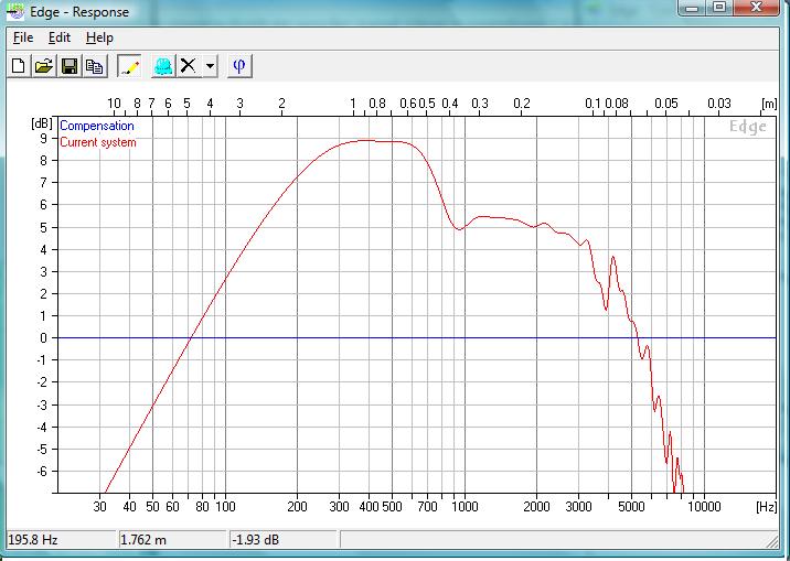

Been playing with Edge in open baffle mode and trying to simulate a stage. Not a lot of luck in finding an accurate enough drawing so a bit of guesswork, but looks like a pair of 10" units will fit in there. Reason for looking at a pair is that it does flatten the response off IN THE SIM. This differs from the usual approach to OB espoused by Linkwitz where you flatten the peak in response and then boost the bass. My current thought is that you could use the peak to your advantage due to the crossover at 750Hz.
The other reason for a pair is you can see the bass falls off below 150Hz so either a lot of boost is needed or a handover to a sub early on.
But without cutting a hole in some foamboard and measuring its all conjecture! OB is one of the more empirical areas of the speaker art still...
