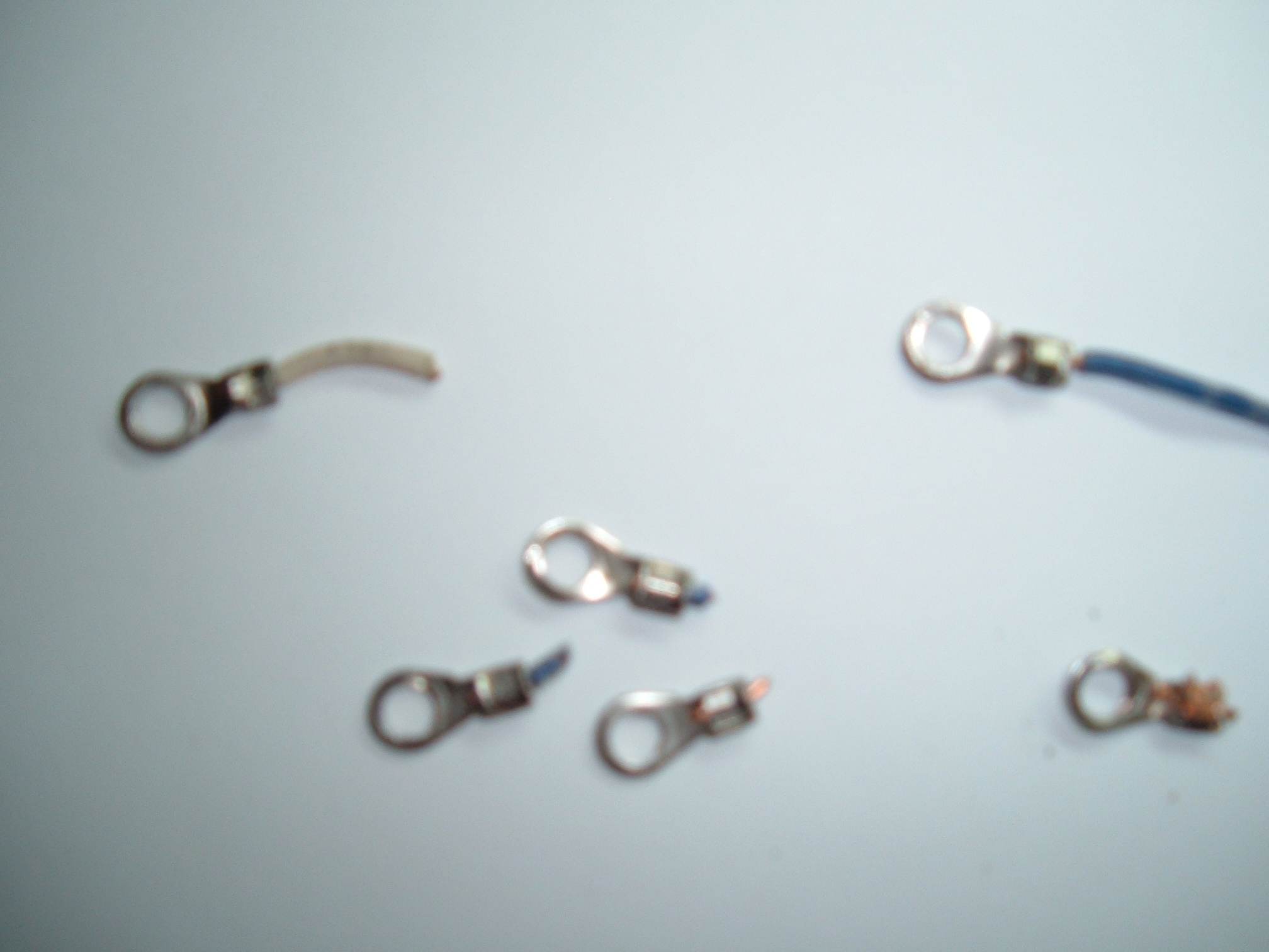

On the Stages an the Centaur .... ....the wire is 16g soild...with these crimp on ends.. that I have found can give the same buzzing sound... as if it was the panels..these ends an the wire can get lose.....an the soiled wire make it look like all is well.....but thay buzz to the beat...........
these plated ends... give the sound a unneeded peak....not just my ears hear this...I have always pull these out of my Apogees.....from my frist pr...
Also the caps are glue or were... with the coils an there zip ties
All this can become buzzzzzzers...........
You may ck this befor moving on to other fixs.....
