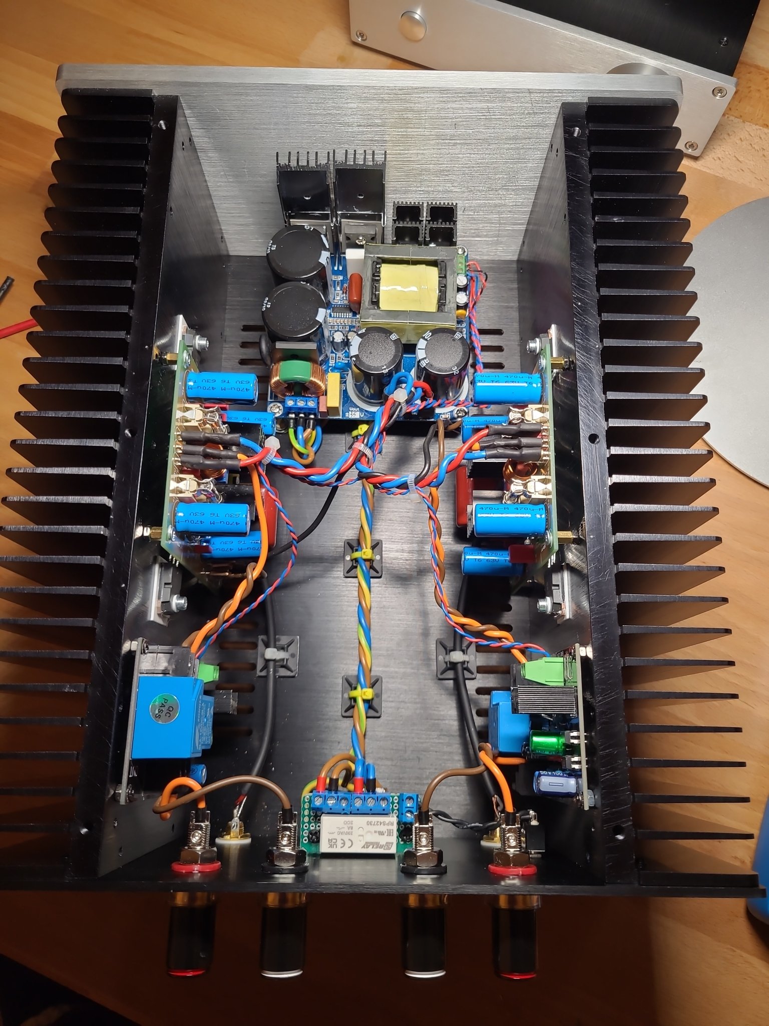

500 Watt Connex was delivered 🙂 I ordered a +- 35 Volt Type. In the past there was a pot on board, +- 5 % voltage adjust. Gone... the voltage is fixed on this SMPS.
After 2 hours i adjustet the bias to 300 mA. The heatsinks keeping relative cool....but not my testing resistors. 10 ohm 5 watt are to small, i need bigger 10 ohm resistors. I'm tired of buying someting... 🙁
Dc offset is -1,9/+2,2 mv at the two amps. With some thermal adhesiv i made the heatsinks of the SMPS larger.
Tomorrow i can listen for the first time. Perhaps 300 mA bias is enough.
Greetings Pedda

Testing the Amp with music, a cd of Marla Glen. Sounds very well on this amp. A feeling of controll in all ways. After the CD was finished i got a temperatur of 34 degrees on the heatsink. A higher adjust as 300 mA seems to be not possible without greater heatsinks. No hiss no hum...silence. I first try it with headphones. I wont destroy my speakers...🙂
You are right Chris, sounds powerful. May be thinking about a greater amp with more power 🙂
Im glad to built....many thanks to Apex, Bimo, Prasi and so on for this beautiful little amp....
The next one please 🙂
Greets
Pedda

Hi...
Chris, Chermann told me the same....
The paste is there... 🙂 I dont like this mud...i take the rest away with q-tips. Underneath the pcb in direction SMPS you can see a little bit of the paste.
But you are watching out, thats right...
Thank you
Greets
Peter

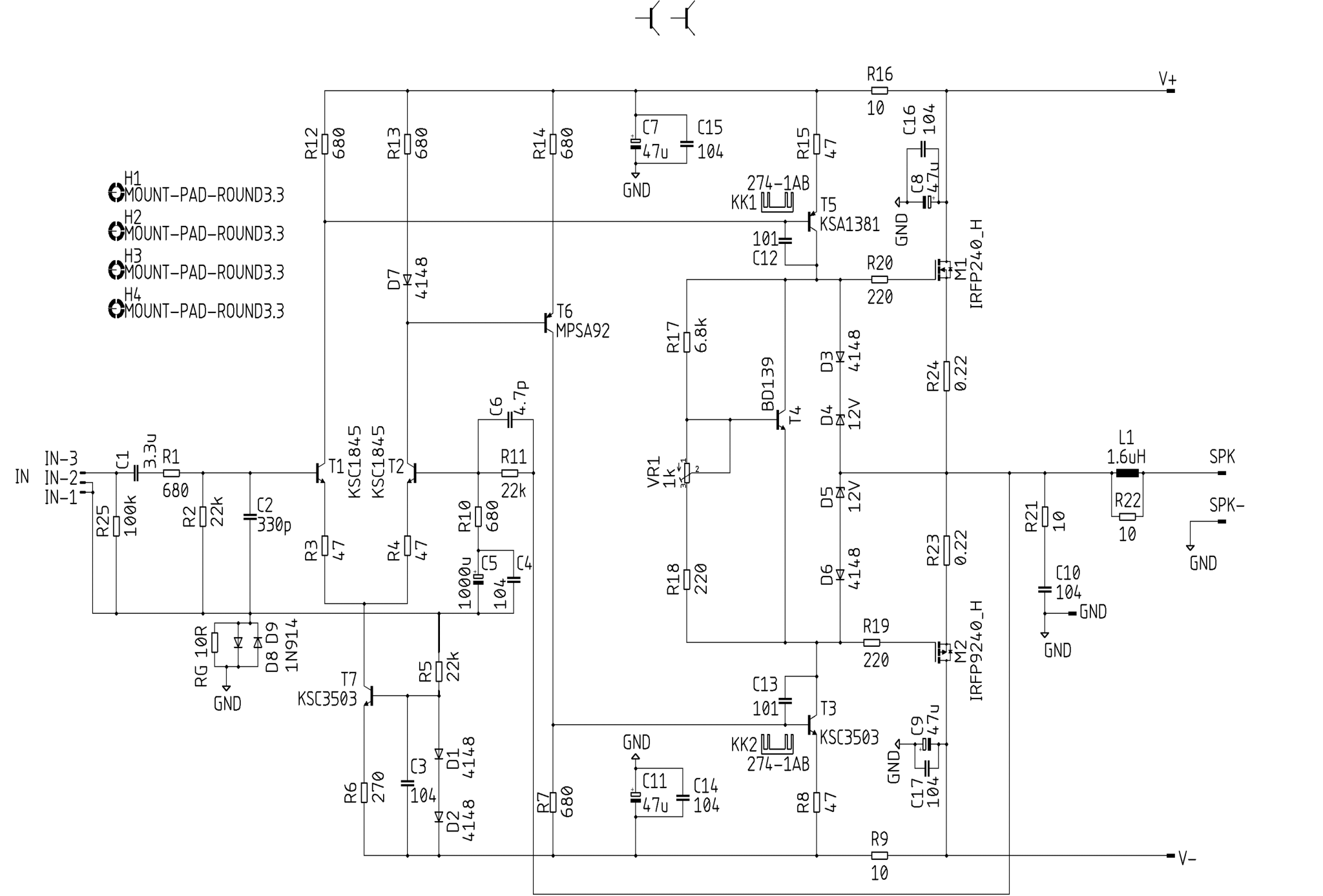

In the Moment i have trouble with the FH9 boards. Both not working. At the first board i cant make any bias adjusting, the second board has over 20 volt on the output. I soldered the IRF240/IRF9140 in. The next try with the IRF240/IRF9240. Something wents wrong, but at the first look i cant see any mistake. All capacitors have the right polarity, diodes have the right direction....mhmmm. I have to search...test the transistors...💩
Peter
Hi Chris.
i will check T4, BD139 and the others. T4 is mounted on the heatsink with isolation. I have measured the isolation to the pins. VR1 i can measure, seems to be ok on both boards. I dont rearly know...
I have tested one IRF9140 with my atlas...completly dead....in all directions...whats that ?....dont know. I will check all transistors tomorrow . Its to late now...
God night..thanks for your tip...
Peter

Strange...i never had defect IRF...as Zen mod wrote years ago. nobody is cloning the dirty cheap IRFP240 because the are sooo cheap.
connect gate with source with a short wire to discharge the gate...then the MOSFEt should be off! remove the wire then try again.
I think the IRFP9140 i have bought in germany, at kessler electronic, are not okay. I changed to IRFP9240 bought at reichelt and the board is working.
The bias voltage is following the pot now. Wtf....Time robber... 🥺
Second board will follow
Greets
Pedda

Yes the Print Labels of the to 126 ( Bd 140 or similar) are mirrored. I Had this at the AA14 Amp too.
