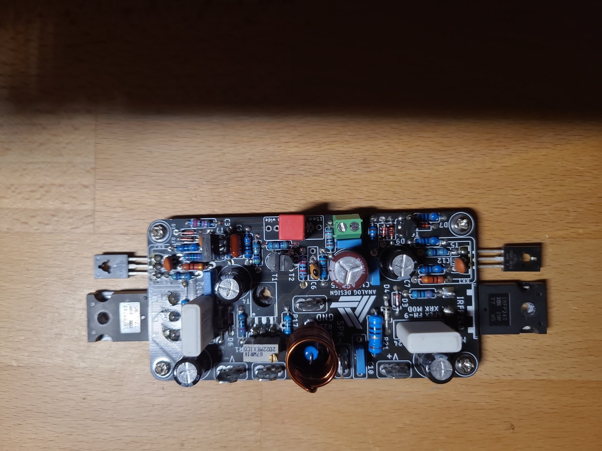

I first try the original pcb by bimo. On my pcb there is a little mistake. I have to change 2 things in KiCad. The first is to change the space for the input capacitor. The second is to use other, smaller driver heatsinks. I think that gives an little more space and a smaller layout.
Perhaps you know about the "Blame ST" ? I changed the layout a little for four times. Now it is finished.
On my PCB you can built the ES and Blame ST. The driver heatsinks on the pcb are gone. The drivers are together on the output heatsink. With two layers on the pcb its possible. Another amp to test 🙂
The FH9 follows....

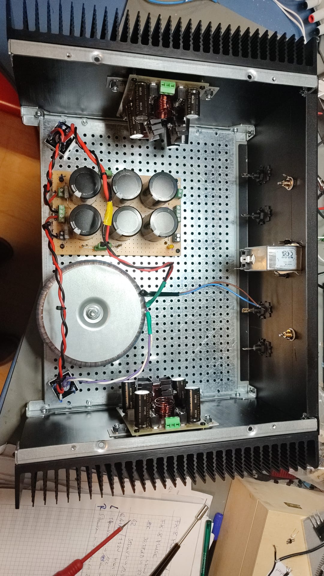

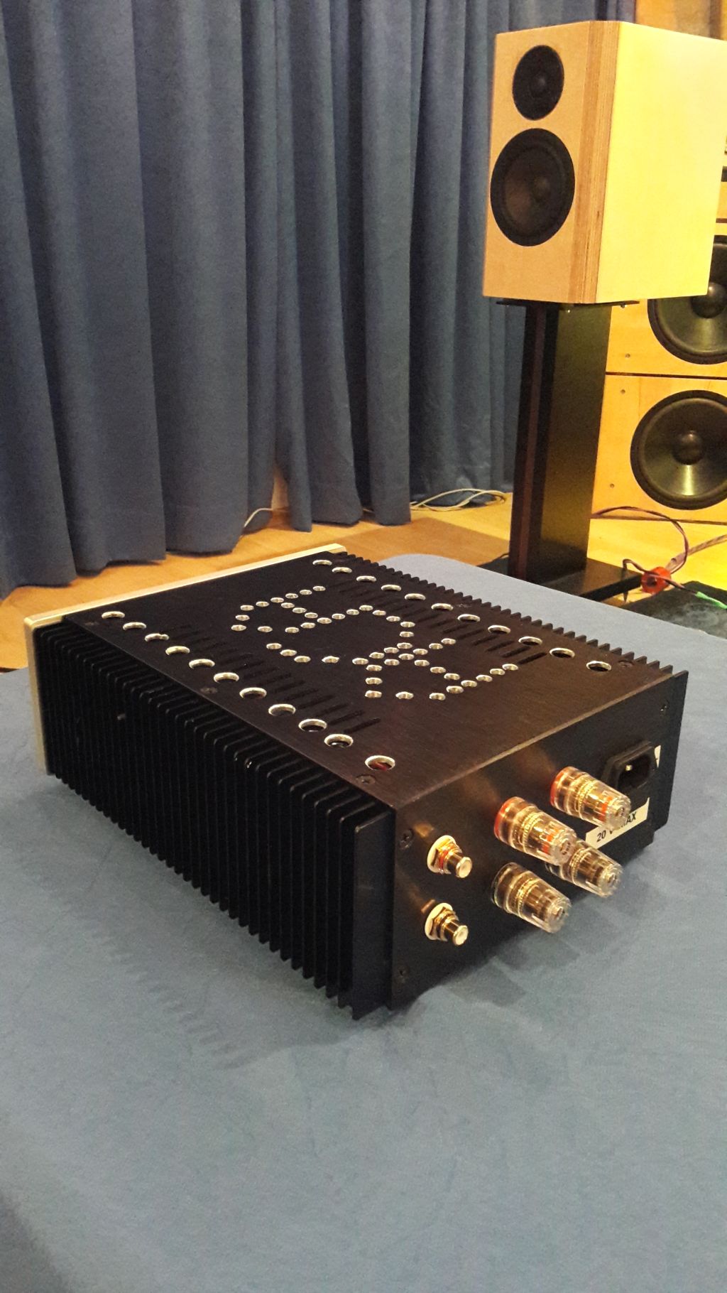

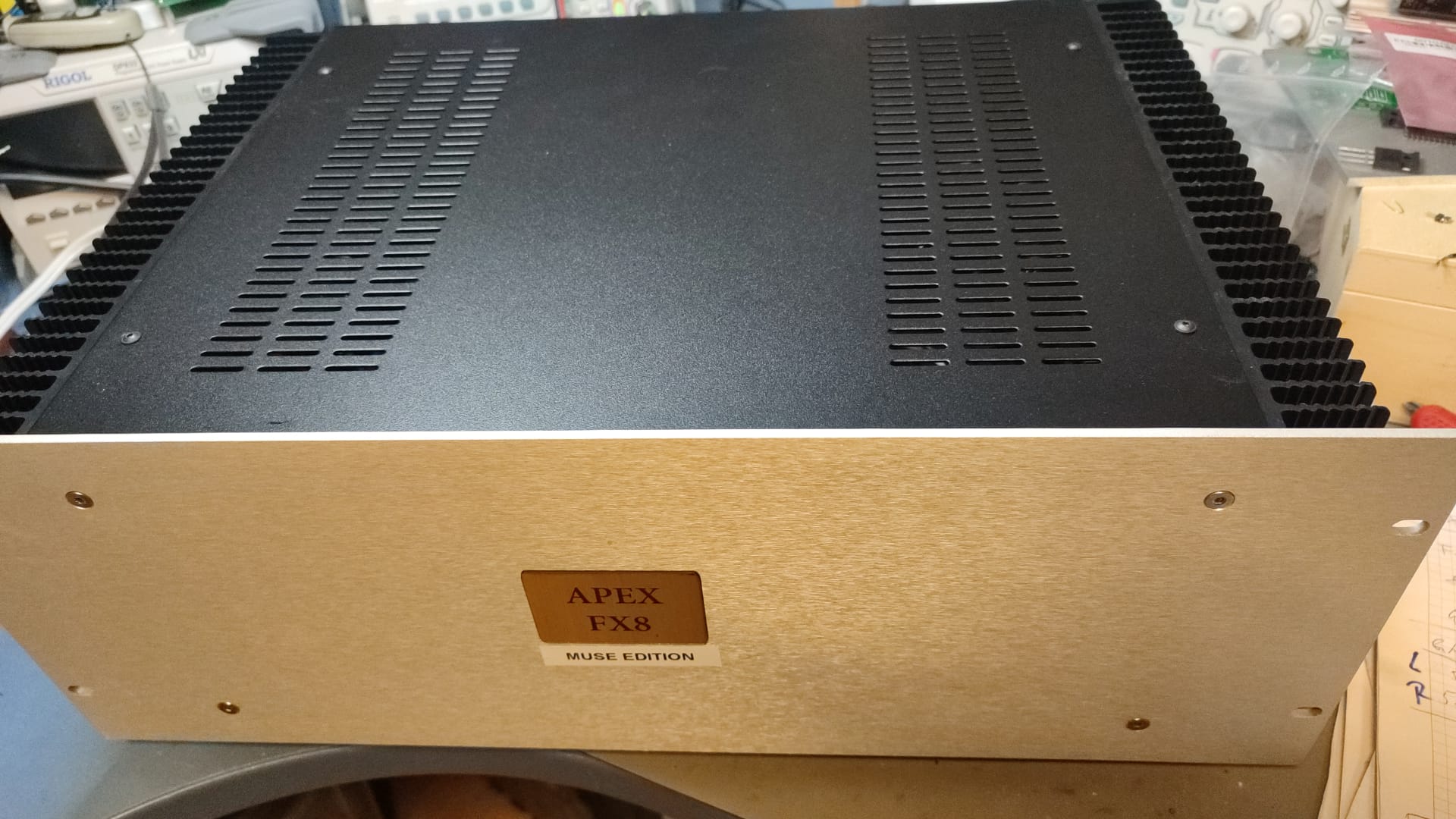

Hi peter...
here it is the FX8 muse edition 😉
finally i changed the bleeder from22k to 2x22k in parallel because 99mF are long to loose current with just 22k 🤣
the gain is about 26,6dB and the amps works fine...i will run in and do some measurements.
power is the same as the other....ripple i have to check.
in the afternoon i will have a compare test with the other FX8.
yes there are a lot of interesting amps to build...yes it is a fantastic hobby!

I think so too...yes there are a lot of interesting amps to build...yes it is a fantastic hobby!
Your amp is looking very nice to me...thumbs up...
Is there a difference in the sound by changing something at the input as you do ? I have got 10 µf CCB caps, really big ones 🙂 i dont know if there is really a difference to a smaller Wima. Is there a differance between Muse or Roederstein foil capacitor ? I dont know....
You will test it to get a result...👍

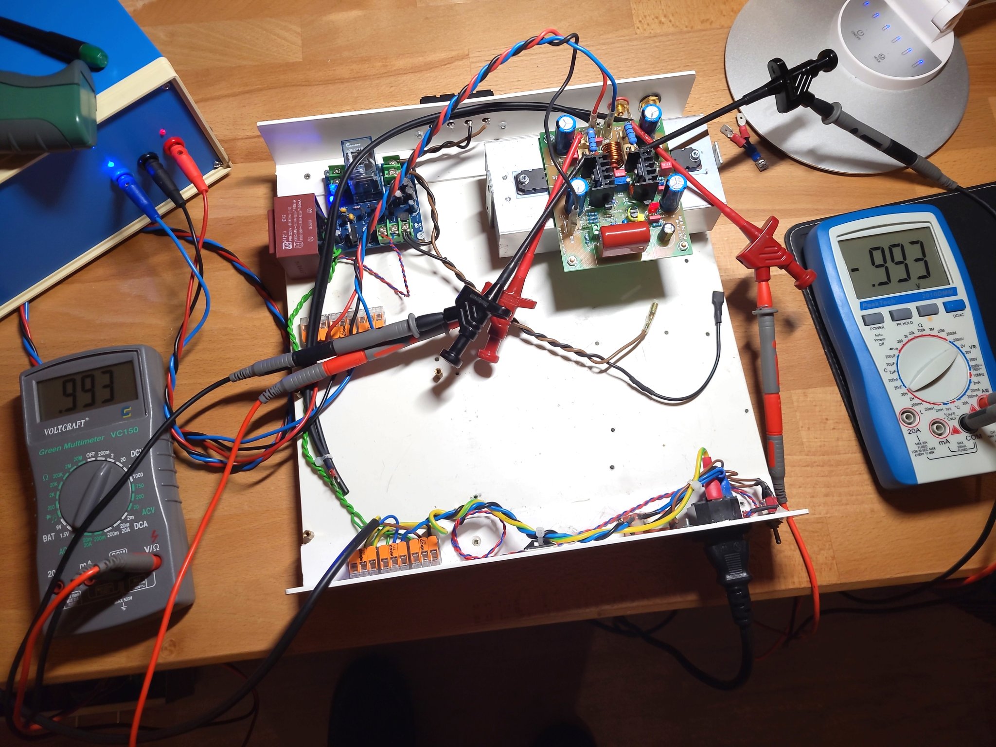

Testing the first pcb. By setting the pot to 250 Ohm i got over 10 Volt in each rail, measured over the testing resistor. Switched off and regulated a bit for three, four times. The voltage is following the pot. At 992 mV, for about 15 minutes, i switched off now, because its a testing heatsink and not the finally. The temperatur was rising to 40 degrees C. Thats ok i think, the heatsink is not big, for testing big enough. The second pcb must follow...

as i understand you set instead of the fuse a resistor to measure the current. what value has this resistor?
I = u/ R.....0,99V/?
your supply is 10V each rail...that is ok for the first test.
Hi Chris,
the resistor is 10 Ohm/3Watt. No 2 watt at home...
I have solderd the resistor over the fuseholder, yes. Thats easyer to handle for me. If i get 1 volt its 100 mA on the rail.

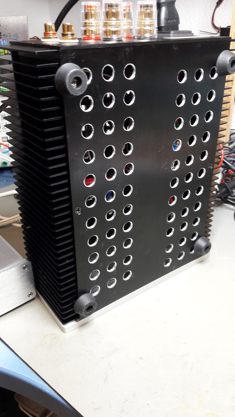

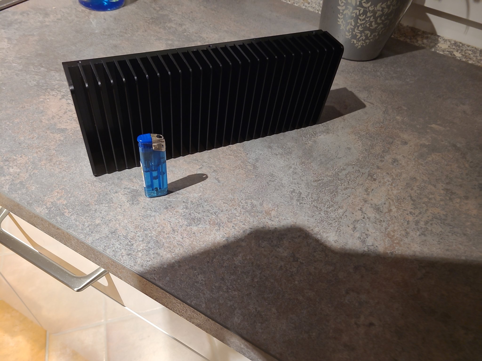

if i built my ACA premium i use also a China housing..but i drilled a lot of hole to get a better konvection.
heat of 48W each side !!! 24V 2Abias
for fast putting into operation i use this heat sink: cheap and 0,65K/W 15Euro heat sink 0,65K/W

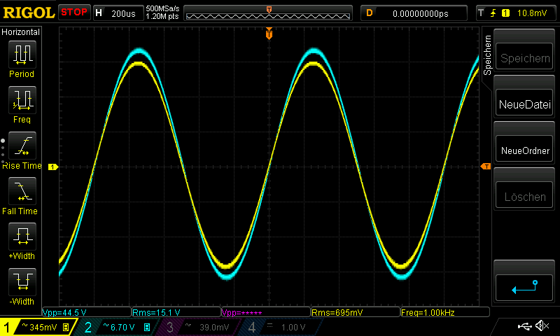

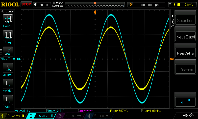

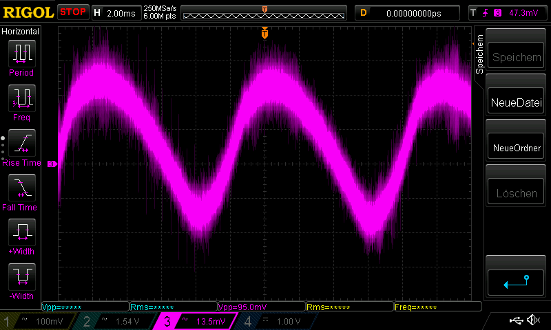

measurements at muse edition (CRC 33mF, R2x0,22E, 33mF, 33mF):
pic 2 700mVrms input 26,7dB gain in 8R, about 28WATT rms
pic 1 600mVrms input 26,7dB gain in 4R, about 41WATT rms
pic 3 is ripple voltage about 70mV
ripple calculator: ripple calculator
current for both channels
fequency is 100hZ because of the rectifier
cap: in FARAD - remember that every elco cap can have 20% less
result is the ripple voltage.

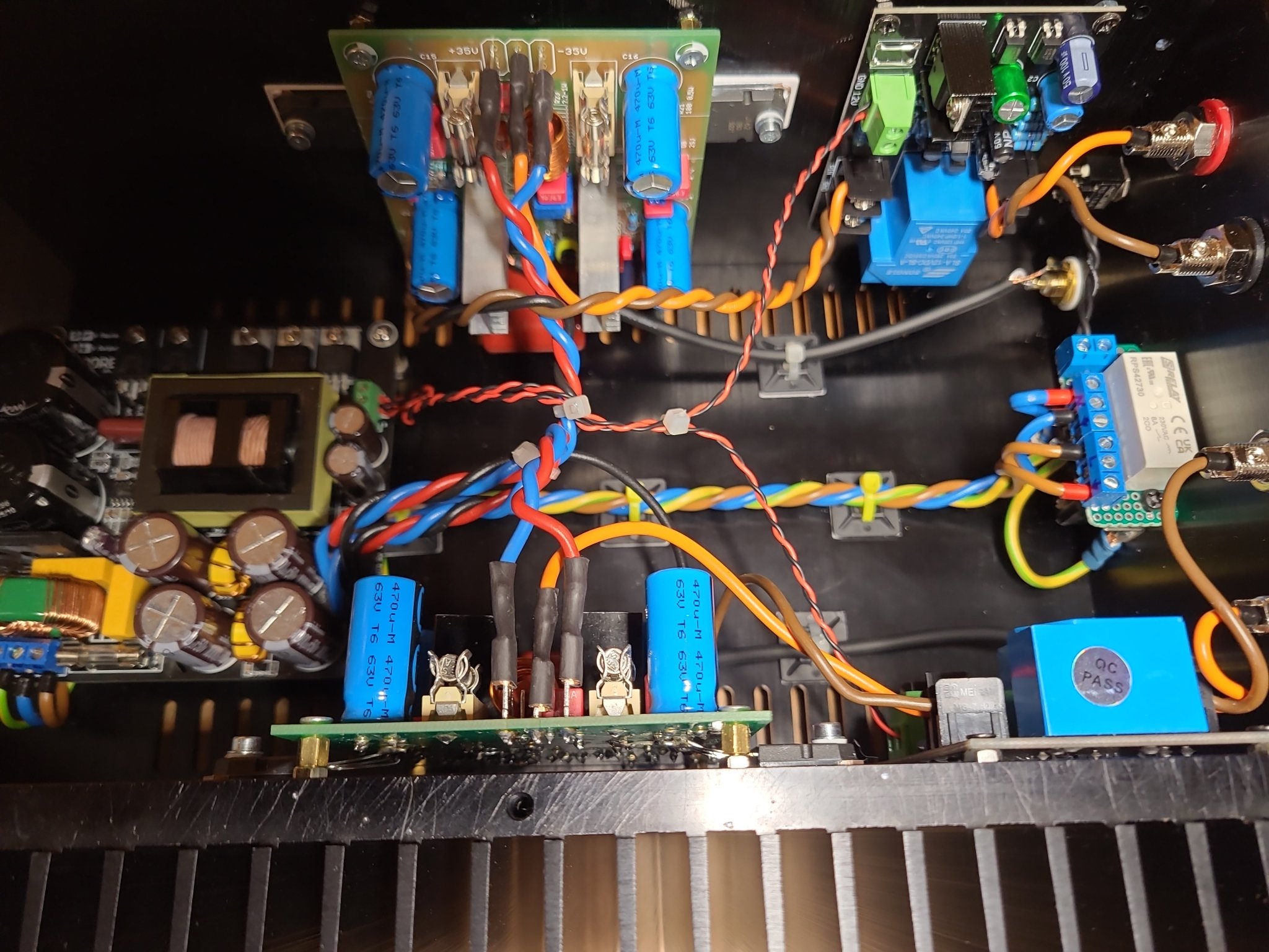

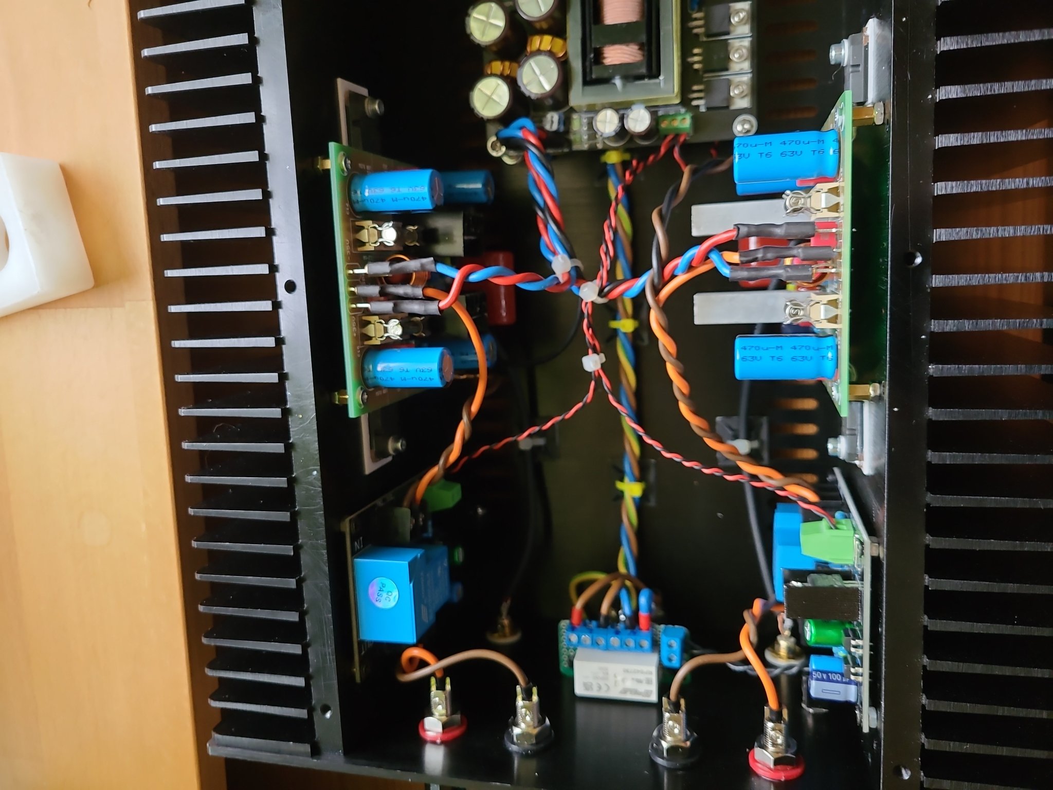

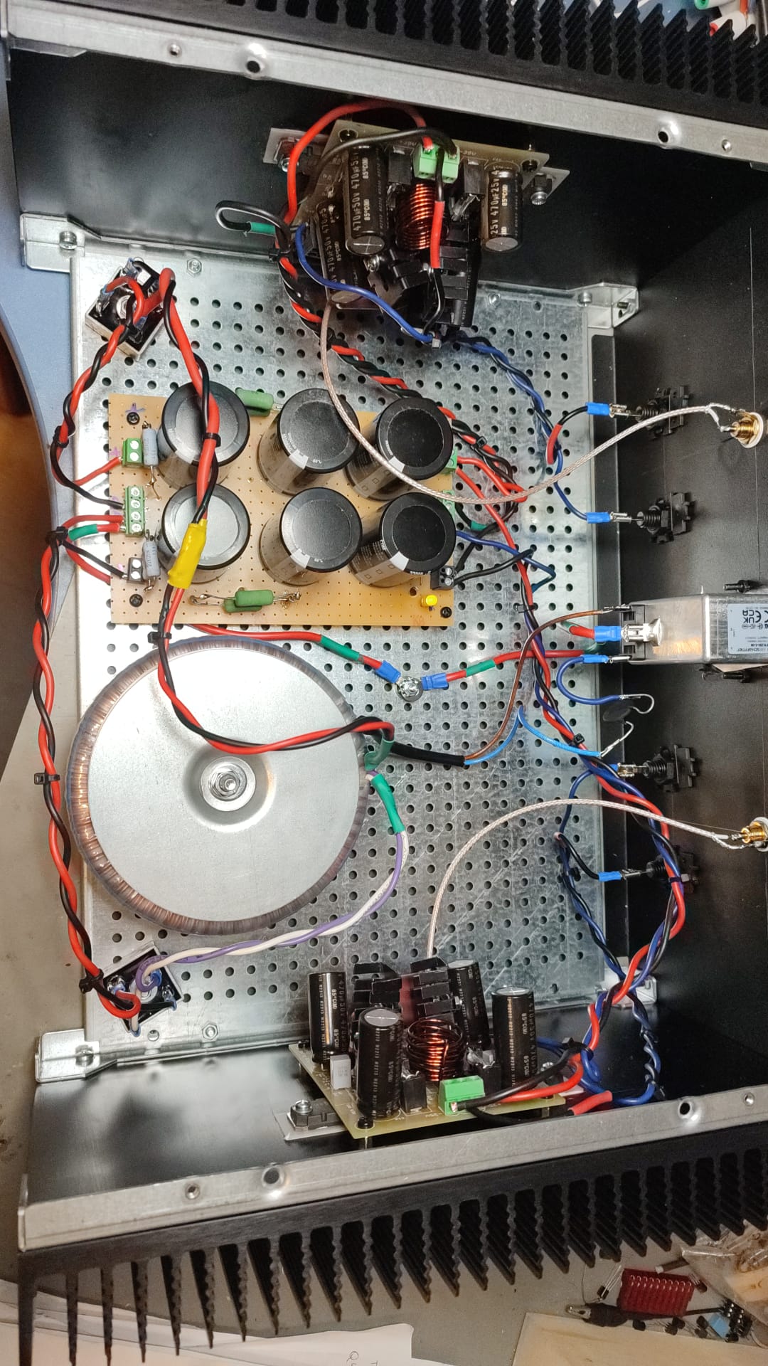

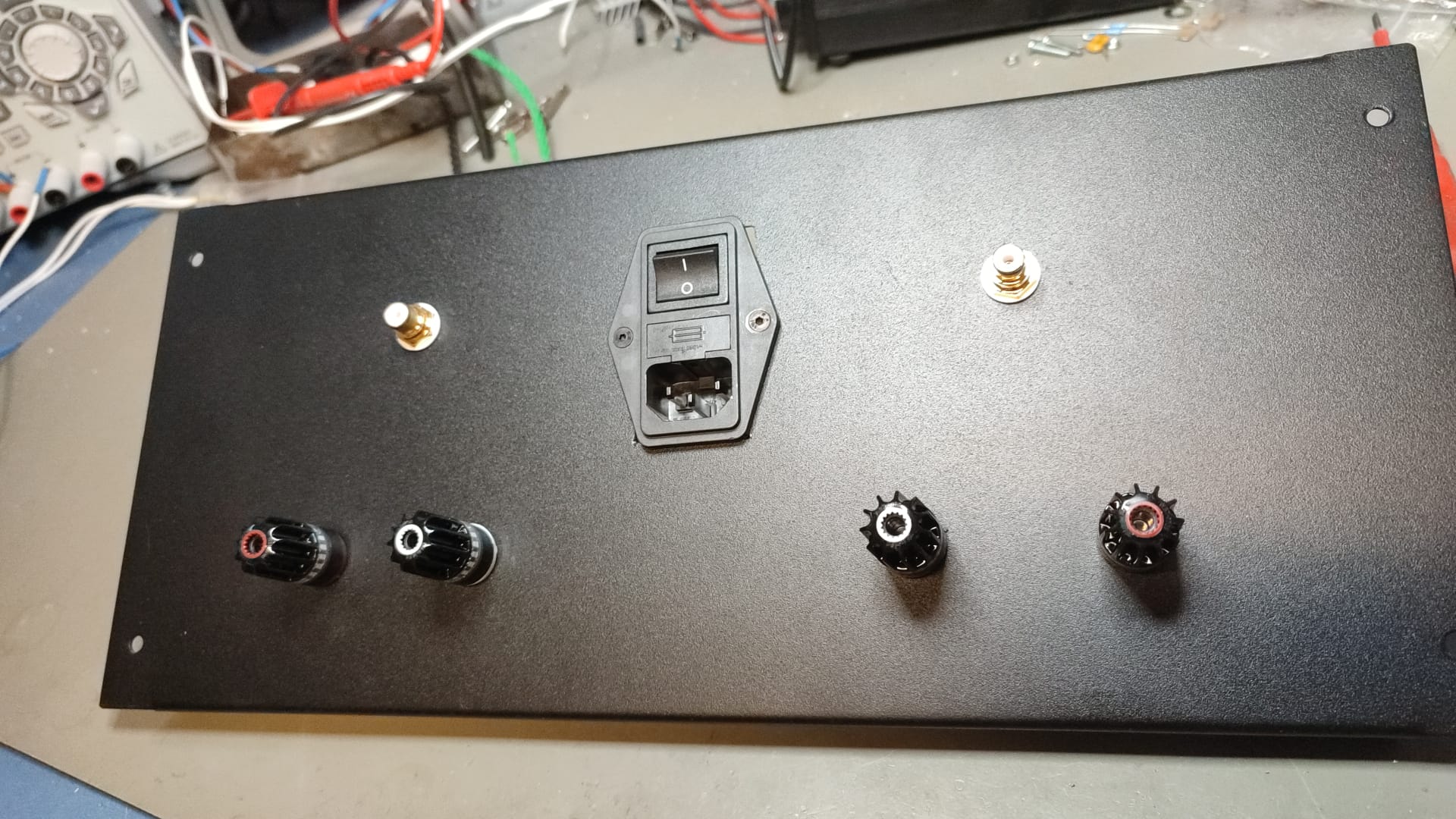

I was a little bit busy...the second board is running without problems. So i built in...but i have to wait for deliveries again. Other Heatsinks for the drivers, ceramic isolators and so on....
But today i finished so far with all cables. In the next step i have to change the driver-heatsinks and adjust final bias...
