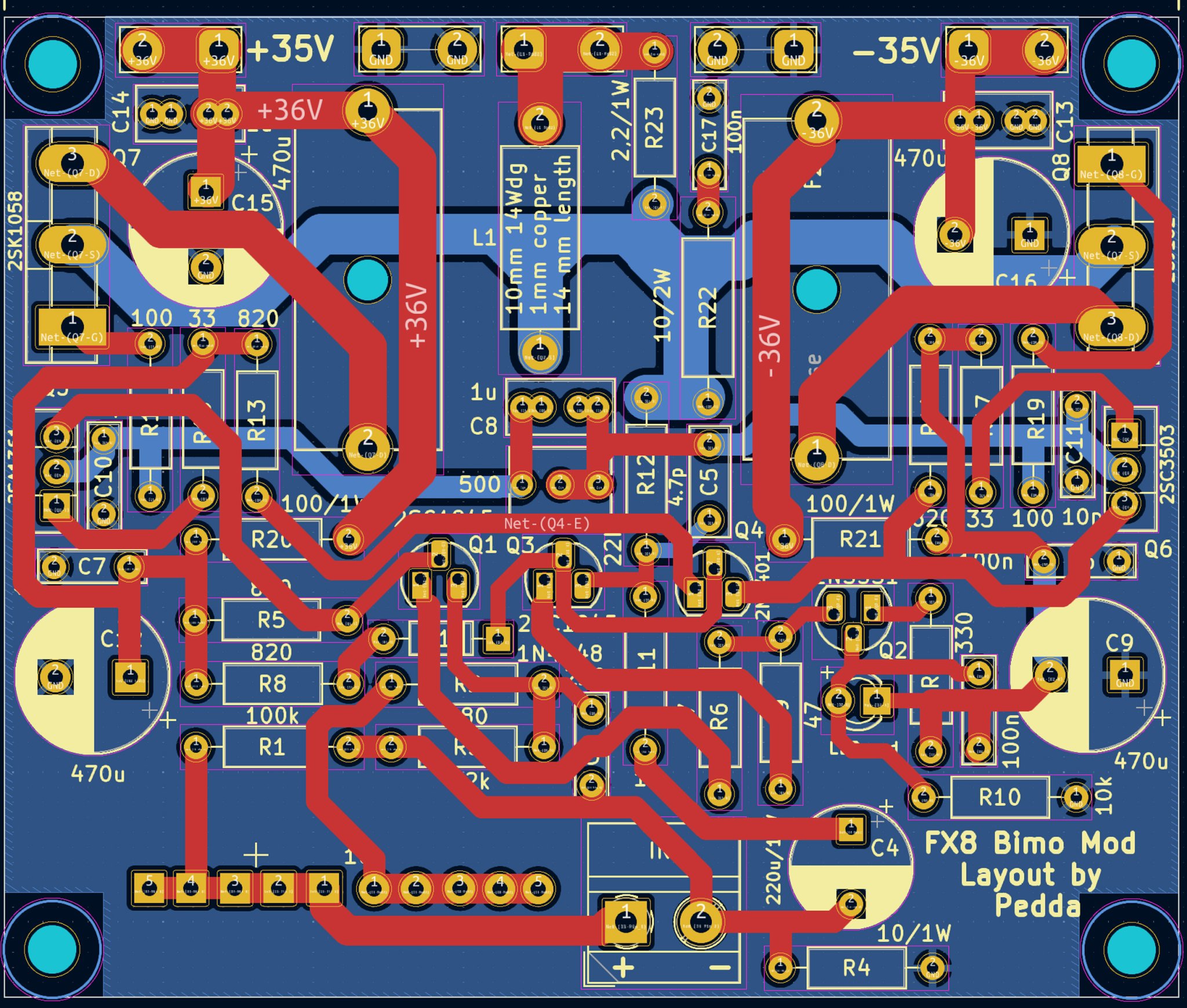

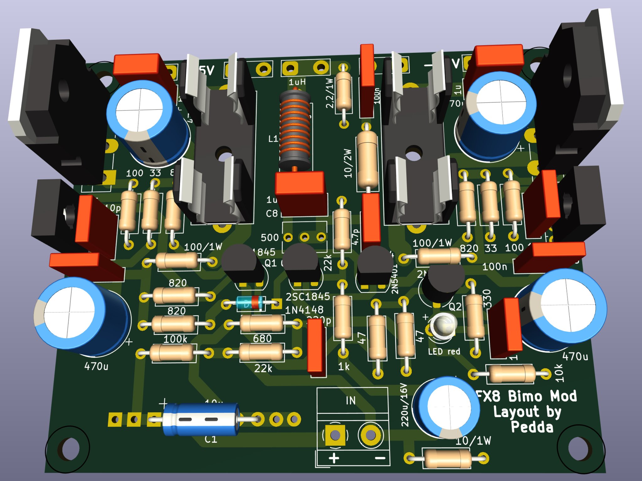

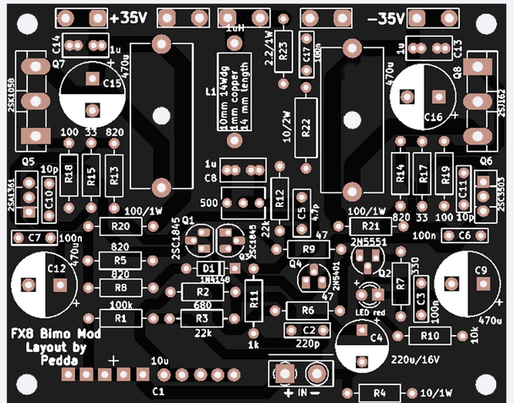

Hi Chris,
You ask for a new Layout in the FH9 thread...
The Layout of the FX8 is bigger than the layout of the FH9 because of the two fuseholders. Kicad symbols/footprints are bigger in some case. Don't know if it is possible to get the pcb smaller. Perhaps i can make a smaller pcb putting the drivers to the outside. I will see what is possible...🙂
Peter
Reactions: inyashd

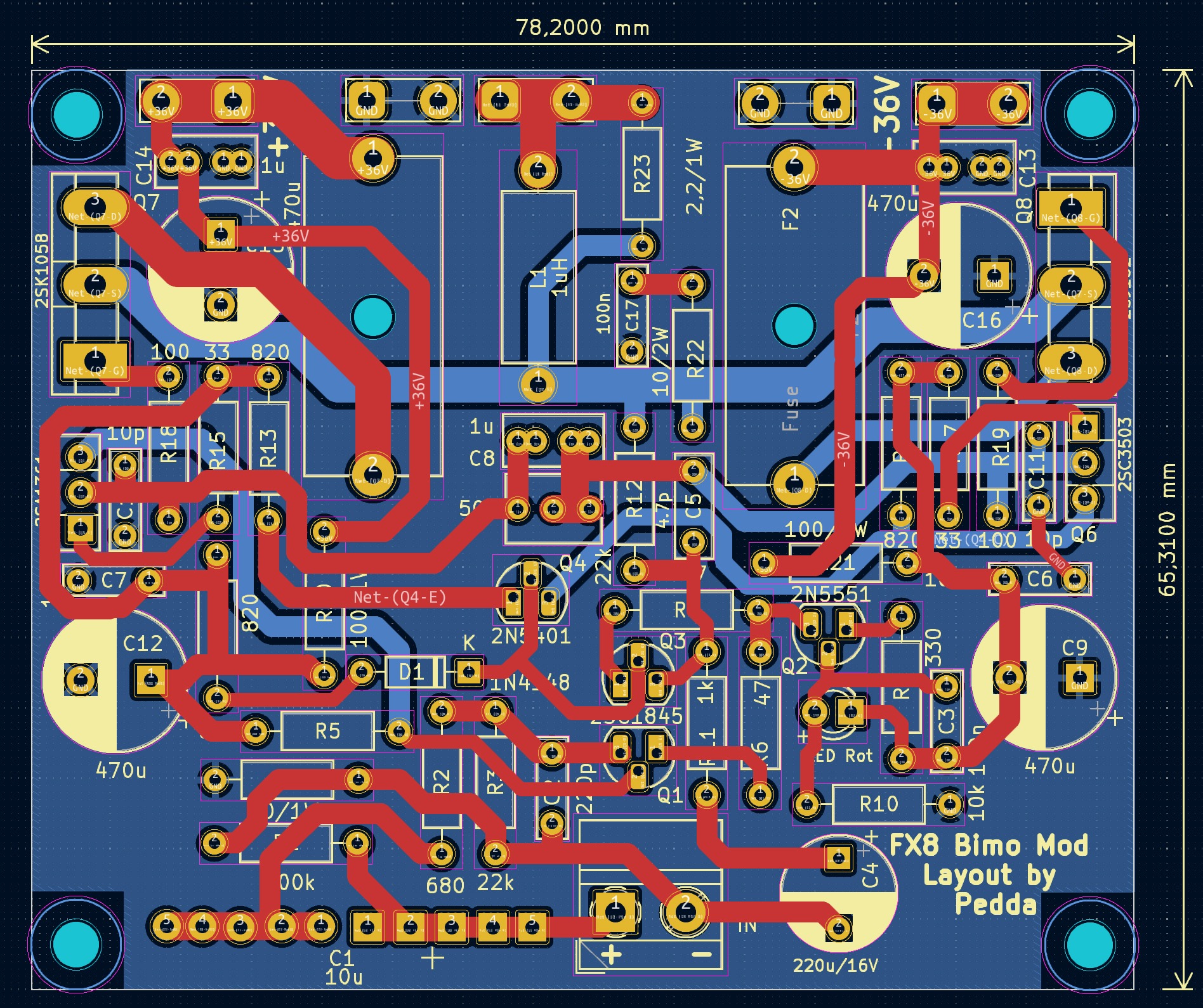

The original pcb had a size of 100 x 83mm. I made a new layout, little bit smaller. But not finished yet. I have to look after the coil, if there is enough space to the fuseholder.
I will have a look if i can provide some crossing. Not many crossings on the pcb...😉
Here it is...

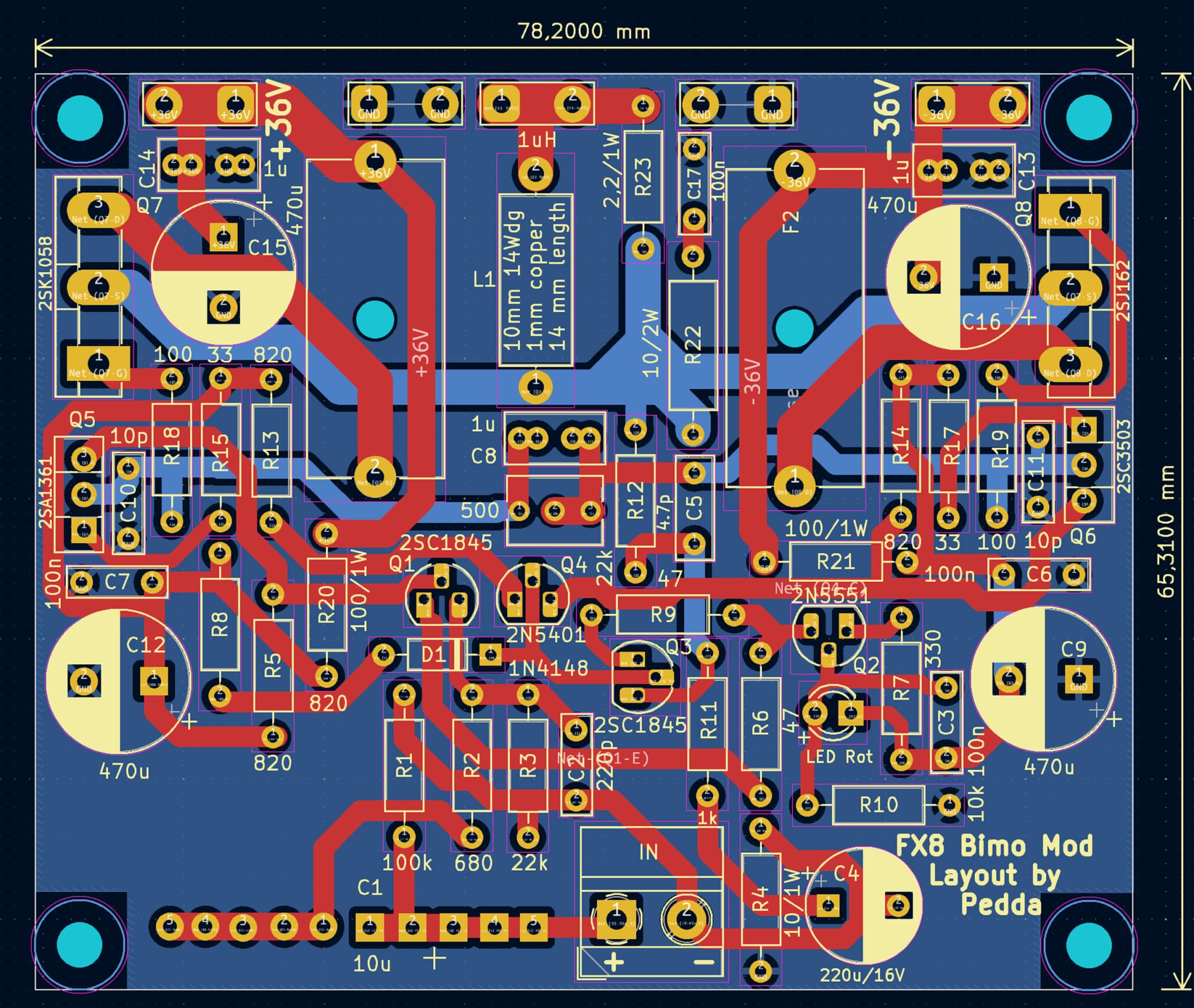

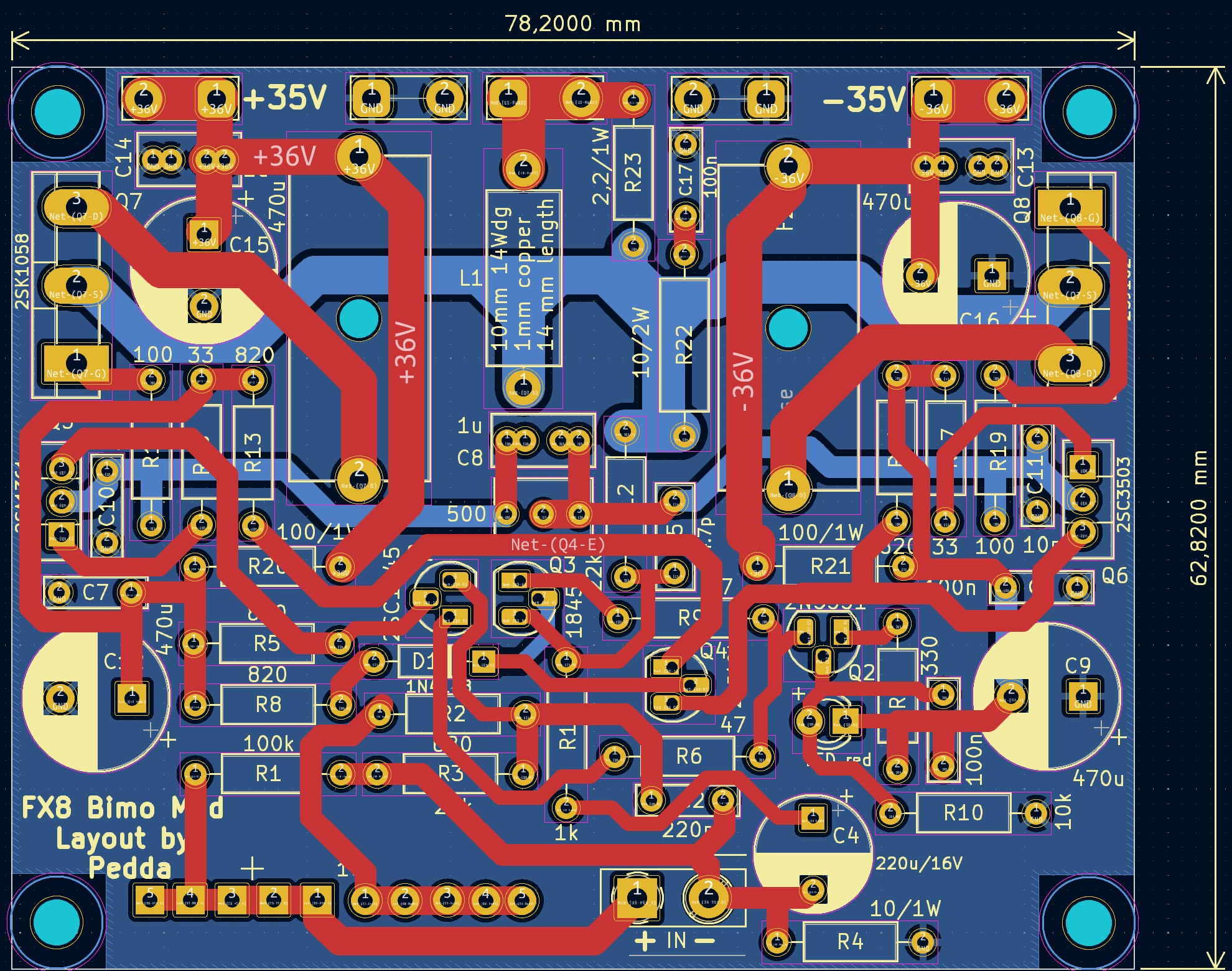

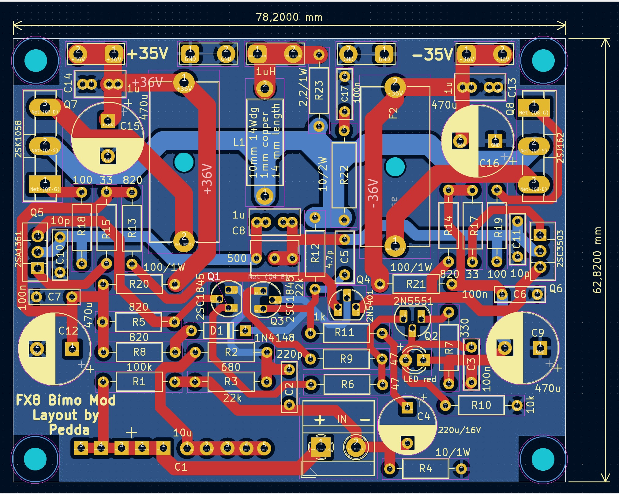

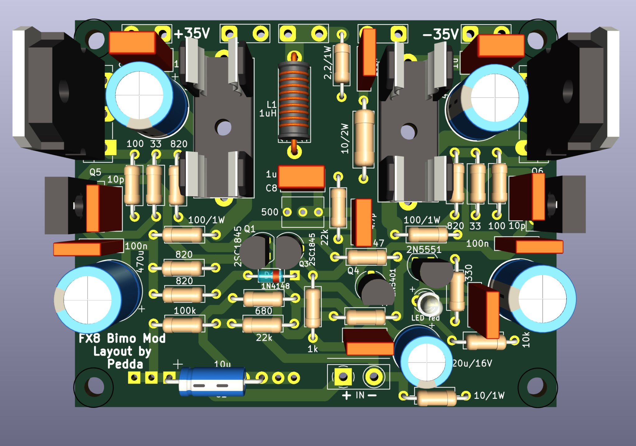

Hi Chris,
you are right...KiCad don't know +-35 Volt. I have forgotten to change that. I have done....
Gave more space to the input capacitor and made other, but little changes....hope, you can live with it....
Peter
