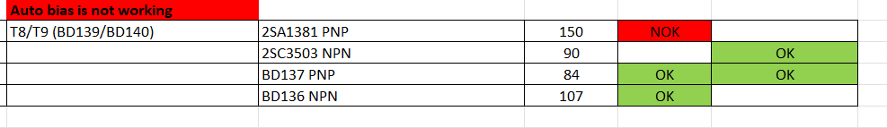

then i realized that the onsemi 1381 NPN is with hfe about 150 too much for the "auto biasing function" because if i change to the BD137 and BD136 which i had in the box- both amps are working and the ocp is not get on.
bias is starting with 1,44A @ 24 Volt and goes on one amp quicker then the other down to 1,250A

You mean T9 ? This is VAS transistor, not part of 'biasing' circuit.
1381 should be perfect for VAS...
T10,T11,T12, T13 are doing biasing..
Measure voltages between bases of T14/T15 to see bias voltage.
If amplifier behaves differently after you replaced T9 with 1381, perhaps it is oscillating...
Possible, spice sim would confirm this...

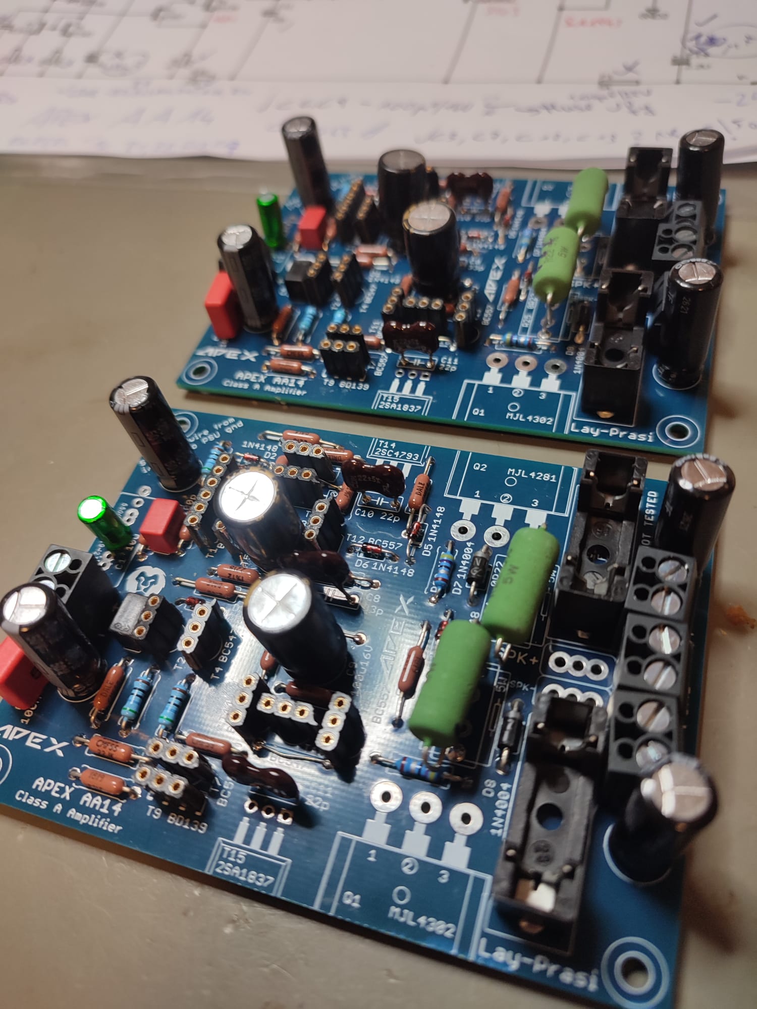

By any chance - you didn't forget to solder the wire connector in the center of the PCB?
Between R17 and D4. Can't see it on your photo...

no...the connection (wire) is done between D4 and R17....all other 2 wires too. (see pic)

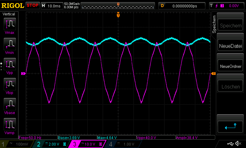

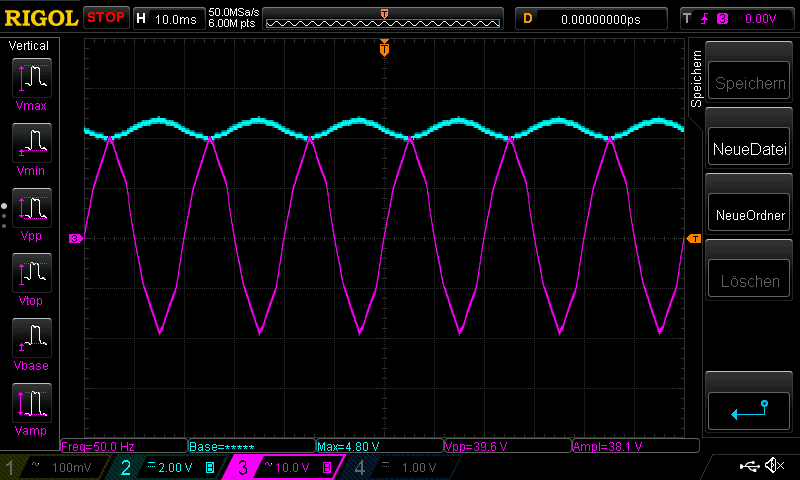

S**t...i build an oscillator
50HZ ??
Q1 getting very hot very fast:
Measurements:
bases T8 / T9 33,88V
bases T14 /T15 3V and get down to 2,81V
bases T6 /T7 33,88V
GND to base of T1 0,3V
GND to base of T5 9,4V
pic: ch2 DC_blue...ch3 is the probe AC to some points
pic named with base
is with the probe pink at the Base of Q1, blue is the DC offset with a differential probe on the speakers output (from 15V to 5)
all other measurements show the same high swinging value !!
i have no idea what i do next because the Q1 is getting very fast super hot 100°C ! is 5 seconds!!

50HZ ??
Measurements:
bases T6 /T7 33,88V
pic named with base
kr
chris

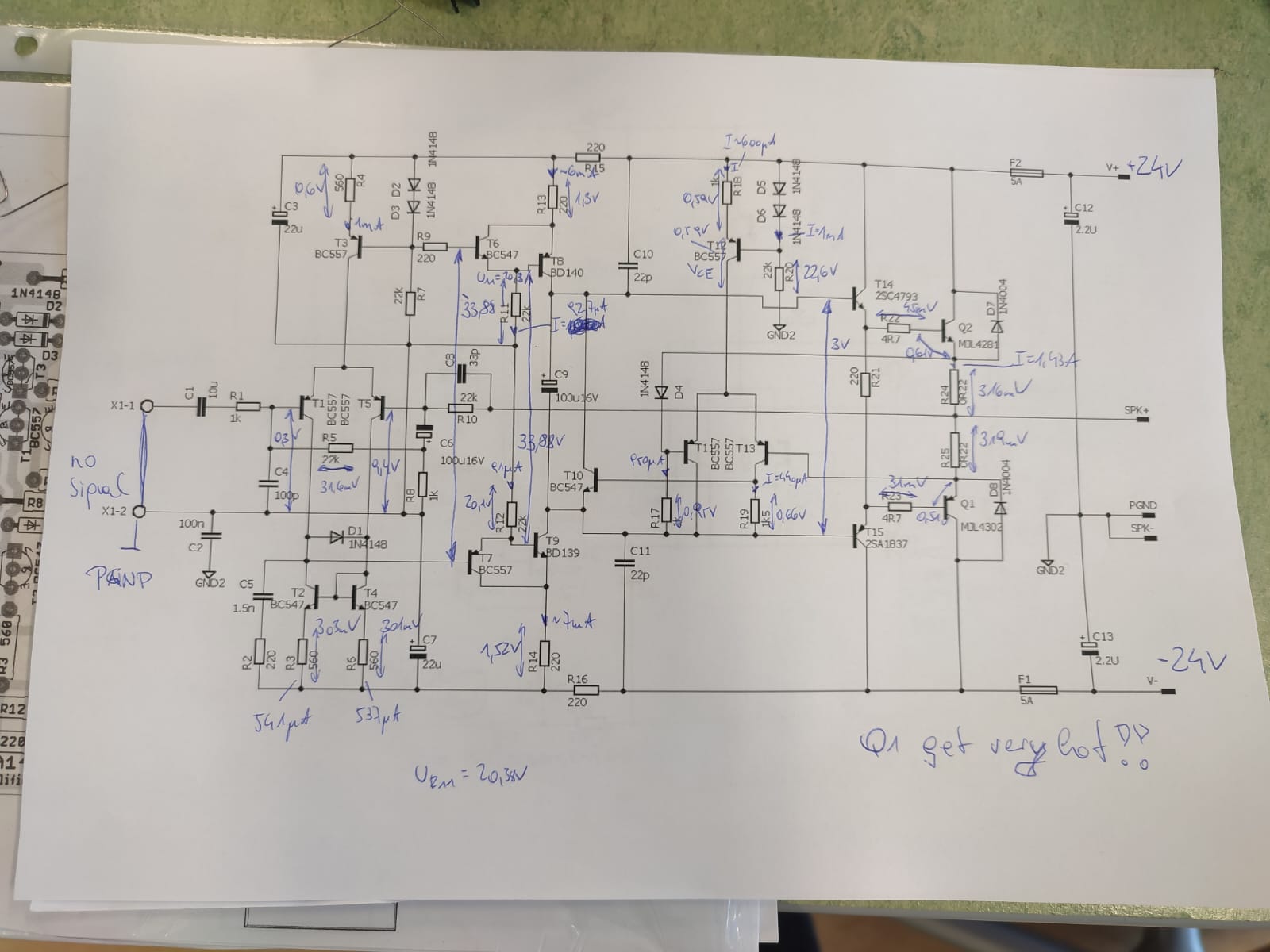

measurements: from post 34
bases T6 /T7 33,88V
new.
i switch on an measured as fast as i can and then switch off a wait a bit for the next measurements because of Q1 gets f** hot! so the current is in the startup phase about 1,4A.
OPS:
Q2 Vbe 0,61V , R22 base 45mV, R24 0,22R 316mV
Q1 Vbe 0,51V , R23 base 31mV, R25 0,22R 319mV
R21 1,76V
Auto bias area:
R20 22,6V, R18 0,59V, VCE T12 0,59V
R19 0,66V, R17 0,95V
VAS:
R13 1,2V, R11 20,38V, R12 20,1V, R14 1,52V
IPS:
R4 0,6V, R5 31,6mV, R6 301mV, R3 303mV
bases T6 /T7 33,88V

I'm looking at the voltages you posted, and all input/vas voltages look normal, with exception of base T5 - but this is a consequence of the DC offset on the output.
Next step would be to analyze how the biasing circuit works, and try to make sense of these voltages.
I guess that would be the best time to use LT Spice..
My suspect responsible for the DC offset is biasing circuit (assuming that drivers are working fine, not burnt/shorted, etc..).
How did you check if drivers and output devices are fine? Transistor tester?
