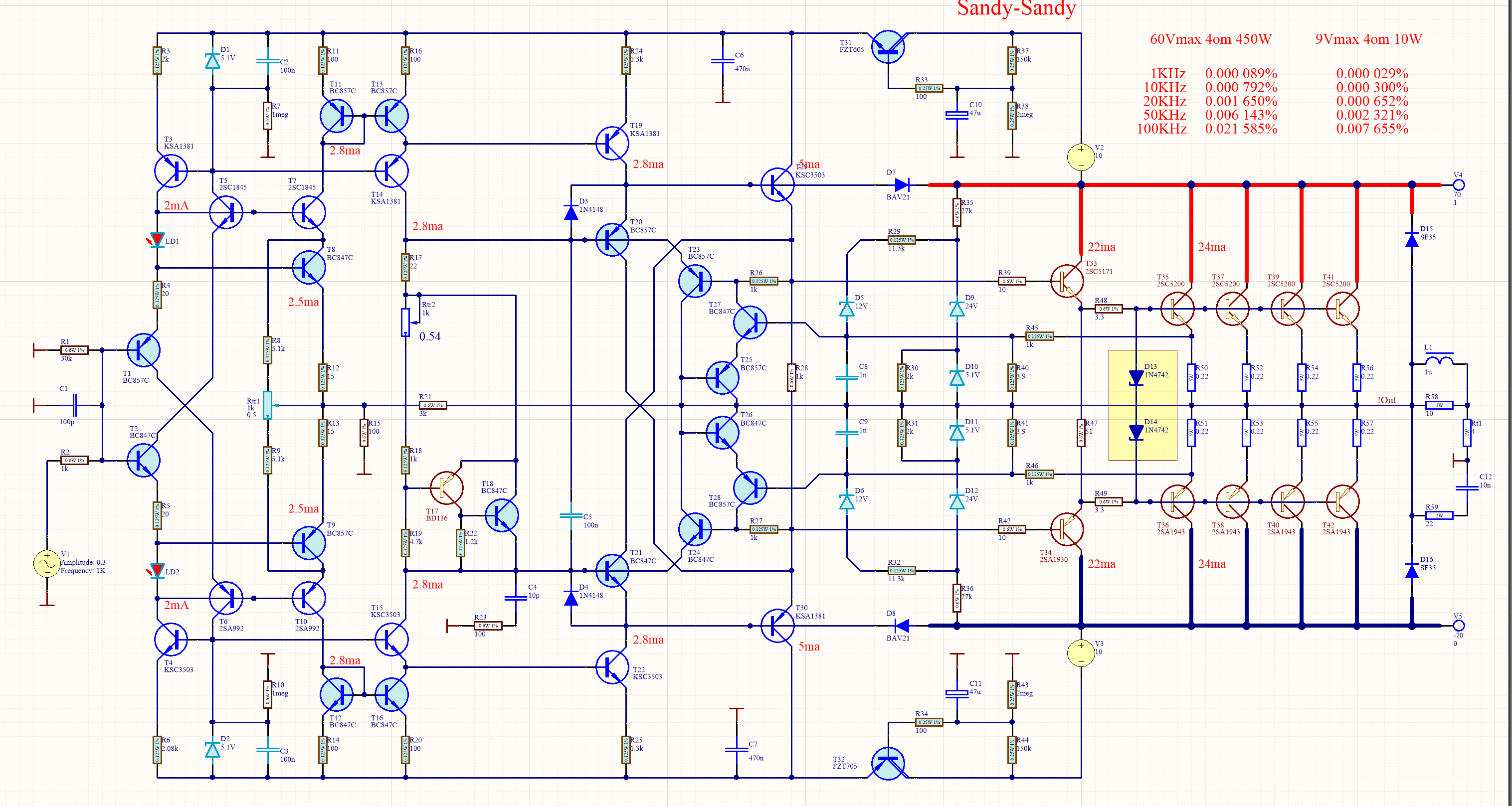

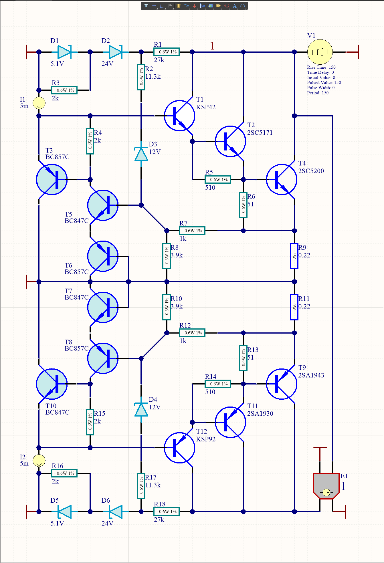

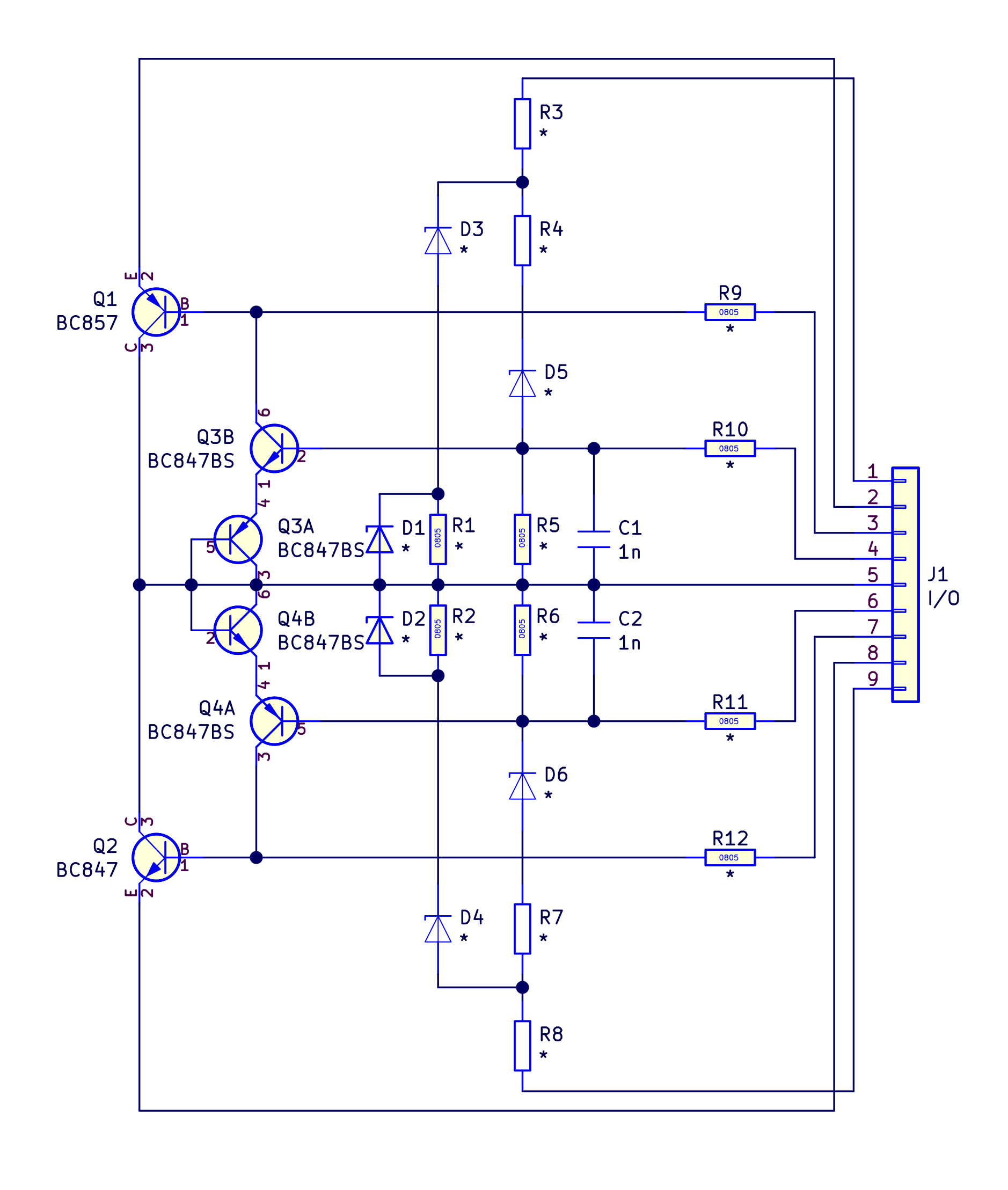

The 1Meg resistors are only for "turning on" schematic. Since it is absolutely symmetric (at least on a paper) in their absence it will rely only on the differences between p-n-p and n-p-n transistors etc. for the initial starting process. Once transistors start conducting, the currents via 1Meg resistors become neglectable.
P.S. Адаш, i think I explained it well, did I? 🙂🙂🙂🙂
Current D1, D2 is 2mA and comes
for D1 T5 (T4-T2-T5)
for D2 T6 (T3-T1-T6)
R7-R10 are only for the initial startup.

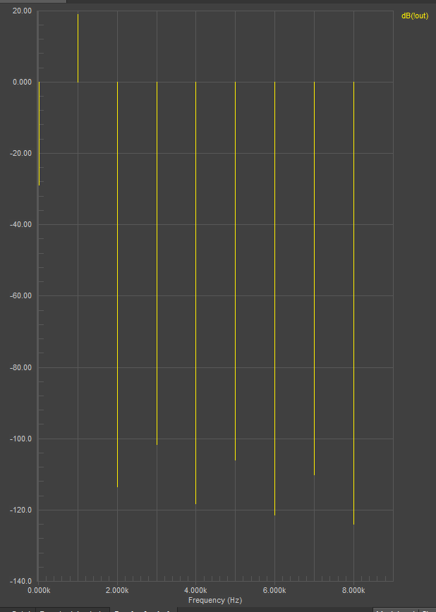

DC in output is only 1mV
However simulator transistors are the same.
Upload a photo of your schedule to see where your error.
It is not MY error. It is YOUR error in YOUR schematic.
It is described in the text in reference to your last schematic with resistor number reference in end of the line.
With 1 MOhms resistor, the zener is not polarized and both current sources do not have current to start up.
So much force where there is moderate talent. So much talent where there is moderate force. Go on with the PCB. Some details about components are over optimistic or pesimistic on simulation. Validate in bench.
He only need to study how to polarize a Zener Diode correctly. The arrangement he did is very good to improve PSRR.
If he assembly only this little circuit in the bench to light up a LED all will be clear to him.
Regards
Yes but my circuit behaves correctly in the simulator, but yours is not working correctly.
Upload a photo of your schedule to be able to discuss things correctly.

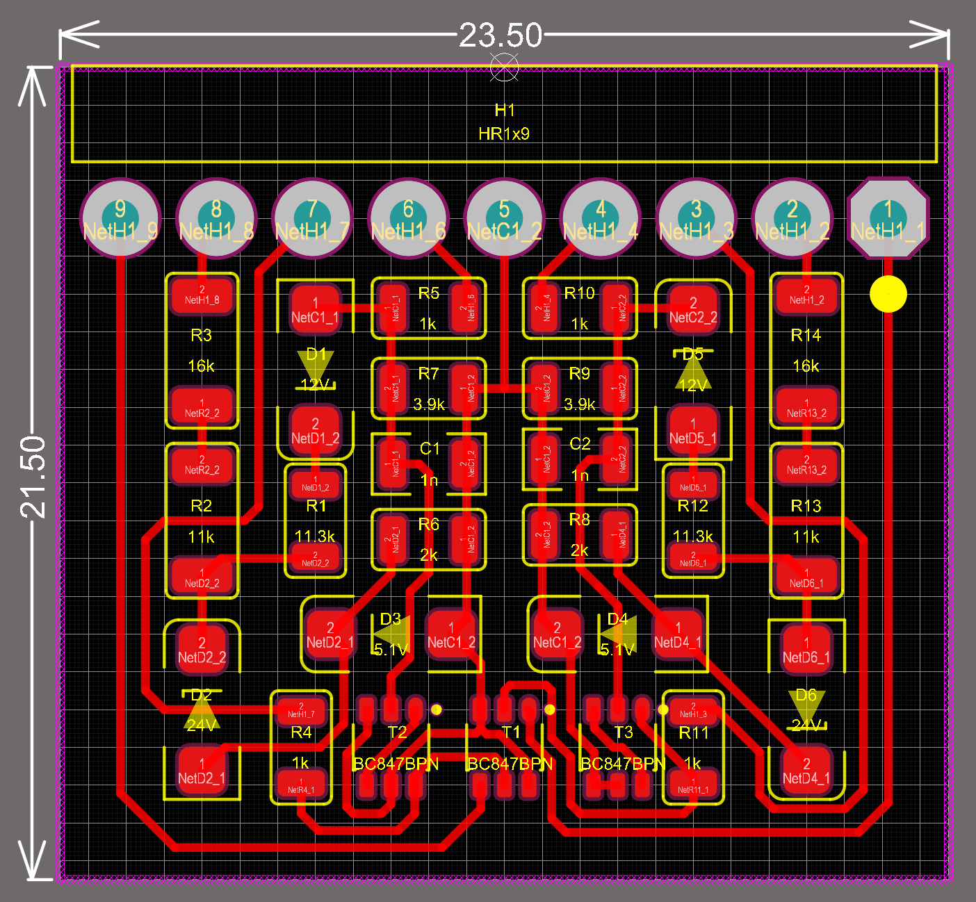

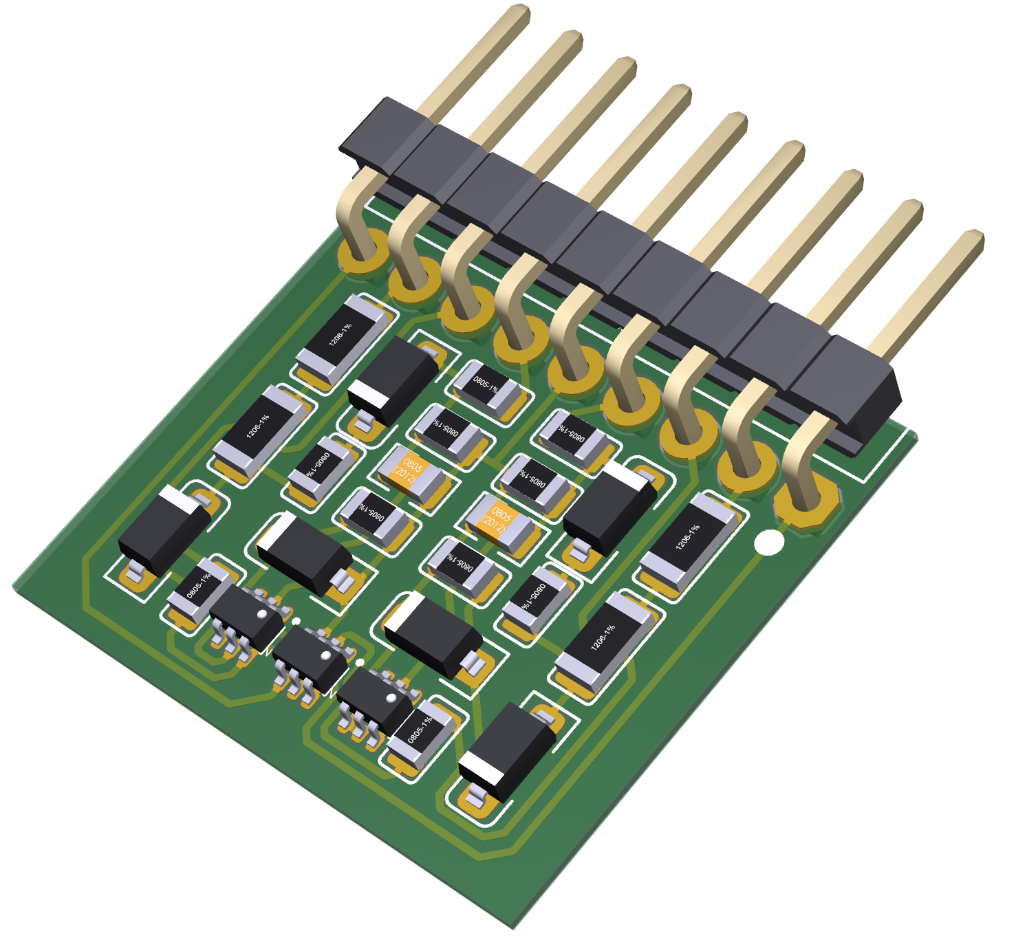

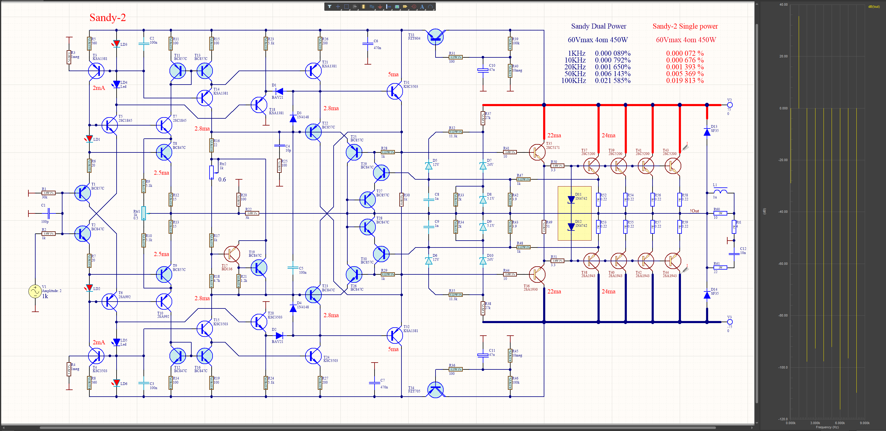

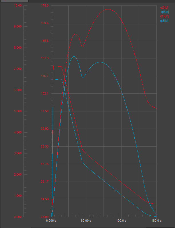

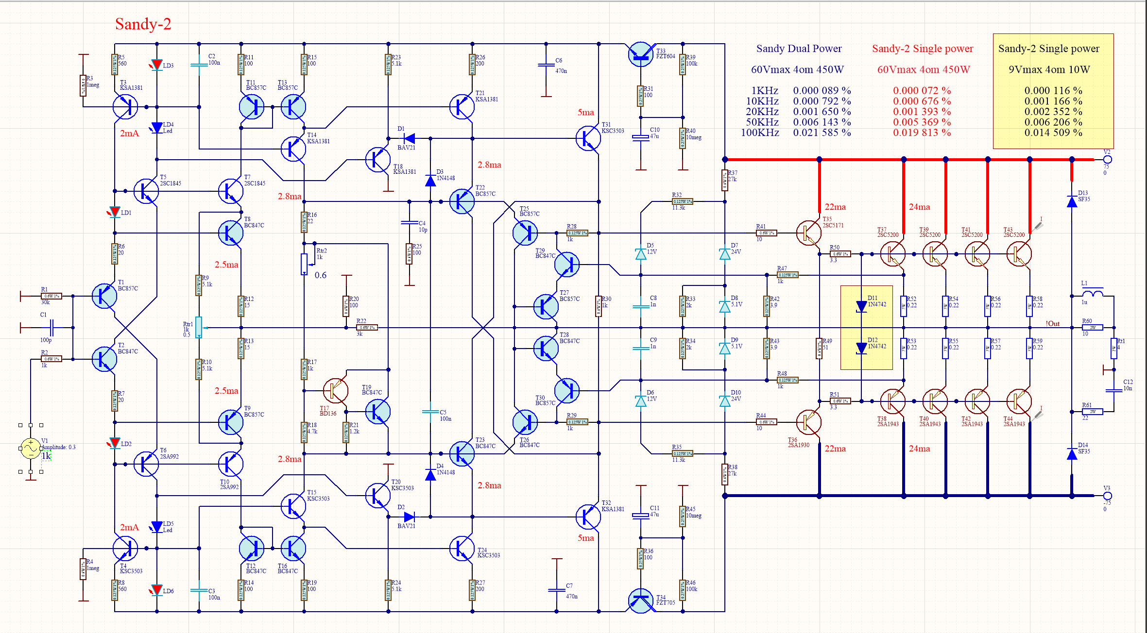

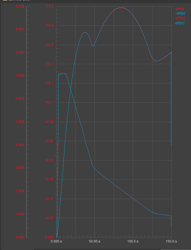

This schematic already has power-based limitation circuitry which follows the SOA curve. It is based on the idea described in the Michael Kiwanuka's paper "The Safe Operating Area (SOA) Protection of Linear Audio Power Amplifiers". It's another question if you're thinking about some latching protection.how abput to add short circuitt protect ?

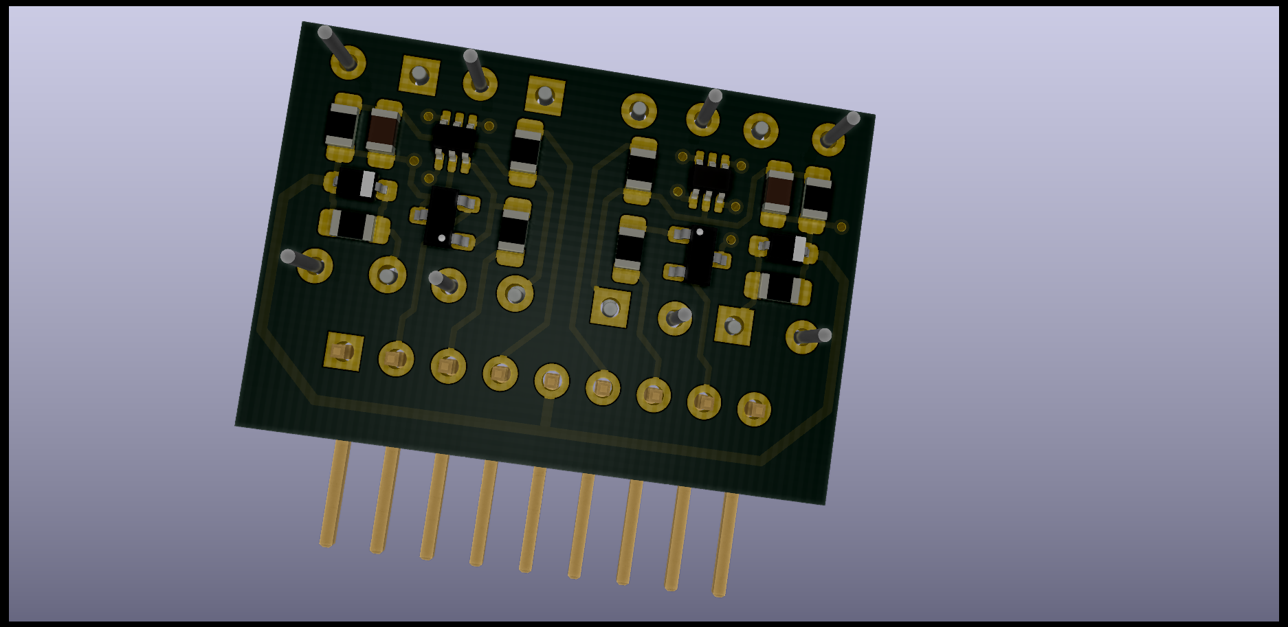

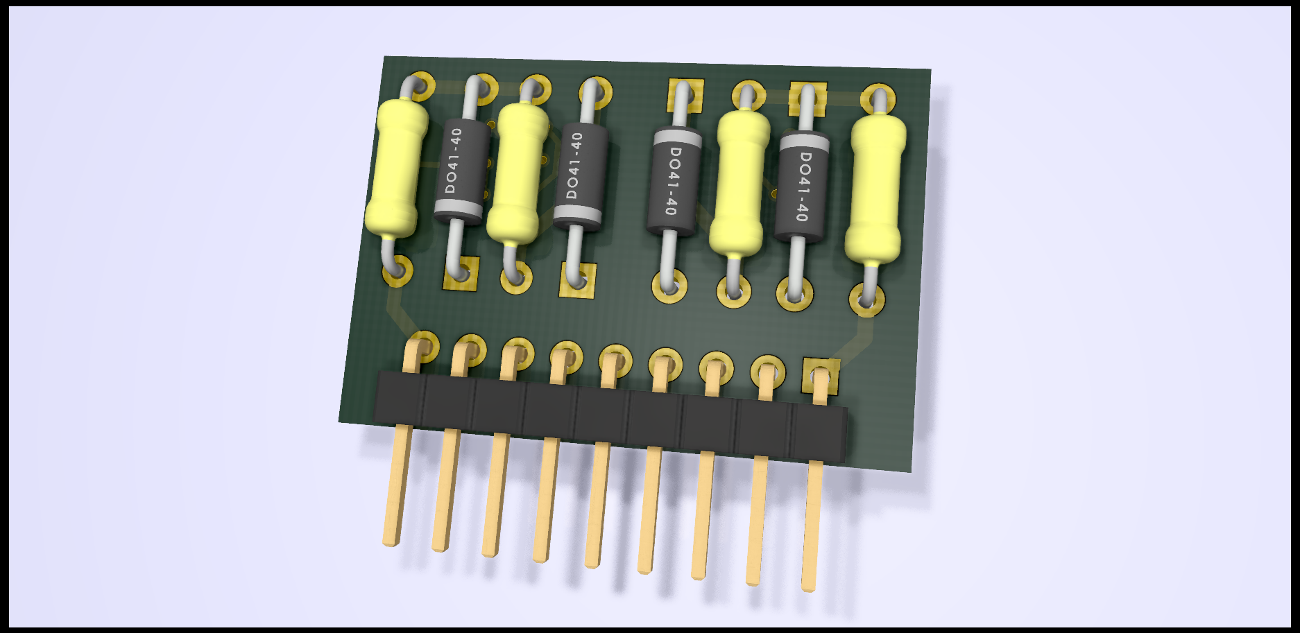

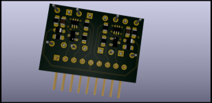

Concerning the SOA protection circuit some time ago I've made a small board in order to use it on various amplifier boards and to be able to (almost) easily change the limits.
Till now I haven't an idea for sharing it since the transistors in SC-70-6 package are not a spoon for any mouth 🙂 but since Sandy opened the theme, who knows ...
OP, there's no need for aggression, thus towards groups of people which aren't mentioned as a debate subject of this topic.
Seriously, this thread is a great example how to lose interest in pursuing reading further. Do as you will, but I would take Elvee and Eva's words with care. So much for talent. 😕
As SMD will be only SMD.
Protect 3D.pdf is a 3D opens only with Adobe
Protect (on 30.12.2019 00-00-45) Altium Designer project
Ha, Адаш - of course I know you'll make it better 🙂🙂 but I deliberately used some through-hole components. After all we have a quiet high voltages here and I'd prefer to be on a safe side when output signal makes an excursion from maximum to minimum. The dissipated power also must not be excluded from account.
Therefore, R2, R3, R13, R14 are two and 1206 (0.25W)
1206 150V max becomes and the power amplifier with +/- 150V

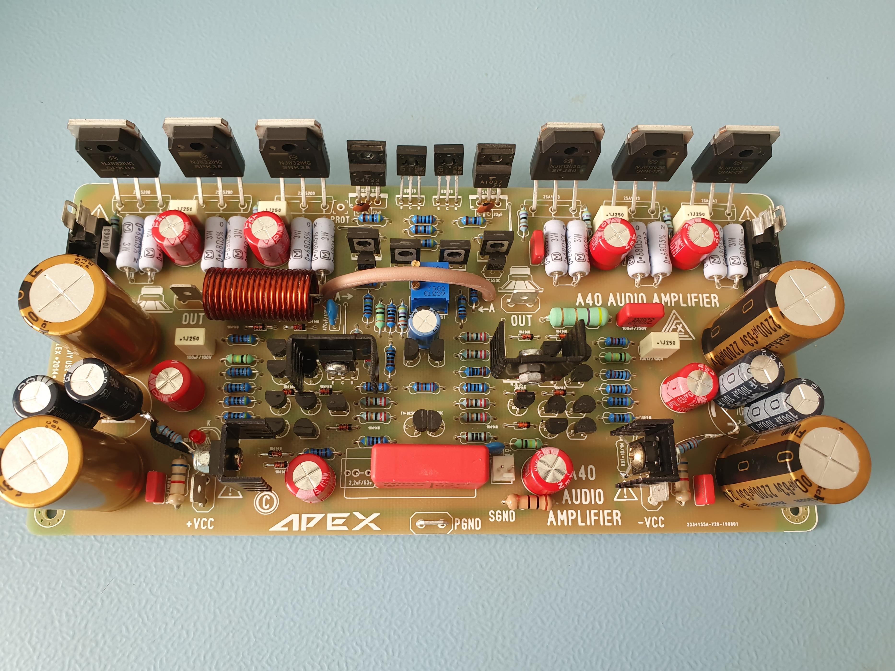

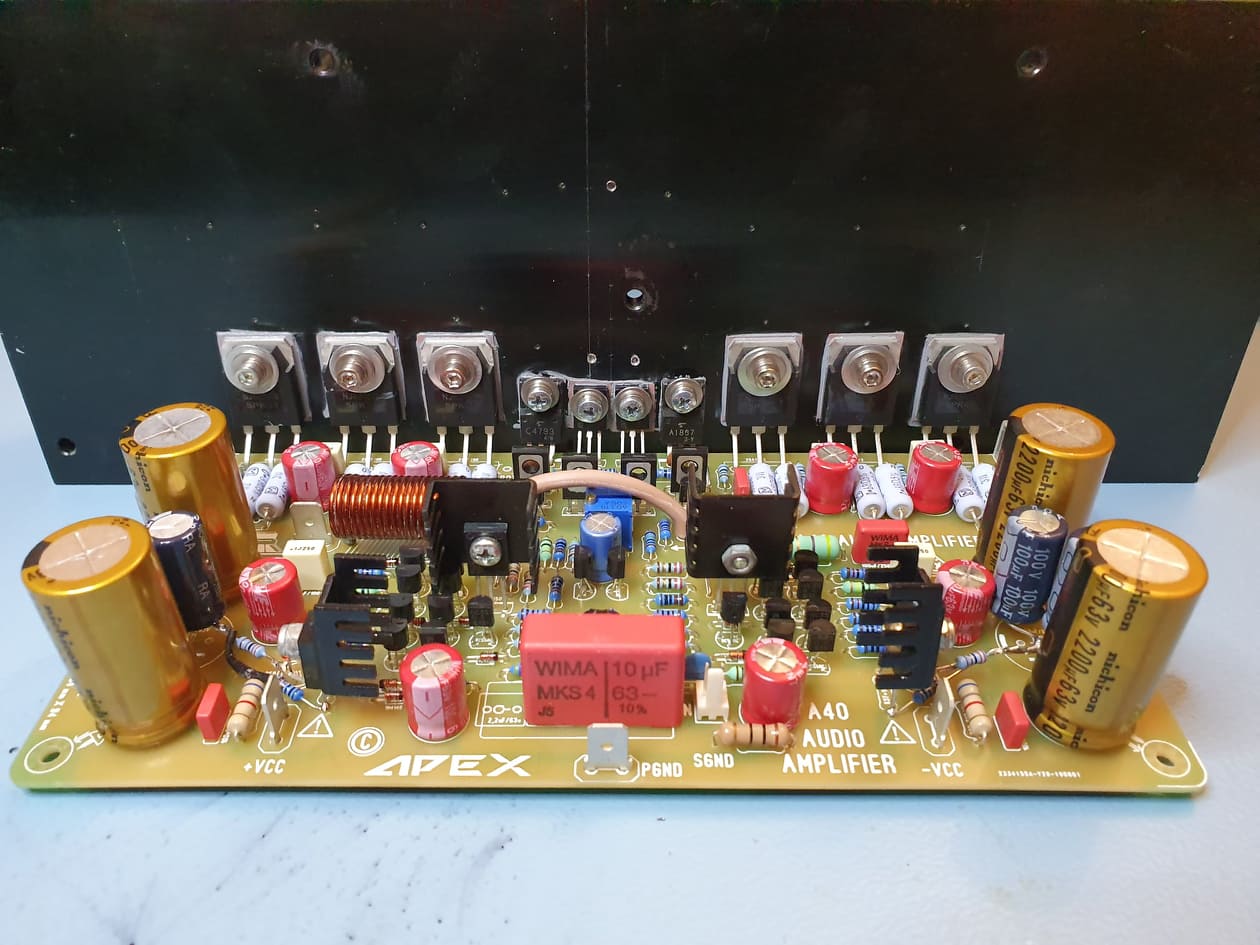

My Apex soud very well too, but after replacing the MJE transistors with proper ones.
Also I replaced 10оhm resistors in PSU rails with Capacit multiplier, due to the bad PSRR of this kind amplifiers (CFA).
Although i am happy with the amplifier, i consider to try the modified version in this topic.
I must say that it is very unprofessional to asseble pcb for the original Apex A40 without annotation in the schematic.

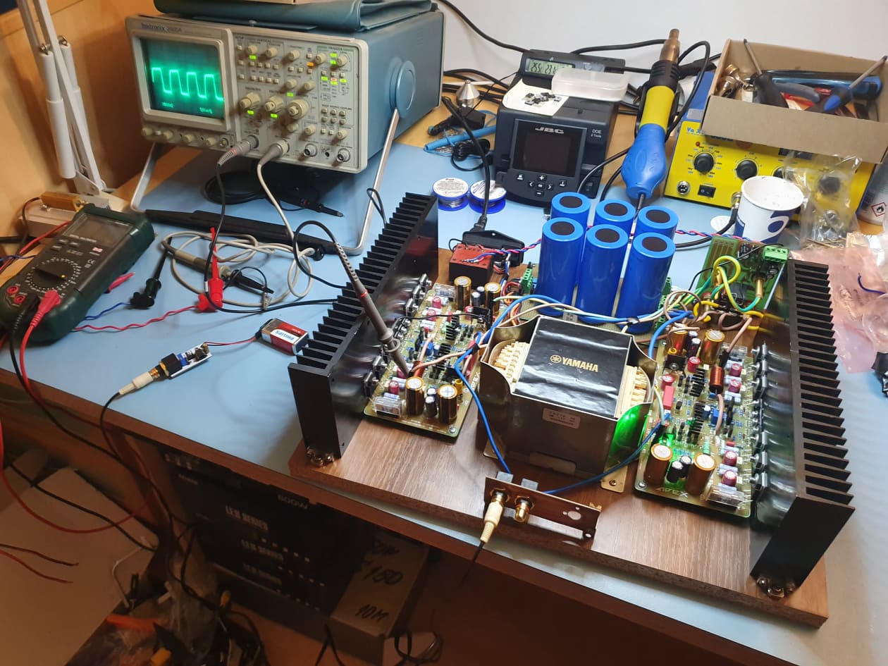

Here are some pics of my test wood board...
