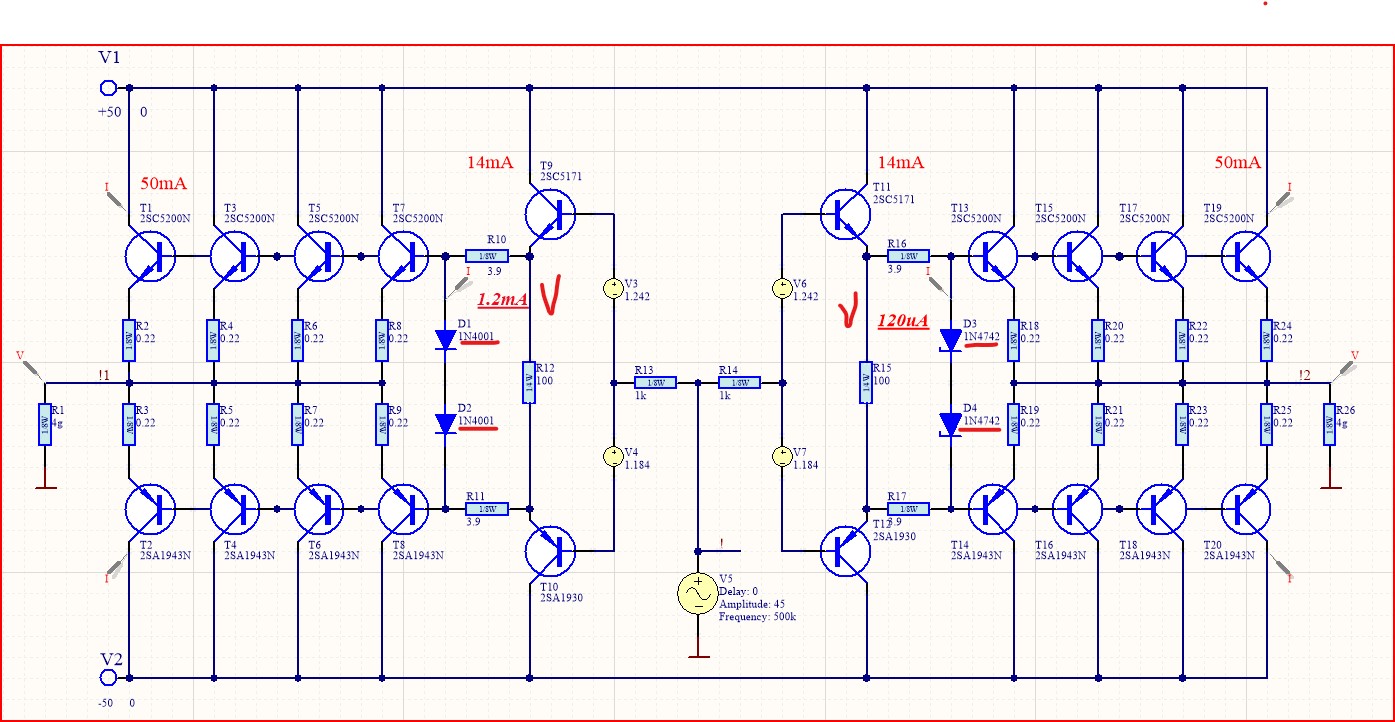

They are used as ordinary diodes.
Zeners are chosen because they have a larger drop and during normal operation the current through them is uA.
And in short mode do not limit the current naturally.

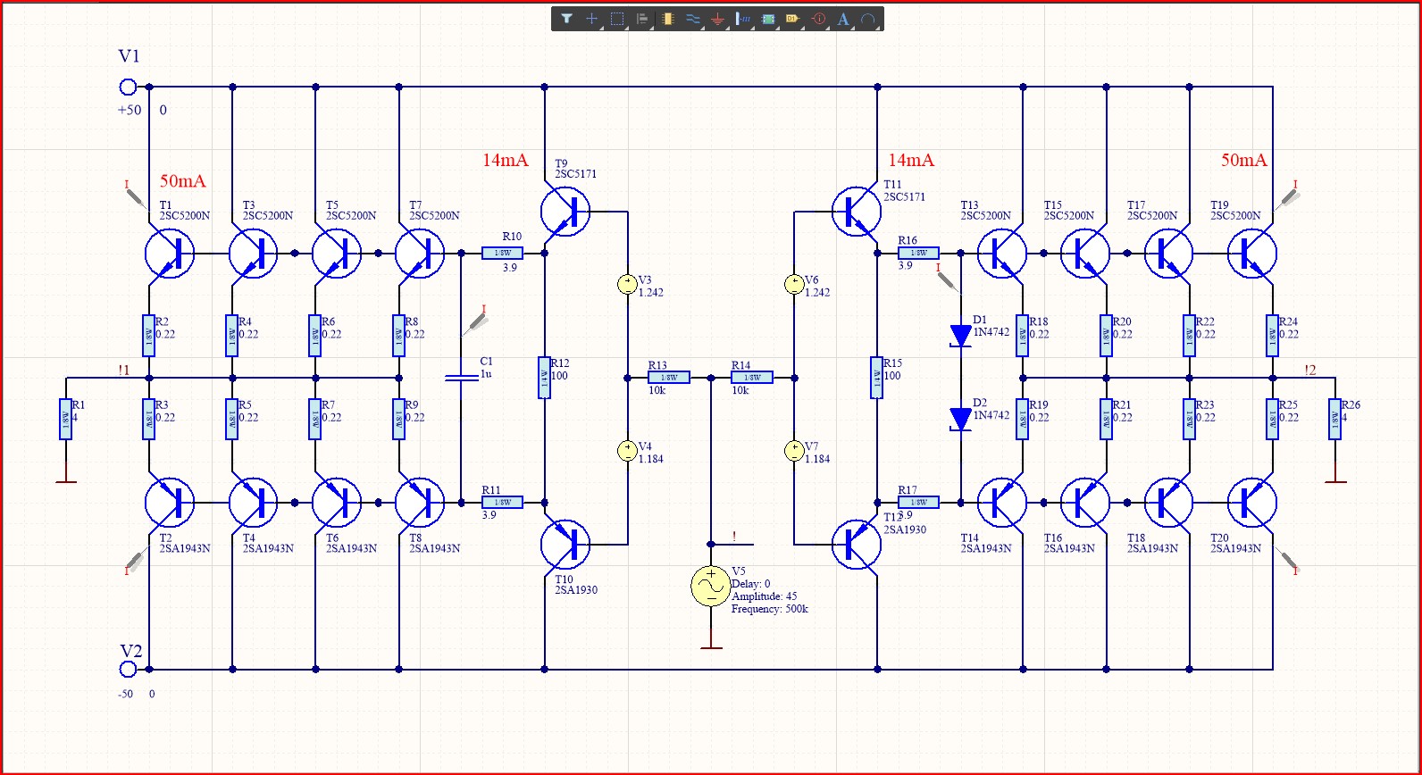

A conventional 1-4u film capacitor is an equivalent replacementWhat is the role of D7/D8 ?

As far as I know, zeners were placed in the cathodes of cascades with a common anode.

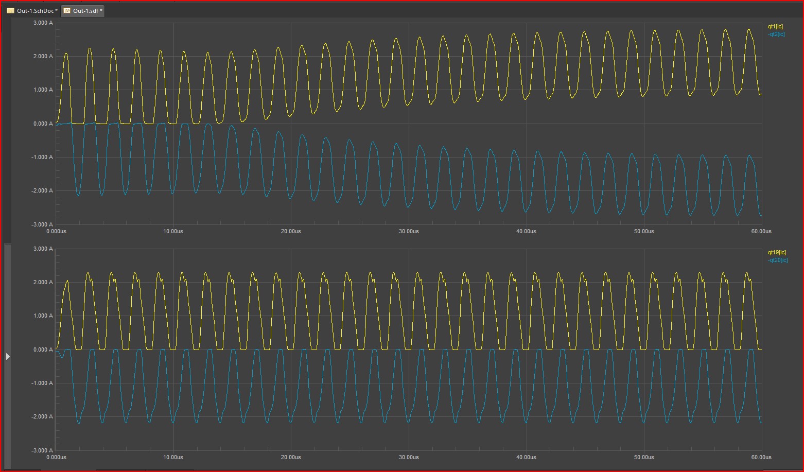

You probably don't know, but when a pulse current flows through the capacitor in only one direction, it is charged.🙂I made a model with zeners . There is no difference with capacitors. I stand by my opinion

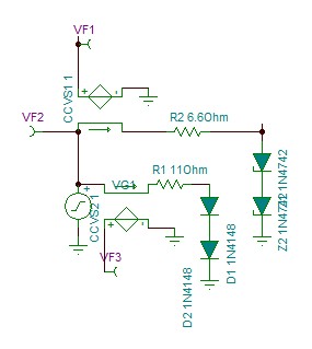

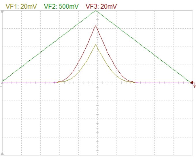

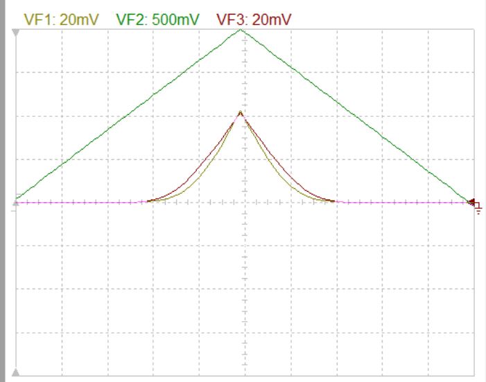

Comparing diode of Zener and 1n4148
With 2×3.3 ohms this is current of the diodes in red 1n4148.
and with 2×5.5 ohms for 1n4148
Are these diodes following in temperature the output transistors?
I agree that you can adjust 120ua in diodes, but when the outputs go hot, the 120ua evaporates as the voltage across the diodes decreases. If you add a resistor along the two 1n4001, can't you also get 120ua?
Try to think again about what will happen when the final transistors heat up.
They are on the heatsink and the diodes on the board.
By heating the radiator, the thermal compensation circuit will reduce the base / emitter voltage and therefore the voltage across the diodes, and the current through the diodes will decrease even more.
