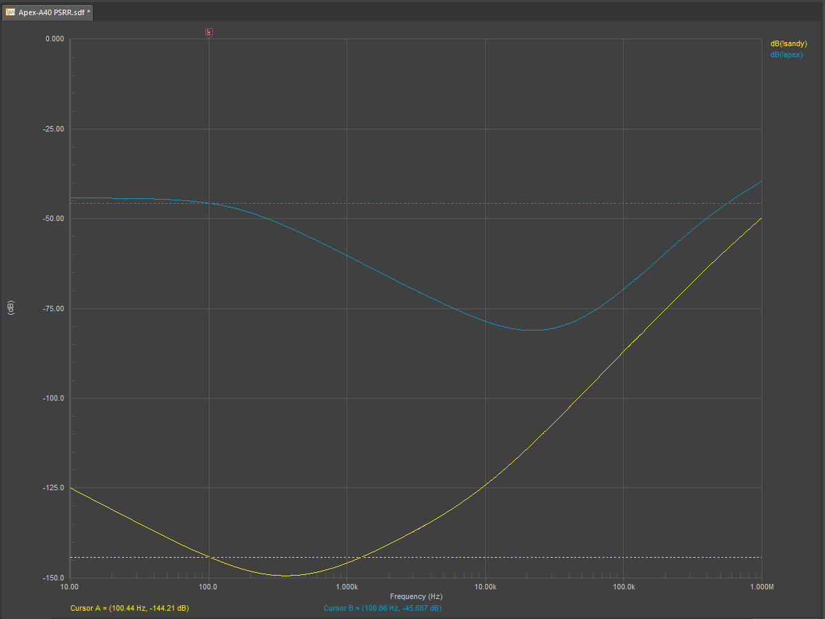

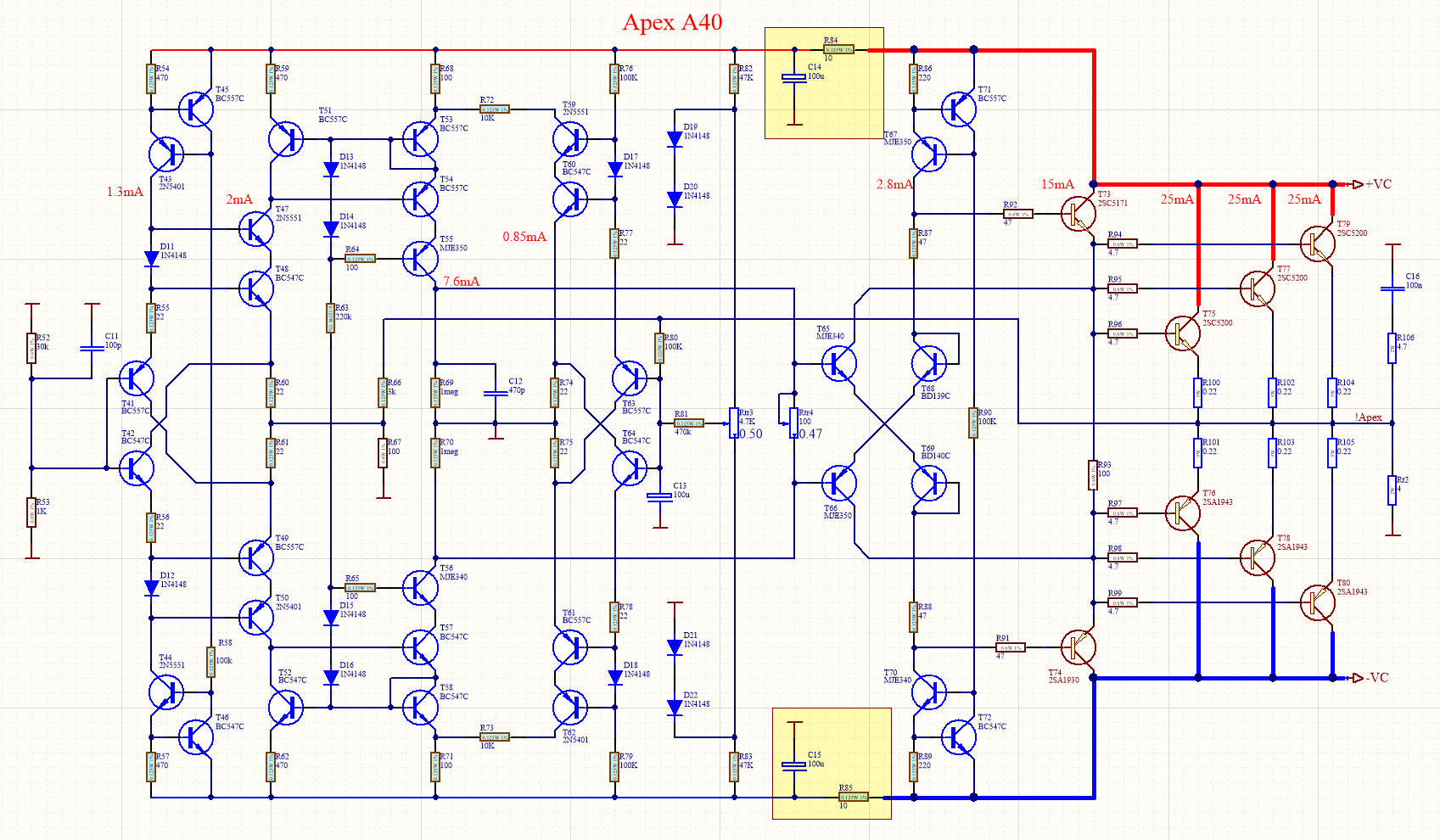

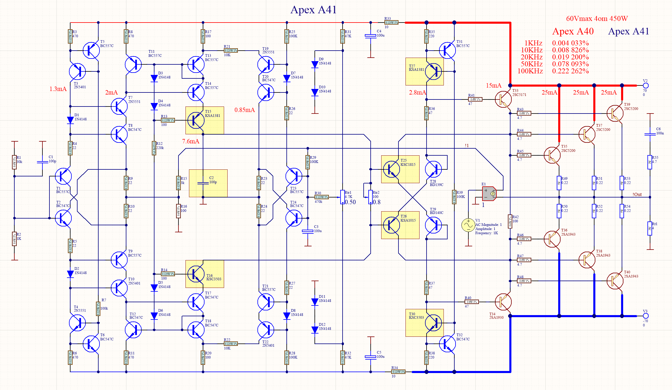

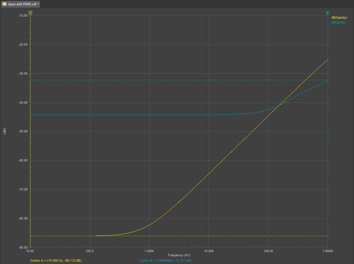

Apex A40 fundamental improvement. (Sandy)

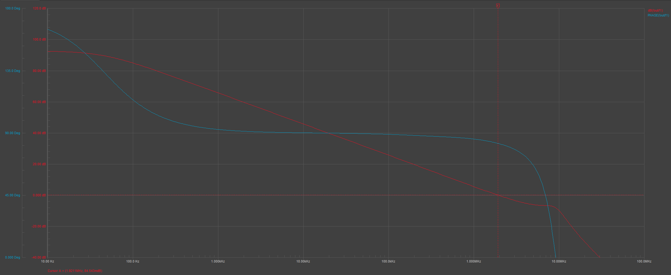

@kokoriantz - look at Bob Cordell's book about simulating the amplifier's OLG.
Otherwise, Sandy is right of course :) - I think I told him about this method for OLG simulation :D:D:D:D
Well, if you use LT Spice, there is a method with Tian's probe but this is a different beer...

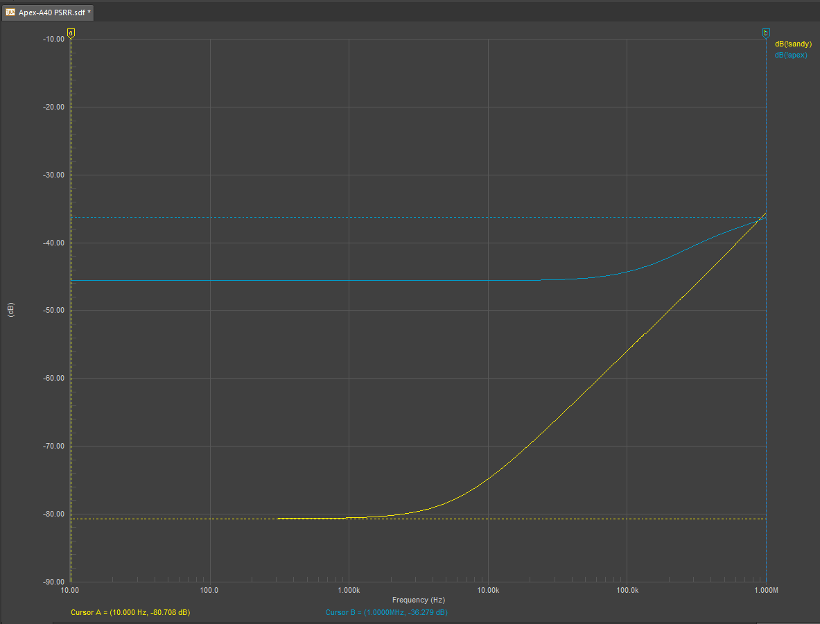

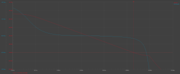

PSRR without the filters of the power supply (yellow) and with them.

Obviously you do not understand how this method works.
Well no name for now.
I do not respect CFA amps when it comes to audio amplifiers have no advantage.
Just I wanted to show you how you can improve the parameters by eliminating the drawbacks of APEX-A40
Hi Sandy,
Do you think that we can improve the measurements on original Apex A40 with just changing the transistors(to a more compatible ones )?. Could you please share your thoughts.
Also, I made the original Apex A40 using BC550/560, and I do love the sonic quality :) Better than my Onkyo A807 stereo amp. But if there are any scope of improving it further I would like to have a try.
Sha

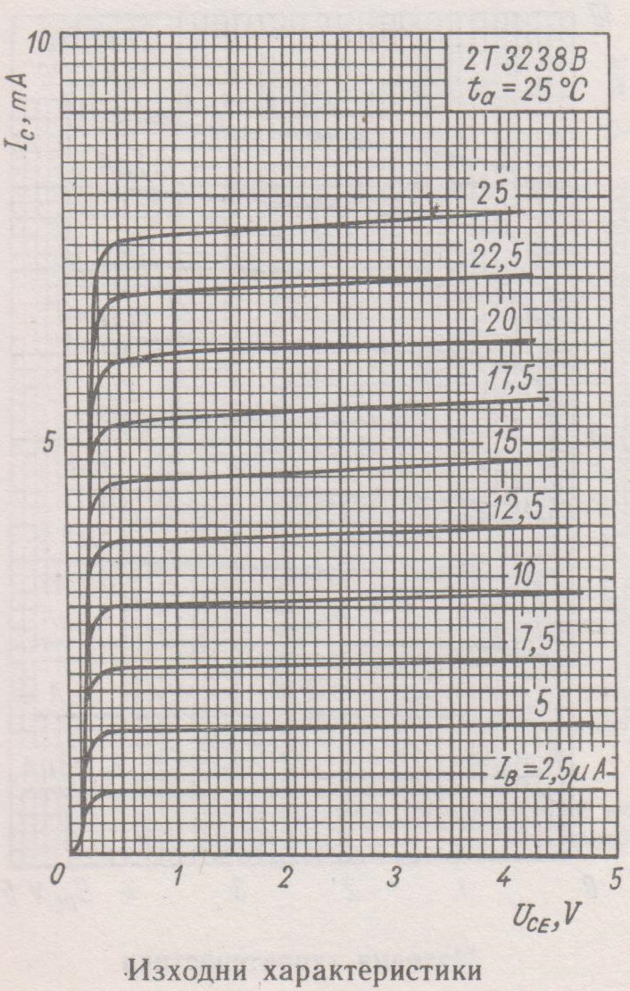

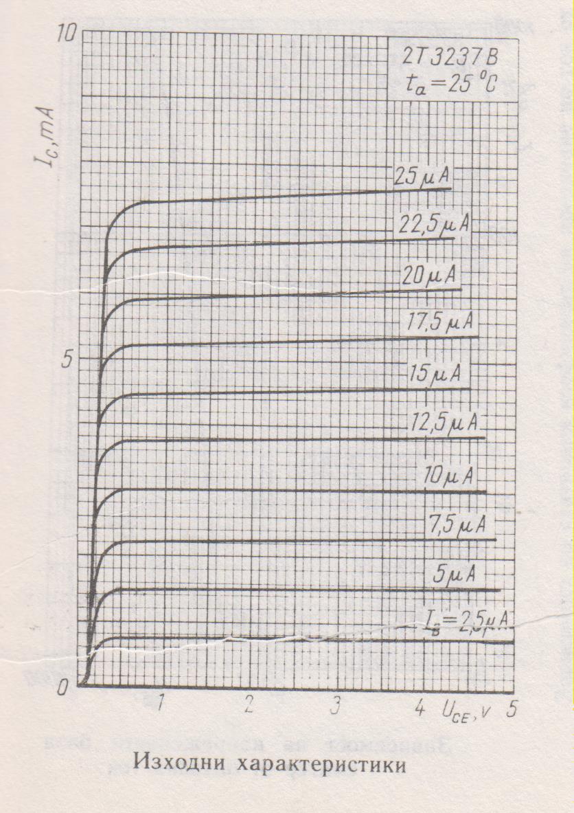

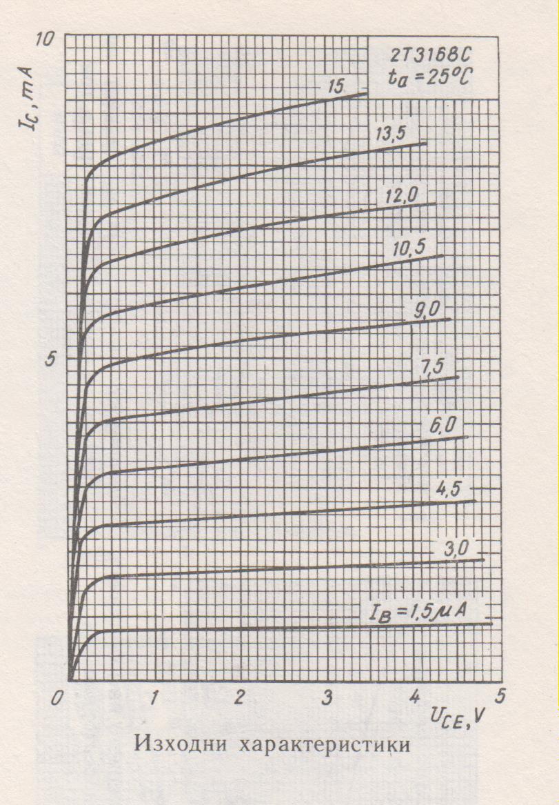

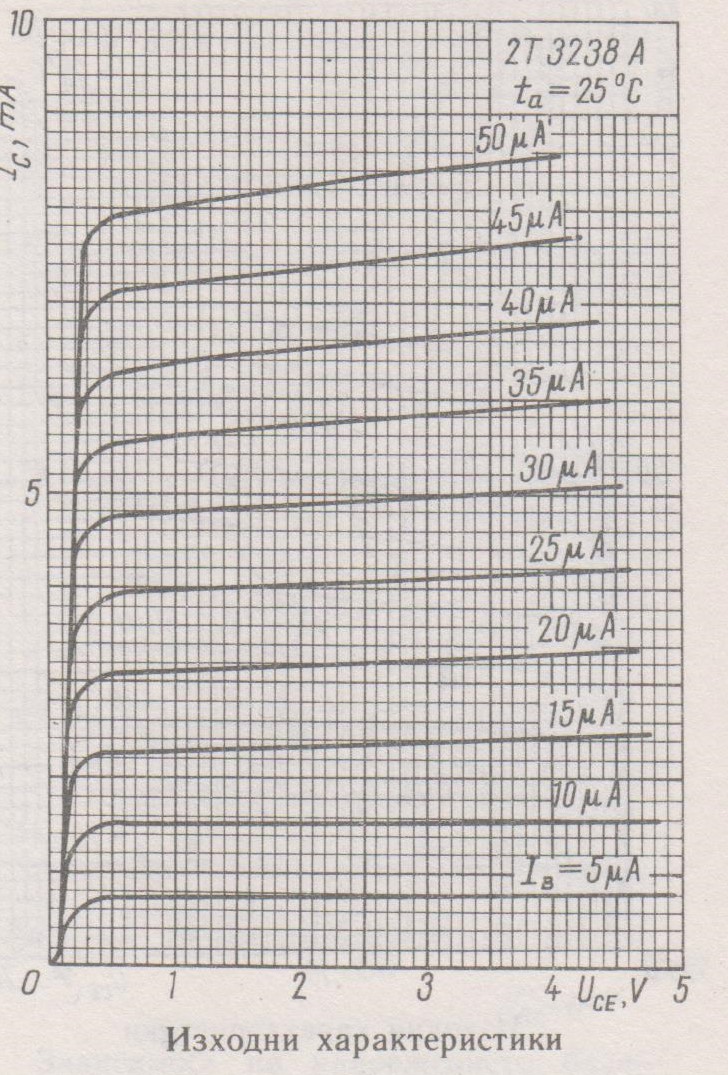

Ето резултата от замяна на MJE340/350 с по подходящи. Промяна и на С2 470pF > 100pF
My friend is actually telling that this is the result of changing the MJE340/350 pairs with some better ones. And the C2 capacitor's value was also decreased from 470pF to 100 pF.
@Sandy: Адаш, I think I correctly translated your words, did I?

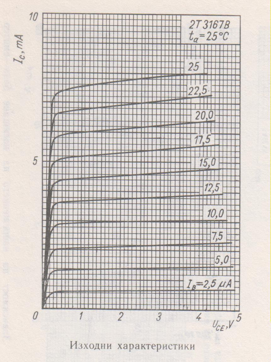

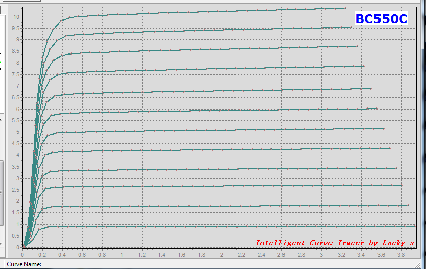

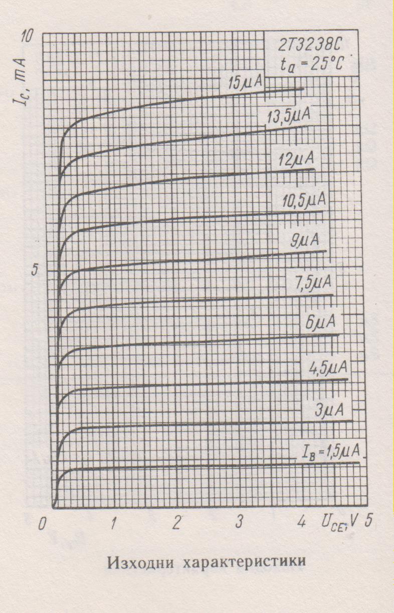

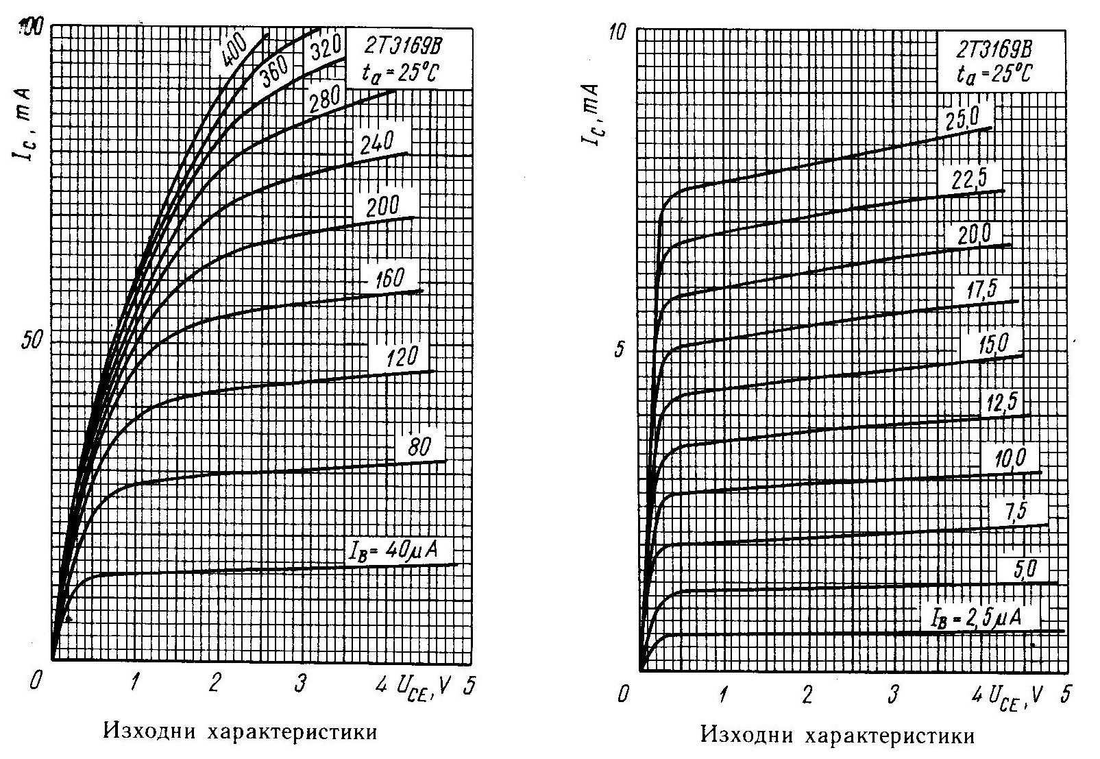

2T3168/3167 = BC548/547
2T3238/3237 = BC548/547
Transistors Low Voltage <50V no problem with saturation and work well in Ucb = 0V Ic<10mA

Interesting design and ideas, but you should probably not present them as related to the A40: in fact, you could have used any regular AB amp as a starting point, but that's not even necessary: your amplifier seems to offer excellent performances, and it is sufficient in itself
There are lots of much less interesting and innovative designs around, but their authors present them in more attractive, less brutal way, and they get much more appreciation from the community, even if it is not really justified.
Another aspect to take into account is the real world.
Sims are OK, and are a great tool, but there is no substitute for reality, because physical designs always show peculiarities and quirks that a sim does not reproduce, and in general, the measured performances are significantly inferior, because many minor, higher order effects are not modeled in the sims.
Presenting a working prototype (even if it looks ugly) and its measured performance will earn you more interest
