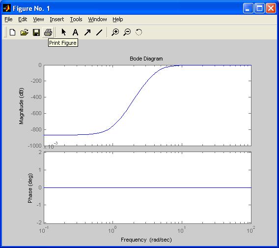

Hi!
The theory of the filter hasn't been completed yet, because a predictor should be used for stability.
It might be done with time delay, but I will think about it at this summer. Up to that time:
John, don't you want to share with us the schematics of the amp.? Then everybody could learn from his own, and each other's mistakes..

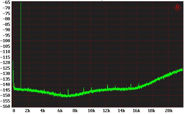

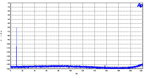

Reclocked / Relatched TAS 5518 DR Atwd greater then 120dB
Note the 0dB scale on both FFT plots is ref. to full power / 0dB output.
As Kim states, note the nice flat noise floor of the 5th order noise shapers in the TAS 5518 - a very good result for an 8Fs AD modulator!

you keep impressing me with the measurements you do. Your clock/reclock/relatch circuit makes it possible to see the exact noisefloor of the noiseshaper.
For the TAS5518 with the internal PLL where there is no garantee on the exact timing between MCLK and internal 200MHz clock you must have problems with the reclocker/relatch from device to device.
And yes 120dB from a AD-modulator is good. Adding 24dB PSVC on top => 144dB from clipping to lowest noise.....
With standard integrated output stages and without reclock/relatch a DYR of 110-112dB is normally acheived. Adding the PSVC a pratical DYR of around 130dB is acheived - something most class AB-amps have dificulties acheiving.
