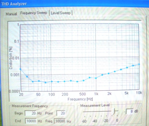

I measured this with one of my new designs. However i am not using the best ferrites yet, i will get them only in a few days.
Then i expect the lift at 10kHz will disappear. :cool:

IVX: Absolutely agree with you. But now i am waiting for one of the ferrite types with very low THD. However the new amplifier allows including the choke in the feedback loop. And what happened was the THD became stable and frequency independent, but at a higher level than here. Something like 0.007%.
Anyway i am also on the trace of another contributing factor to improve the THD. So in the next week or so, i will have something that doesn't look so bad compared to other available modules.
However i dont want to comment on the 'Commercial available amplifier' discussion going on, since for me as a grown DIY'er these amplifiers have no special interest for me. Especially since the best ones you can get today is on the DIY market.
