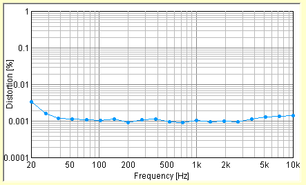

What is the relation of THD as function of Zpsu vs Zload for open loop class D?
kims said:
Low THD is not nessesarry a measure for good sound - but none the less attached is a graph showing just that with a non feedback design.
modulator TAS5518
power stage TAS5182, mosfet FDD5612 fairchild, used in PBTL (2channels is parrallel mode)

This is the equation for THD in BD modulation from TI's aplication SLEA028:
THD = Rpsu*M^2 / (4*Zload)
where M is maximum modulation index. I don't know what is relation for AD modulation.
Best regards,
Dejan

The power supply used for the THD measurements I showed in the earlier post is shown in the below document.
http://focus.ti.com/lit/an/slea038/slea038.pdf
the DC/DC concverter A706 has less than 6mR output impedance over the entier audio band - when used with a amplifier with more than 6x1000uF low Z caps (less than 20mR).
For this design the inductor does hardly affect the THD at all - there is only a small rise to 0.02% at 10kHz. We use Micrometals T106-2 or the same material in a rod-inductor. 2pcs 15uH in parrallel.

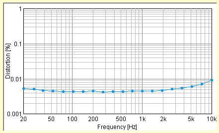

kims: Thanks for that explanation. It seems your measurements are quite lucky compared to the specs. Ex 100W in 4 Ohms is 5A from your PSU. 5A x 6 mR = 30mV which should give you something like 0.06% THD or maybe even modulation.
What i mean is a 50 Hz signal could modulate a 1 kHz signal through drops on the rails. Have you tested this potential weakness?
Just to keep you updated i now got the new ferrites installed, and that equalized the THD. See curve below (1W 8 Ohms vs freq)

..Unbelievable, the new ferrite better in highs, but worse for middle in four times! I never seen such effect of the output coil. In my experience, properly gaped core give almost the same THD figures for many (if not to say "any") ferrites. I can't understand what is the reason for such THD "equalization"..
IVX: Yes i was also baffled by this effect. But it is probably because the lower permeability requires a lower biasing of the core, and thus gives the higher THD at low freq but lower THD at higher freq. Thats the only explanation i can find at this point.
This new ferrite material also features lower THD at power than the ferrites i have used before. See below:
(40 Watts RMS 8 Ohms )
Hi Lars
The THD as function of Rpsu is given by the follwing eq for BD-mode:
THD = Rpsu*M^2/(4*Rload)
for AD-mode this eq does not hold - but will at least be lower than that.
Rpsu = 6mR, M=0.94 (max modulation), Rload=8R
6mR*0.94*0.94/(4*8R)=0.016% - not far from the measured results.
With these NON-feedback designs the demand for feedback is moved from the amplifier to the power supply - some where the 50/60Hz signals from the mains need to be filtered and regulated - so for a 6ch design using a common PSU, we have one feedback system e.i. the SMPS, handling the mains frequencies, 100Hz ripple and harmonics thereoff.
Making the SMPS having low output impedance is hardly any issue today with the knolege on feedback systems used in manny class-d amps (just a SMPS with a varaible reference voltage).
Take any class-d amp with feedback, feed it with a dc-voltage, and you have a very good SMPS - and it can even sink current (that many SMPS can not).
The THD graphs you show looks very good - what material is used for the inductors (we use Micrometals -2)
rgds,
Kim
