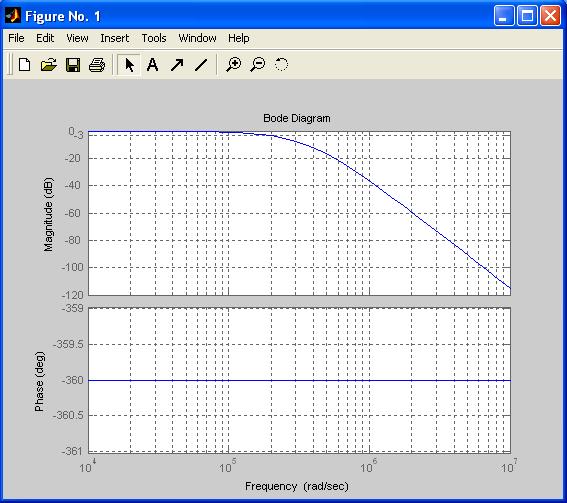

Hi Gyula,
your studies were successful, we can see here... 😀
Did you combine a 4th order lowpass wit an (double) allpass? Is it a low power filter (using OPAs) or a power filter using L/C? The first solution would not surprise so much, because similar things are already used in "transient perfect crossovers". But it is interesting to experiment with. If it is a L/C-solution - hat off, I never saw that behaviour before.
Best regards, Timo

Hi John!
So, the life is drawn in for you? I wish you scoop!
I will write tomorrow about the filter.. In essence: the transfer function fasors are counterrotating of two serially connected second order low pass filter. I think it can be made with any type of filters.
