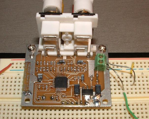

But after magnifying your photo of the pcb, I thought first: you migh have nuked a cap or semi conductor by soldering it by hand. Since you have run into similar problems before.....
ALways use a cooling probe while doing this! (Soldering I mean, not nuking :smash: )
Leakin caps can spoil the fun. Not to mention semi conductors who aren't semi any more...
Your schematic seems quite confusing when it comes to pin 37 to 48 but it seems alright.
At the bottom (pin 13 - 24), you switched LRCLK and SCLK, I guess. Have a look at that.
Desolder all components, perhaps except 3002. Check them for their value. Hopefully you didn't waste the 3002.
Good luck.
TAS3002 board
Ok, Ive butchered my 2nd board, removed all resistors/caps cut tracks etc again. Still no joy. After tearing my hair out I left it for a while, came back and double checked the IC's orientation on the board. To my suprise I misinterpreted where the dot corresponds to the pins. It was soldered the wrong way!!!! no wonder everything was behaving bizaarly. I will have to etch another board and get another TAS3002 chip. So I will post when/if I eventually get the board working.
To me the datasheet is really misleading. I was working from the pinout diagram they have on page 12 and I assumed the orientation they show would correspond to the orientation of the text printed on the IC: it does not!.
Anyway I am mighty annoyed Ive destroyed 2 boards but happy I have found my mistake.
TAS3002 Working!!!!!
At last, after 2 other unsucessful PCB designs, I have a working TAS3002 digital equaliser!!. At the moment I have it hooked up to my computer via USB and am fiddling with the various registers and functions.
Working on some nice software so I can play with this IC a lot more :)
I am very happy!

I am controlling it through a 2 wire i2c bus to an FT2232 USB controller board and have written the software in C#.
